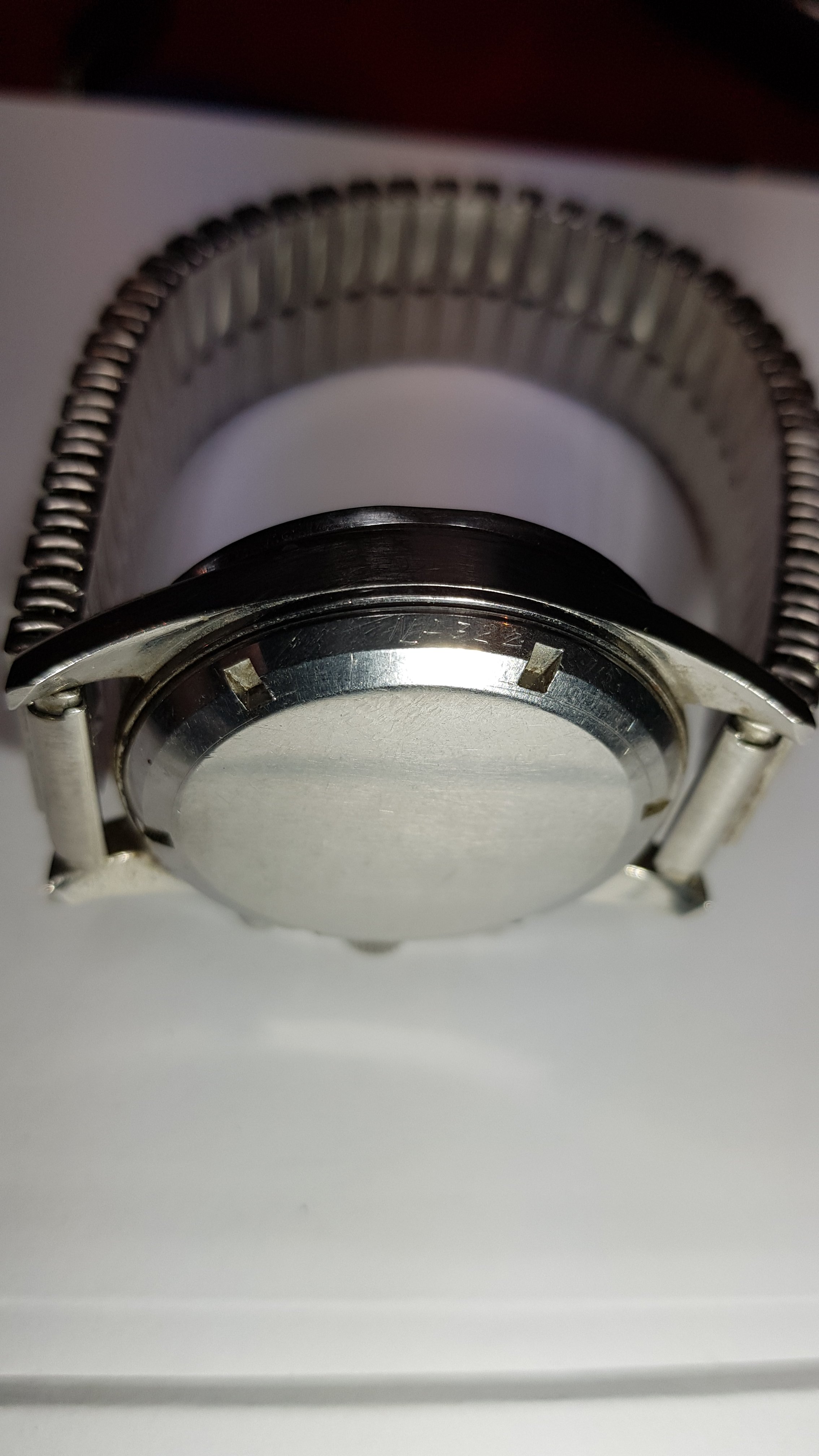

Let's all critique this one for a second: 😀

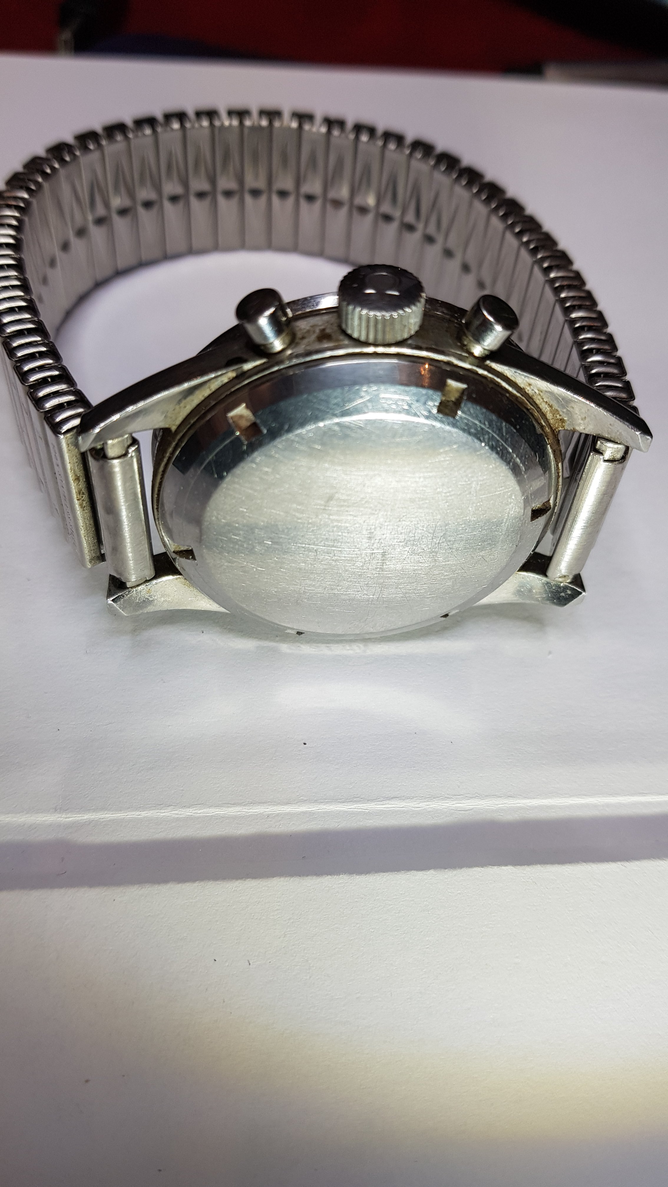

The hour hand has been relumed. The bracelet is incorrect. It appears there is a dent on the bezel at 9pm side and caseback appears to have a chunk missing from the outer edge near the crown, which also looks to have been replaced. . Other than that I love it!!

caseback appears to have a chunk missing from the outer edge.
Looks like a reflection of the crown (if that's what you're referring to).

That is what I am referring to and thats no reflection, it has been ground down.
OP: Take a look at the caseback in this spot and see if its been ground away or a reflection.. THX

Is'nt everybody doing a bit hysterical about opening the watch? A normal qualified watchmaker can open it surely without damaging it. Even I can open it and I'm a total fυck up. It's just a watch which is worth a nice Ferrari... hmmm... ok, leave it as is...

Shabbaz: How many pristine Speedy case backs have you seen in your life without distorted/damaged square holes or scratches across them from some tool slipping? Most are F'ed up and were done by some "watchmaker" over the years.
On this watch just leave it be, The proper tool and proper person should be consulted to do this. This is a no joke piece..

Looks like an honest 2915-1/2 that has lived a life.
Dial seems to be in beautiful condition.
Watch has a couple of minor issues that might detract the most pickiest of buyers (such as the dented bezel, & relumed hour hand). But overall it is in beautiful shape.
The replaced crown is an easy swap with an original.
I don't know if you're intending on keeping it in the family or selling it, as its value could be a life changing sum to many.
I would value this watch at about $150,000 - $175,000 on a private party sale. (Given that the original movement is inside of course...).
No "Chunks" seem to be missing in the side view image.
Rubbish. That's the reflection of the crown.

There is no damage on the back. Just bad lighting. The watch has been in my dads possesion since 1970 and he says he has not had anything done to the watch. If something has been changed or recolored it must have been done before 1970.
