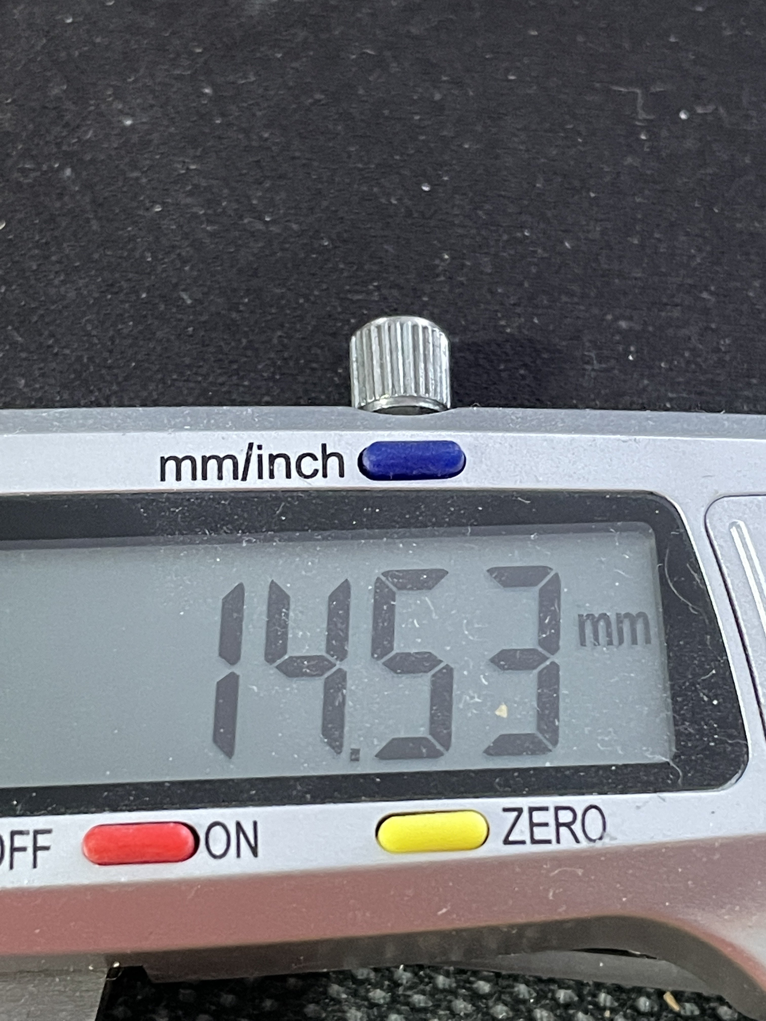

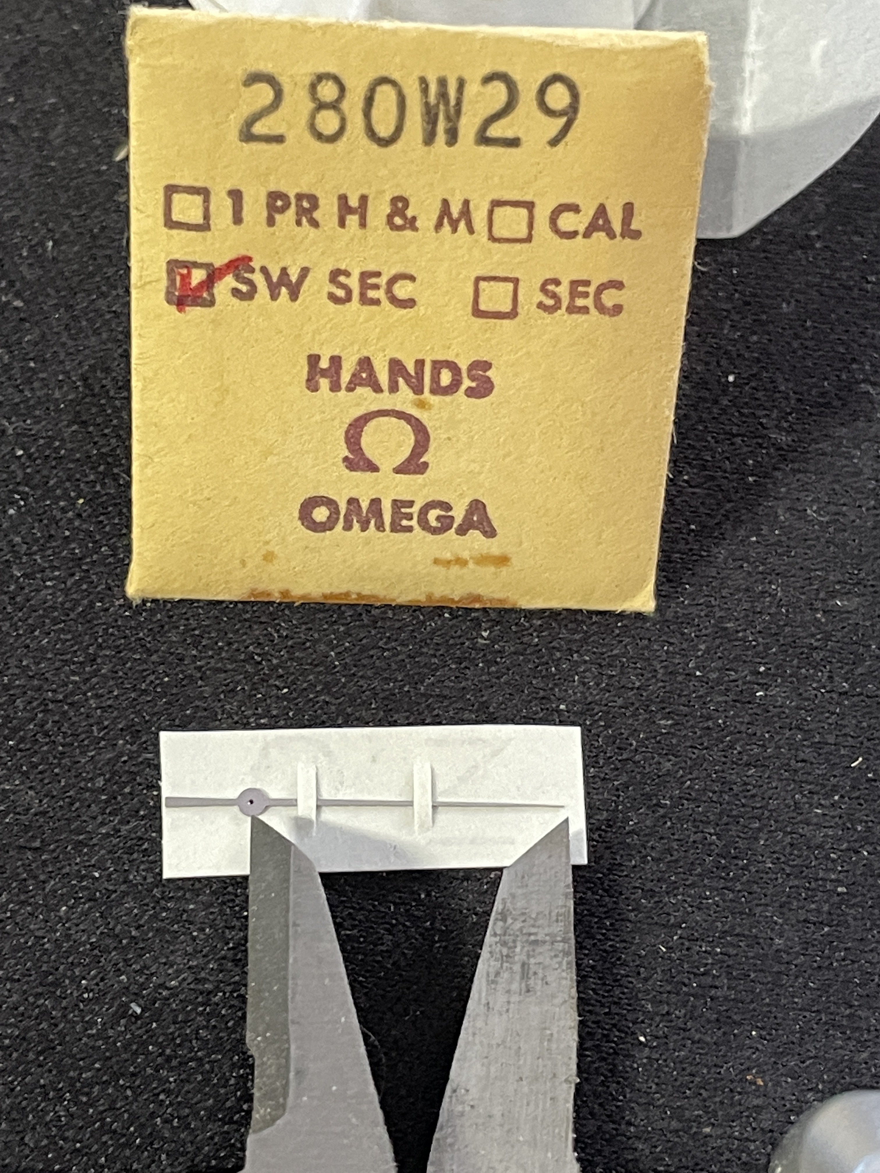

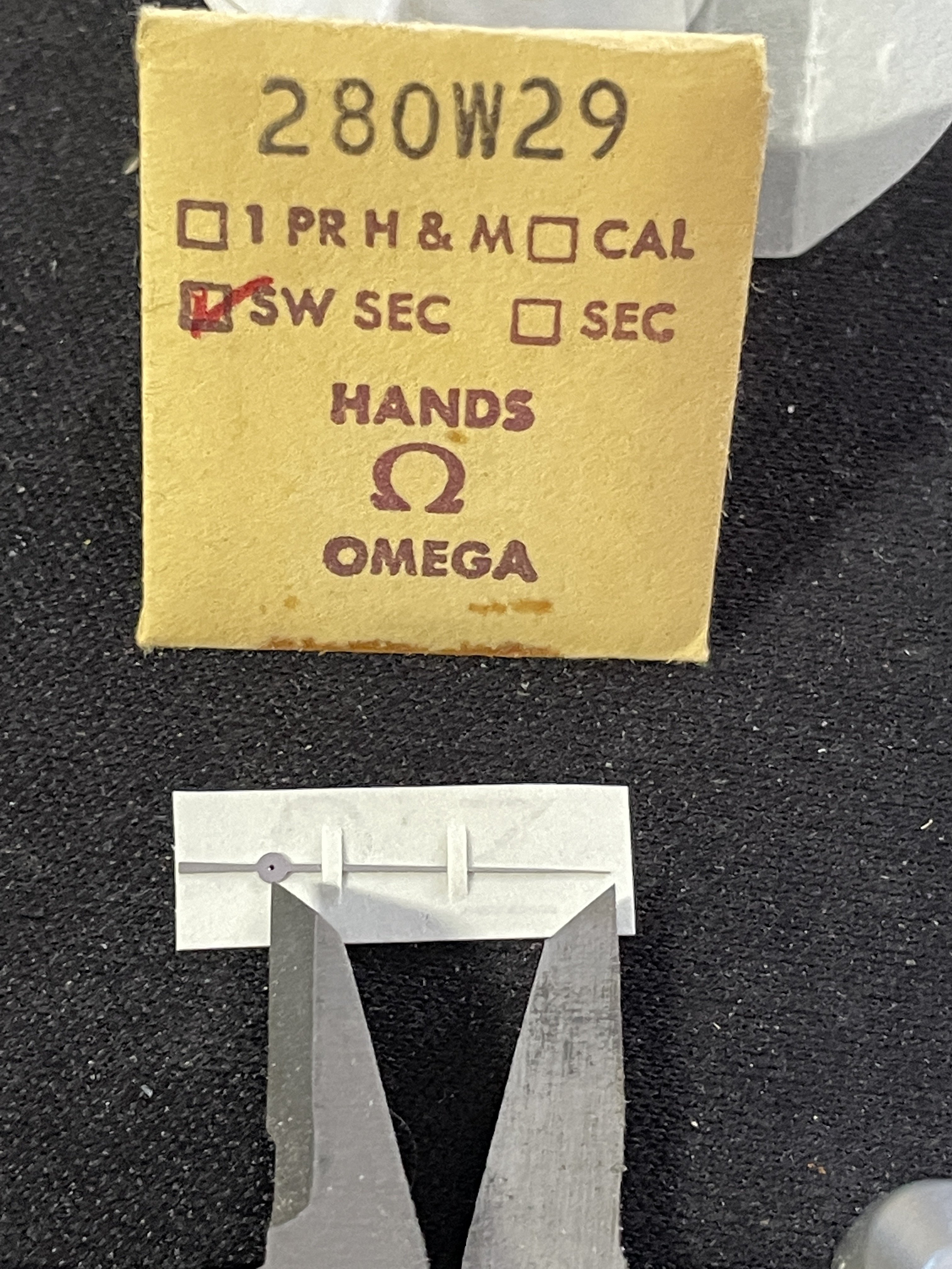

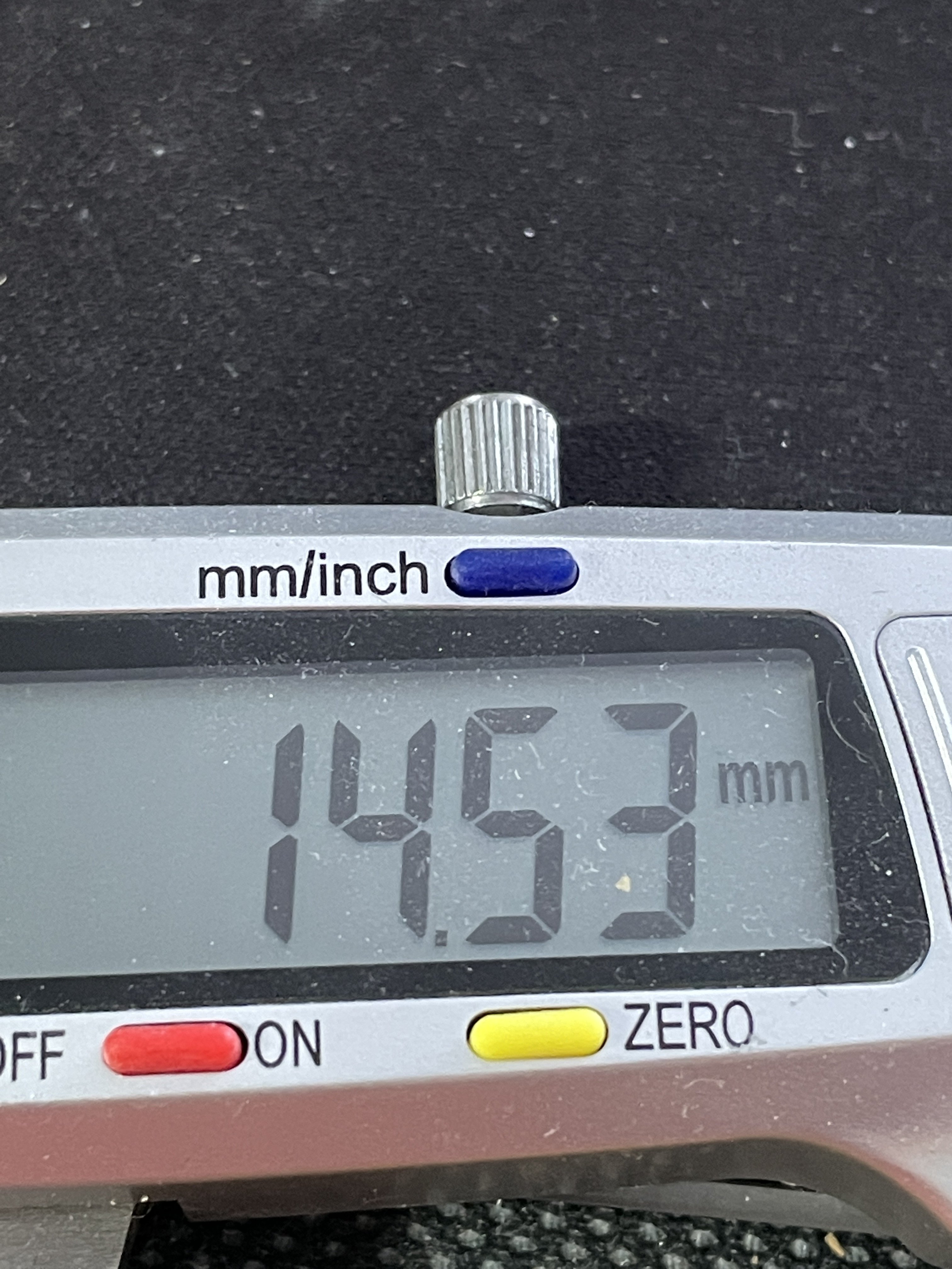

I have an Omega "second hand" it is unpainted, it is in its original packet marked 280W29, it is 14.5mm from the centre to the end of the hand, the overall length is just shy of 19mm.
I always thought it was for a Railmaster but the person has said he thinks its for a 2915, can I confirm......

I have attached a couple of pictures.

As the envelope unveiles: its for a cal. 280 (30mm family) and not for cal. 321
