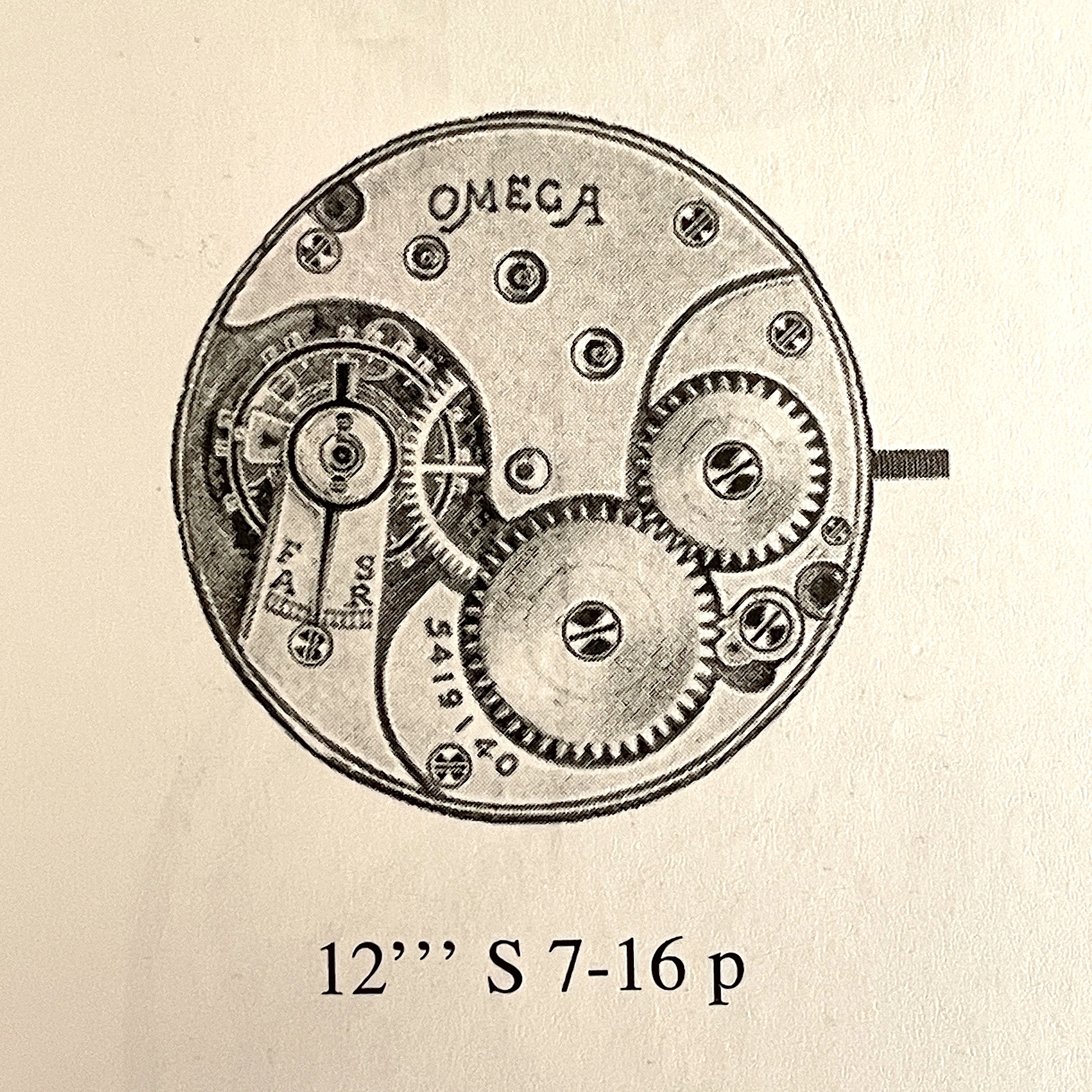

Please help me authentify this watch ;)

29mm would make it a 13''' (28.9mm) size. I can't find a 13''' with that configuration.
Did you exclude the casing ring from your measurement?
The closest example I can find to that configuration is a 12''' (26.5mm).
This caliber was introduced in 1899 and was used in Omega's first wrist watch. It had technical problems and was withdrawn in 1923.
So, the outcome is that an enterpising watchmaker went through their parts drawers and found enough bits to make a watch.
Ahhh younare right without thencasing ring it is 12" as you mentionned.
So based on what you said, the movement is original but a very old and early one right?
And the lack of serial number on the bridges is normal?
Thank you again my friend, you are being extremely helpful 🙏🙏🙏
Omega often marked early serial number on the plate under the dial, except when they didn't and marked them on the bridge.
Omega has been known for such inconsistencies.
Brother yoilu have educated me a lot on this matter, i truly appreciate your help and expertise.🙏🙏🙏
