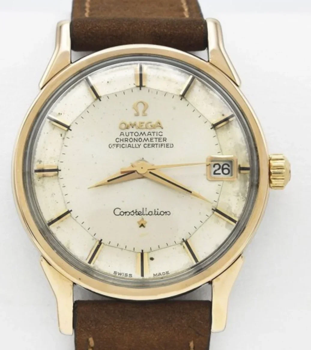

Hi everyone,
I'm quite new to the forum but I've been reading some of you for a bit. Thanks for sharing your passion, everyone.

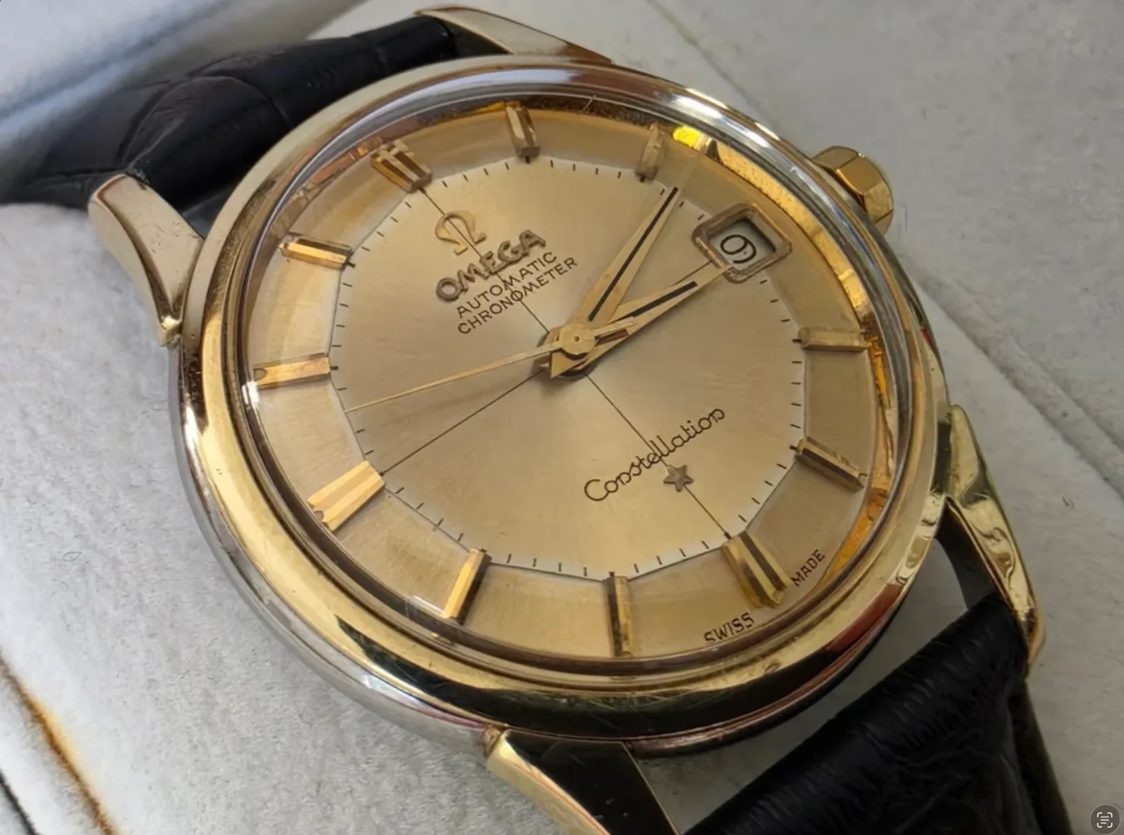

I'm looking into buying my first Omega watch and I understand that either counterfeits or redialed watches are present in the market.
Since it's my very first investment as a wedding gift, I don't want to get that one wrong and ask for your help.

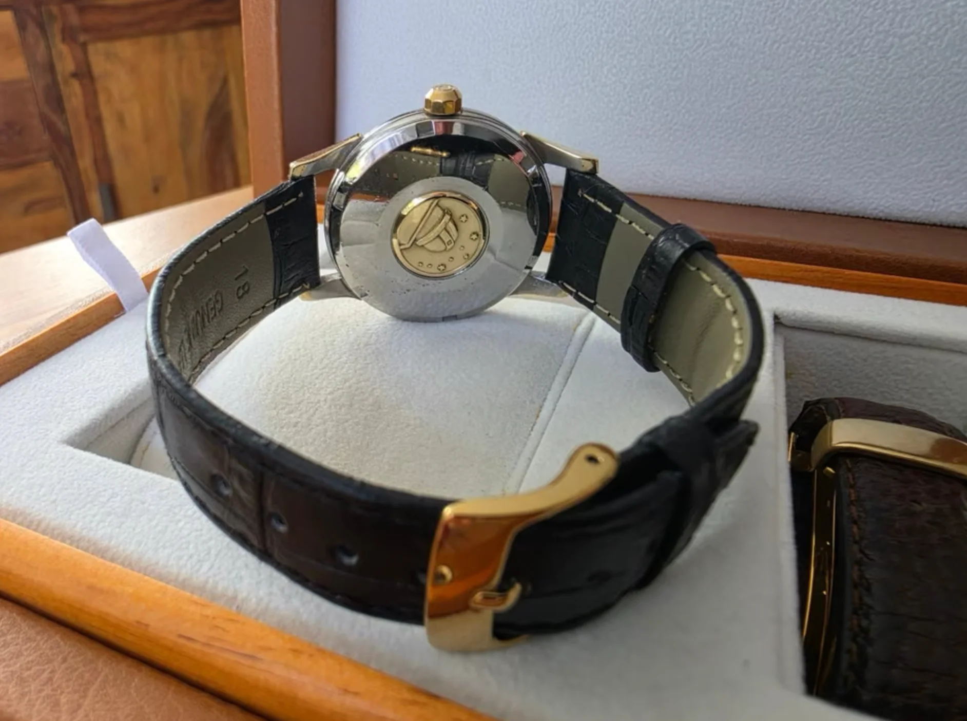

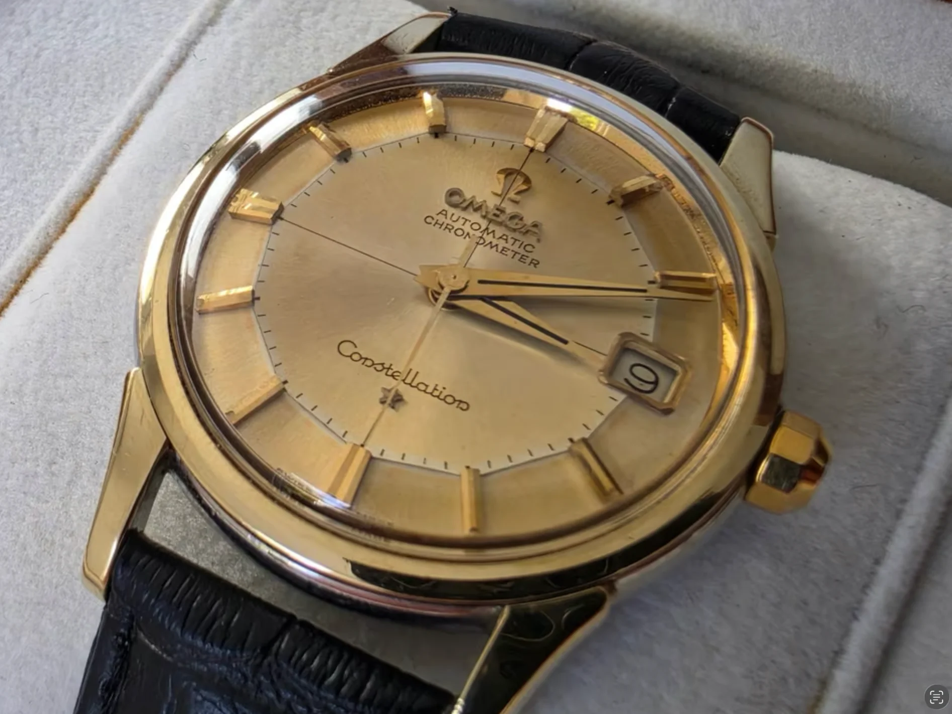

See the photos from someone that seem the sell multiples watches and coins online. I'm yet to confirm with that person whether he's selling the watch through a dedicated company but it seems like he has the equipments and has some knowledge.

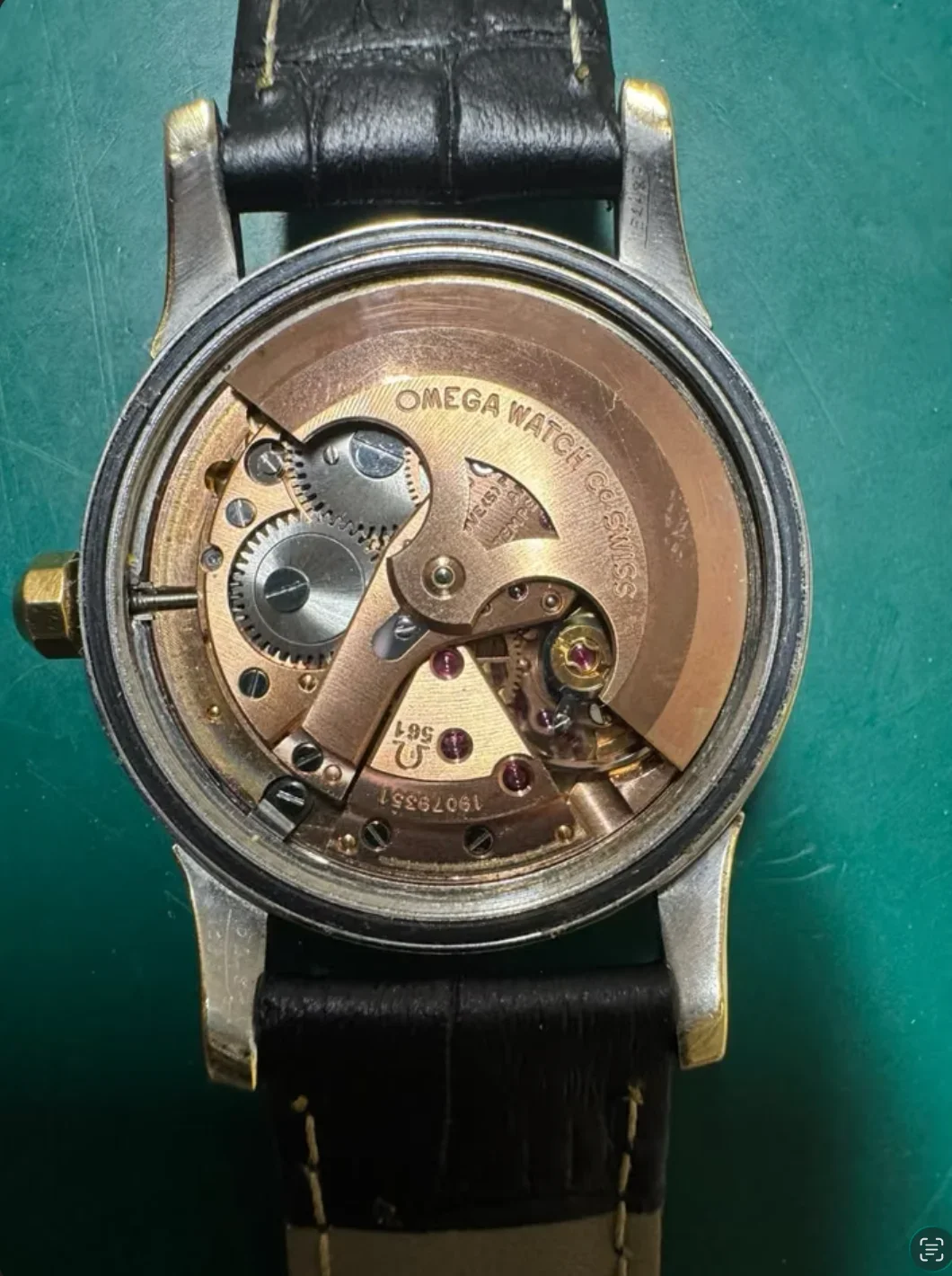

  • ref. 14393-61 SC, calibre 561
  • serviced in October 2026 apparently
Thanks for your input!
13,650
19,016

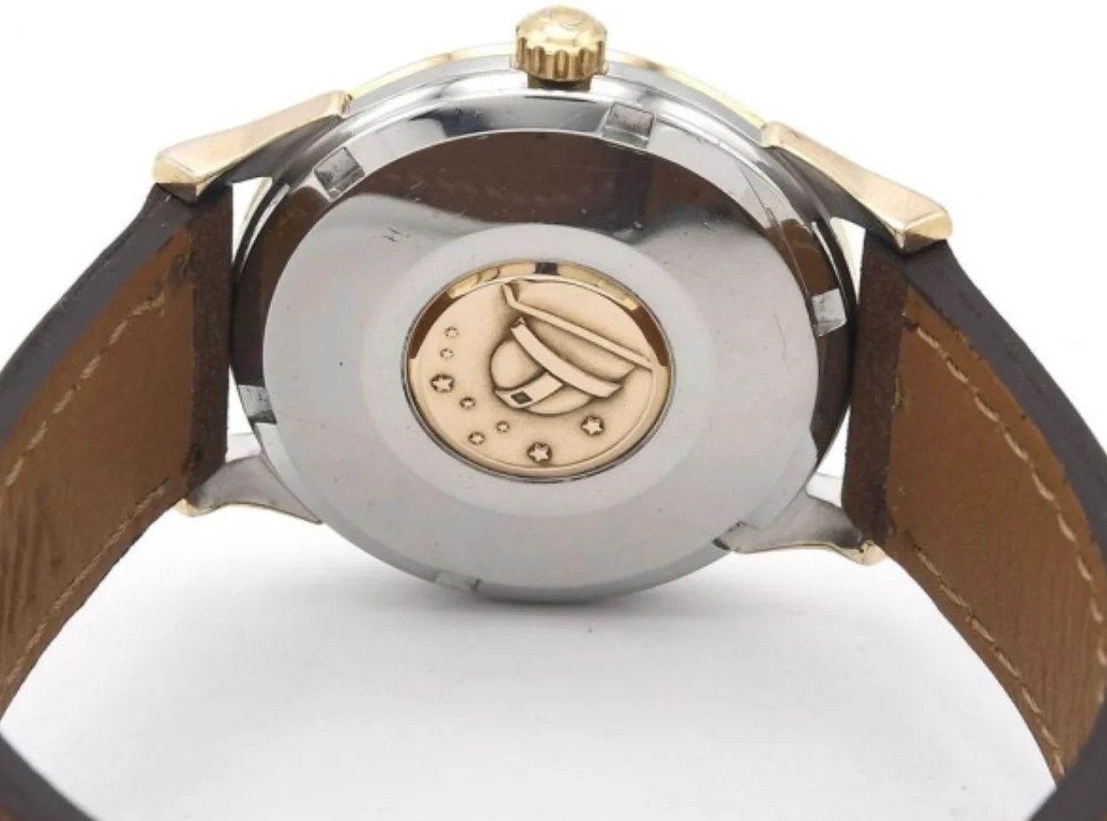

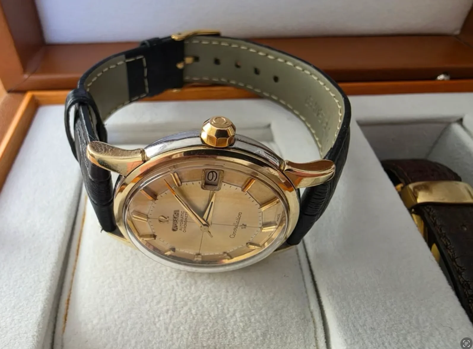

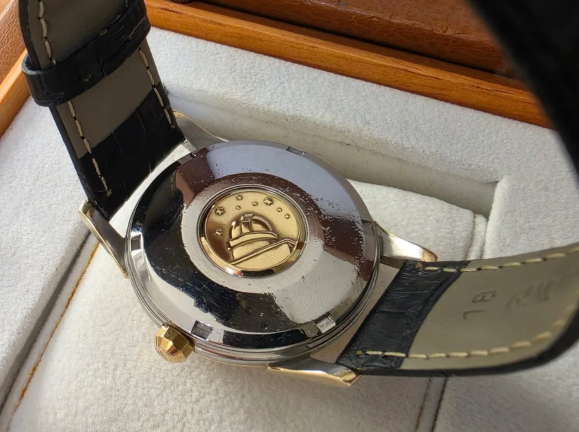

Here’s a few things I can tell you:
1. Watch dates from around 1962.
2. Dial looks original, but should be off-white, not yellowed. This is likely natural aging of lacquer in the presence of some environmental factor. Maybe nicotine from cigarette smoke. Some people like it, some don’t.
3. Crown is incorrect. It should be 10-sided like that one, but much thinner.

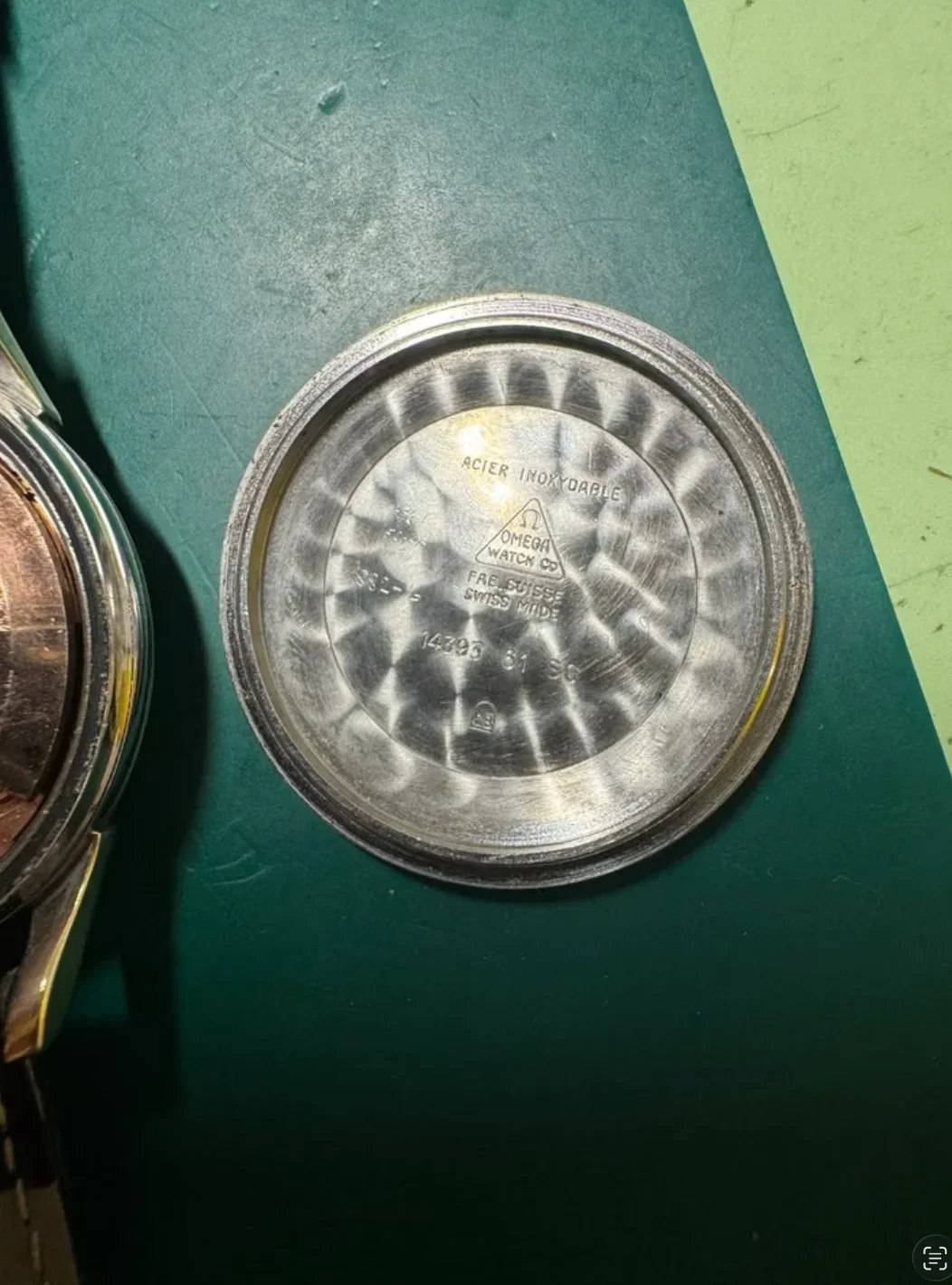

4. The case has been pretty heavily polished. You can see the sharp edges of the watch have been rounded. You can also see the remnant of pitting on the back. Whoever did this either covered up the gold medallion or had it replaced. That looks nicer than the rest of the case.
All this adds up to a very presentable vintage Omega which is not worth top dollar.
gatorcpa
4

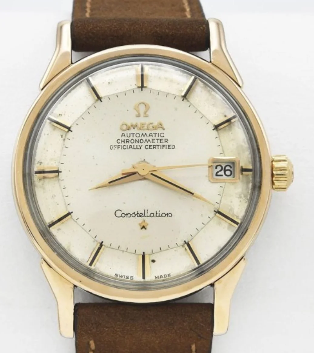

Thank you so much! It's currently being listed at 2500€. Would that meet the conditions for being a top dollar watch?

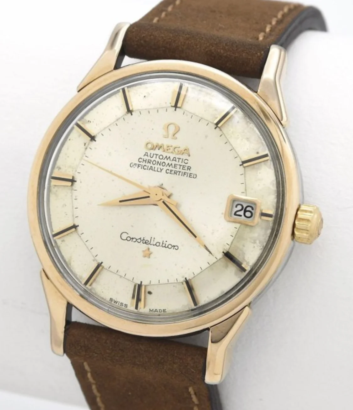

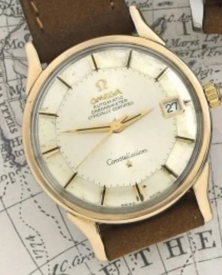

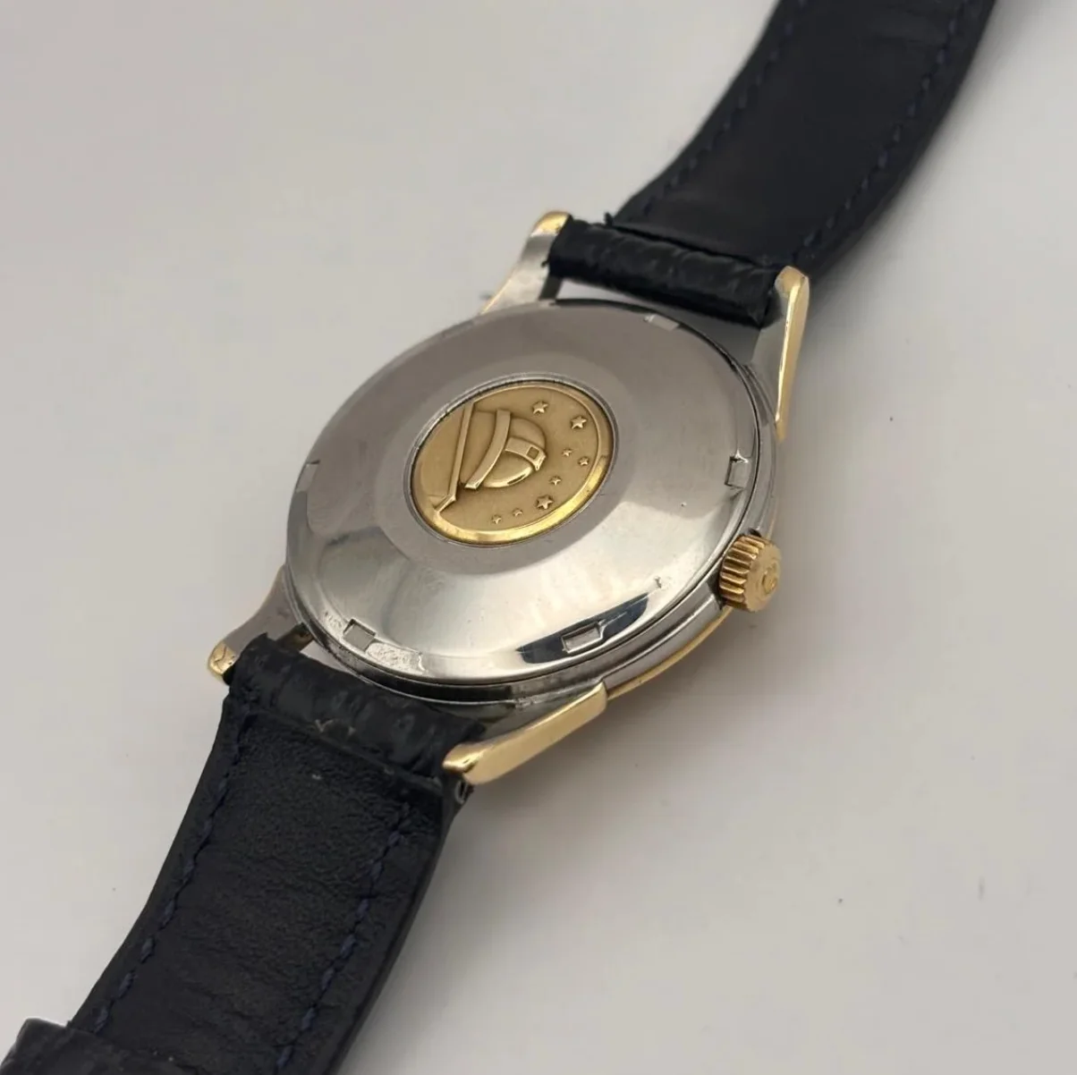

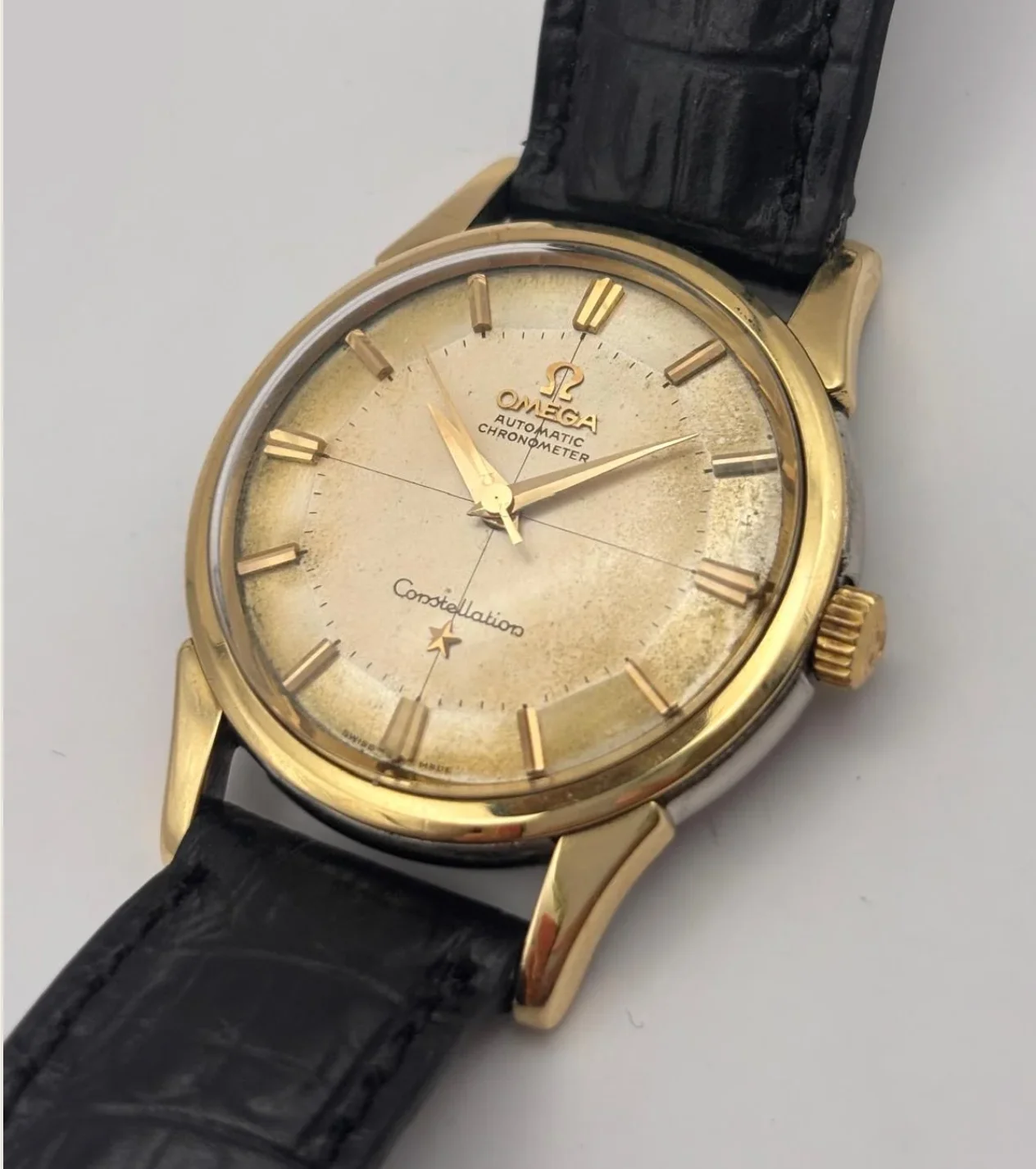

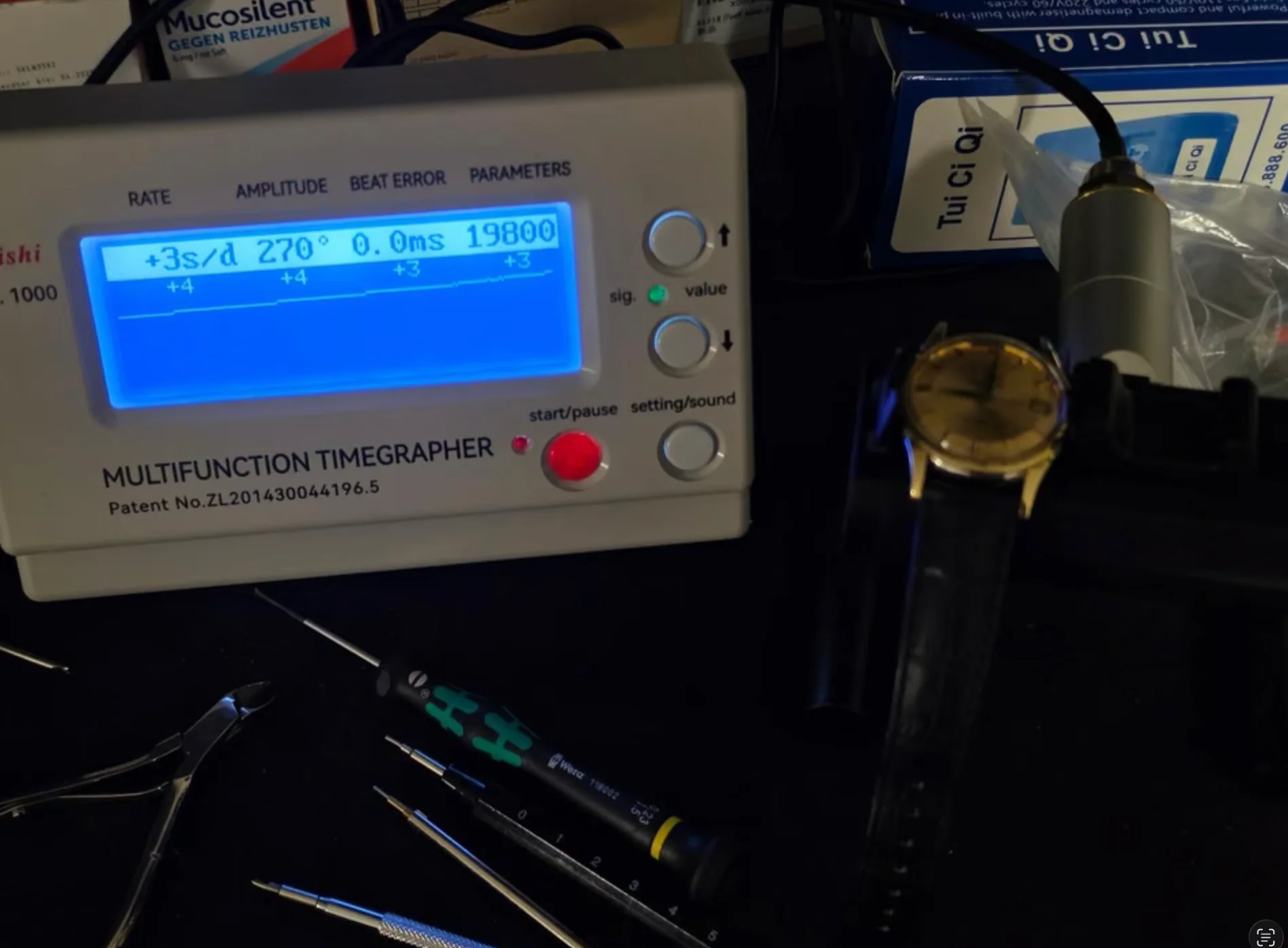

Find below a similar watch that I've found, for 100€ less. Would you be able to help me out with this one as well? Thanks again! This one is sold by a professional, it seems.
4

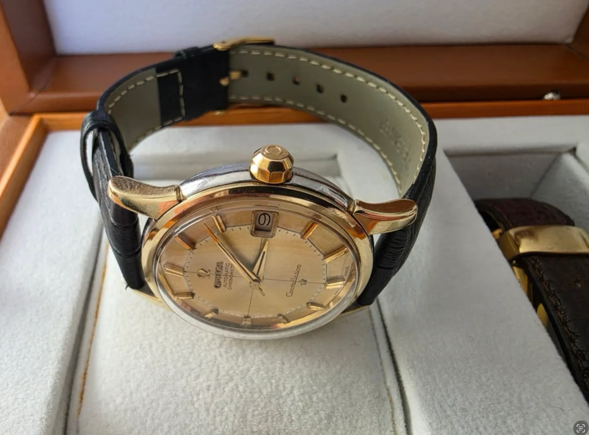

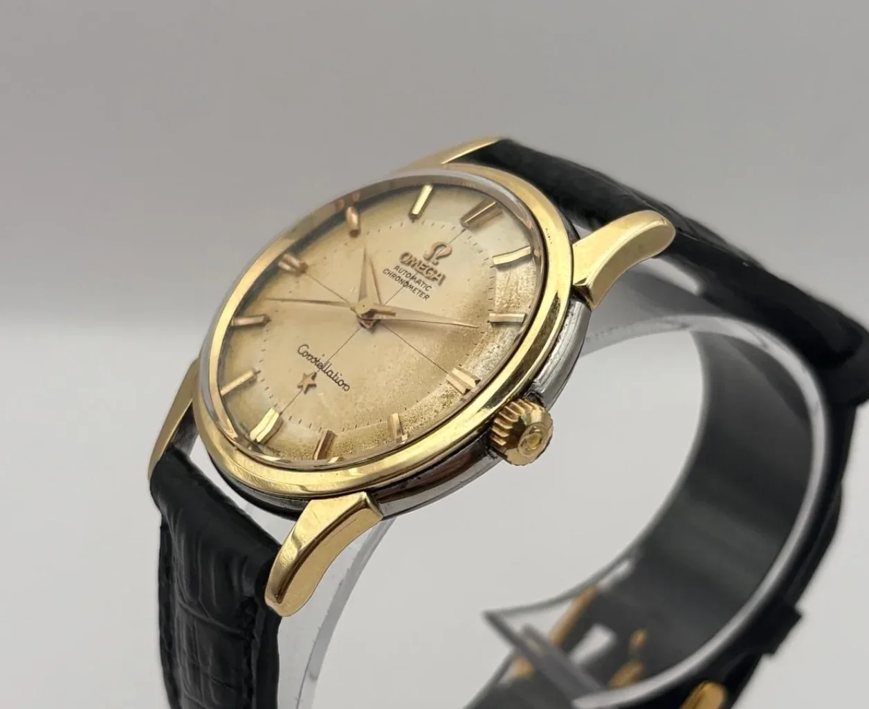

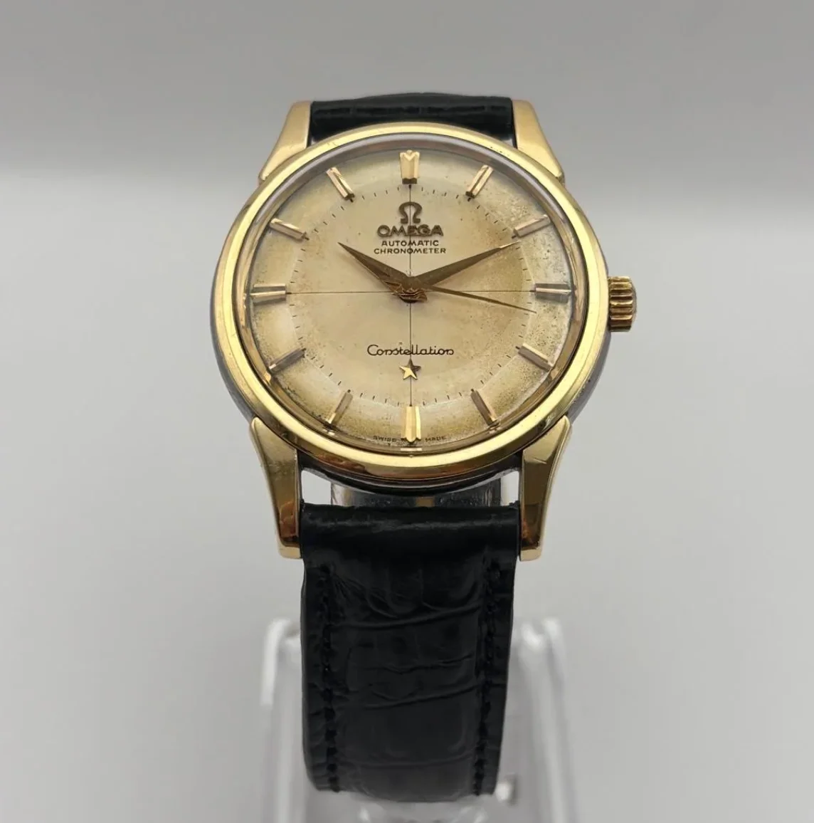

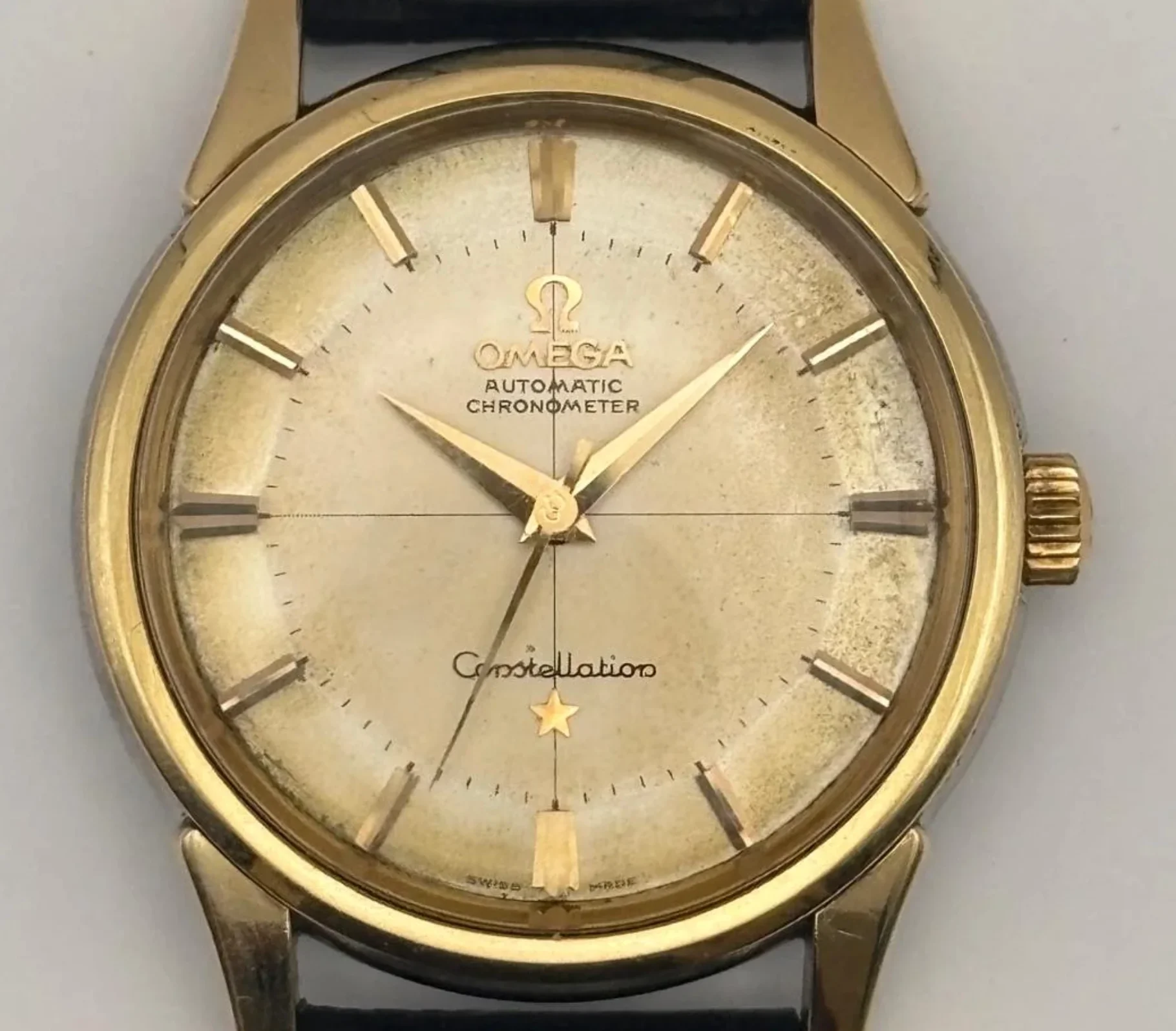

How about this one at 1500€?
Apparently it's 100% original, a pro is selling it - just got off the phone with him.
He couldn't provide me the Accuracy and Amplitude although he mentioned that they have been serviced. I can also insist on getting the info if this is important to know?
8,855
62,725
severe water damage at some point......and the pix are manipulated to mask that damage and discoloration....plus wrong crown completely.

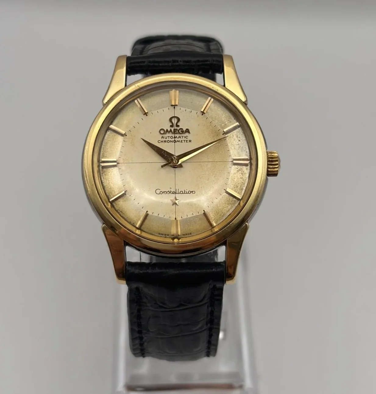

Wanting a pie pan is an admirable endeavour but you also need to decide on your threshold for condition.
You also need to decide on the style of Constellation that you are after and focus your efforts on that.
The first two watches you show are late lyre lug models ( both quite heavily polished) and the third a very heavily polished dogleg reference.
The dial degradation on the 2nd and 3rd make them particularly unattractive.
1,618
6,062
Plus overpolishing.

The hour and minute hands are also wrong on the first one, being too long.
