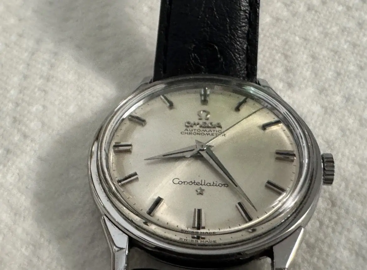

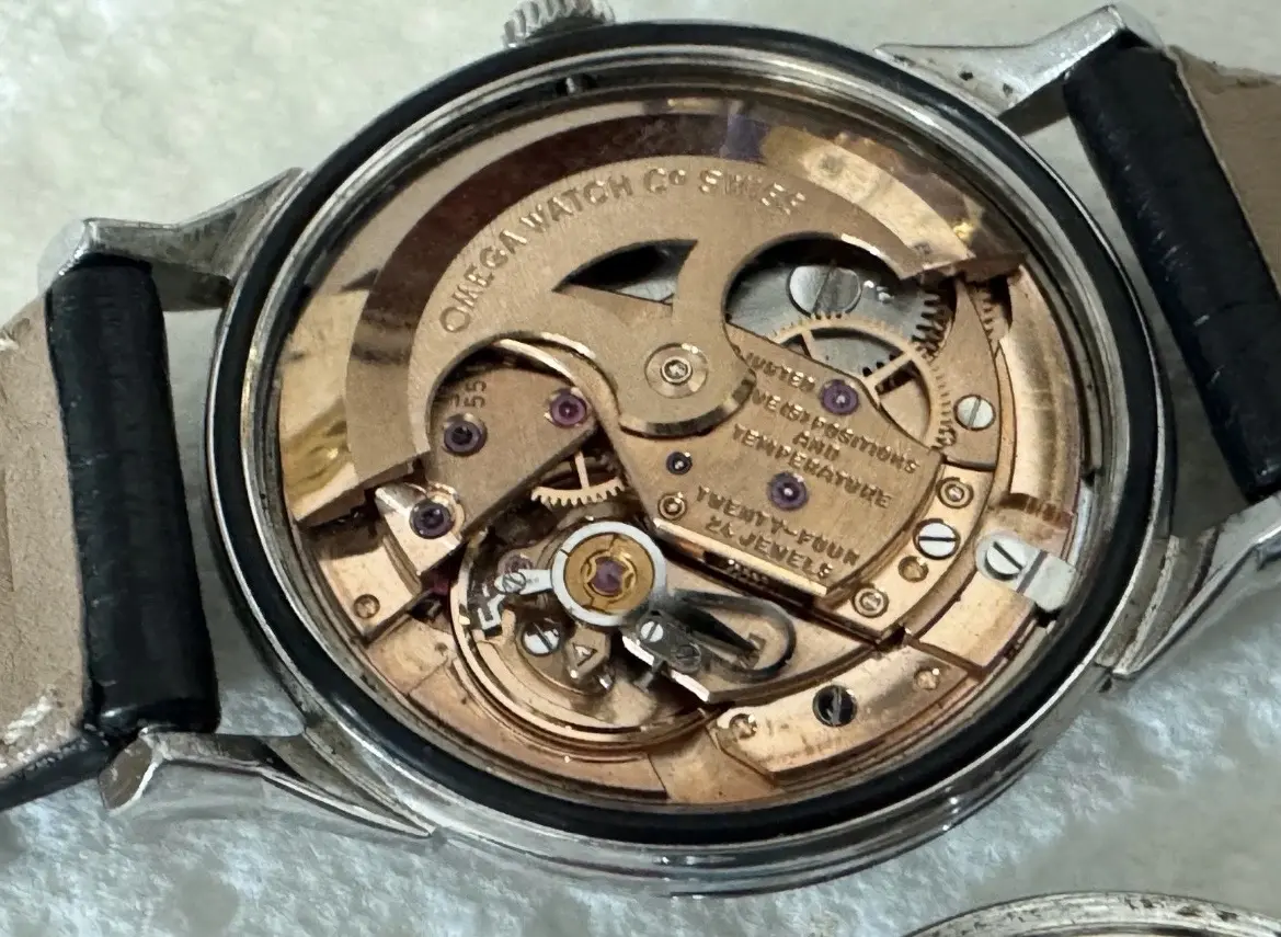

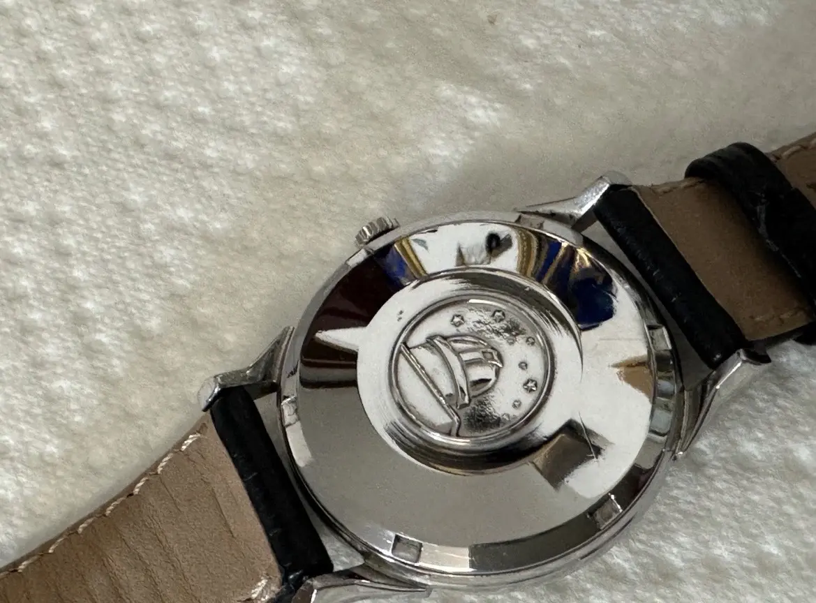

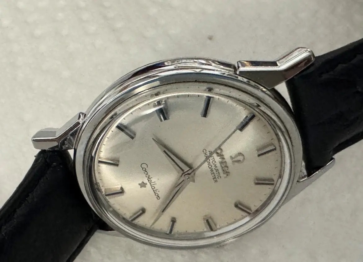

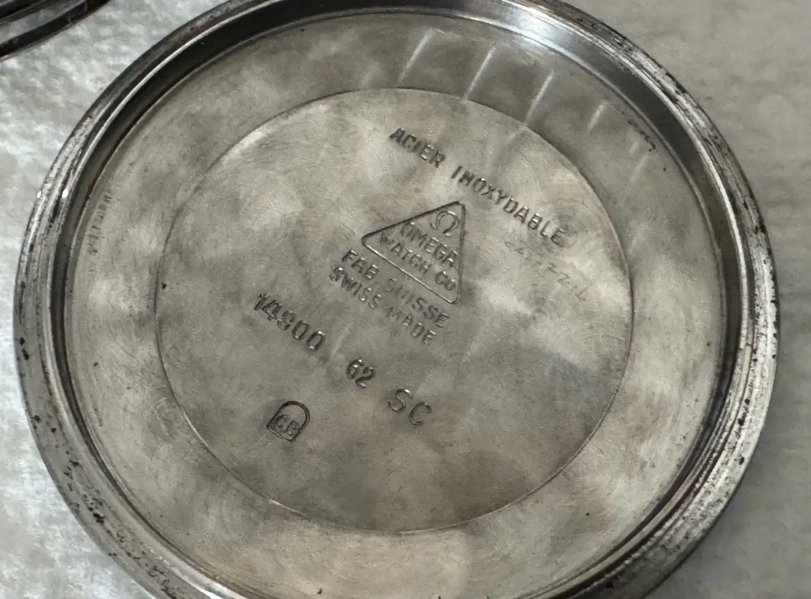

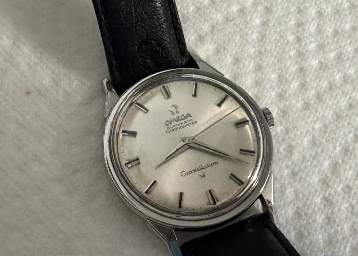

Opinions about this Constellation? I have no idea what to look for.
6

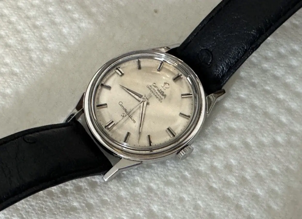

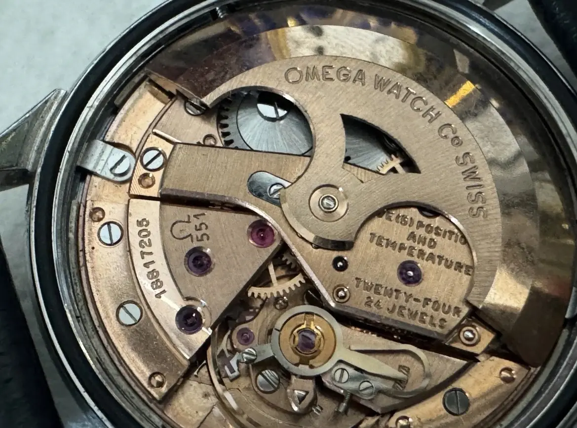

Hello there! Could anyone help me to understand if this constellation is authentic and worth its price? I'm new to vintage watches in general, but I love the design of the Constellation and I'm in the market for a new dress watch. I like the sharp lugs, so I'd really love to get one.
Seller is asking for around $900 and that seems pretty alright after the research I was able to do. But I wasn't able to match a few numbers shown to other numbers. In all honesty I have no idea what I'm doing.
Any help is appreciated a lot.

Can you upload a better photo of the dial.

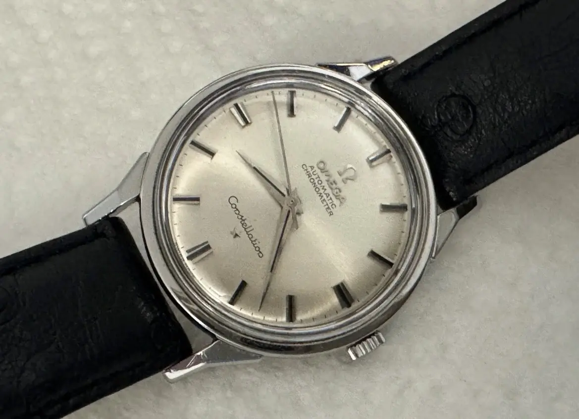

Here are more, but I have no idea if these are better to draw a conclusion.
Thank you for trying to help!

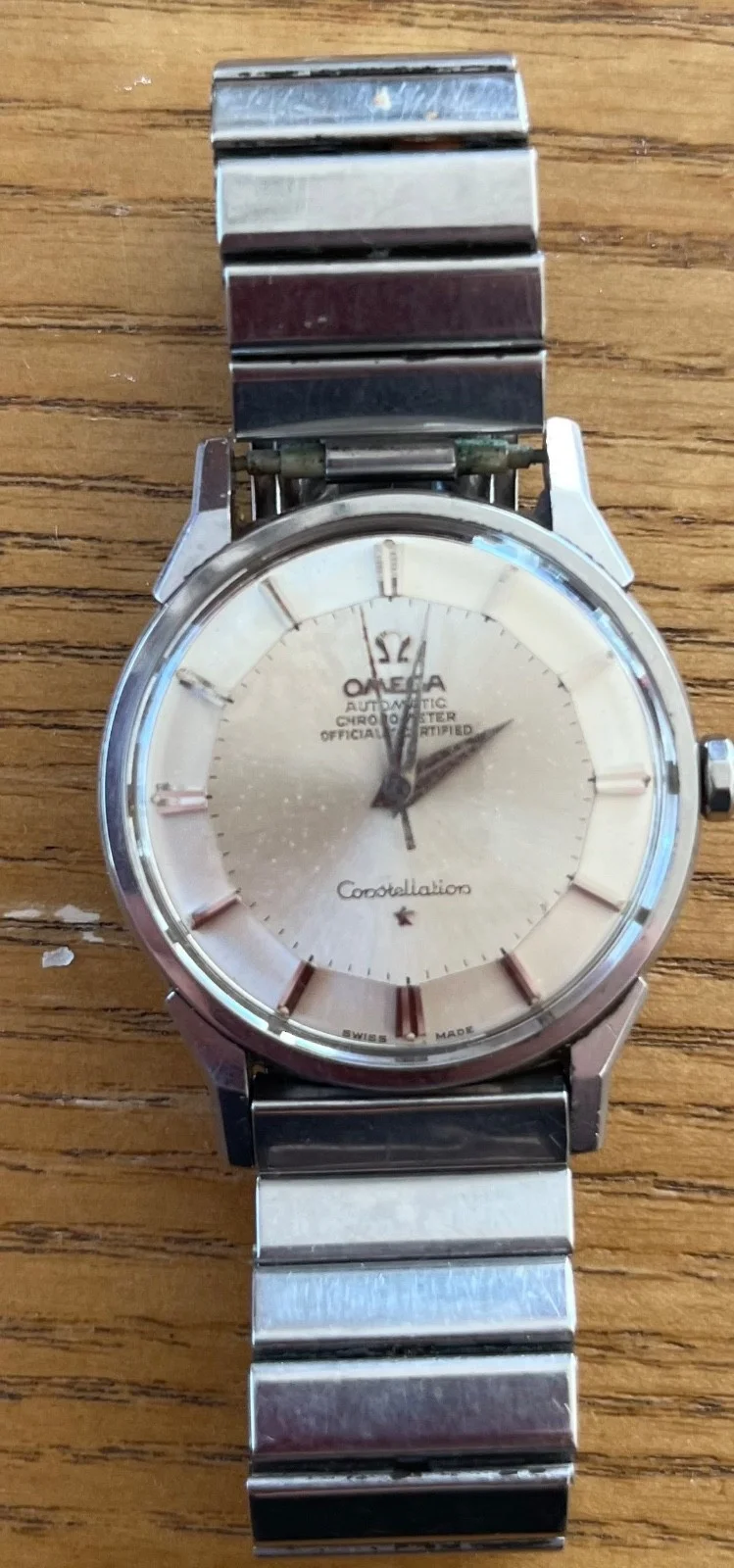

Here's one to check against.
That's a different watch. 😕 The dial doesn't match. Is there a chance the backplate was swapped?
It's the same reference with a different dial variation. There are many variants for most references.
Sorry, the photos are just not good enough for me to give an opinion.

Case is definitely massively over polished dial looks ok from the pics but @Dan S is right. Need better quality pics to say for certain

I have requested better pictures. Thank you for trying, Dan!

One quick question if you don't mind. Is the different crown a variant aswell?

The case on this watch has been so polished that it has lost its purpose as a dogleg.
The crown is not a constellation crown.
A good condition dome dial dogleg is a thing of beauty but I would pass on this unless you can’t afford anything better.
There are good resources readily available here to provide basic knowledge. Until you have studied vintage Constellations more you really should not be considering buying one yet.

Great links above. The more you know the richer you’re buying experience, and the more likely you'll be satisfied with your informed choice. This would not be the one for me.
Collectors would gasp at the extent of polishing all over the case and lugs. The uninitiated might just consider it very shiny. To me it looks like it was polished 8 times for good luck, dipped in butter, polished some more, and then slathered in bacon grease.

Understood. Resisting the urge for now. I'm already reading through the links and compare various listings, trying to check for signs of authenticity. It's more difficult than I thought.
I'll still post the higher resolution pictures whenever I receive them to learn something from your takes on the dial.
