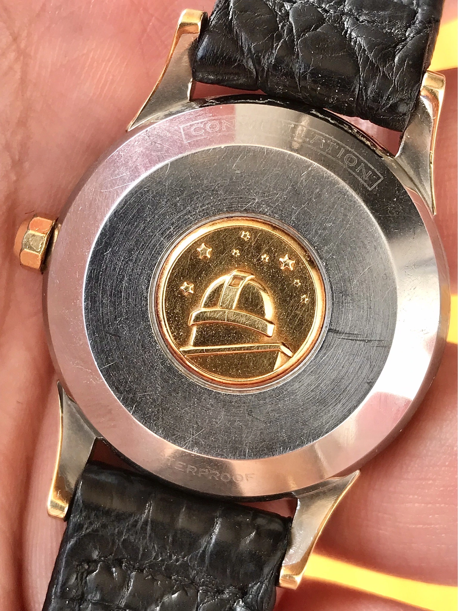

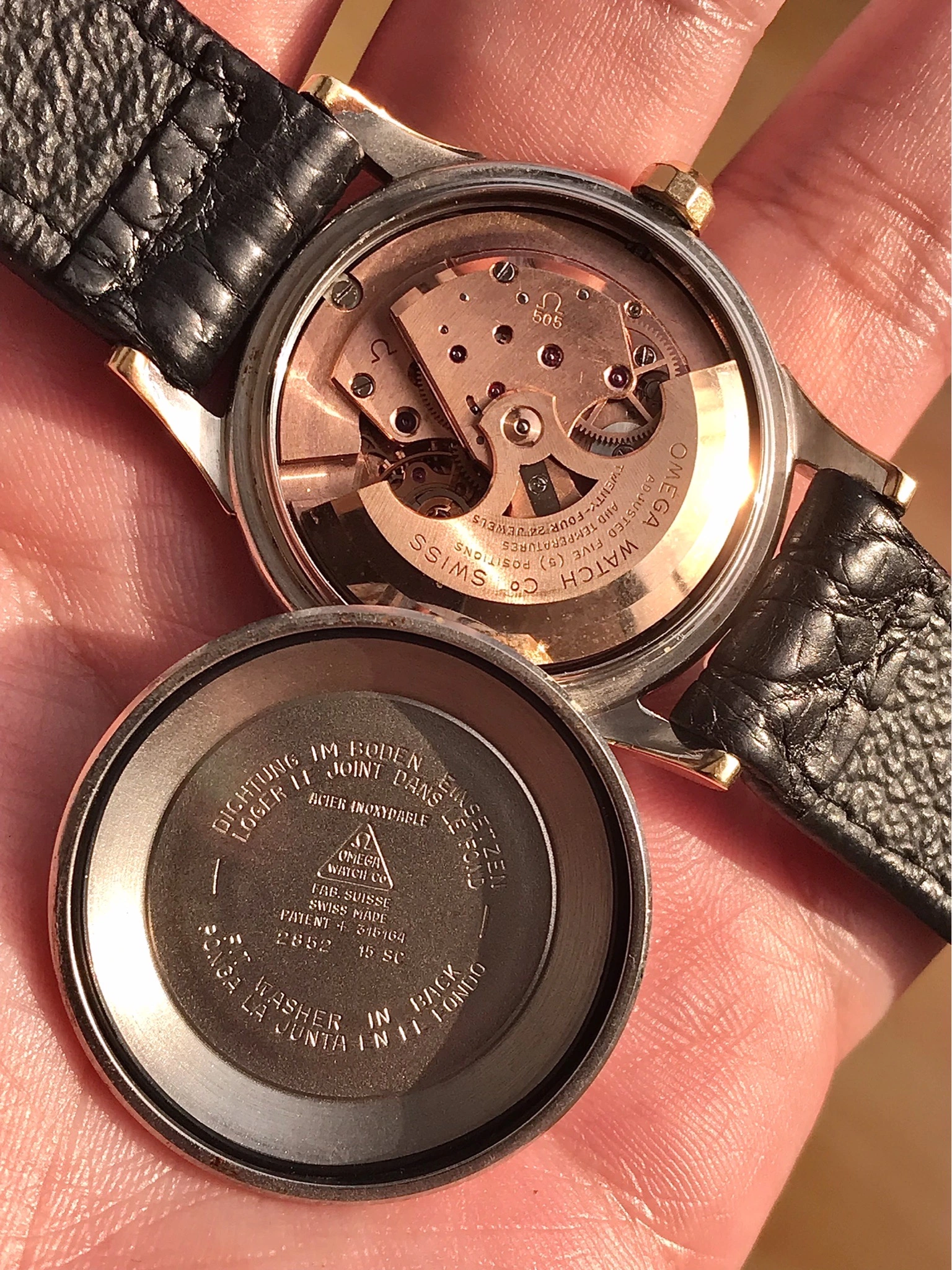

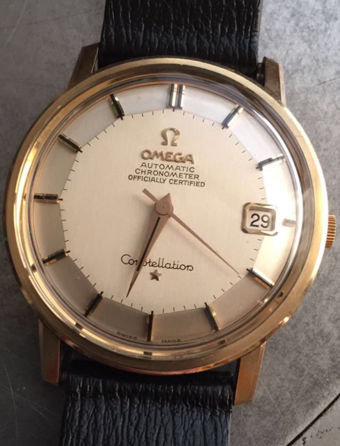

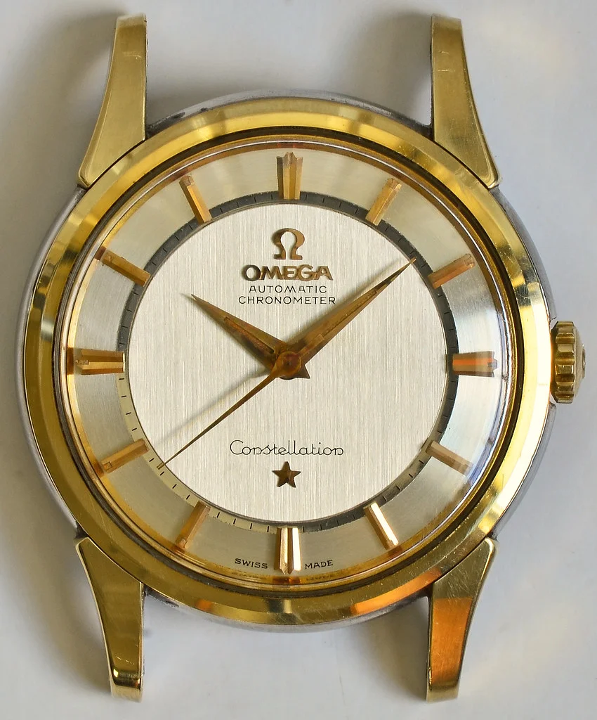

Hello, Omega lovers. I'm just into Omega vintage, and considering getting one. I've found this Constellation pie pan 2852 in two tone, which to my little experience, I think it's in very good condition.
The seller has high reputation, says all parts are original, and ask for $1,900. With many advices to buy from trusted sellers, I almost pull the trigger. Until I spot somethings in other watches of the seller, which makes me believe the seller, even with their honest intention, may not know about Omega vintage well enough. I see an Omega Seamaster 168.002 & 166.028 that has "Chronometer" on the dial using 565 calibre, which from my research isn't chronometer calibre. Plus, I see a non-pie pan 168.004 has non-dauphine hands and non-hidden crown, which I believe every 168.004 pie pan or not has dauphine hands and hidden crown. I may be wrong, but they make me more cautious about this 2852 pie pan.
With the cases stated above, I try to look at the 2852 more closely but I still can't decide if the watch is truly original. I'm doubt the hands that have color differ from hour index, and a bit strange about the crown. However, I'm not sure if it's because of my overthinking. So I need help from more experience people in this community to share thoughts about which parts are replaced and if the price is justified. Again, the seller has high reputation and most of their watches are in very good condition. I'm just not sure if they know about Omega vintage well enough.
Thank you for any comments/thoughts. Feel free to correct me if I misunderstand something. I'm new and just want to learn more.
3,615
7,838
Dial looks original with nice arrowhead indices, some blister/spotting common with these, HM hands appear rose gold? Which suggest replacements. Crown replacement with later Omega logo. Movement correct. Some polishing not too bad imo. Price quite high
Thank you for your comment

Price is at least 2x what it's worth given the poor condition of the dial, IMO.
True this. When the watch like this is two tone the importance of having a nice, clean original dial is IMO more important than if the watch was in stainless steel or solid gold. These versions are already less desirable to begin with and are harder to find with the case in nice shape.
Good for you to ask first. It is very difficult to decide who is a “trusted seller” on the internet. As you point out both the honesty and the knowledge of the seller are unknown. Positive ratings are helpful but can be artificially inflated. The point is you need to have confidence in your own knowledge and assessment, and even then you are still at risk with unknown sellers.
For a new collector it is safer to buy from sellers in the Private Sales thread here on OF who are fellow collectors known on OF who care about their reputation.
Oh, I see. So, the dial condition comes before the original parts. Like, it’s better to have good condition dial with wrong hands or crown than poor dial condition with original hands and crown.
yes & no: ist depends on, if it s a field/diver/utility..-watch or a dress-watch.
Yes, generally that’s correct for these type of references.
Originality doesn’t always mean that all parts were sold with the watch 70 years ago. Crowns, crystals etc. were/are often parts that get changed. And that’s not an issue. Original parts can still be found, at some expense, and fitted so that it looks similar to when it left the factory. The same applies to hands, which can also be sourced. So you can somehow fix minor originality issues in a way that is totally legit.
But dial and case are more complex and because they widely play into the appeal of a watch, it’s important to get them right.
A damaged dial cannot be restored to look clean, a polished case cannot get its chamfers back. These are the most important parts to get original AND in the highest condition possible.
Otherwise you start going down the route of trying to find the same reference to find a donor dial or case and you end up buying the watch 2-3 times.
Having said that, this is a forum where people are collecting watches, so there is also a balance to find. Not every watch has to be perfect, but if it’s not, you want it to at least be fairly priced.

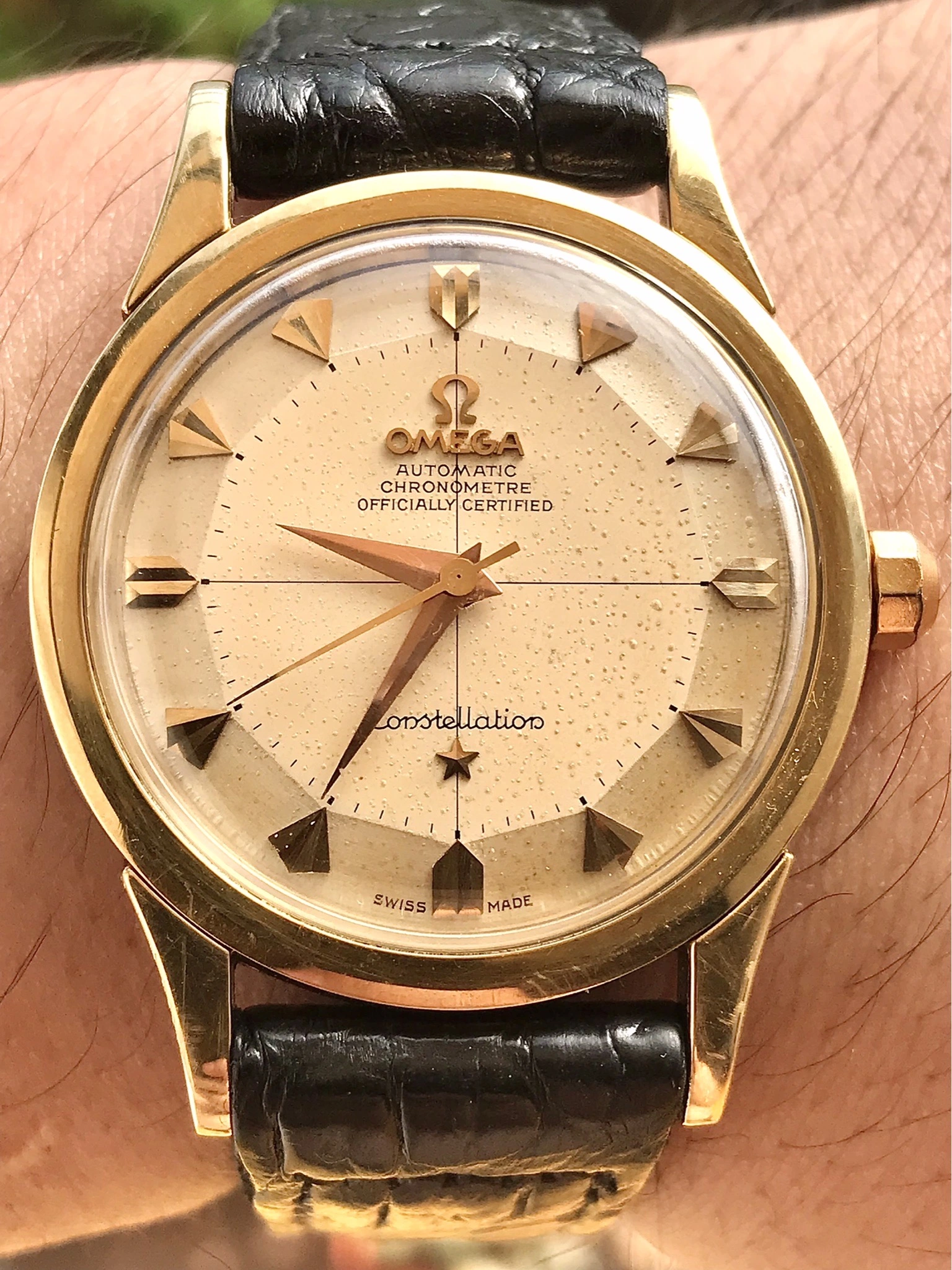

This is not the same watch, it also has condition issues but the price is more than half. And it’s sold by an established member.
Thank you very much for your kind explanation.
Thank you. The text below Omega logo looks strange but I don't know if it's because of damage. How do you think of the dial condition overall?

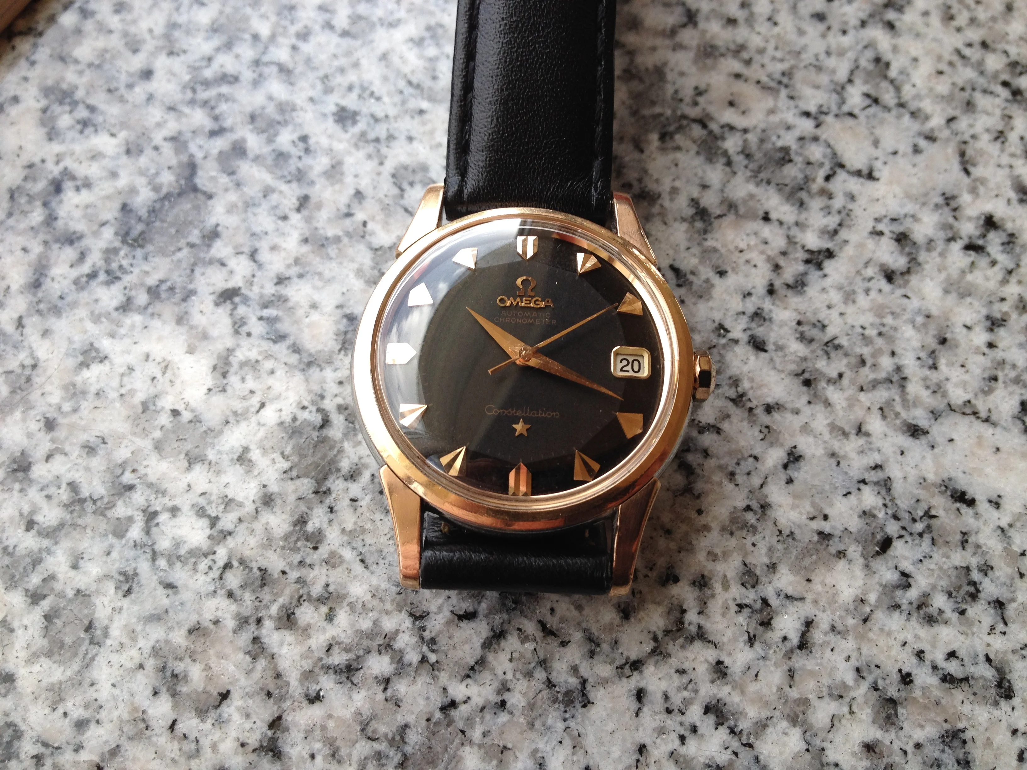

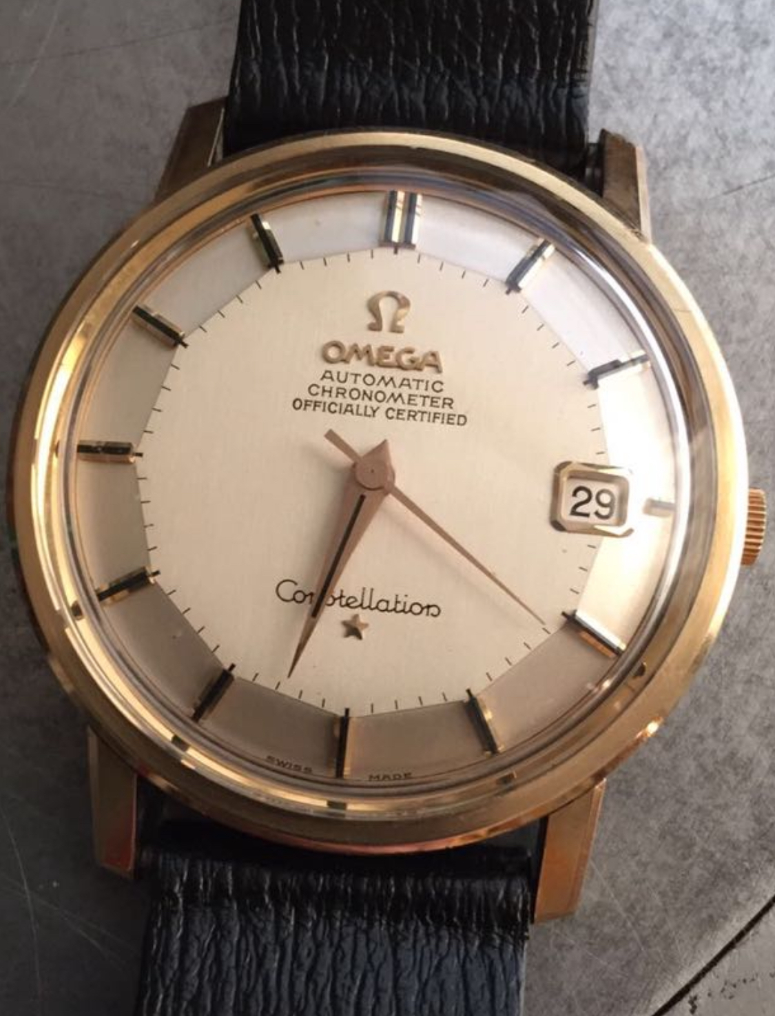

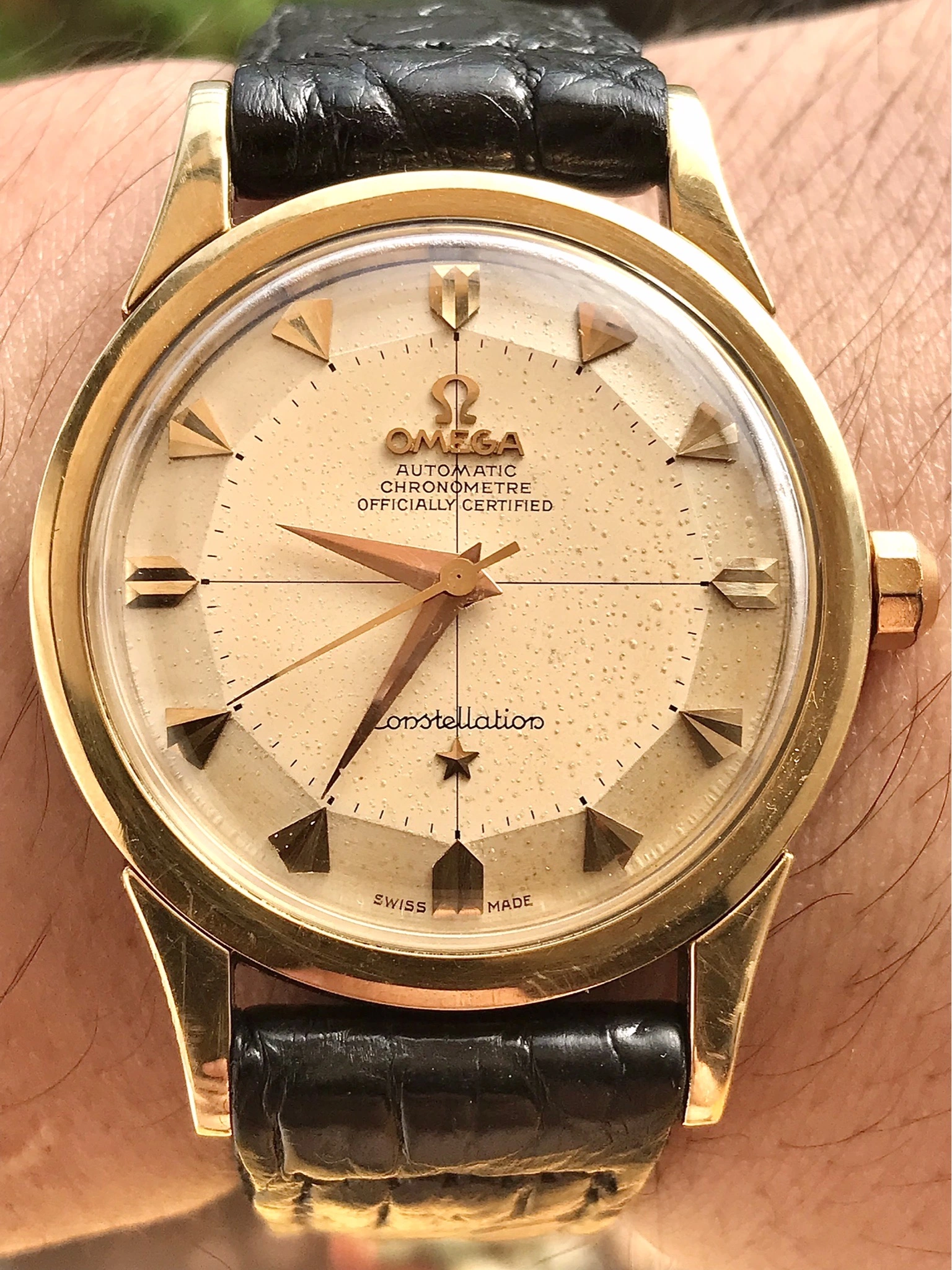

Like many here a gold cap connie is my least favorite case to get. I do have a few that I make exceptions for and as an example this is one I got because the dial was both uncommon and in nice original shape.

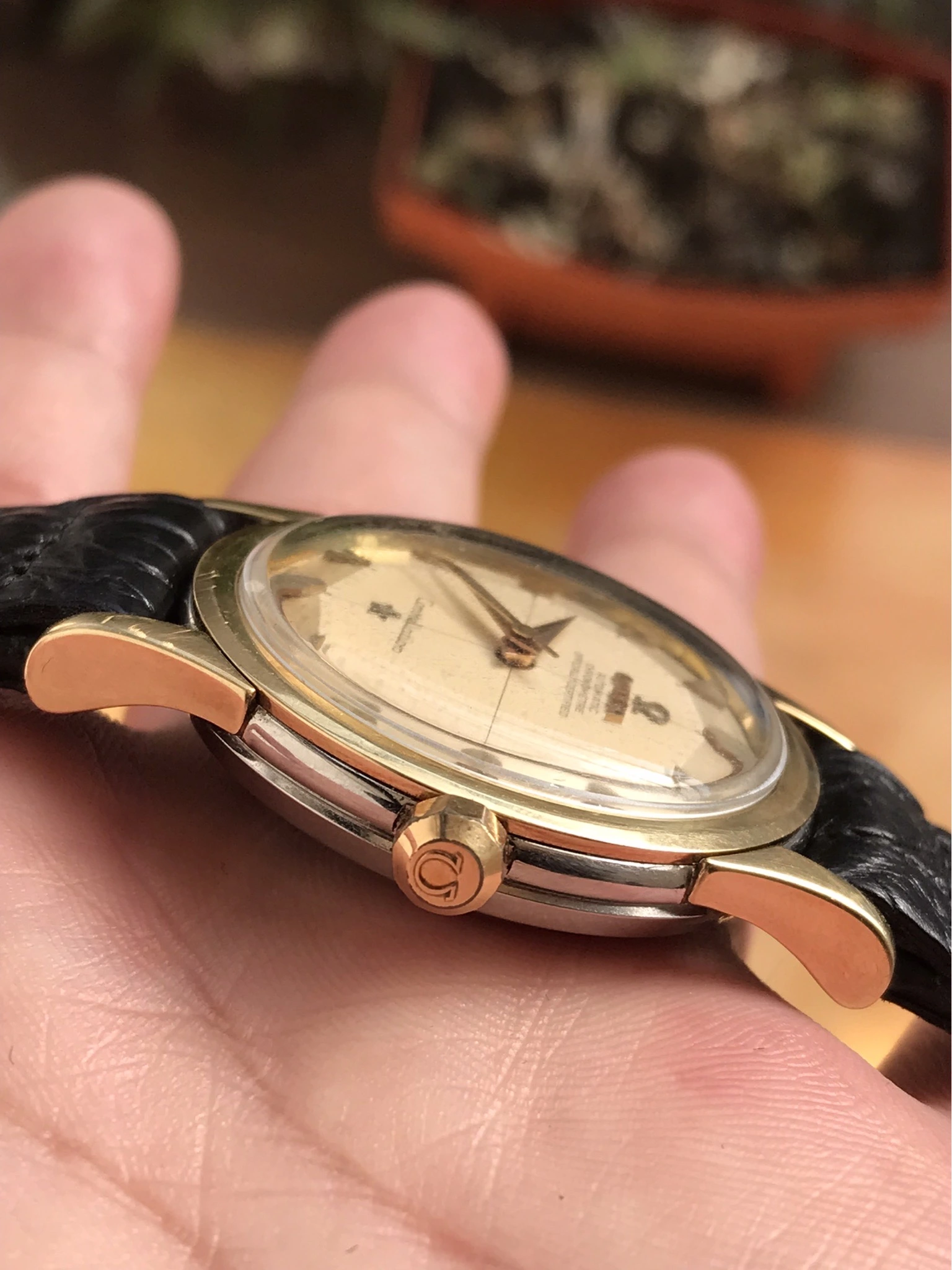

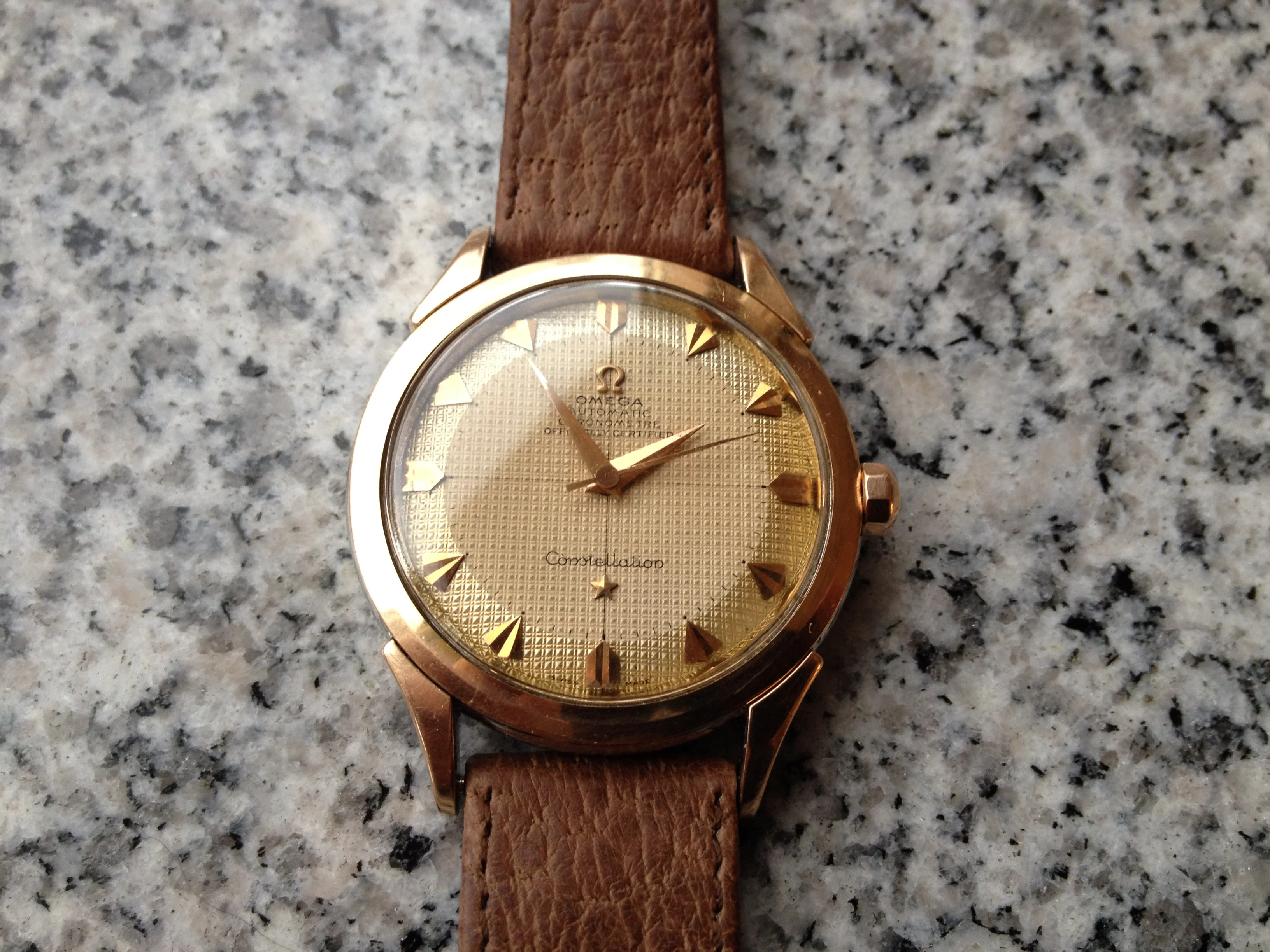

I don't mind capped watches if the rest is special enough. Here's my two examples (both rose gold):
