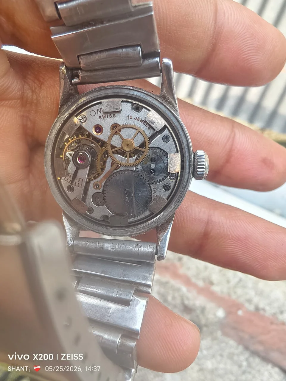

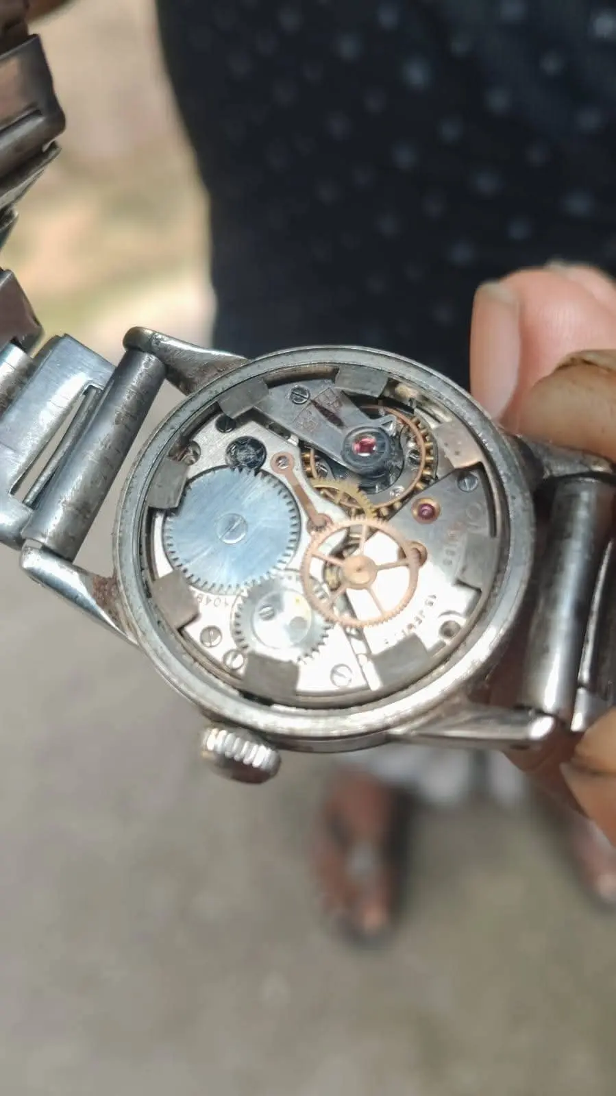

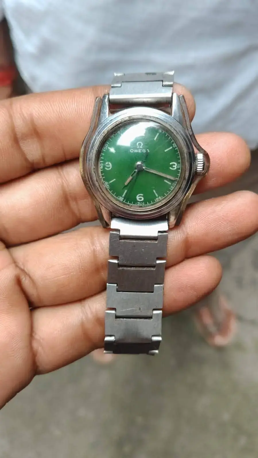

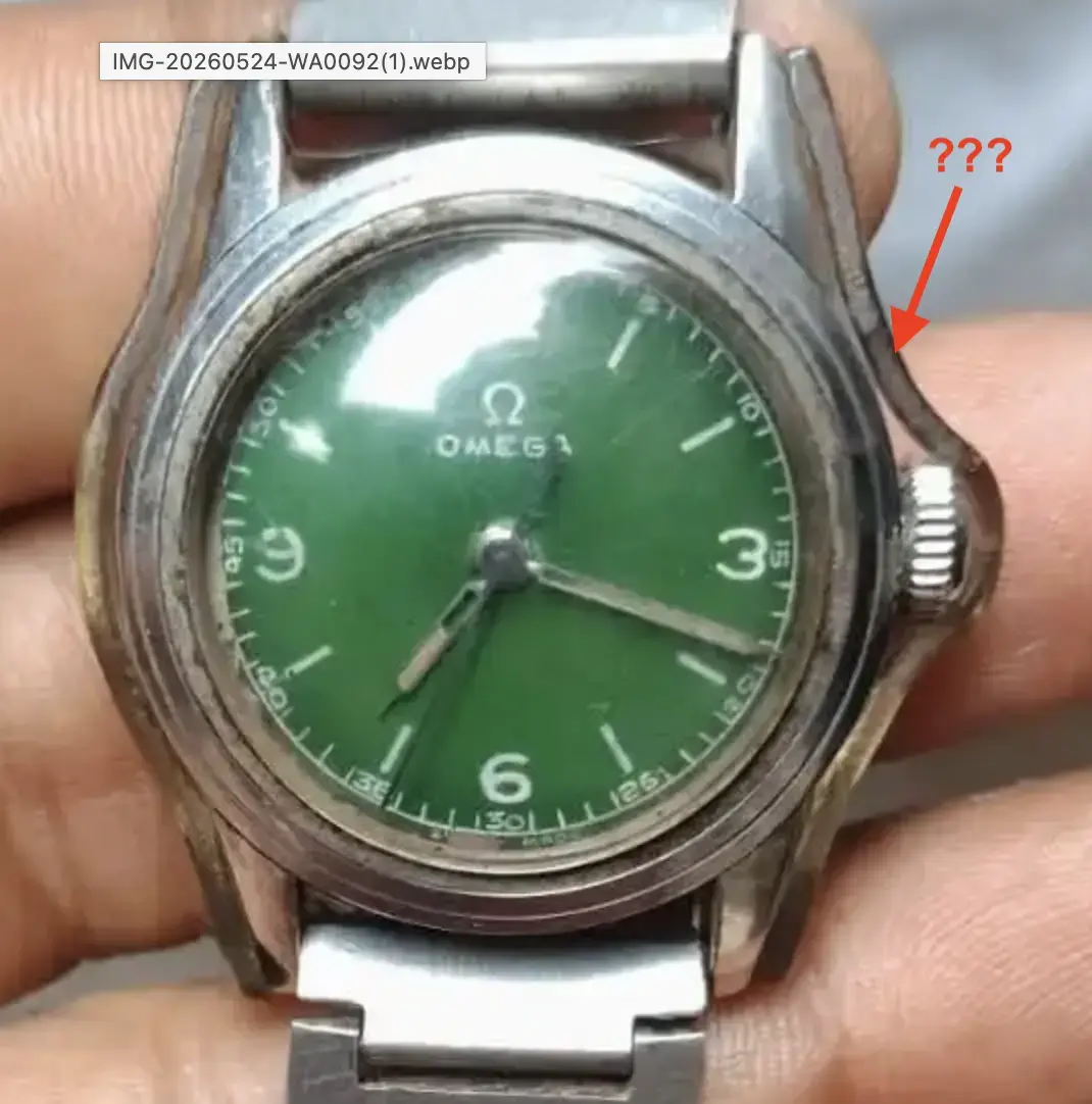

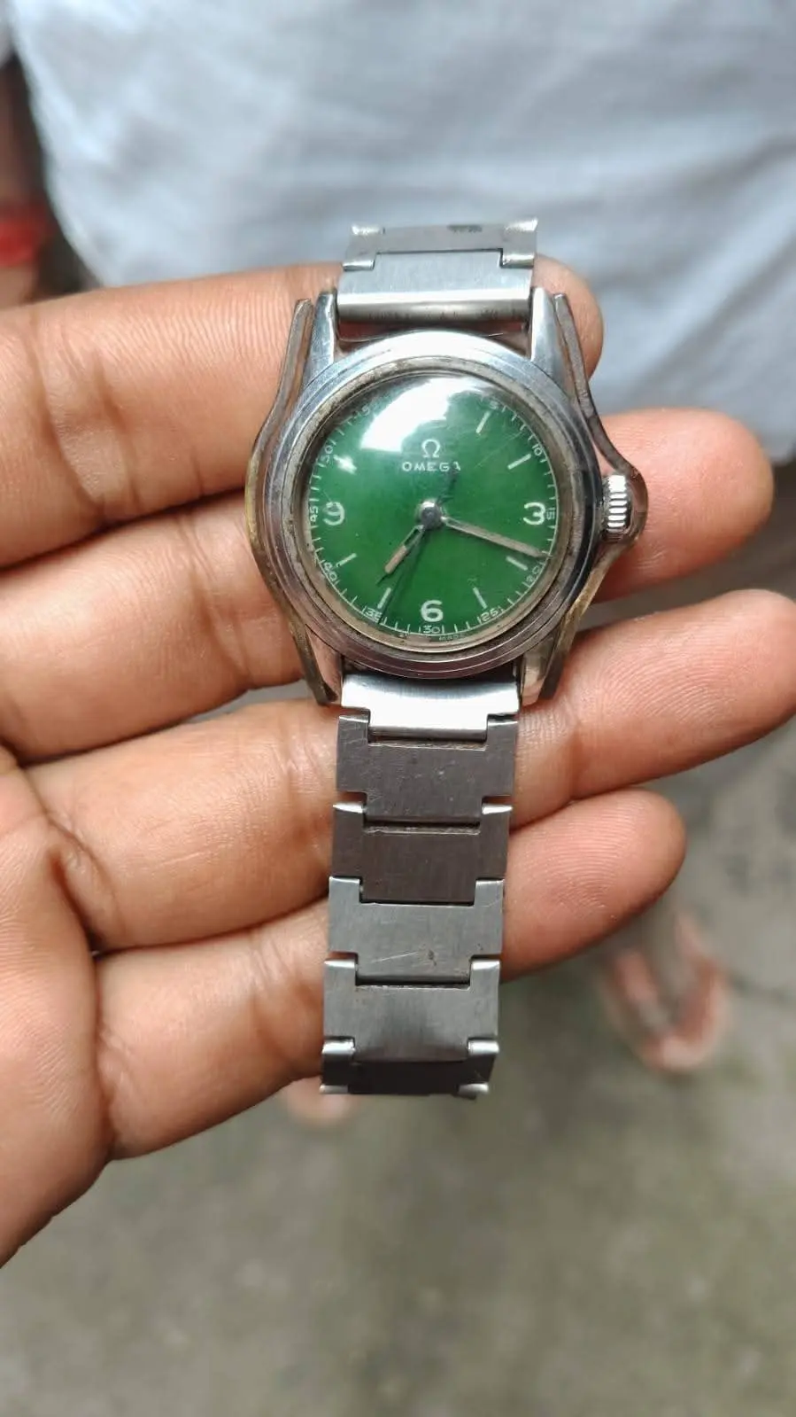

Hello everyone,
I am a young watch enthusiast.
I have been collecting vintage watches as my Hobby.
I love it as I feel like a humanoid collecting curios that measure the advancement of time.
Now, coming to the point. I got a watch from my friend. He needs to check if this is a frankenwatch or the genuine model.
I feel it is a frankenwatch but would like your expert opinion.
Would appreciate any feedback.
Thank you

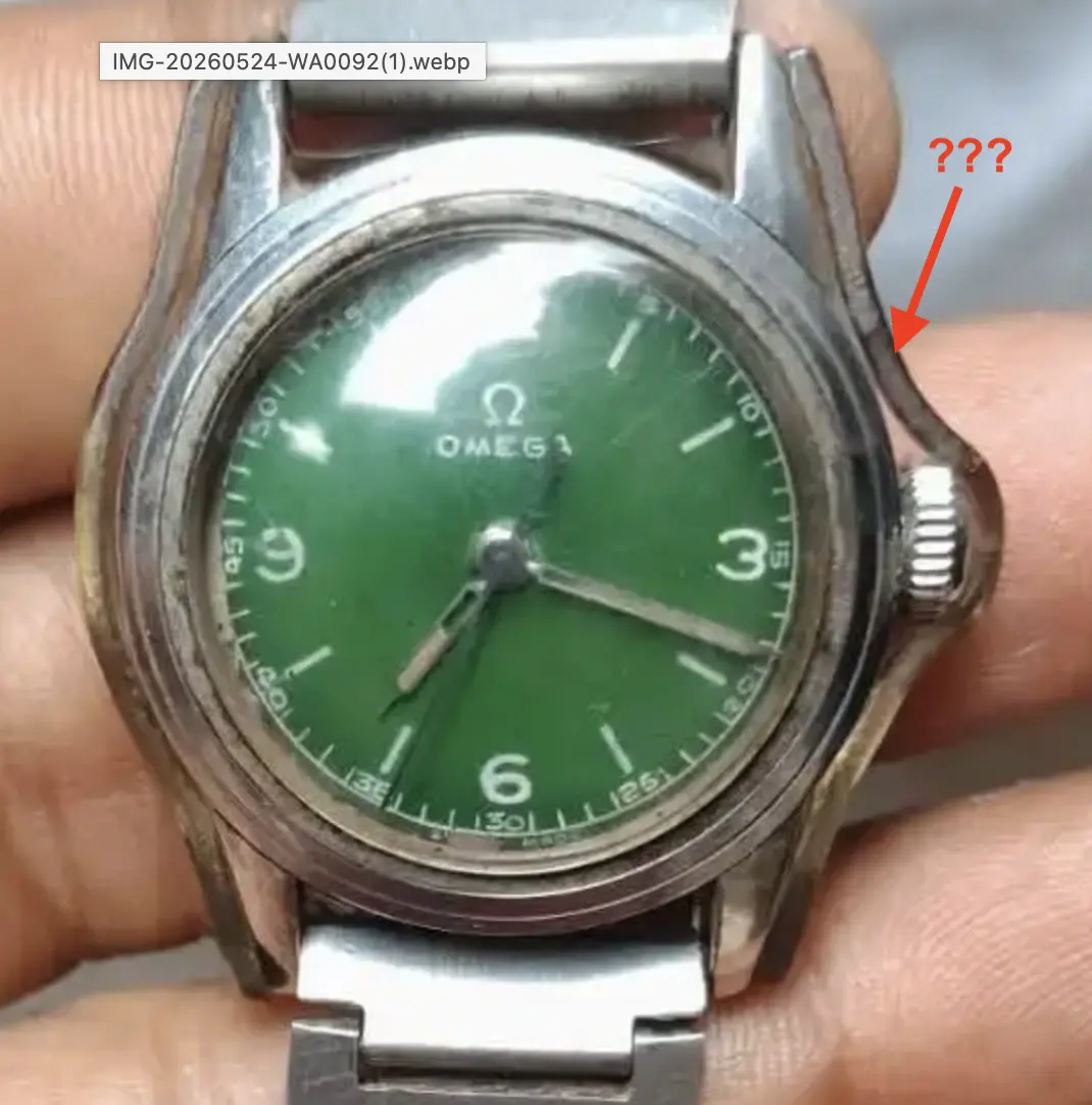

Fantasy dial, and I've never seen a Omega case designed like this.
Thank you for the comment. I have scourged online for how it would look and everything points to the fact that the dial is fake. However, no one confirms it. I believe the movement is original though not sure.

18,128
37,833
The movement is original, but not a 30T2. Probably a 23.4SC.
The 23.4SC was the first Omega caliber with centre seconds and was released in 1936. The serial nmber of the movement dates to about 1945/1946.

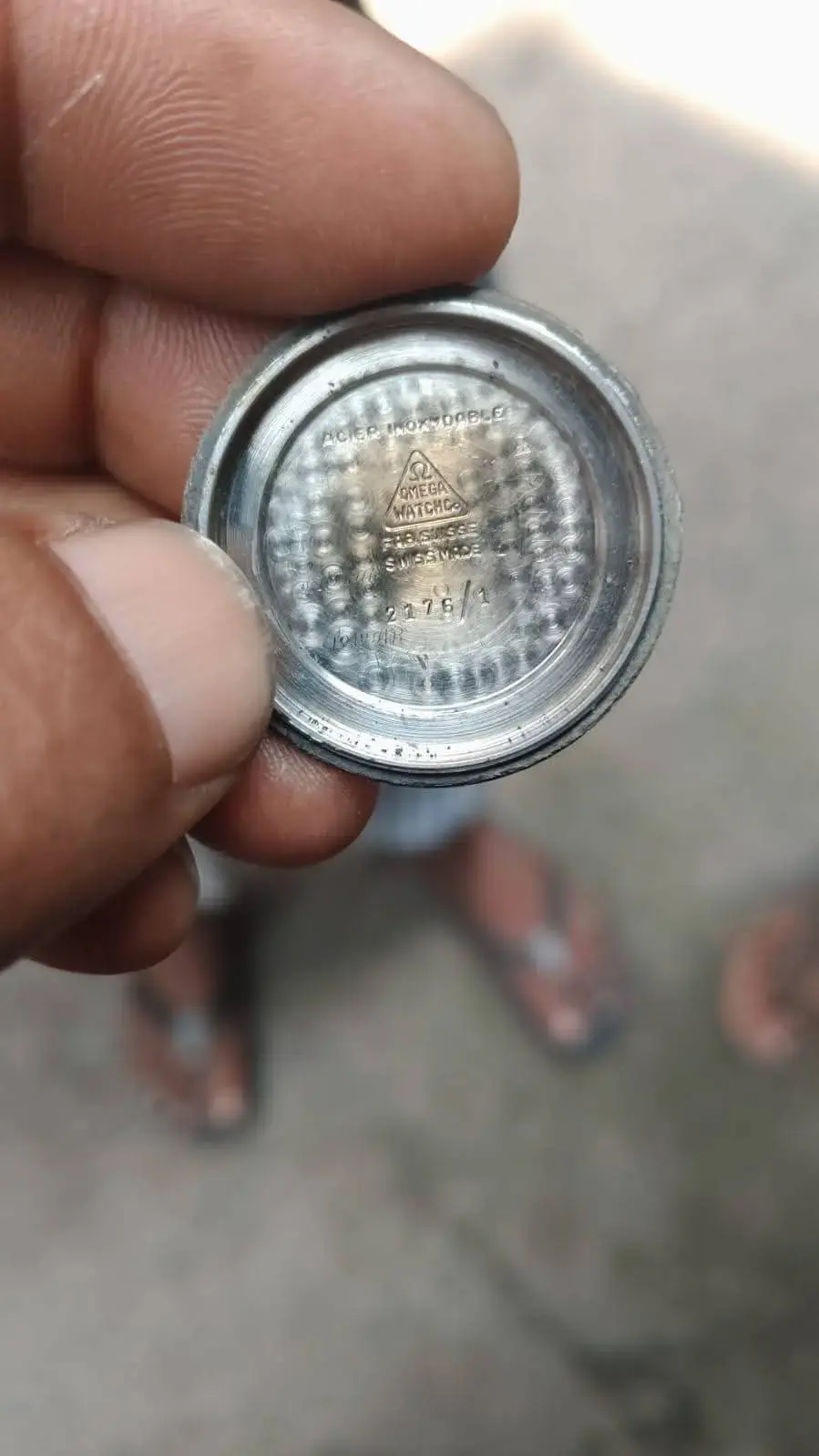

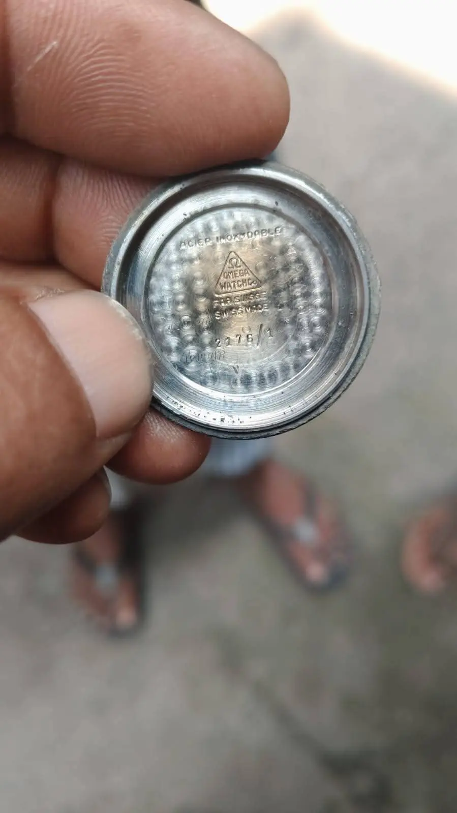

Caseback reference 2176-1 indicates that this was at one time, an Omega "Medicus".
As stated above, the dial has been horrendously re-finished
And what's going on with this case, what is behind it?
Thank you so much for you valuable reply. As you said, the watch has been tampered with a lot especially the casing and the dial.
Is there a way I can slavage the watch by getting a dial and the case ?
I do apologise if I am asking the wrong questions as I am new to the world of Vintage watches.
My idea is to get parts for the watch ( case and dial) and then get them together.
I don't know if that is even possible but as a boy from a small village, having an actual Omega watch can be a dream come true.
I appreciate your reply. Thank you.

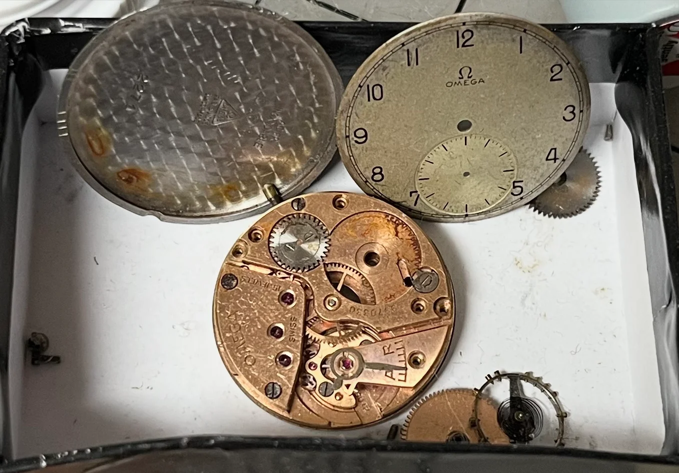

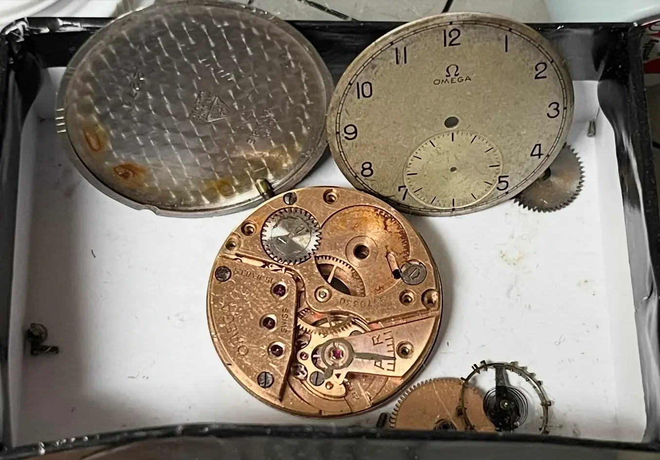

Finally got around to taking this photo.
might as well post it here as anywhere. (should go in the addiction thread.)
I got the PC balance bridge. Do not know if it will work since it has shock jewel, and the non PC plate has no shock protection. I grabbed the bridge within an hour of it being listed. If nothing else it makes the movement look more complete.
Have not really looked much at the dial. It looks passable.
Still no midcase. So this is really an art project. Do enjoy looking at it. I really like these movements. I think there is another listed for about the same in a more complete state. So I could have waited. I do not think that has sold yet.
I think this is a FOMO watch as there have been a number of threads like this. So I jumped on it when I could. I have a case for a 26.5 T3, which one is listed at twice the price. Yet I went for this one as the cheaper option.
Should know better after 35 years. I did go cold turkey for 18 of them while collecting pipe organs.
So I can say no -- at least temporally or so I keep telling myself.
