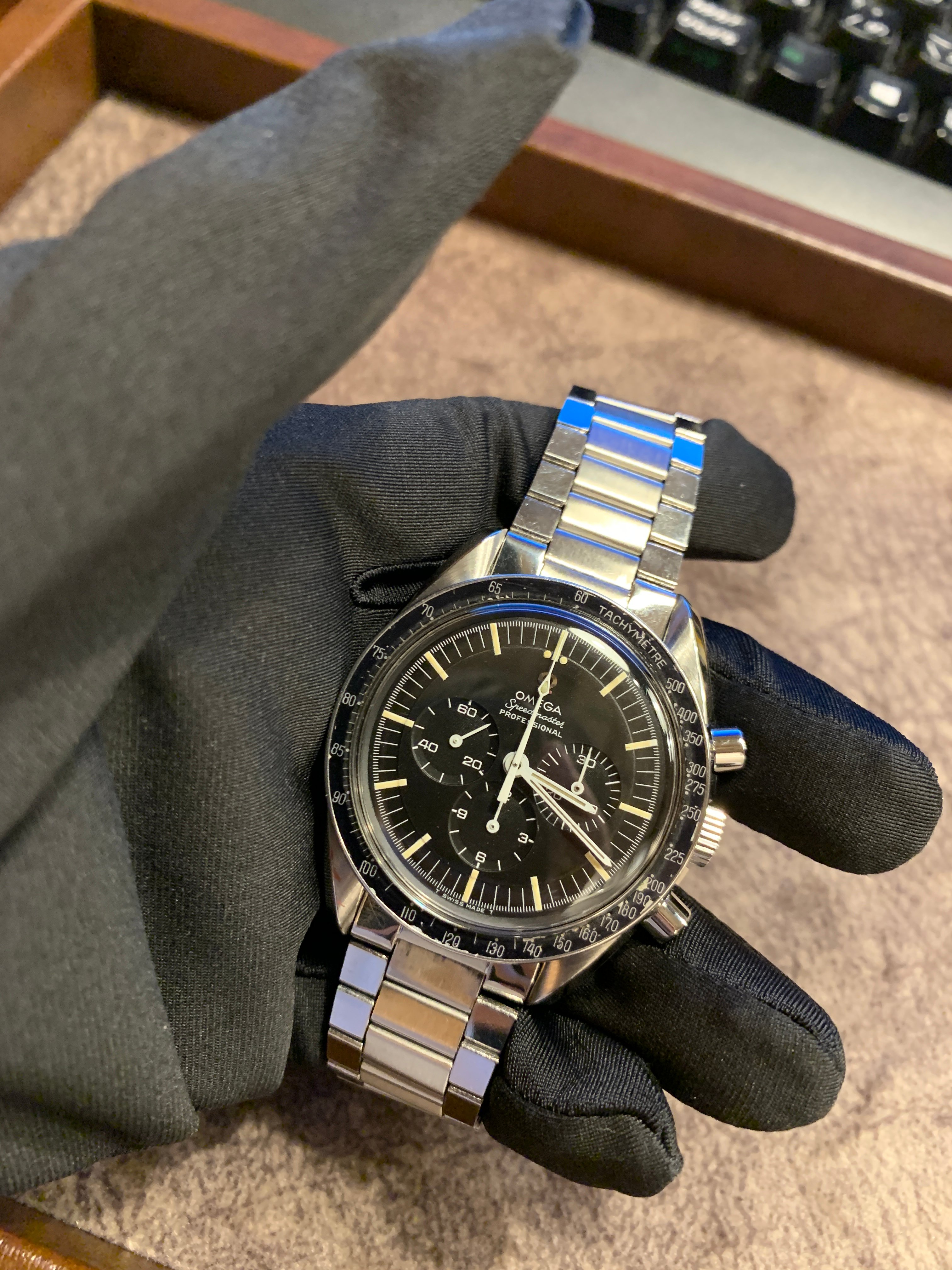

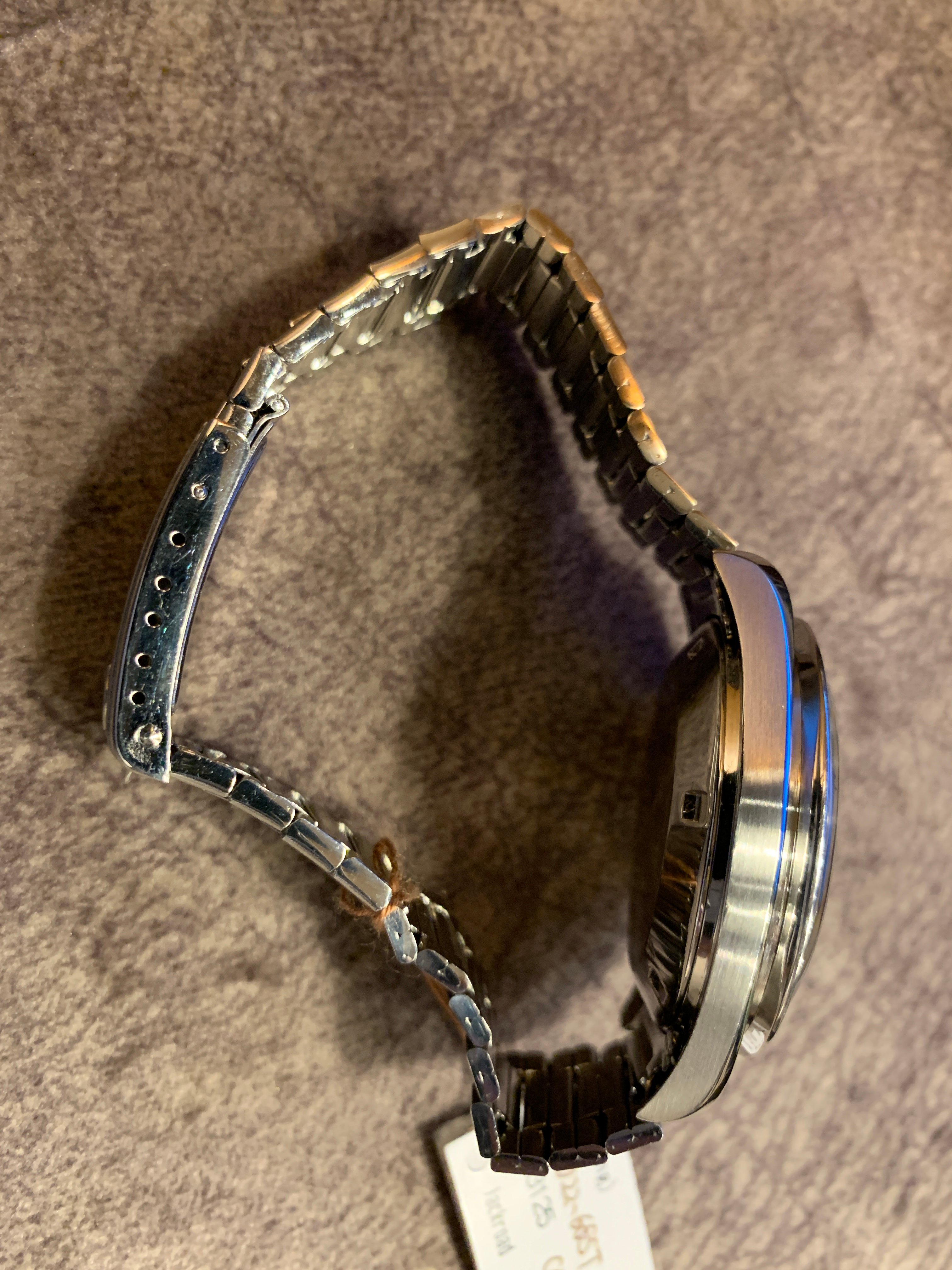

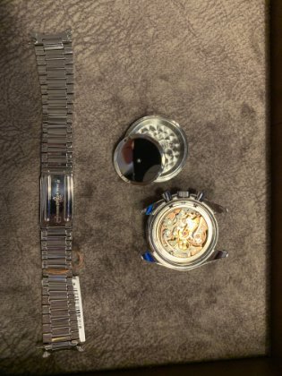

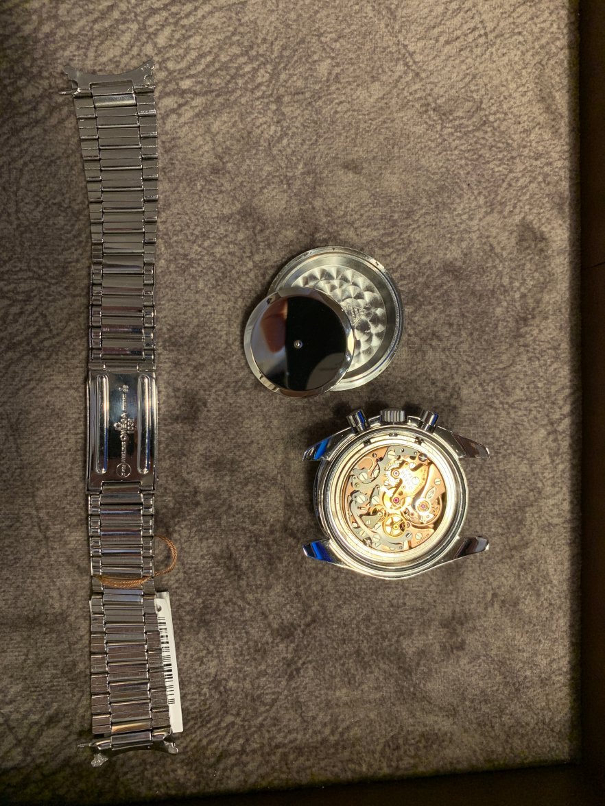

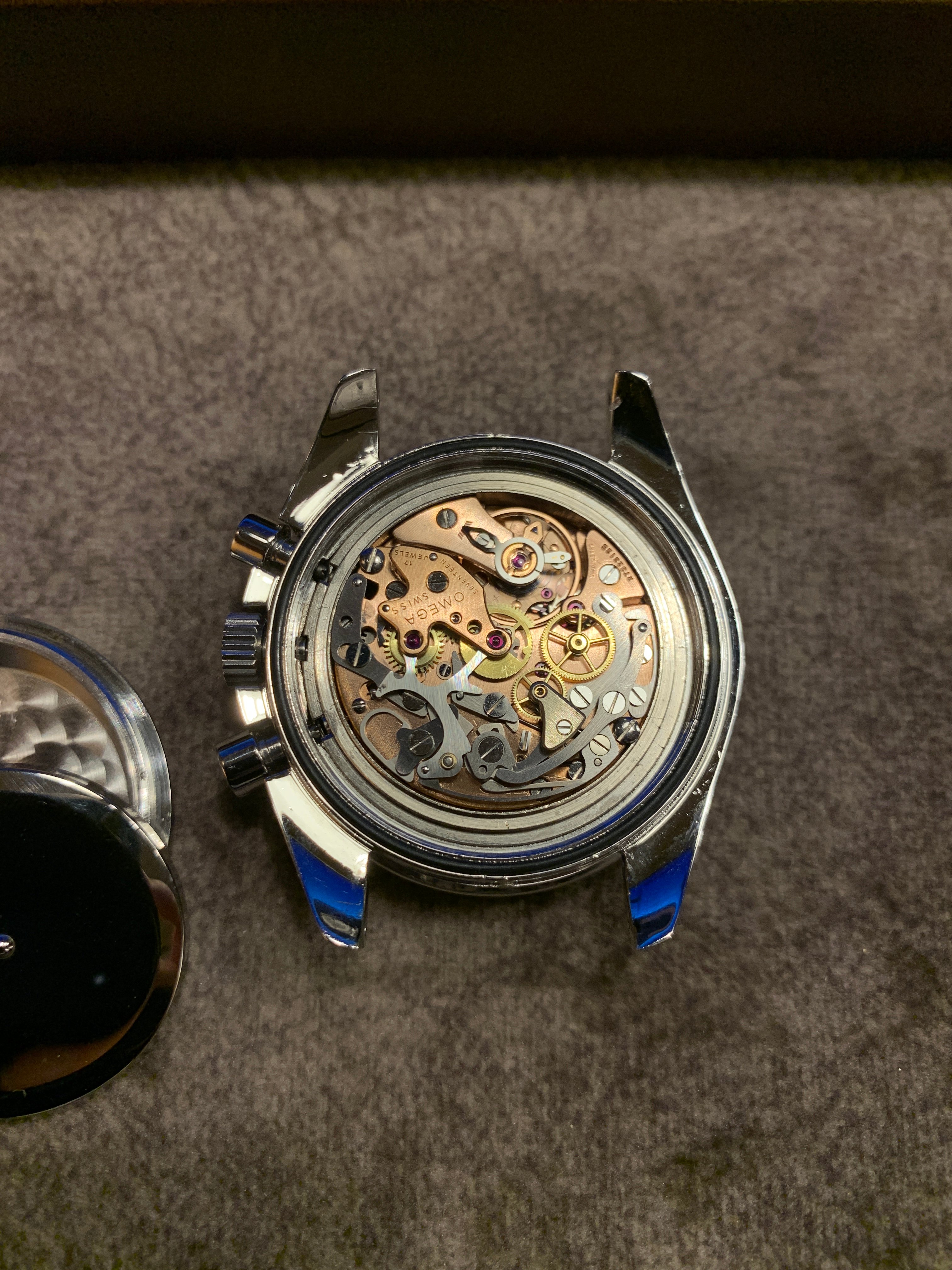

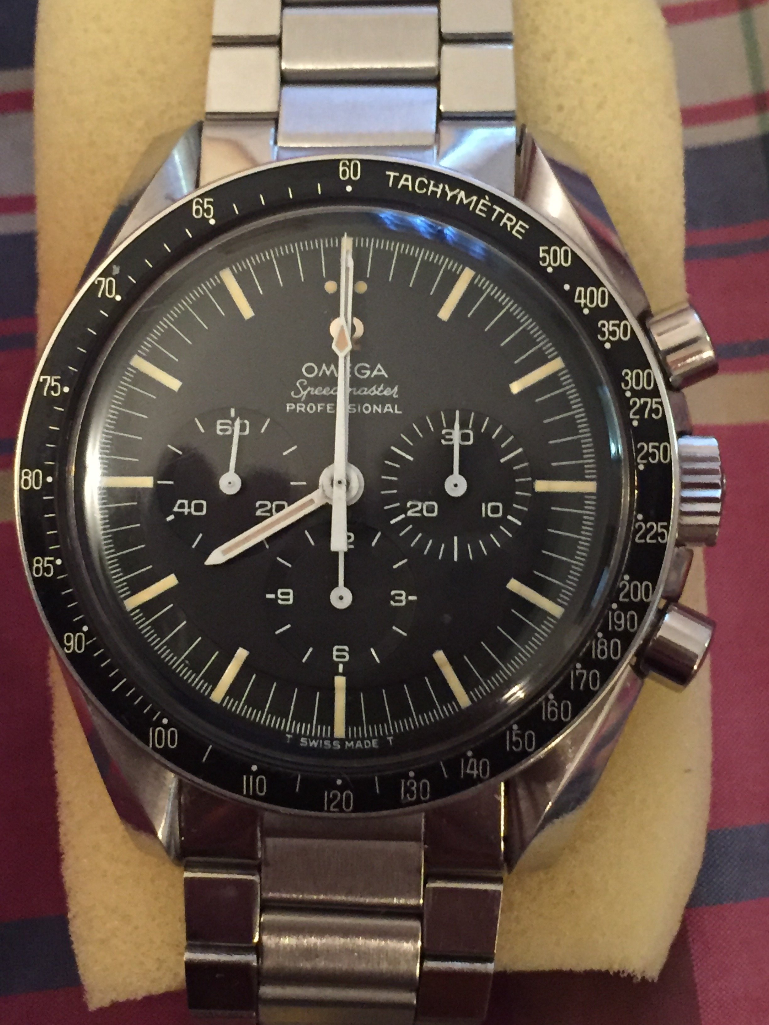

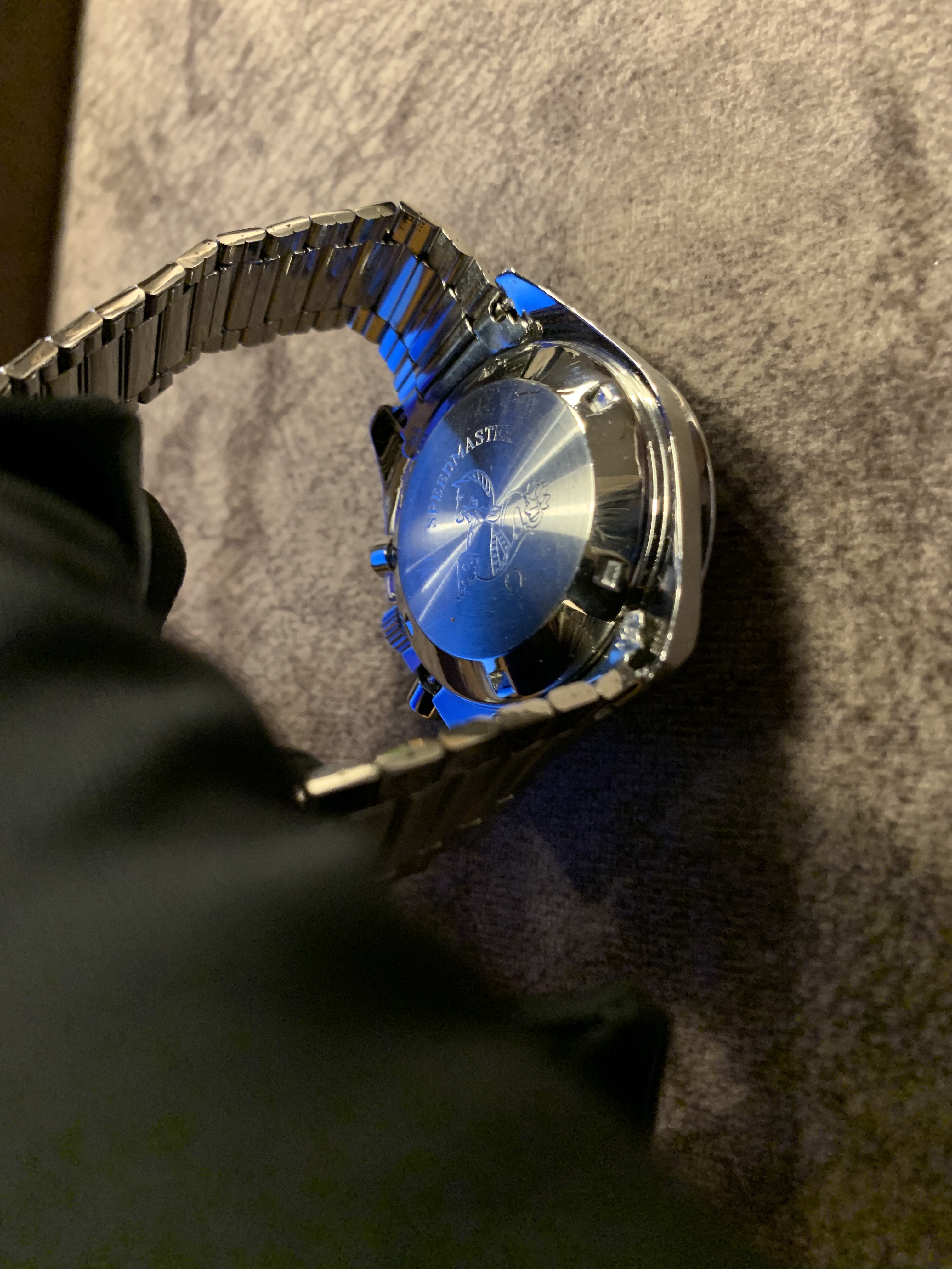

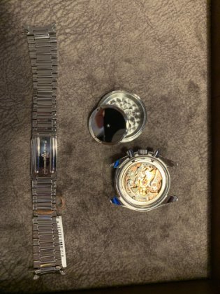

Hi OF members,
I would like to get some advice on the authenticity of this Omega Speedmaster 145.022-68ST.
It is currently priced around US$7,600 which is slightly below the market value of this watch. Which makes me a little hesitant on making an impulsive purchase.
The watch does not come with any box or papers. The 1039 bracelet is period correct with 516 end links and the etching on the caseback looks to be really visible.
Please refer to the images attached below for some reference.
Can any OF members shed some light on this?
Or provide some pointers on what I should look out for?
Your opinions and advice would be greatly appreciated!
Thank you.
Regards,
Kevin

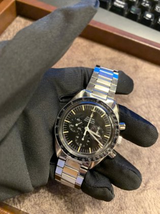

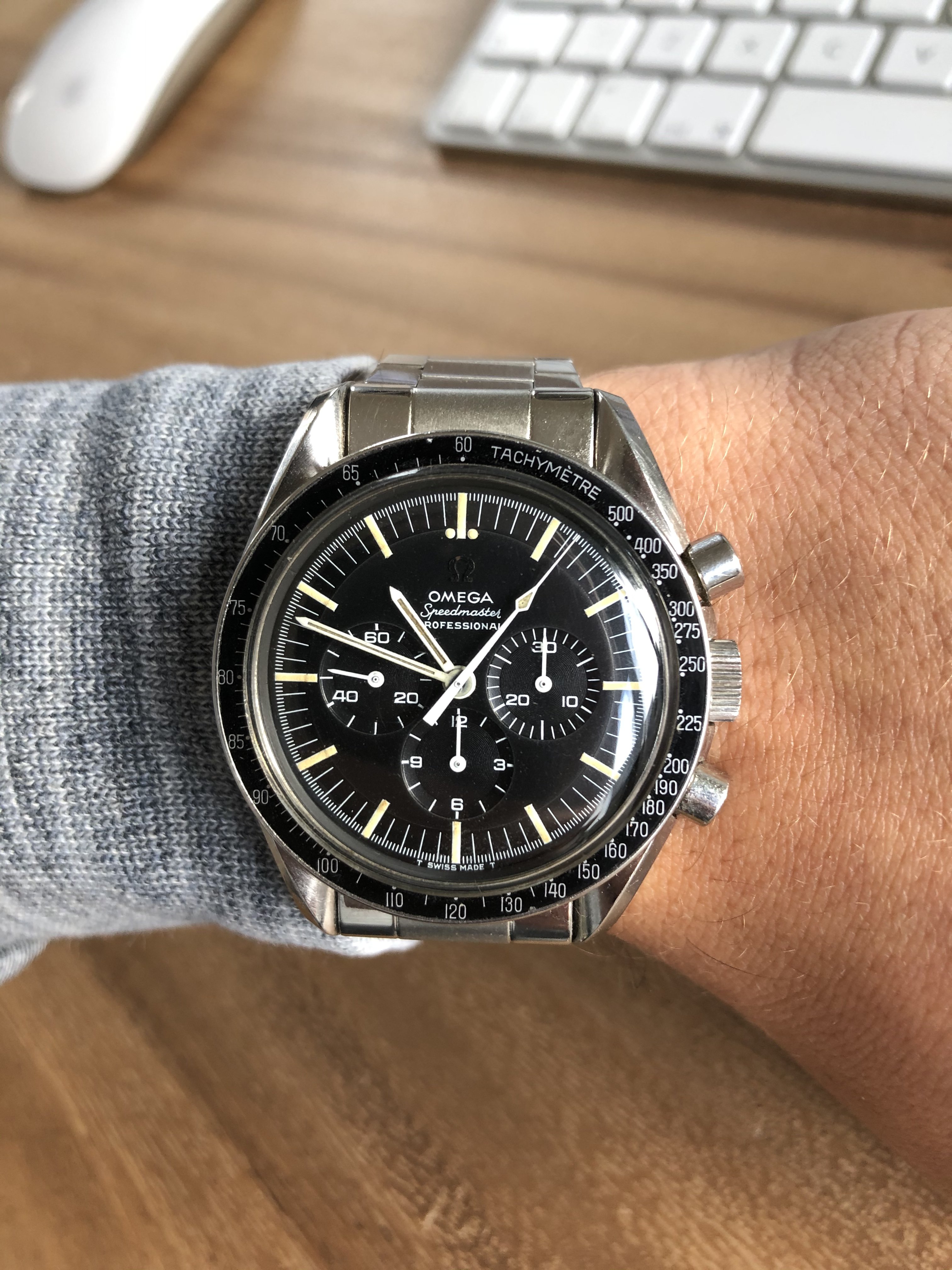

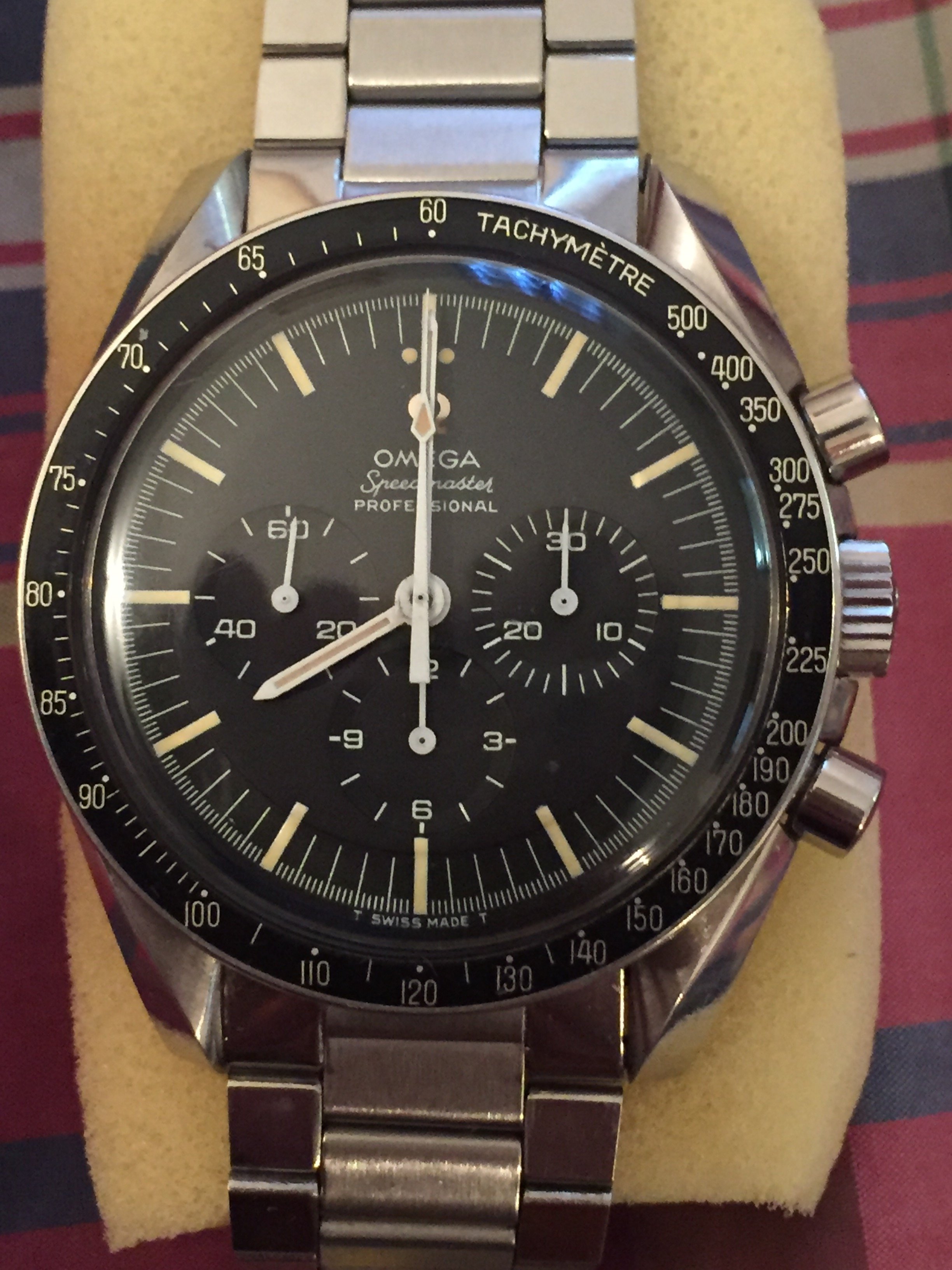

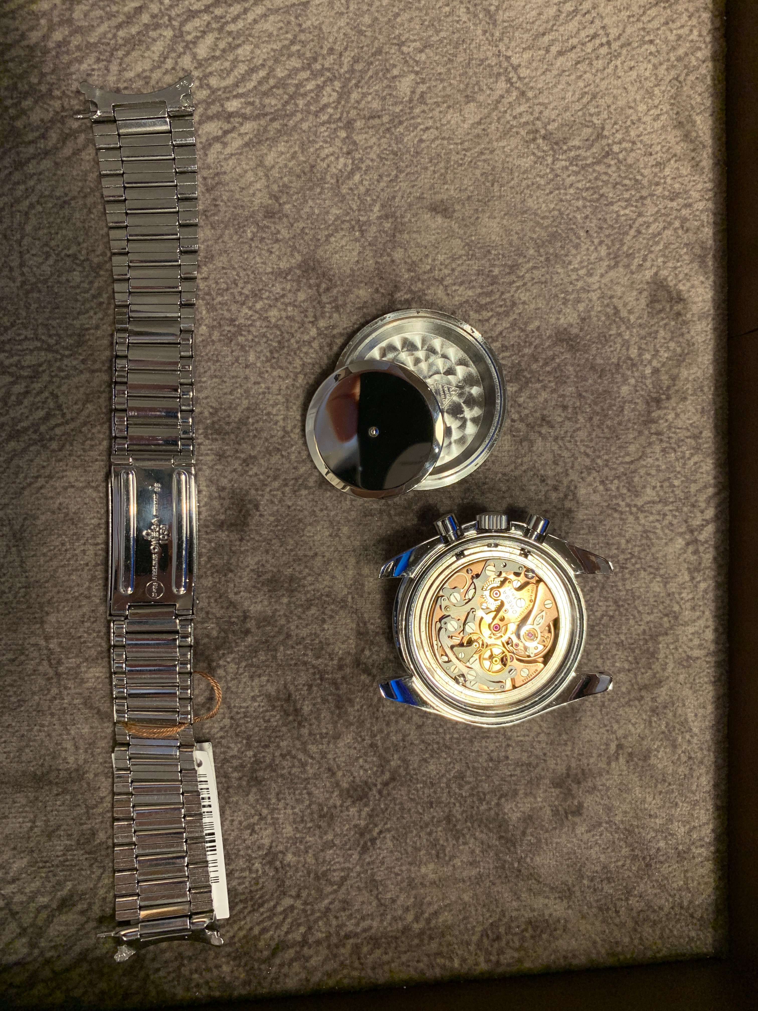

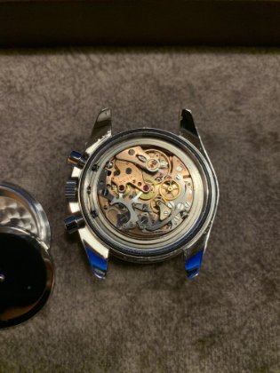

Hi Dan,
Apologies, maybe these photos would be clearer?
Thank you for commenting.
Regards,
Kevin

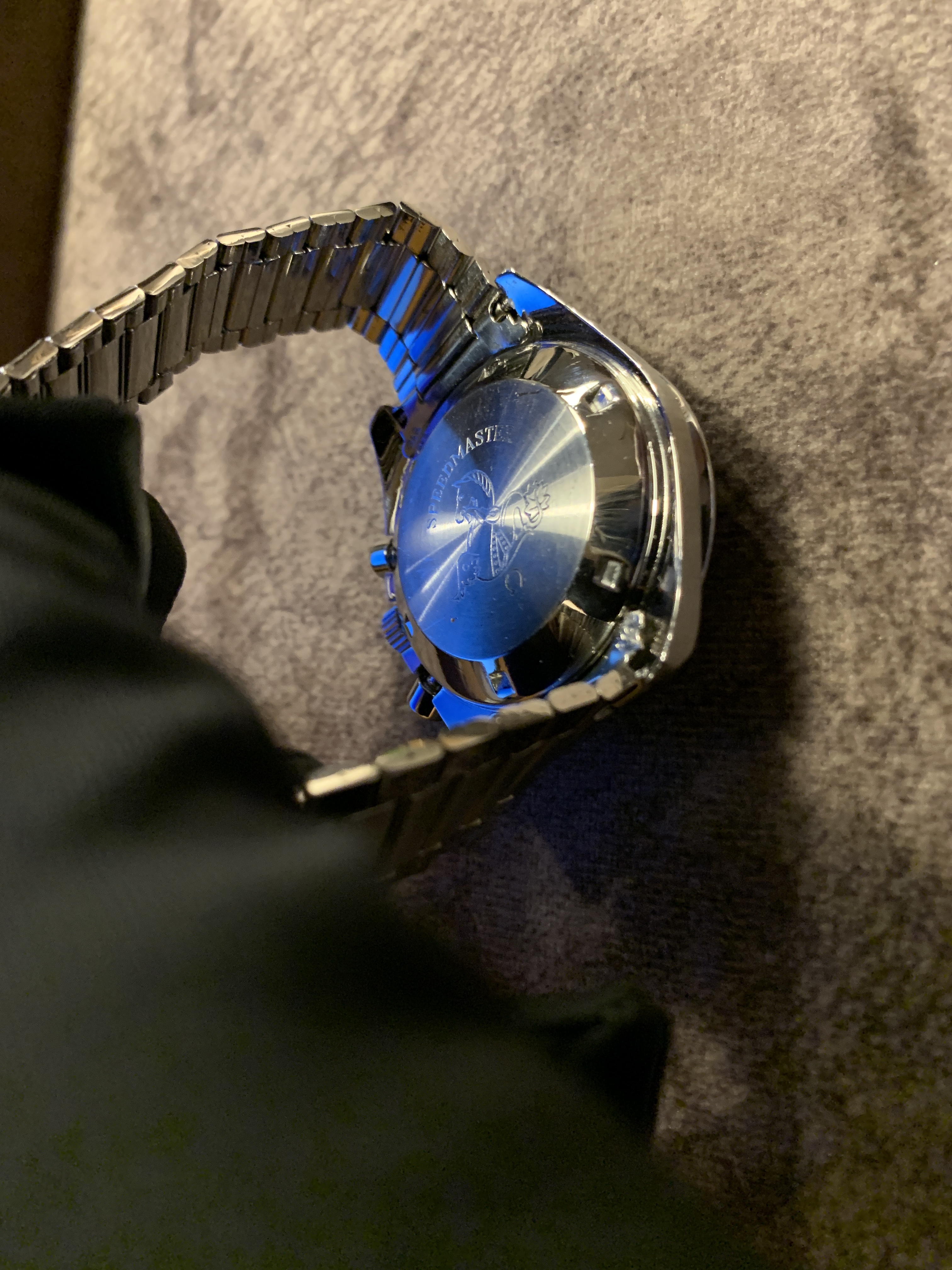

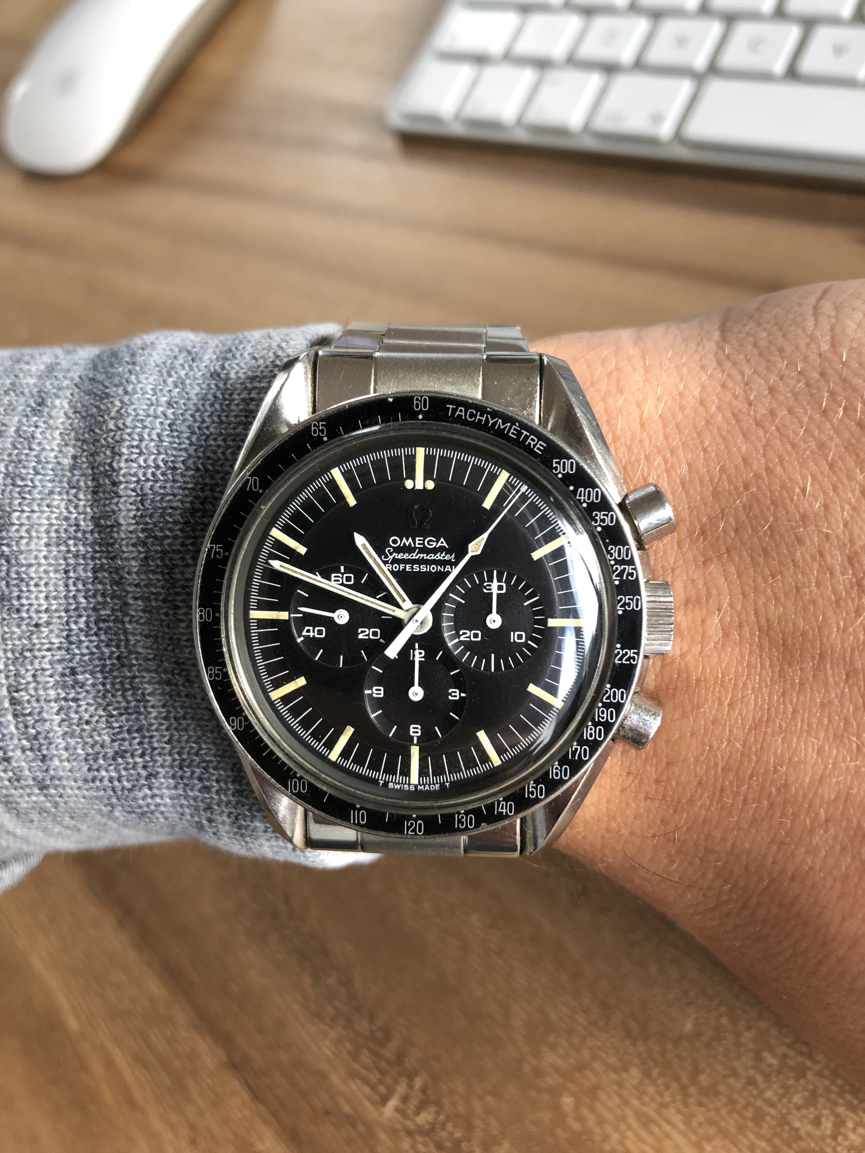

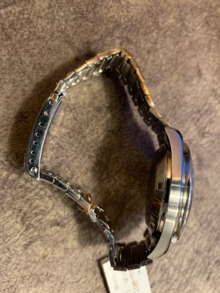

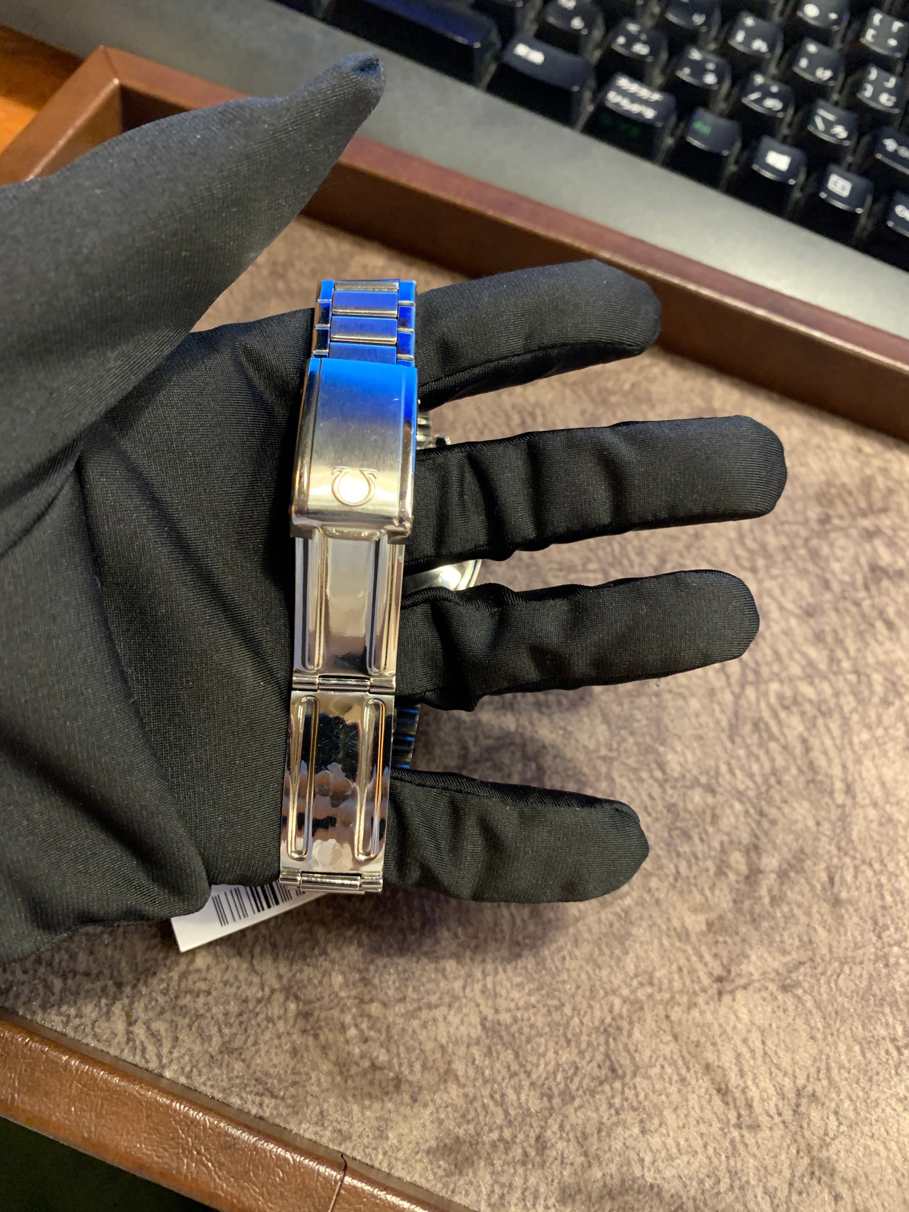

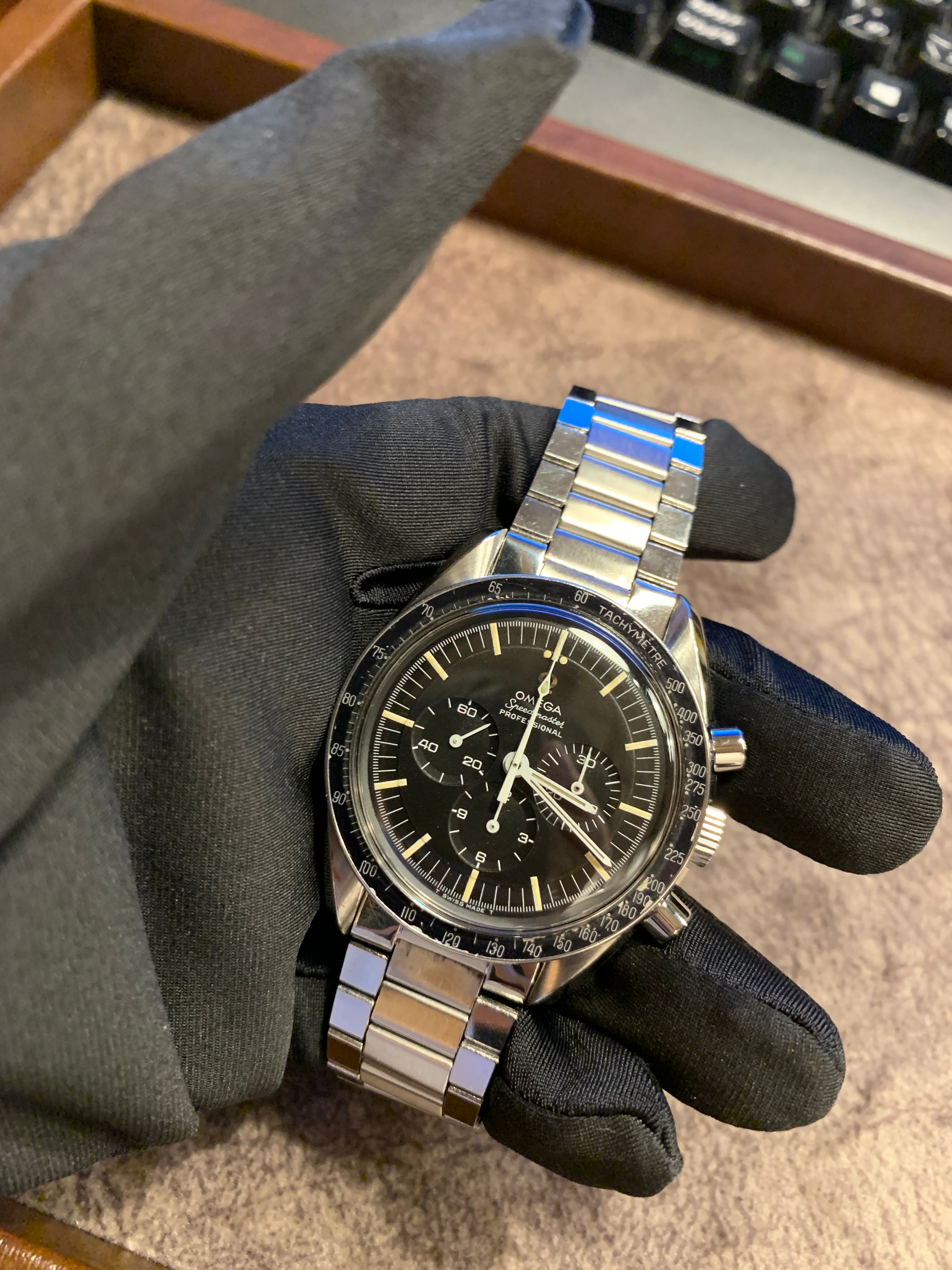

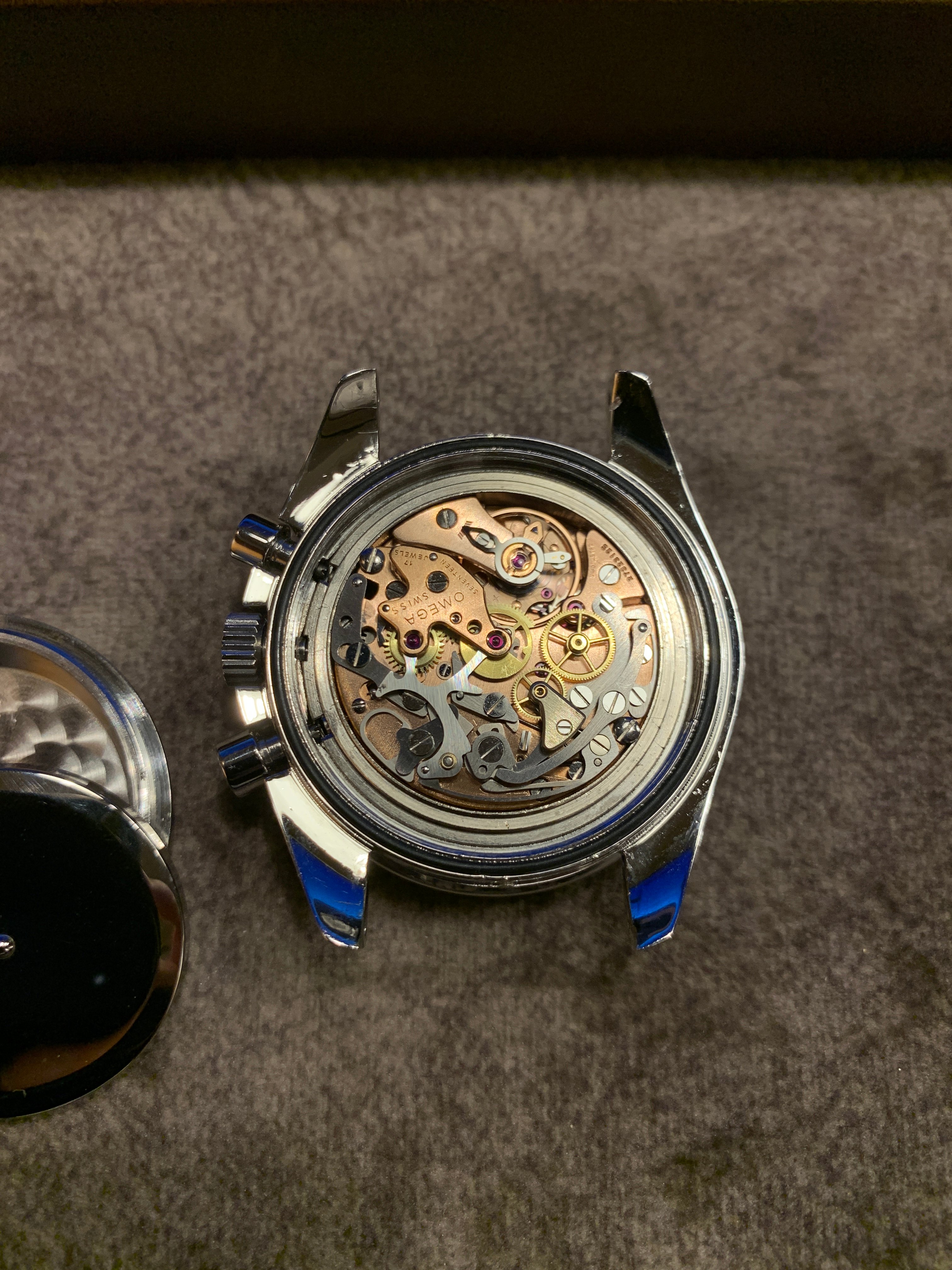

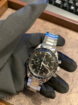

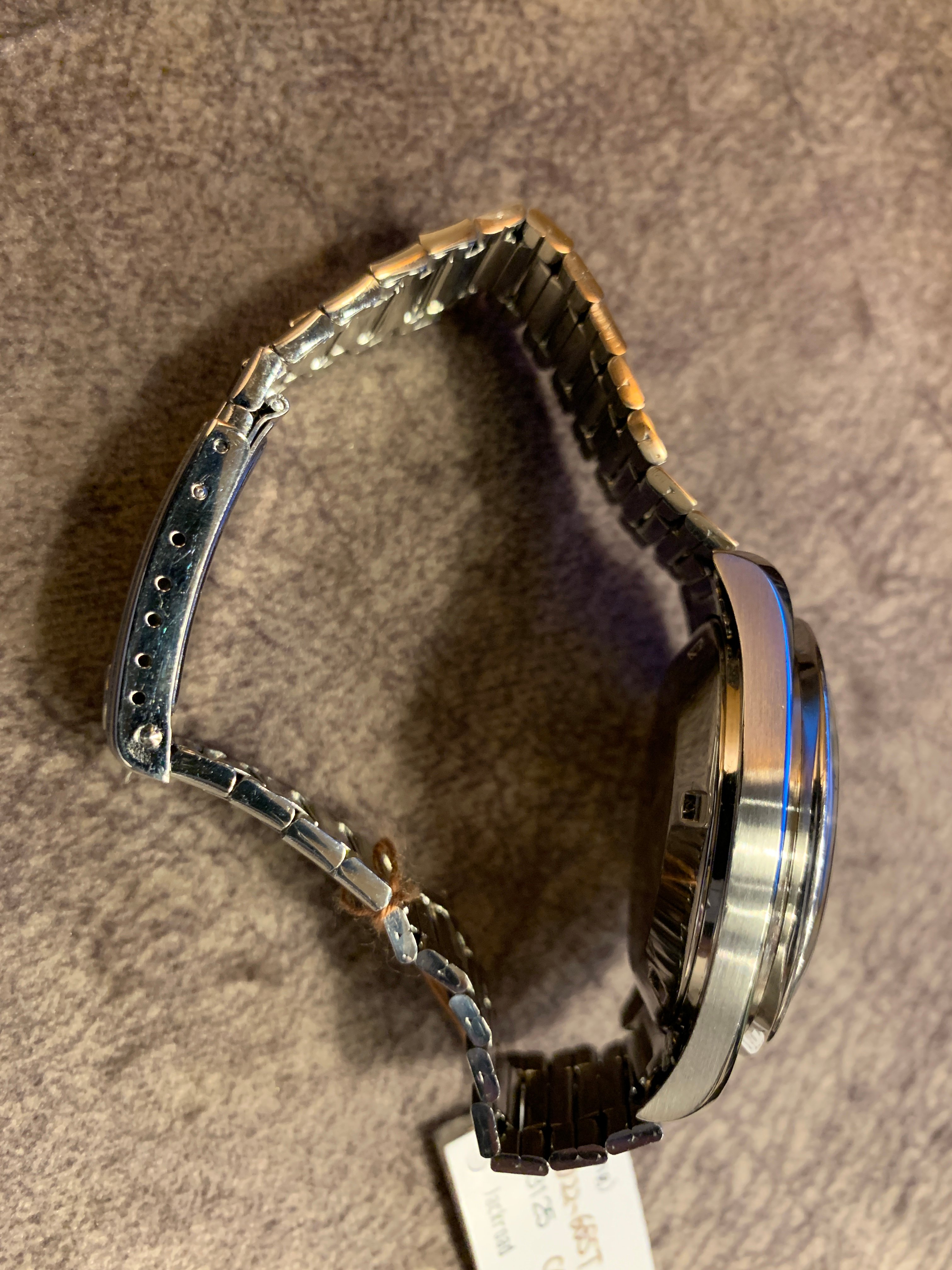

The condition seems to be very nice. The crown appears to be a service part, which would not concern me. Some polishing, but not too bad. I believe that 27M is correct for a transitional. The price is a bargain, especially if that includes the 1039.

Pushers appear off but are an easy fix

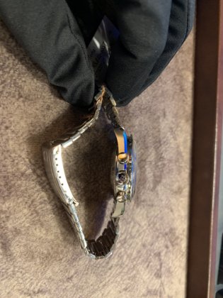

I like the watch, the black gloves make it look a bit like a theft-in-progress tho... 😎

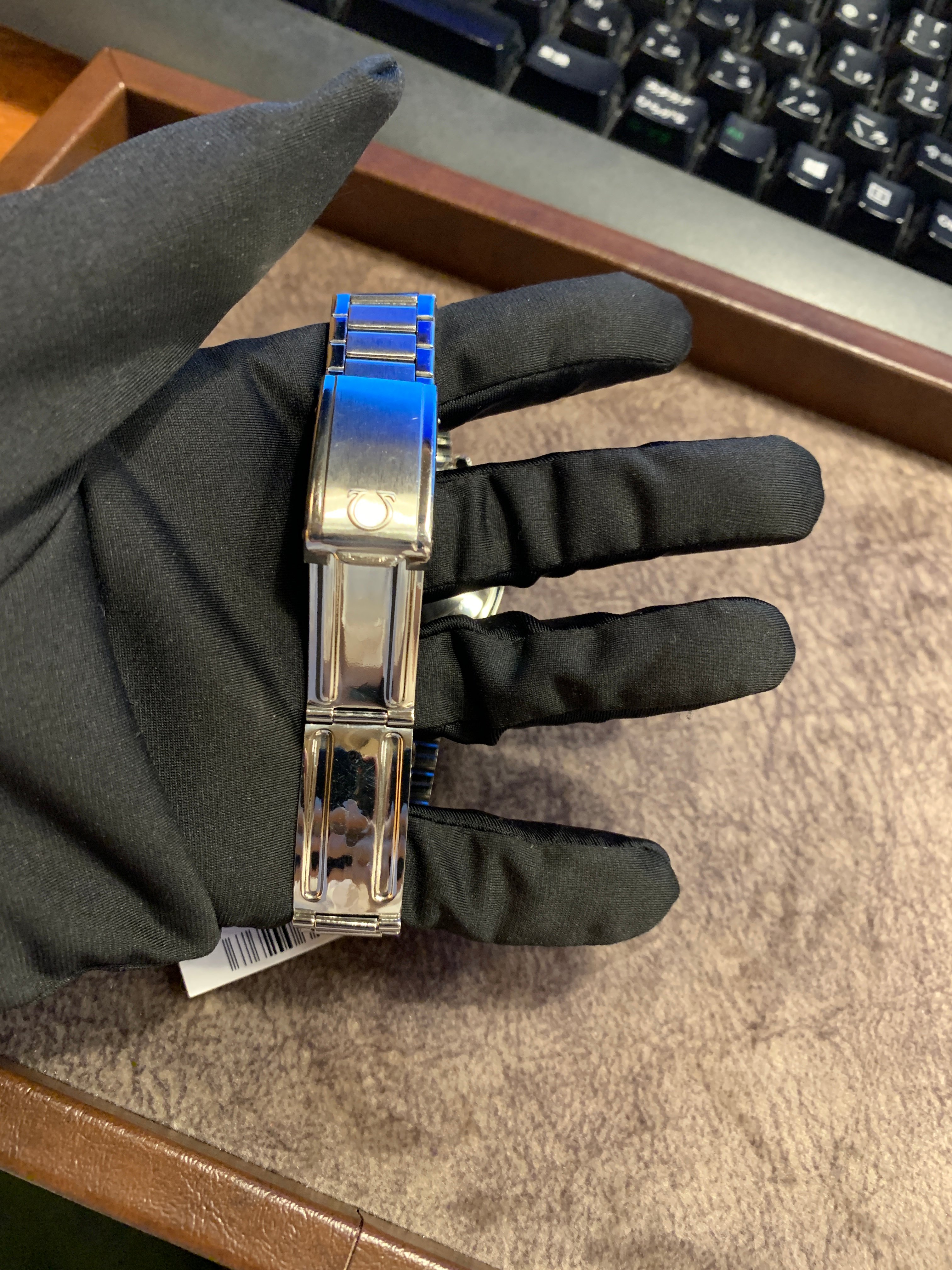

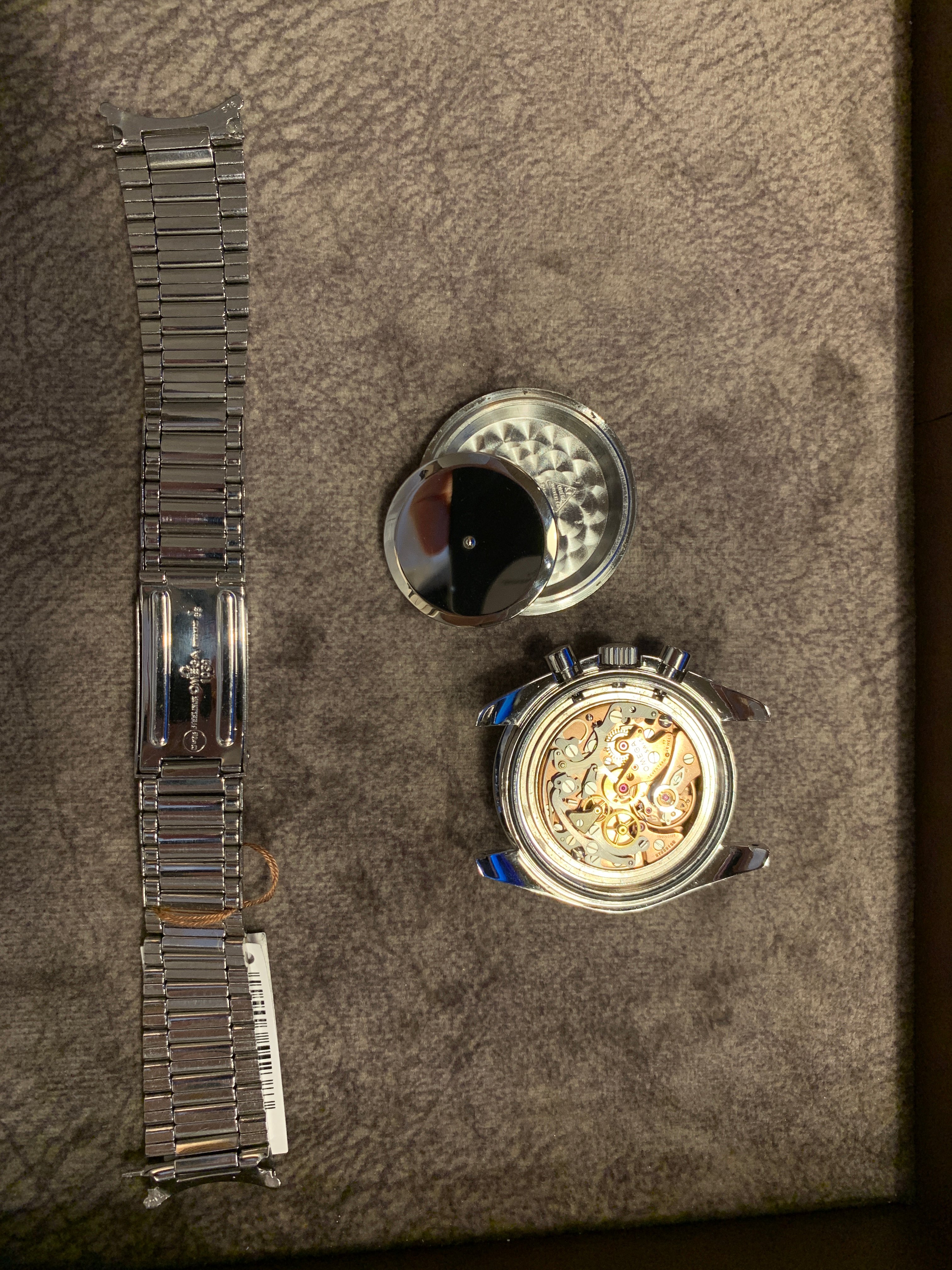

I agree what everyone has already said... the case is lightly polished as some of the line angles are not as sharp, service crown, caseback is very strong, dial is very attractive with very closely matching patina to the hands and no obvious missing lume, the hands are clean, the bezel insert shows some obvious wear and the bracelet appears to be in very good condition. The dial, movement and number, flat chrono hand and reference number are all consistent with being a transitional.
If you consider Speedmaster 101 price chart for just the head...
dial...very good ... 10K
bezel insert... fair... 4.5K
case ... fair + .... 6K
Average for head... 6.8K
add value of bracelet... 1.5 -2k
Value of watch as shown ... 8.3 to 8.8 and I was being conservative.

Looks to be in amazing condition. The condition of the bracelet says everything about the watch.
There seems to be some lume loss on the 2 o'clock marker, but it would not turn me off the watch.

As an owner of a couple of these 145.022-68; I wouldn't mind owning this piece and the price, especially factoring in the bracelet, is very fair to my eyes.

The chrono hand lume seems uneven but that should not stop you buying this. Agree with others great find for that price.
