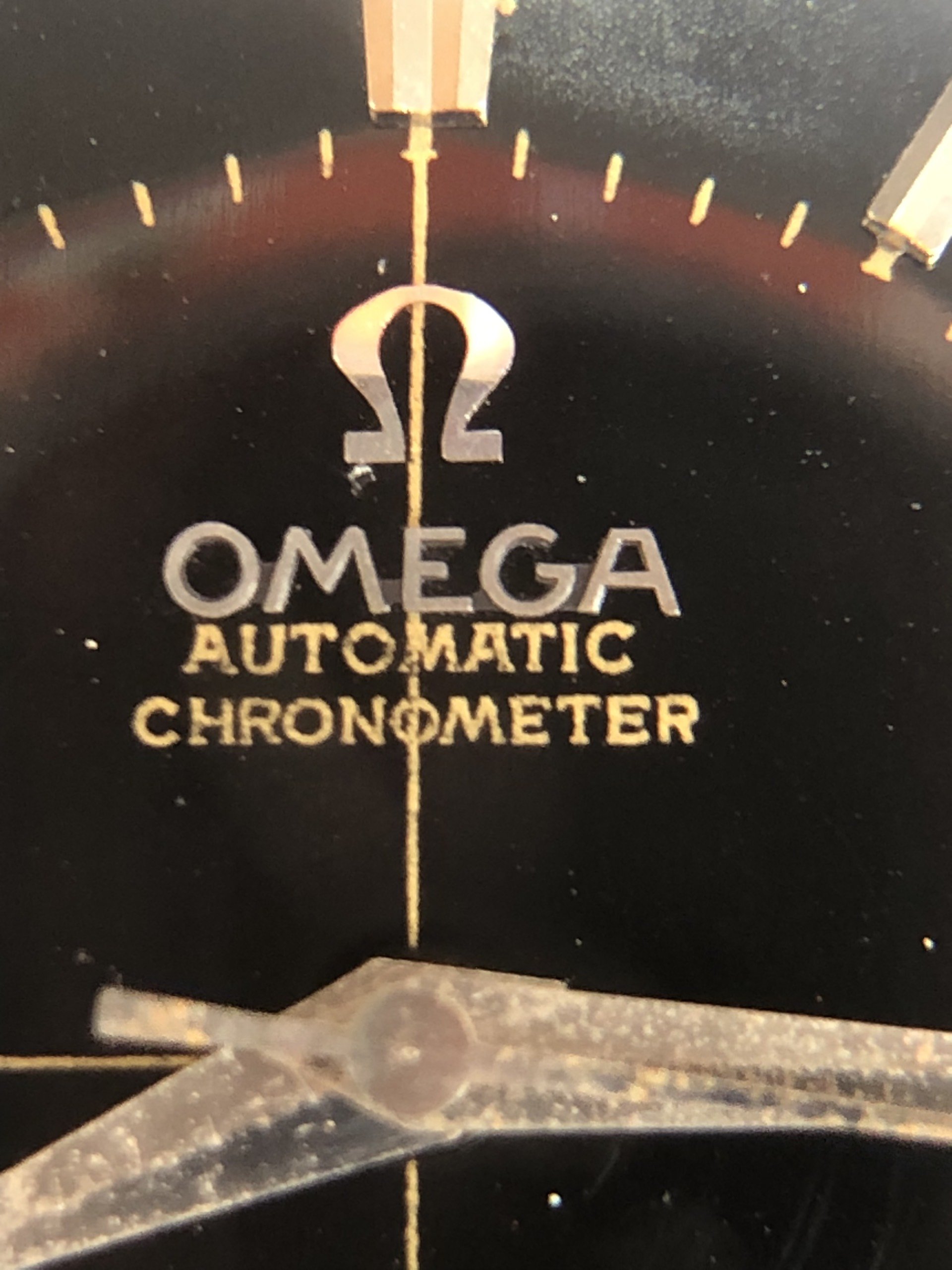

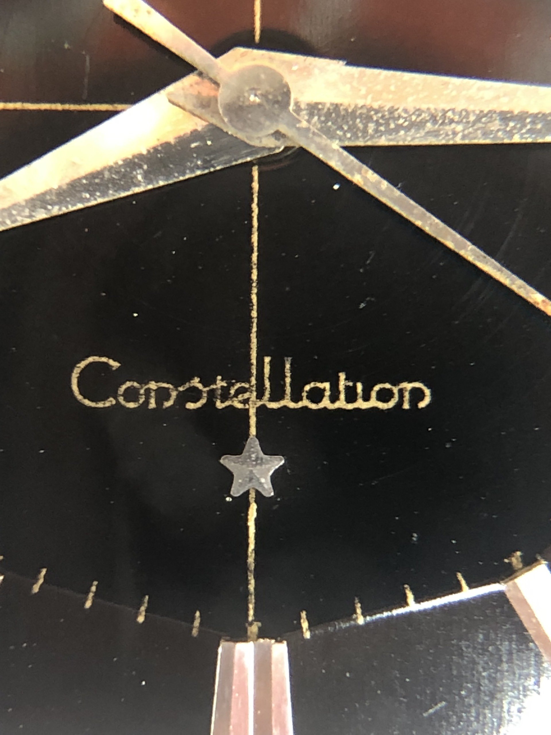

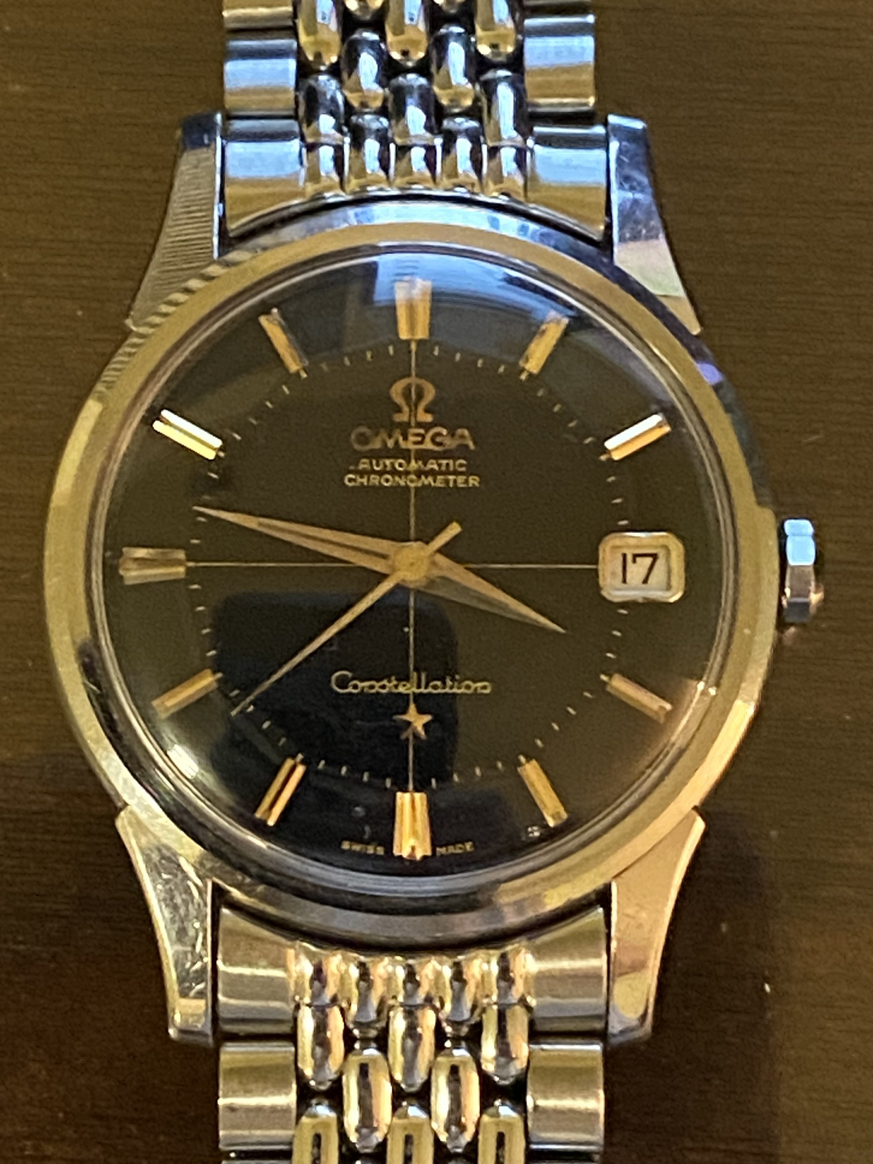

I'm hoping to get your opinion on something. In short, I recently purchased this vintage Constellation reference 14939 with a pie pan black dial as a retirement gift for my dad. I thought it was a good example, before giving it to him, I sent it to a local, well-known watchsmith for servicing.
When the watch was opened up, the watchmaker, who also collects Omegas, suggested that the dial had been restored not original because the font appears to be incorrect. I've read Desmond's blog, but it seems to have passed the MOY test in my opinion. I was hoping to receive the expert eyes to give your opinion on it.
The watchmaker took these closeup pictures with his magnifier loop.
Seller stated no return on it.

Yes, unfortunately a redial.
You just need to look at the minute haches overlapping the pie pan edge - and the fonts are incorrect

Second to also say a redial. Sorry it hasn’t worked out. If you’re unable to return it my advice would be to just enjoy it as it is, which is that its still a lovely watch - even if its not a ‘collector’ piece.

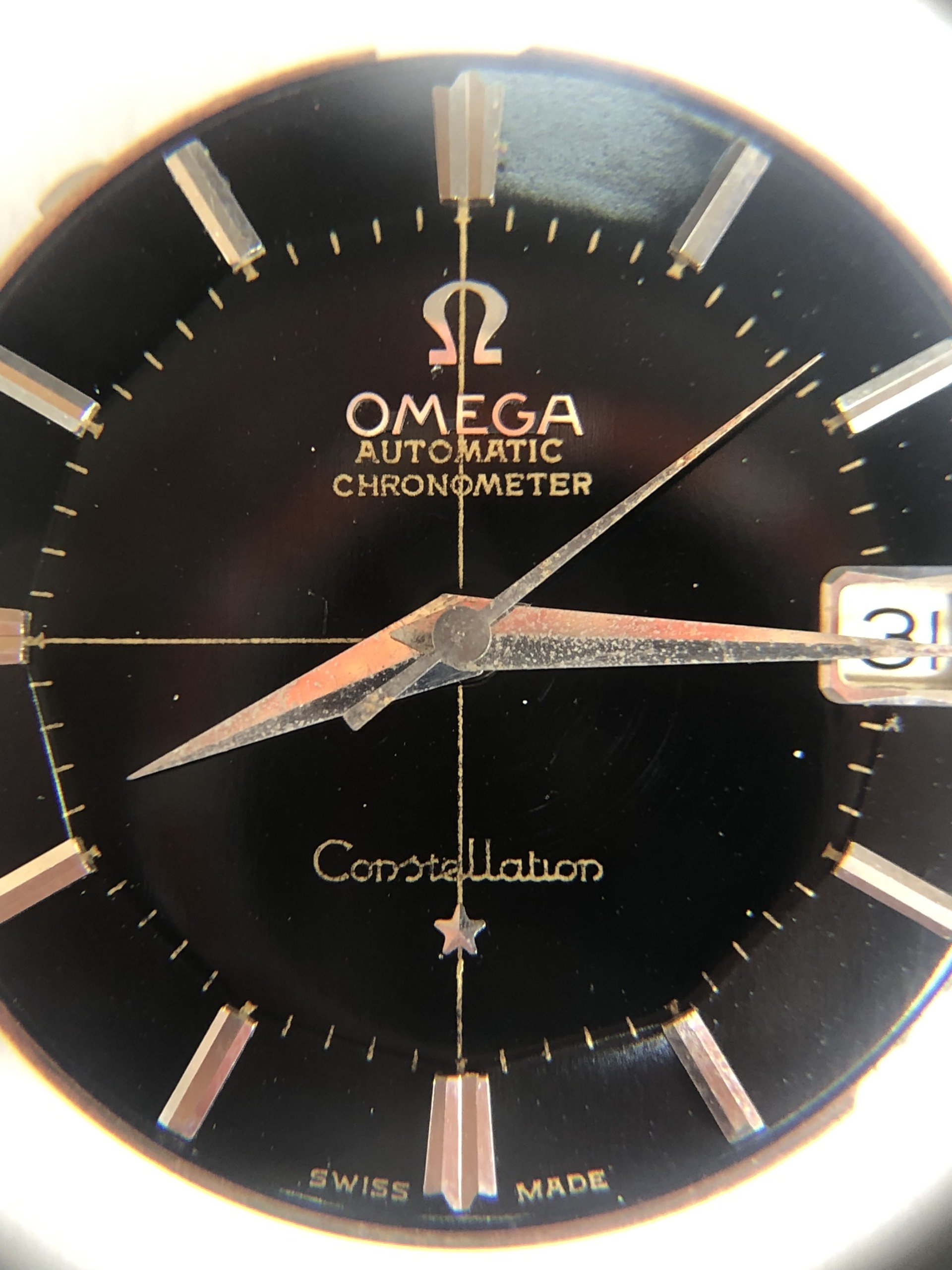

Yes, it's a redial. If the seller did not disclose that the dial was refinished, you have a case for a return. Where did you purchase it? By the way, here's my 14393 which is fully original and authentic for comparison.

It's actually not a bad redial. Those of us with experience can tell the difference between this and an original dial, but most folks are going to see it as a nice looking watch. I'm with watchyouwant on this one. Don't tell Dad that it's a redial. He'll never know, it's a nice looking watch, and a very thoughful gift. By the way, if you're interested in installing a correct decagonal crown for the watch, I believe that cristos71 has some for sale: FS - Constellation Crowns Decagonal/10-Sided Steel Vintage | Omega Forums

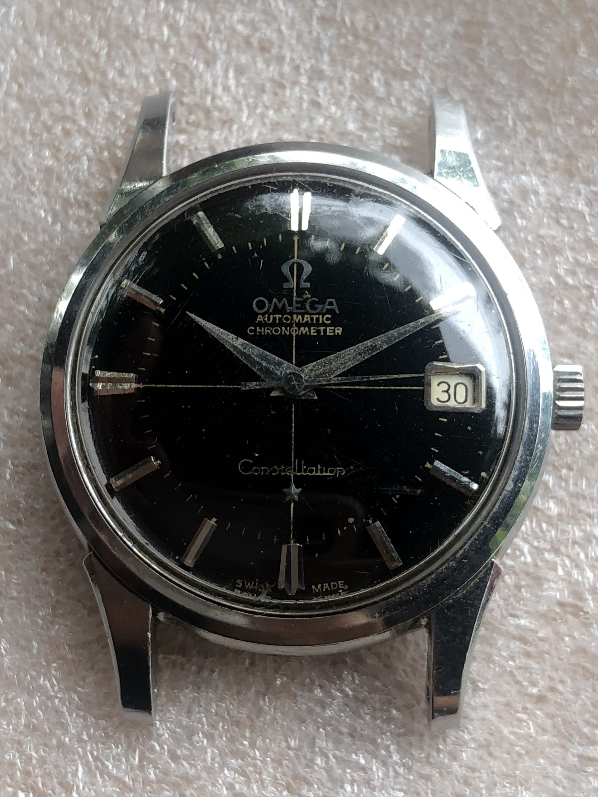

My 14393 to compare the font.😀

For some unknown reason the redialers often forget to dot the "i" in constellation. It's one of the first tells I look for.
