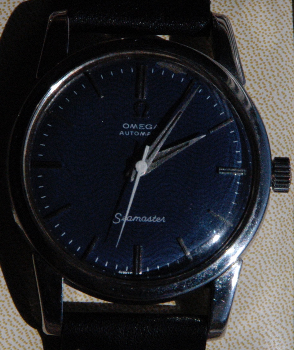

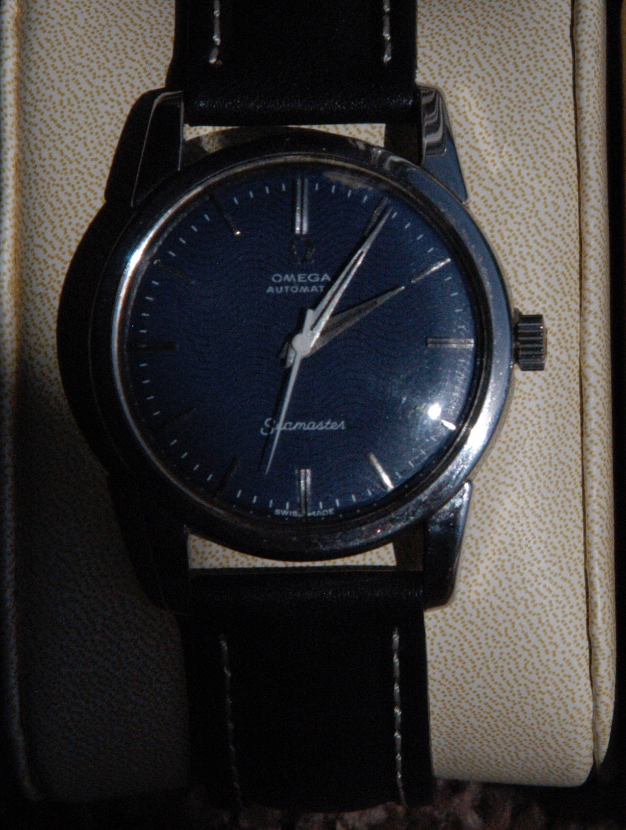

my noob tax was paid on a 501 cal seamaster... the rare blue wave version.
made worse by the chip in the re-dialed paint@ 12-1 o'clock.
IIRC there was a black dial version offered by the same e-dealer at the time.

Edit: I just realized @joe band is not OP posting pics of his watch. So my comments below are pretty useless.
Do you happen to know the reference? Looks like it 2846 to me, possibly.
The case is quite polished, and the hands / crown are most likely wrong for the reference. If it were my watch, I'd be hesitant to sink any more money into it.
Is there a sentimental or other reason you want to hold on to it and try to improve it?
Still, on a positive note, you need have no qualms on getting it re-re-dialled in the colour of your choice😀
The pictures above are note mine (OP). I have a gold plated 2846 with original hands.
