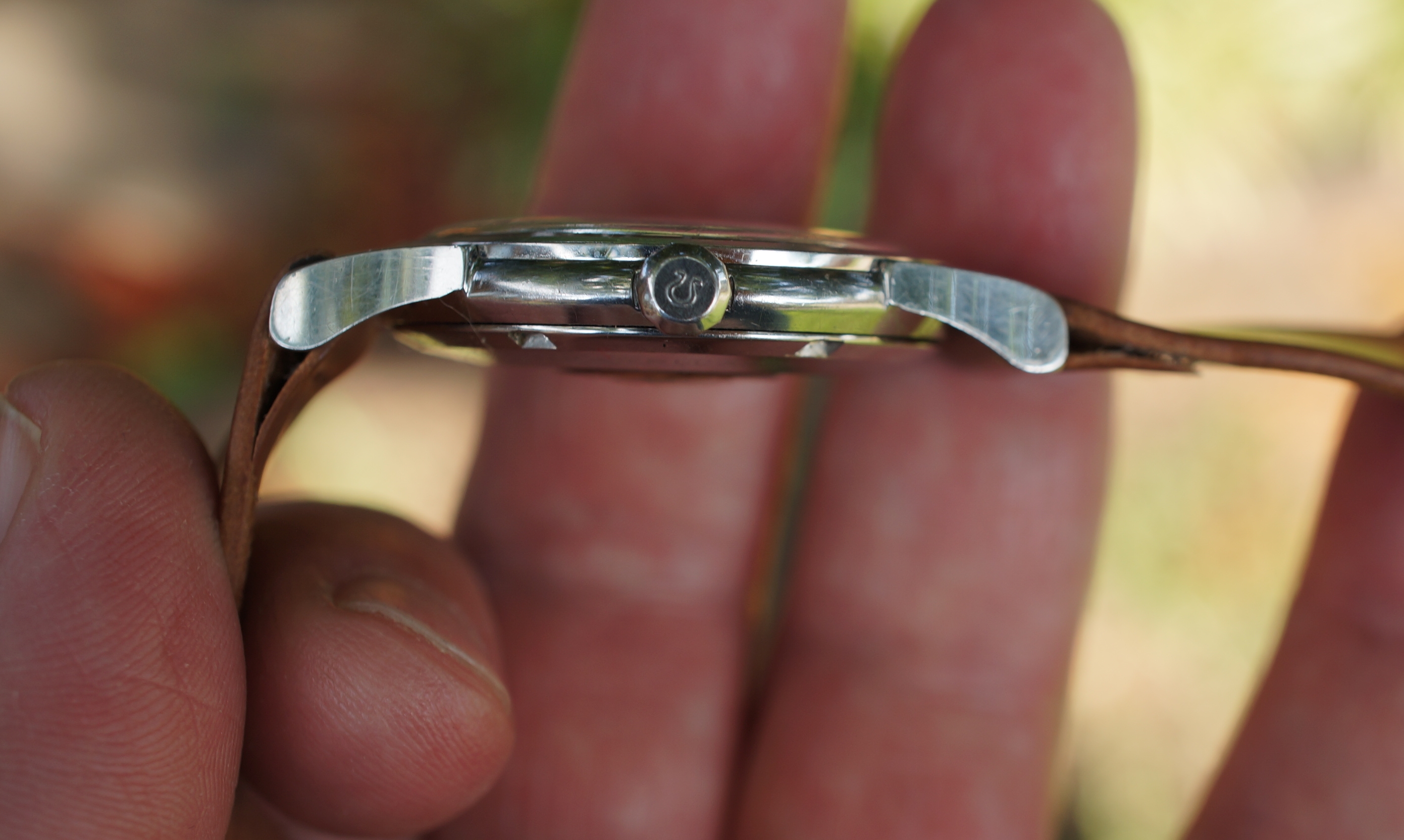

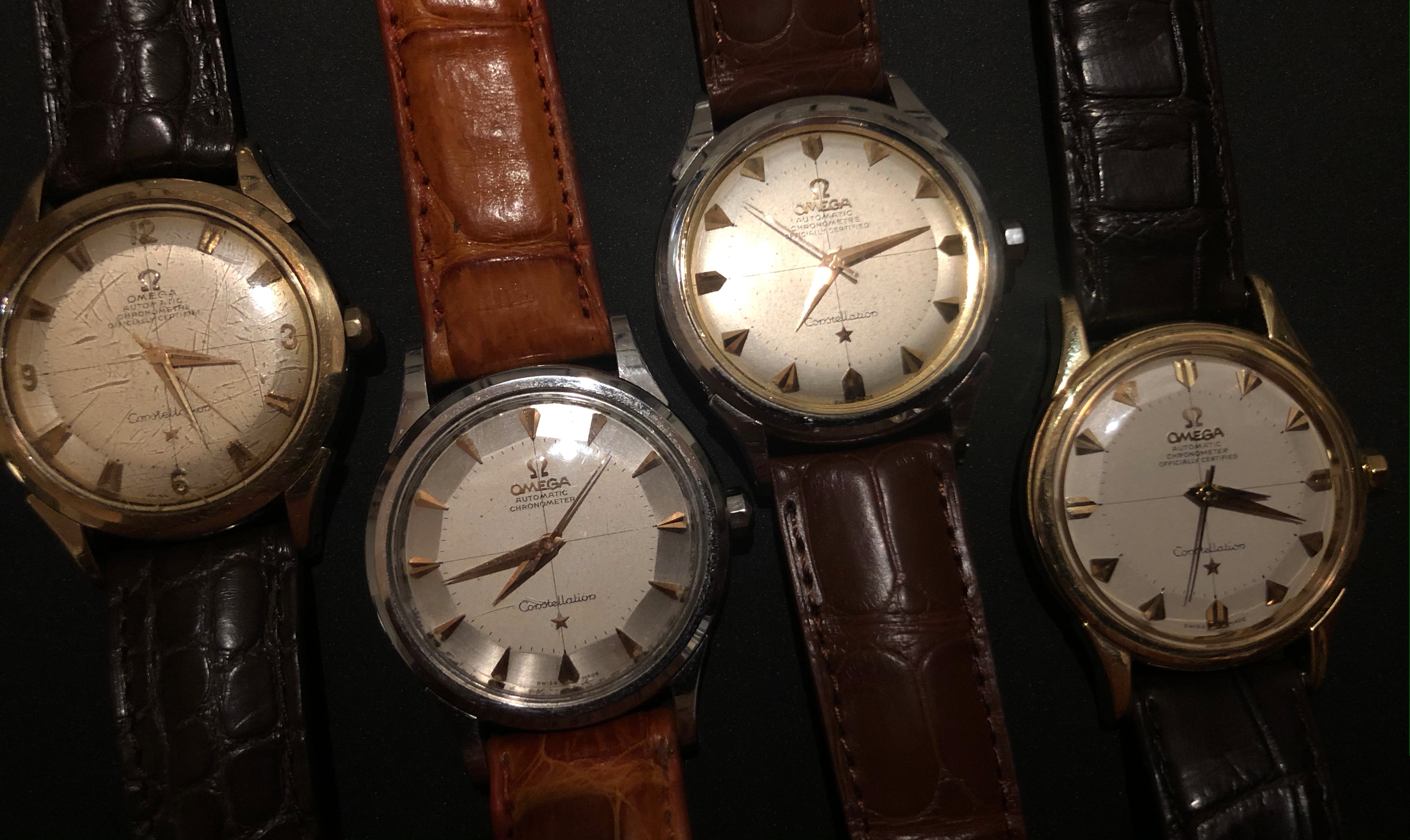

The earlier Ω watches often had crystals with lower profile. I find these much more attractive. Consider these four connies:
From left to right, we have a 1952 ref. 2652 and a 1958 ref. 2852, both with original crystals:
Compare the profile of these two crystals with the original Ω replacement crystals on the two 2852 connies at the right:

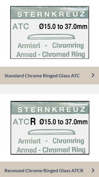

I find the original low dome crystals incredibly attractive compared to the modern bowls. So much that I would like to ask, if Sternkreuz or other generic crystal manufacturers can supply crystals with tension rings and a "vintage" low profile? I don't want an Ω marked crystal, if I can get an attractive generic replacement.
What is your experience?

I'd only had the modern replacements until I bought a watch that had the original. Unfortunately for me, the case with the original was crap and so I was going to swap it with a better case of the same reference, but the crystal broke apart on removal.
So, I will be retaining the Omega-branded replacement but I will see what the Sternkreuz looks like and who knows, I might change my mind.

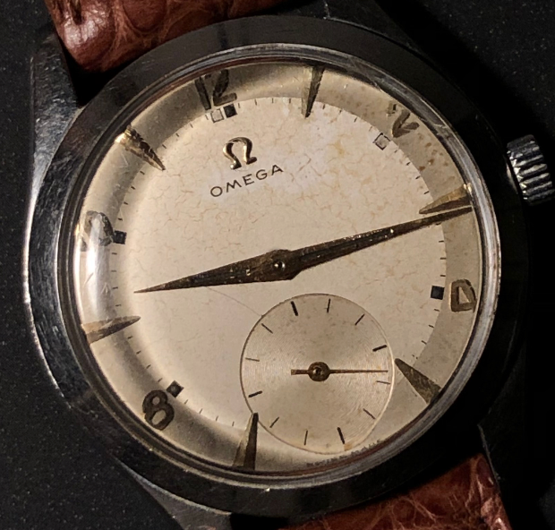

Original is always King
My WM was instructed to gently polish the original after I saw how much a monstrosity a modern crystal appeared.

Is that a 14381? I hardly recognize it without the high dome...

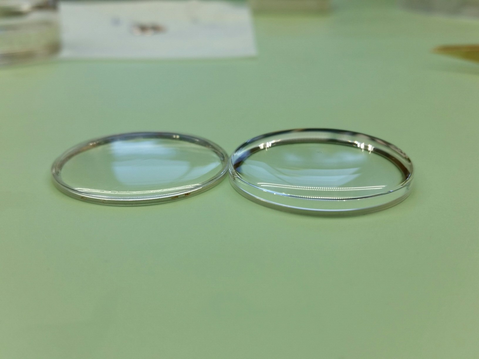

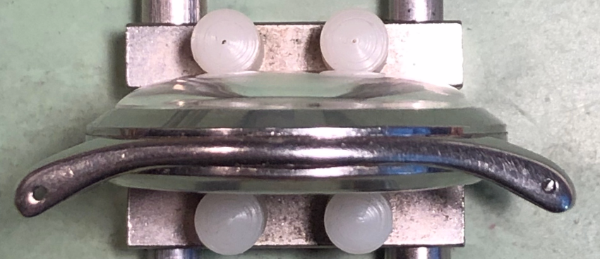

My watchmaker was kind enough to take this pic for me. Sternkreuz low dome on the left, Omega on the right.
Less difference than I would have thought.
1,719
7,388
Still, the Sternkreuz vertical edge and total height seems 30% lower at a glance.

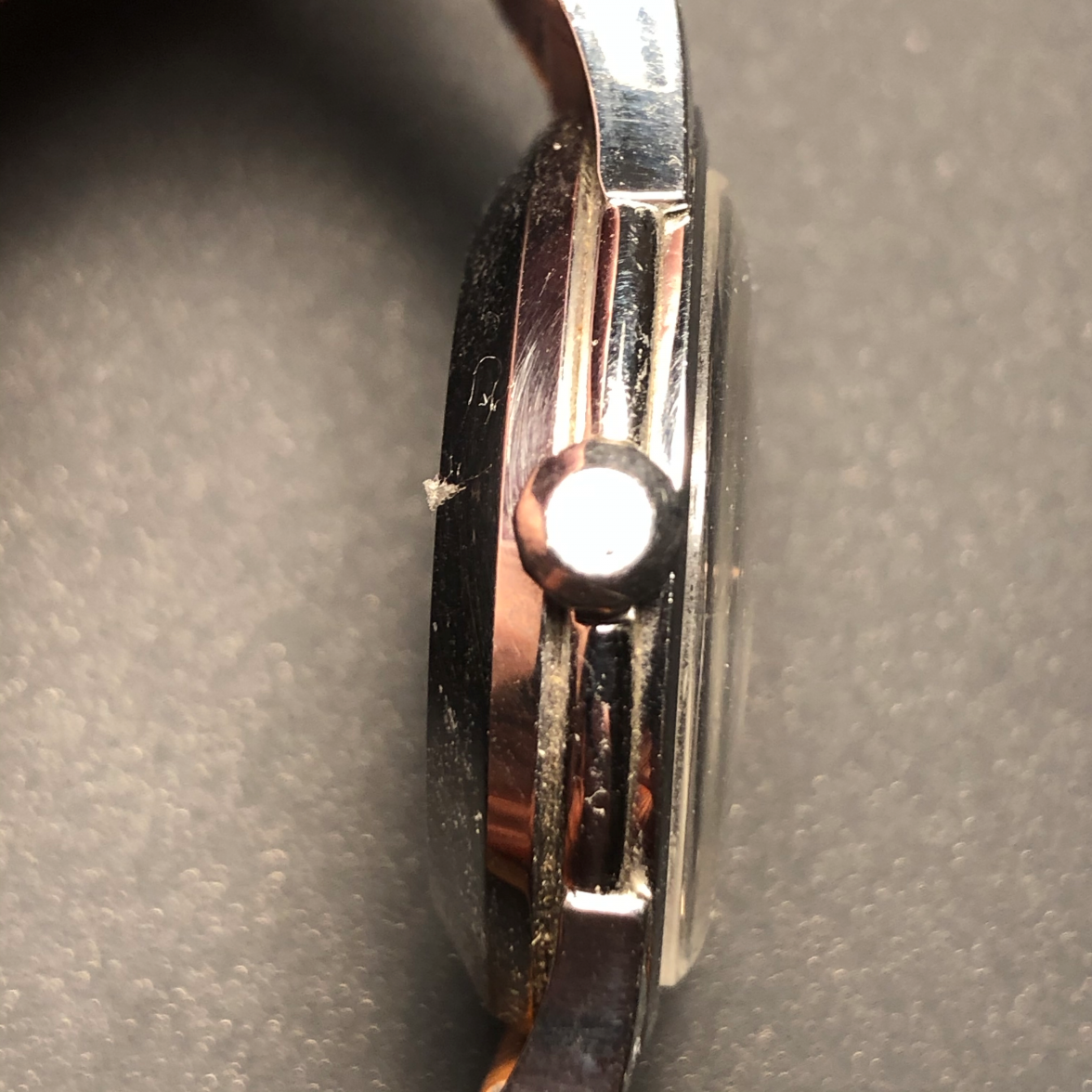

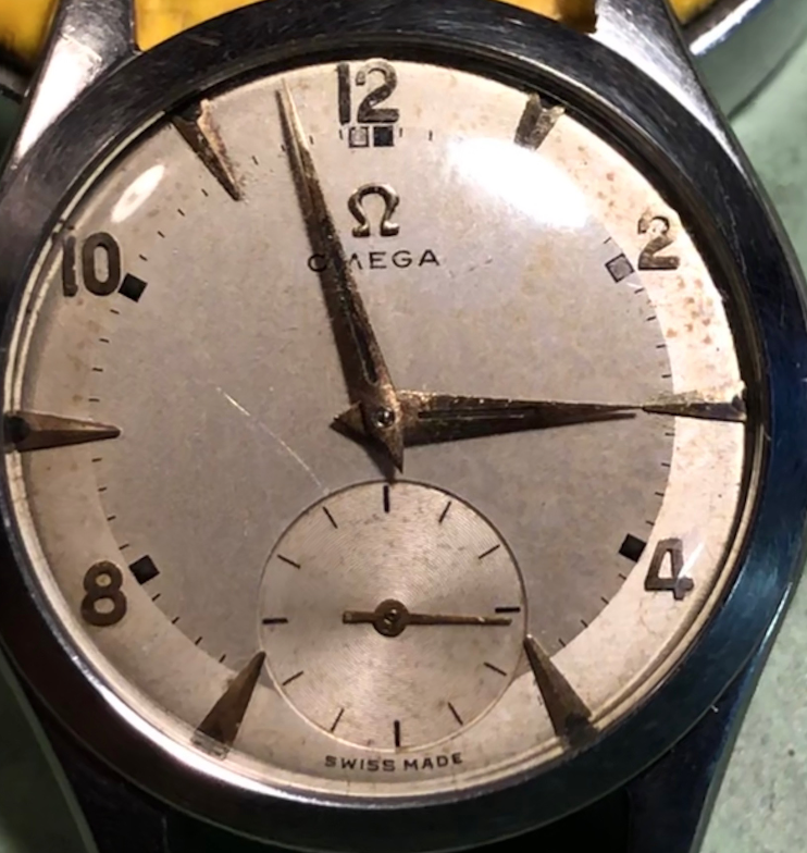

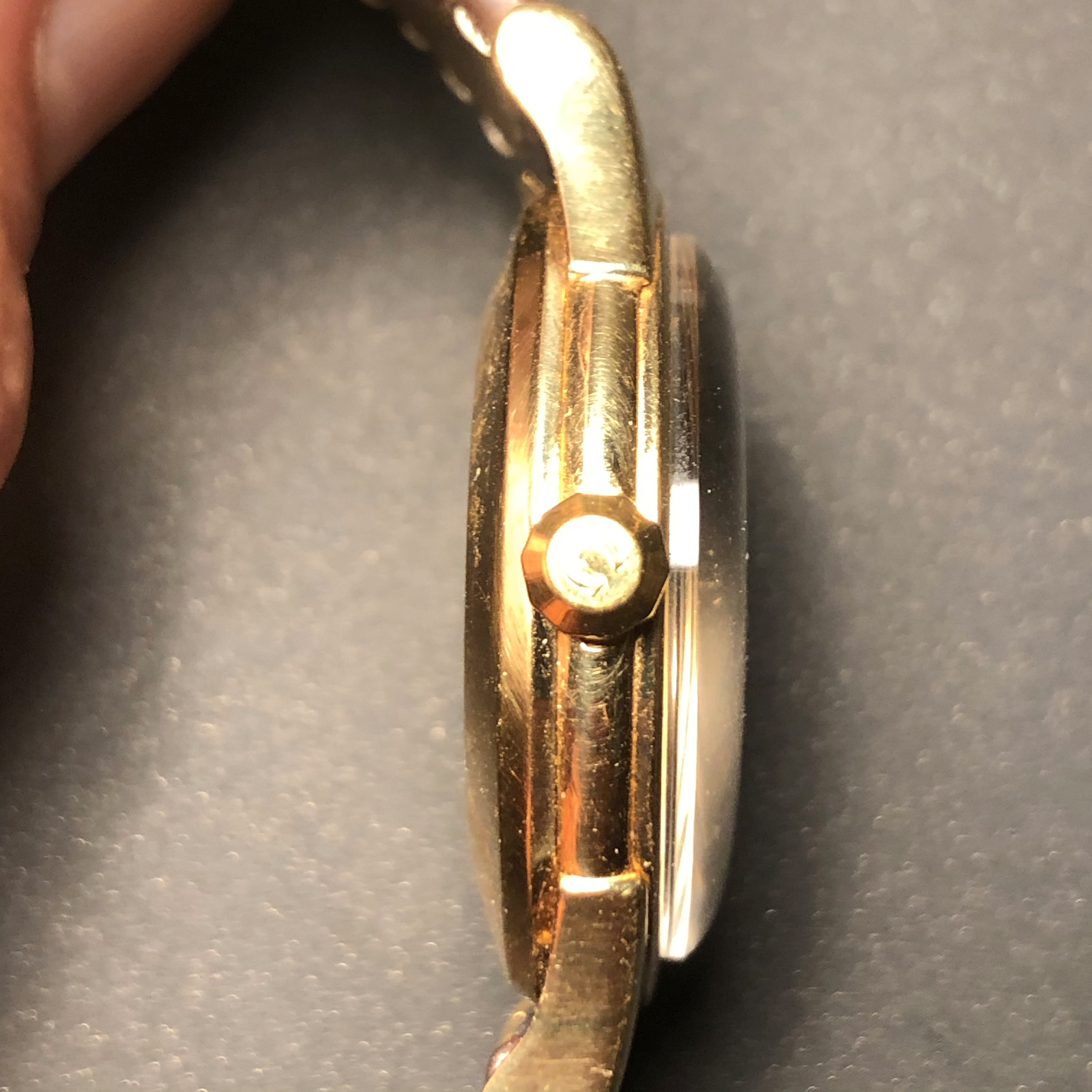

Certainly!

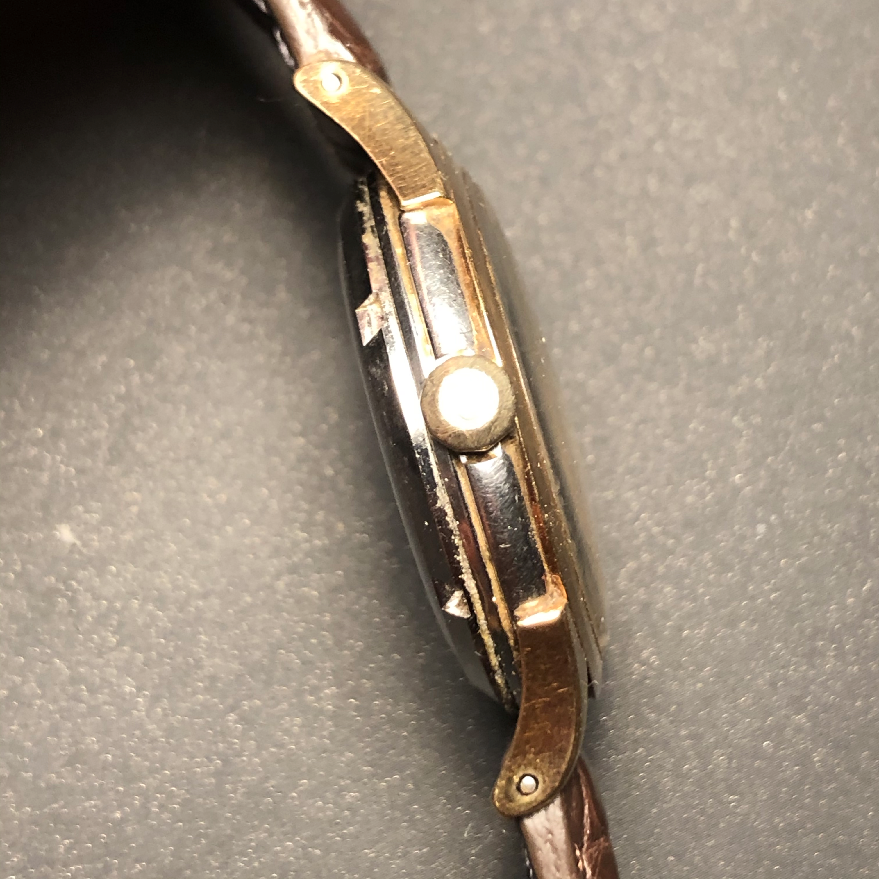

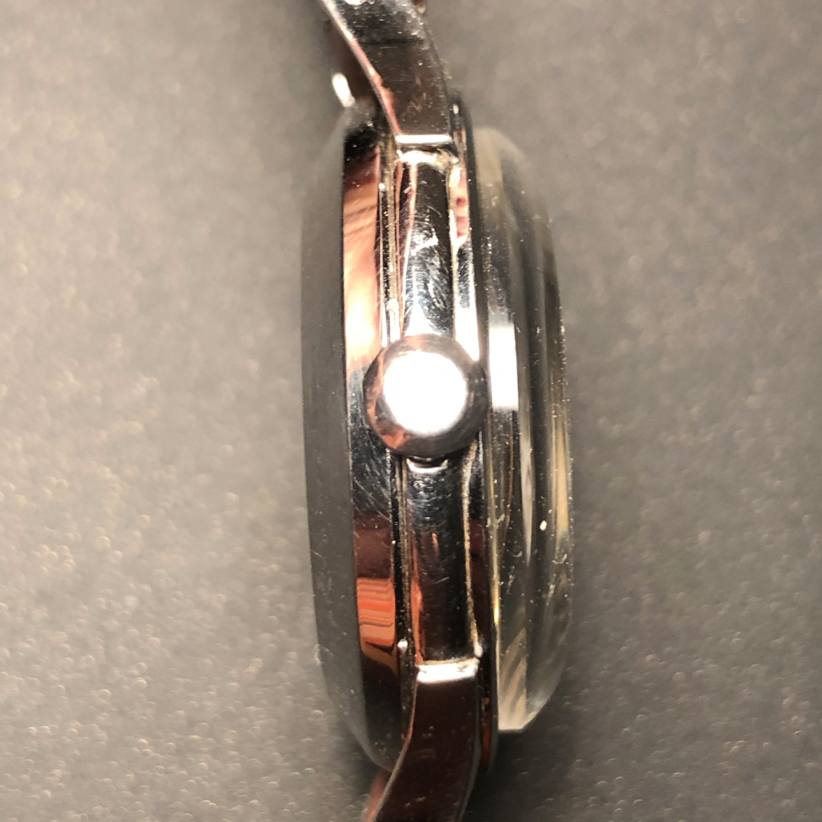

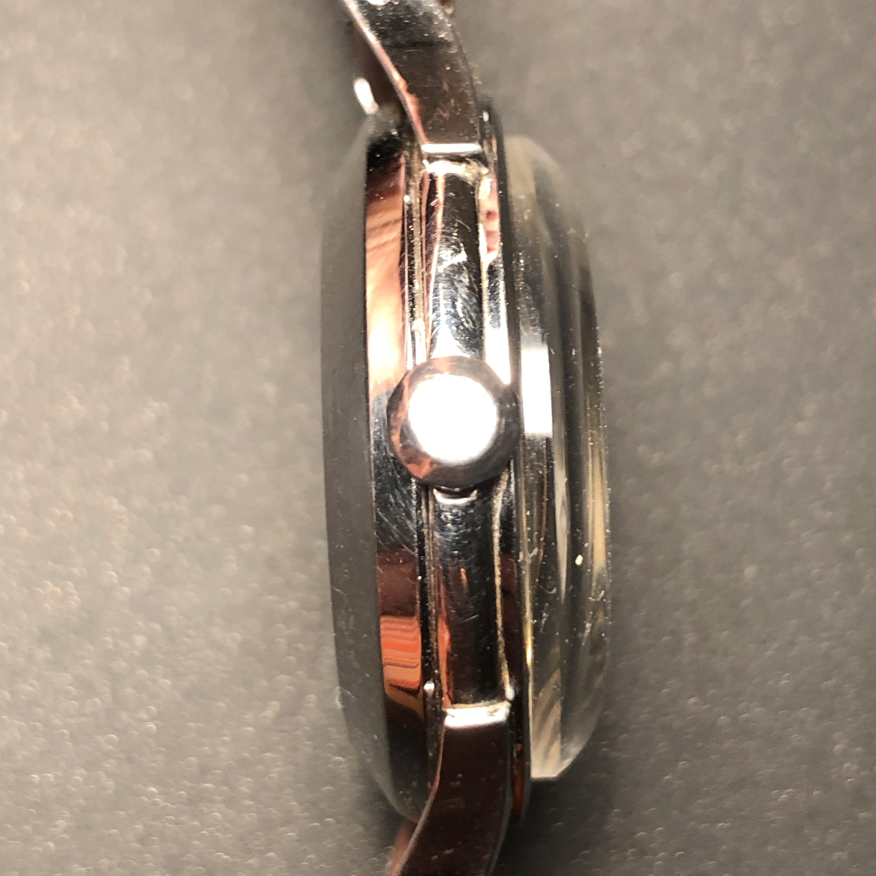

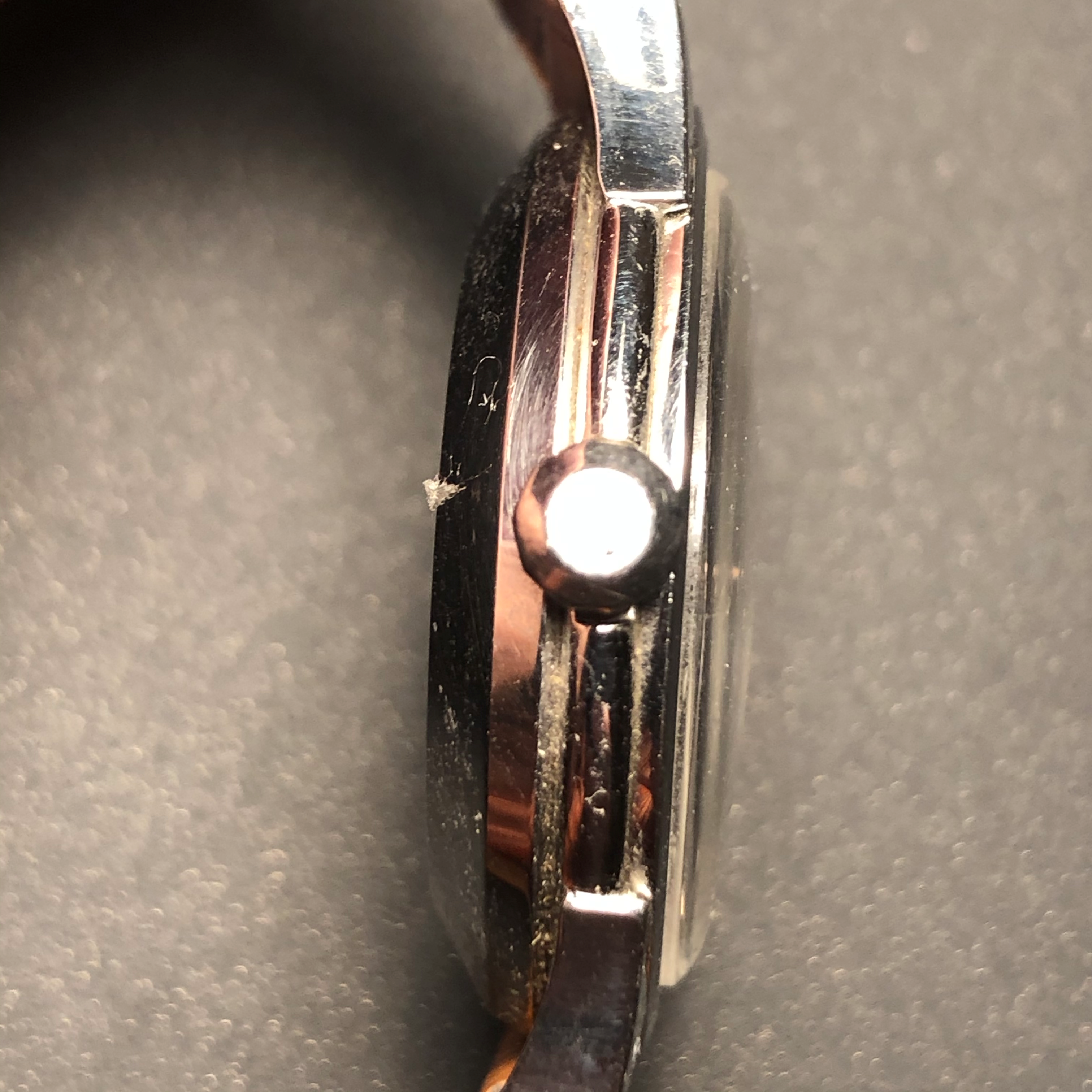

Before:
After:
After - notice the beautifully smooth continuation of the bezel profile. I don't know about you guys, but stuff like that gives me immense pleasure that the dial scratch and patina cannot ruin.
