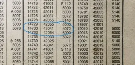

I'm not crazy to think that PZ5072 is the correct part number though right? The catalogue even says it in the image here:
Yes, it's the correct crystal according to Omega.
