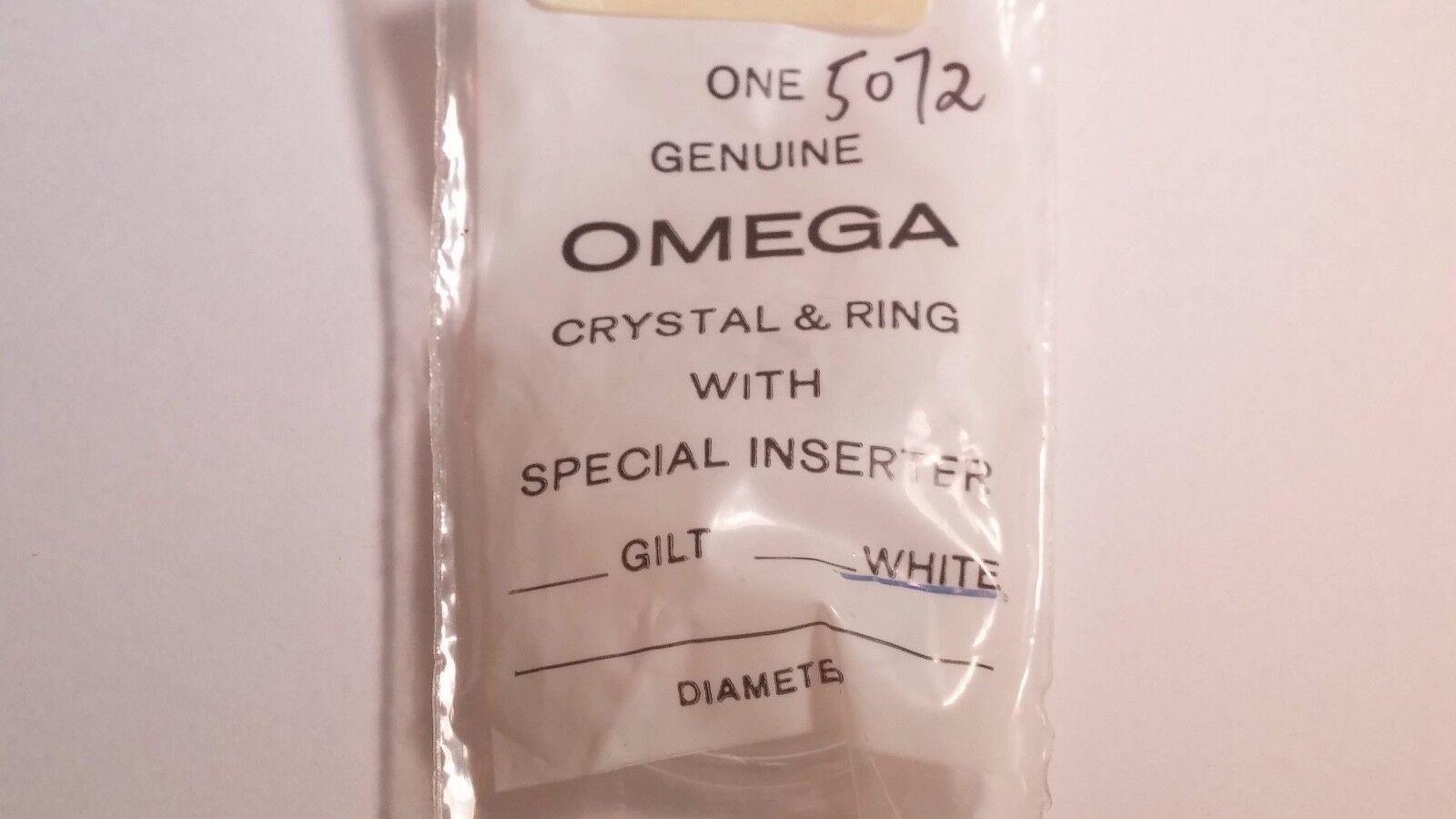

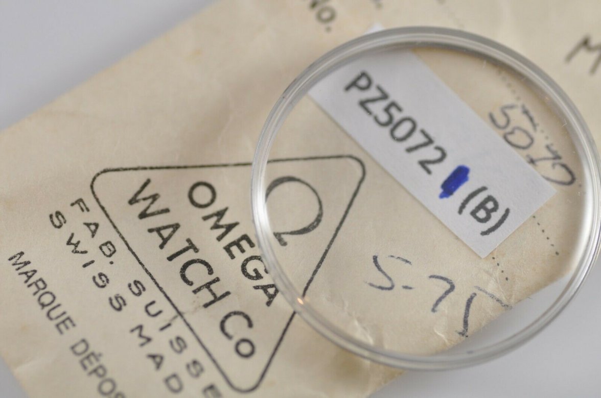

Quick bump on this thread to ask a question. I also very much prefer the original low-domes. However, that's not always an option..
So, has anyone been able to source genuine Omega low dome crystals? I've seen three types of packaging - see below, presumably in order of oldest to newest. Do #1 or #2 tend to be low dome? I know #3 is not.
#1 - paper sleeve packaging
#2 - plastic bag packaging
#3 - new Omega packaging

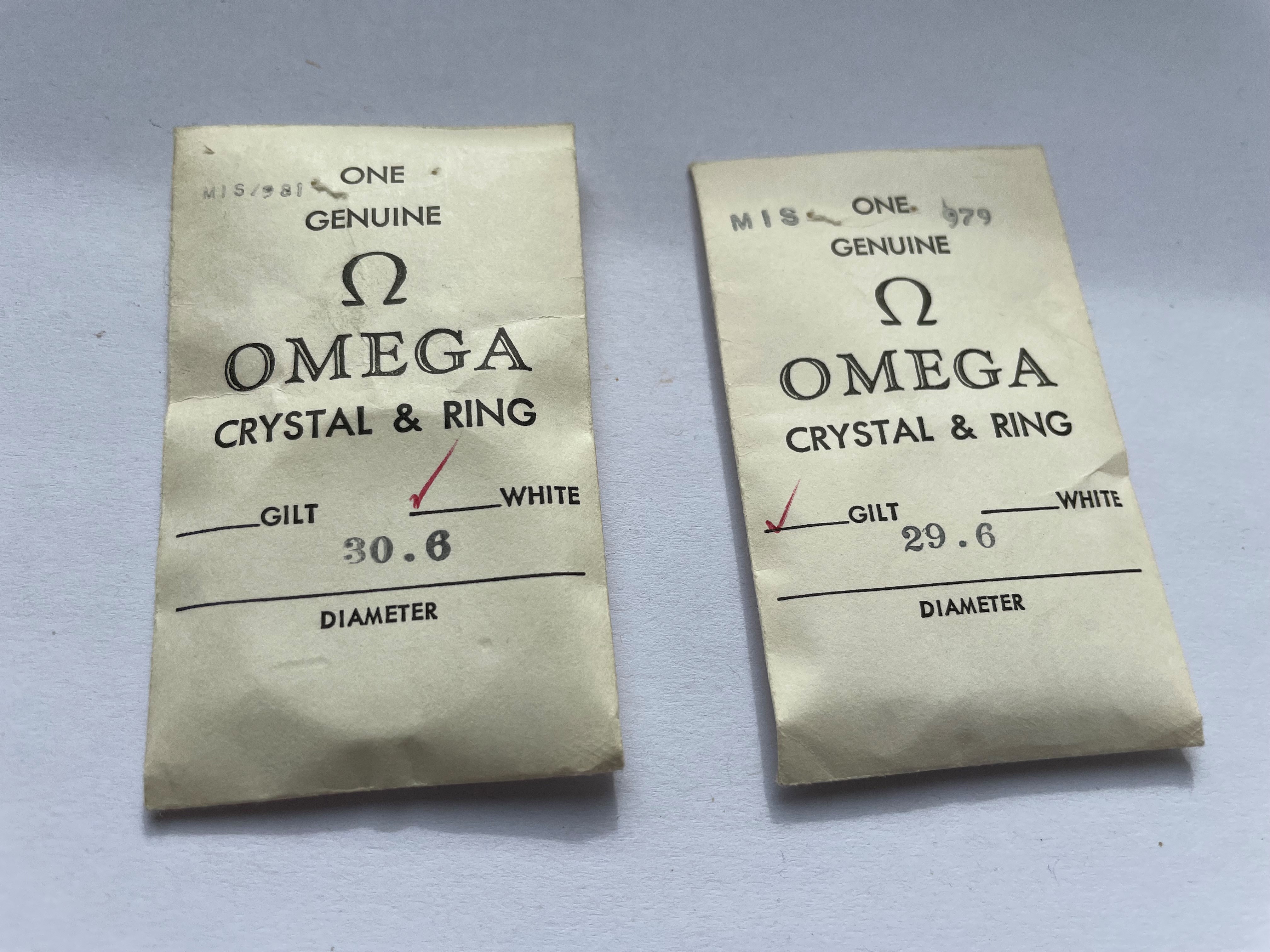

I've just ordered a paper sleeve packaging, fingers crossed it's the low profile. I'll update when I get it ...
1,719
7,388
We await your update!
140
115

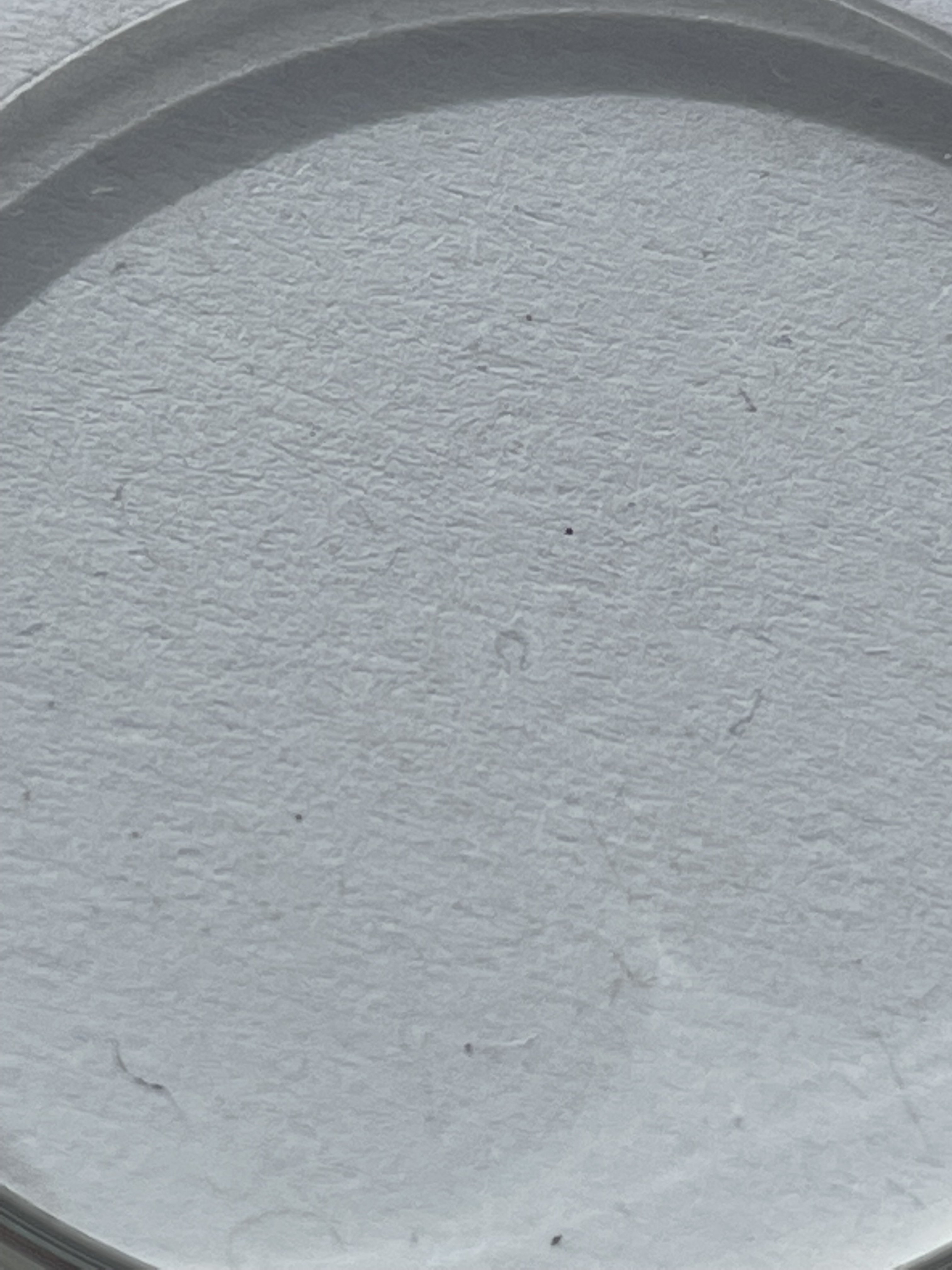

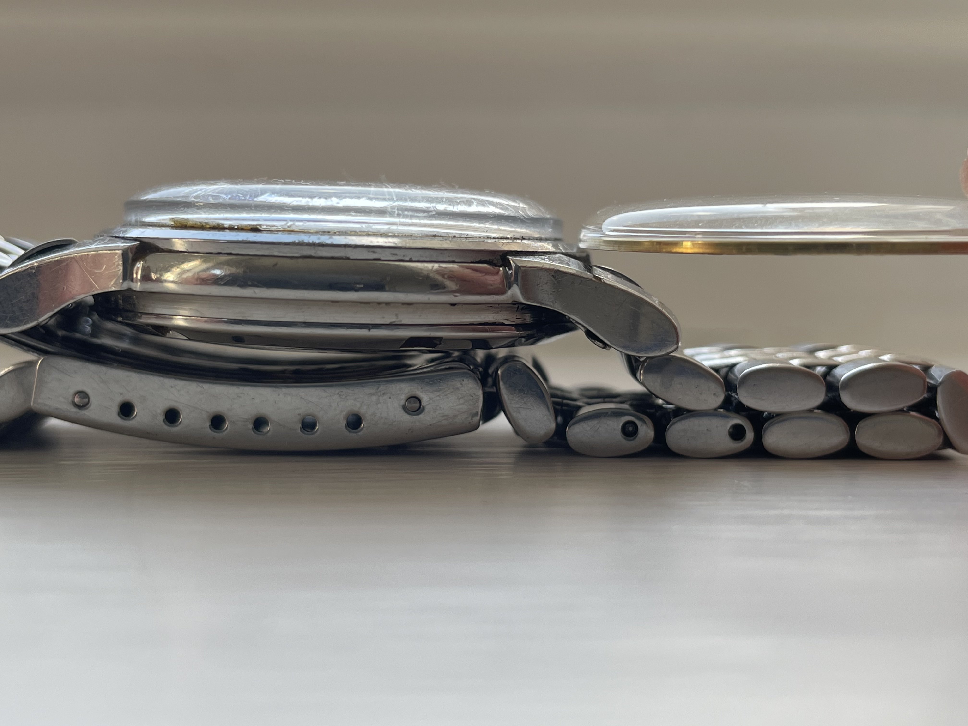

Ok so here's what I ordered (ebay seller jameschat10 - friendly, helpful, other sizes)
140
115

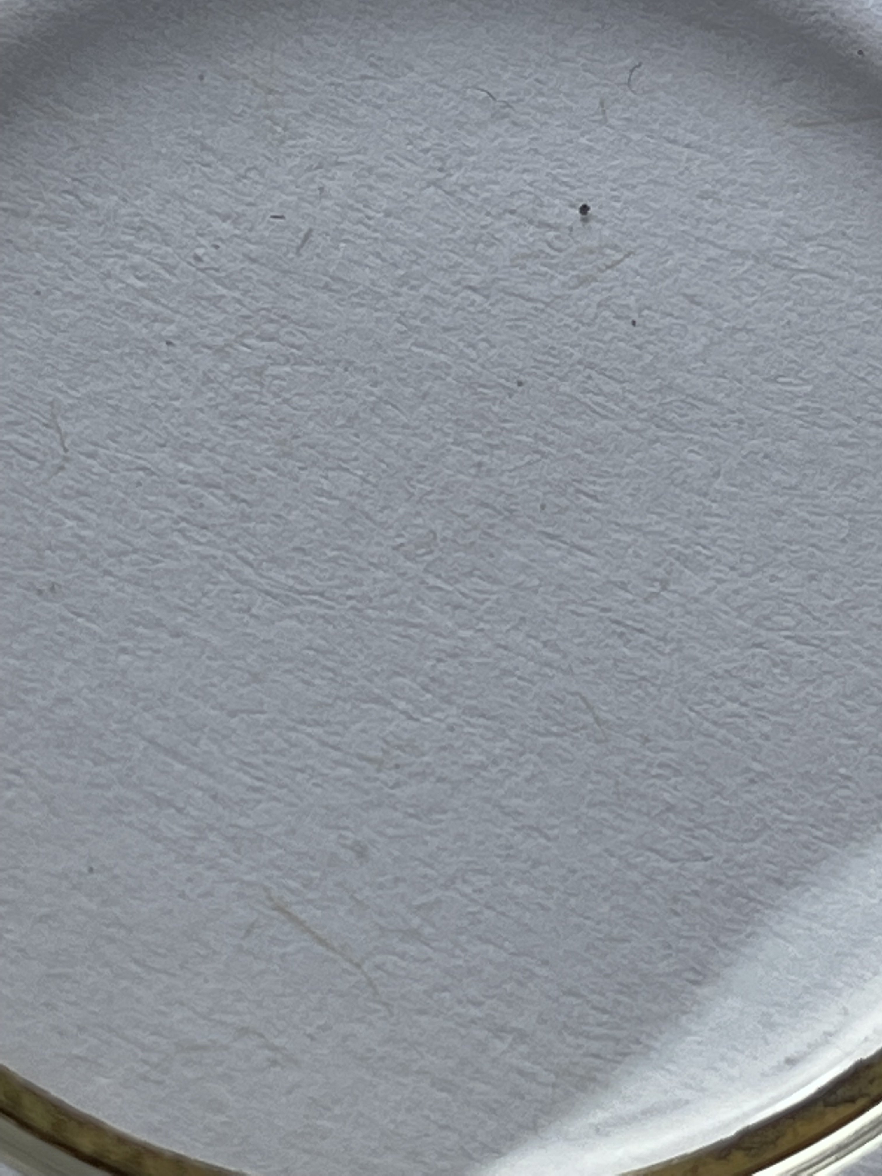

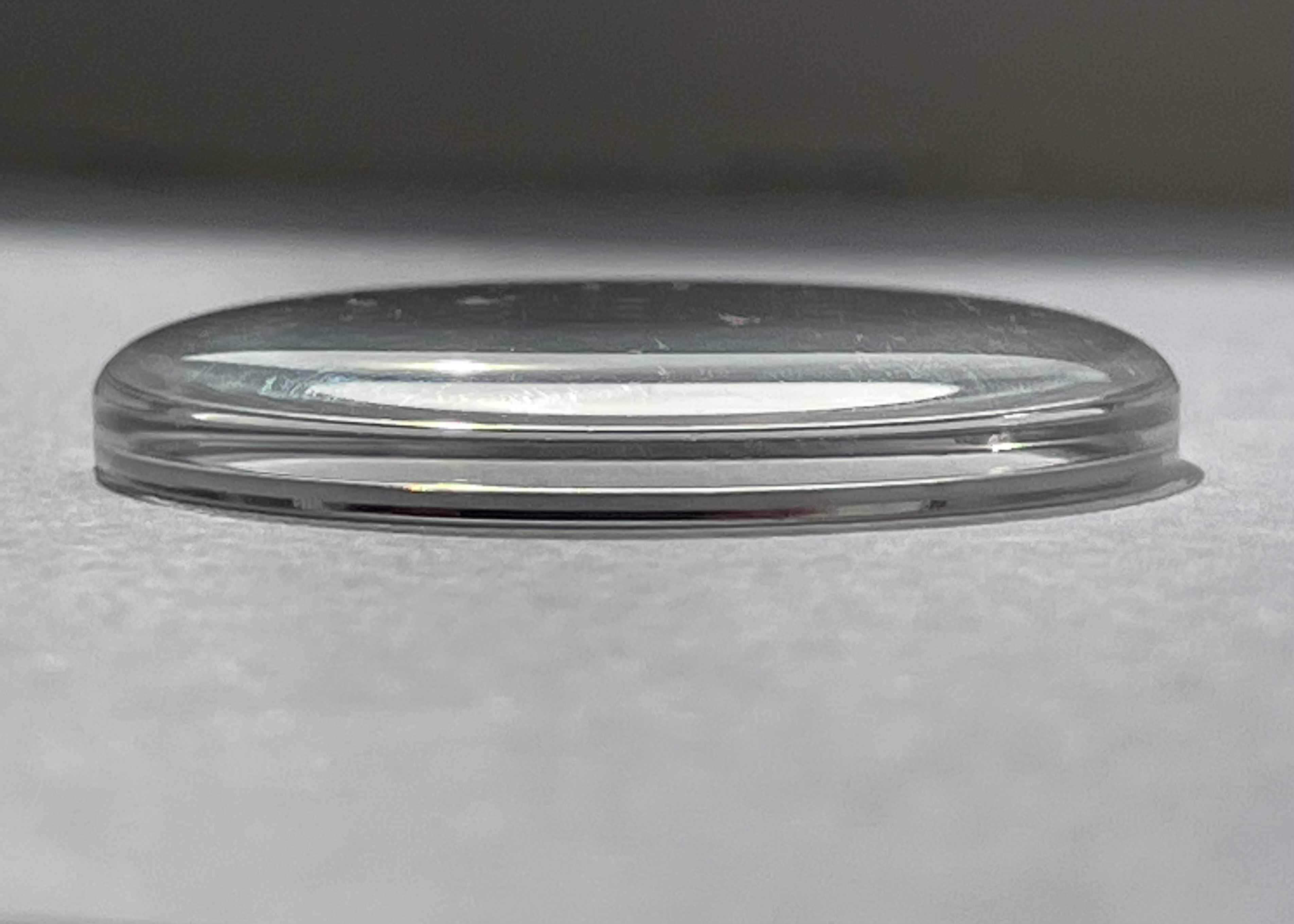

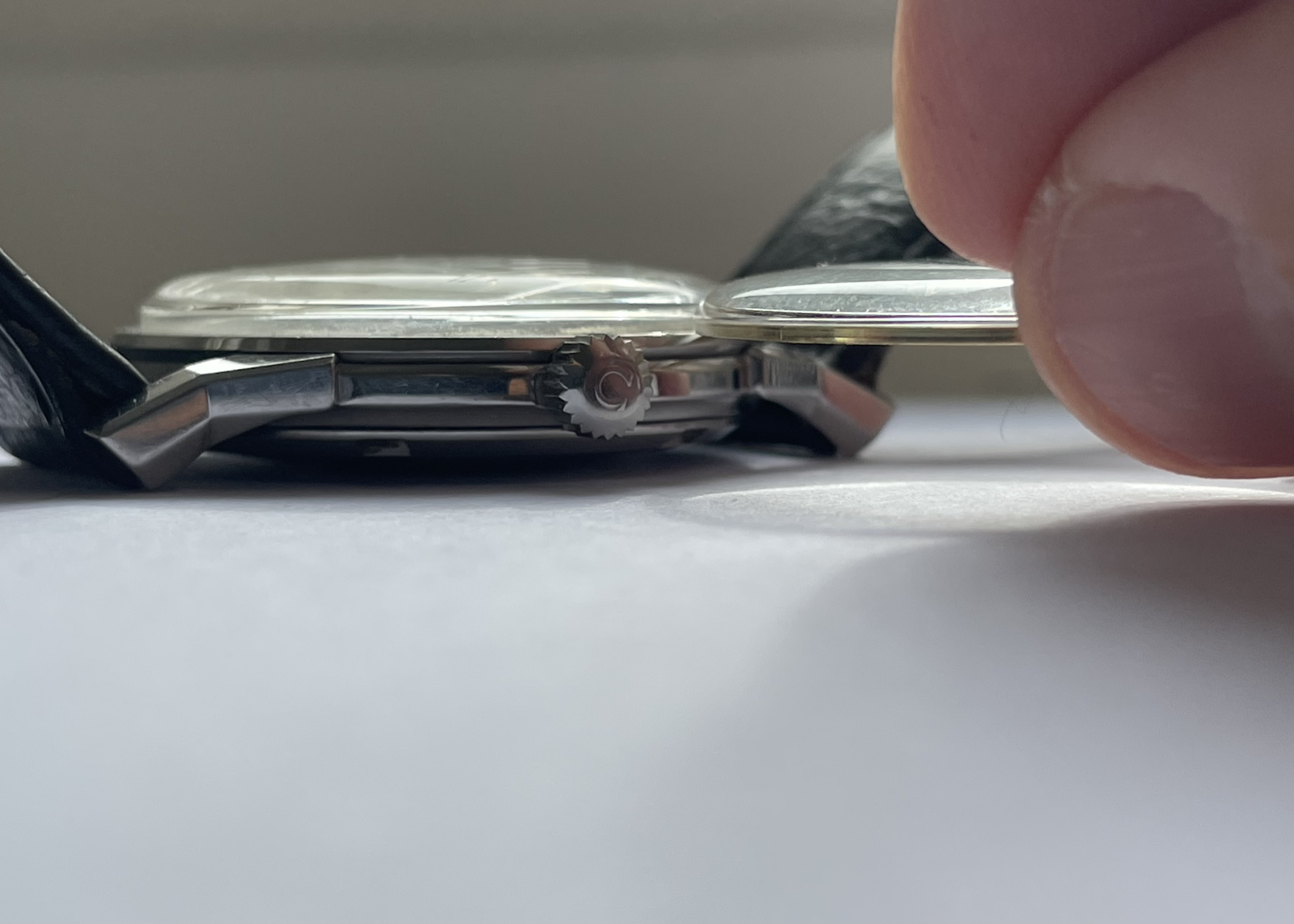

The 30.6 is ~ 4.4mm thick and it's easy to see the Omega symbol. The 29.6 is 3.4mm thick and I've spent ages trying to capture the symbol, not sure if I've convinced myself that grains in the paper look like the symbol! The 30.6 is going on a
* Case No. 14900 - Crystal diameter of 30.6mm = No. 981 = PZ5014
* Case No. 14393 - Crystal diameter of 29.6mm = No. 978 = PZ5140 (he didn't have this one, so I bought the gold 979 hoping to re-use the existing tension band (or have this as a spare if I find another one).
Writing this out though I realise I've been a boob and photographed the 29.6 on the 14900 instead of the other way round. Anyway here you go for now, I'll take pictures the other way round when I have them out again!

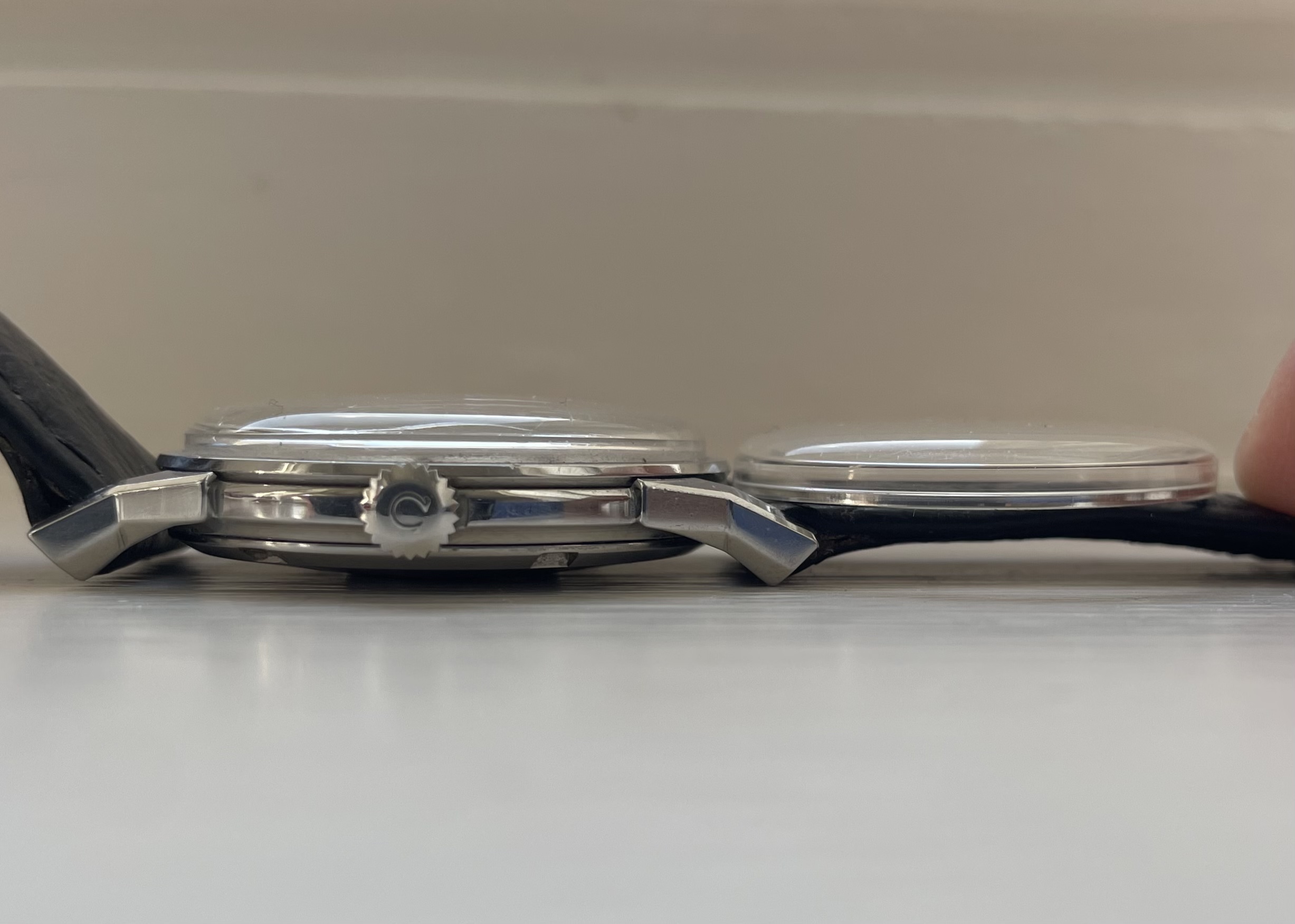

First the 30.6mm / No. 981 / PZ5014 (compared with 14393 instead of 14900):
140
115

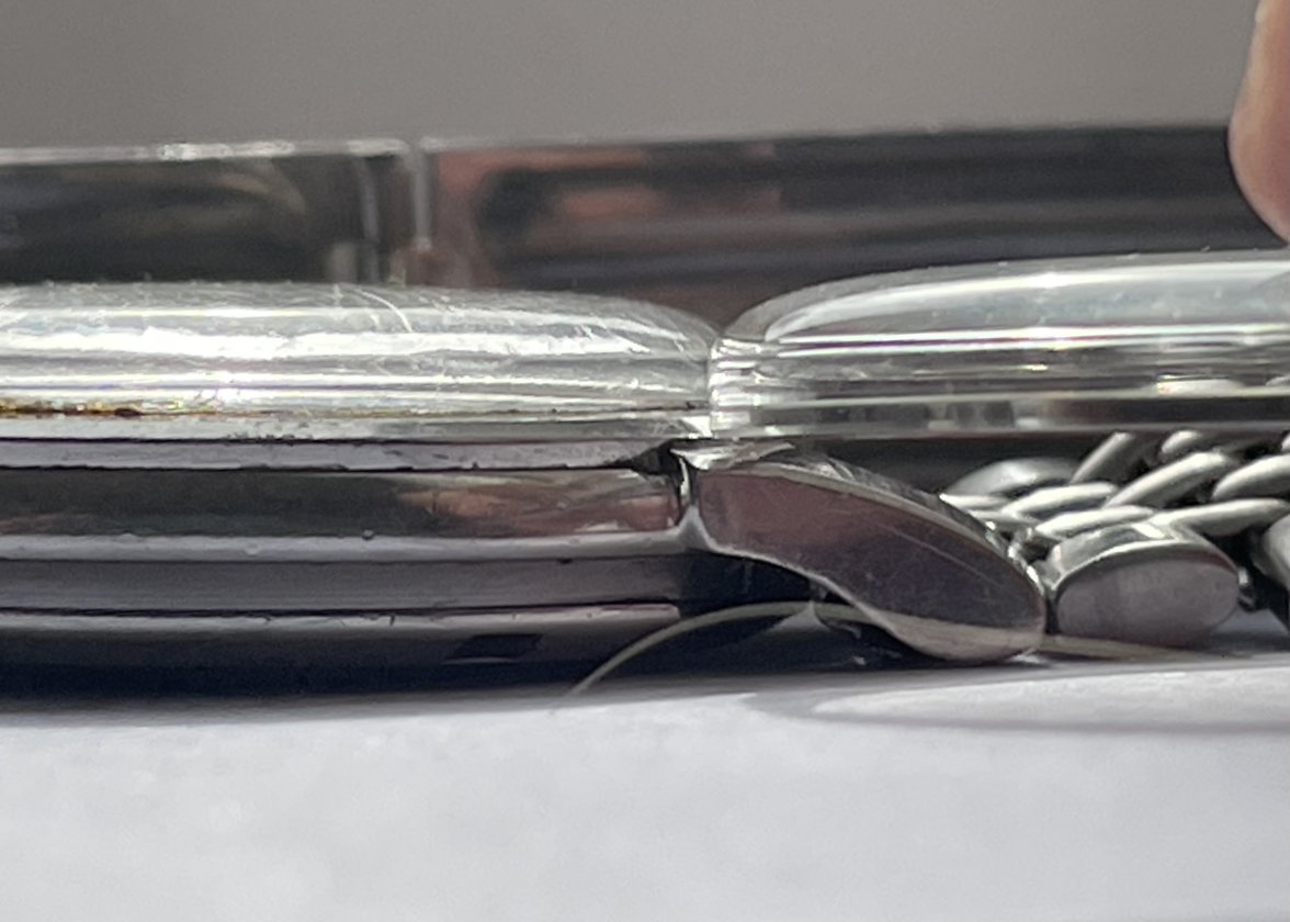

Btw meant to say, pretty sure neither the crystals in these watches is original.

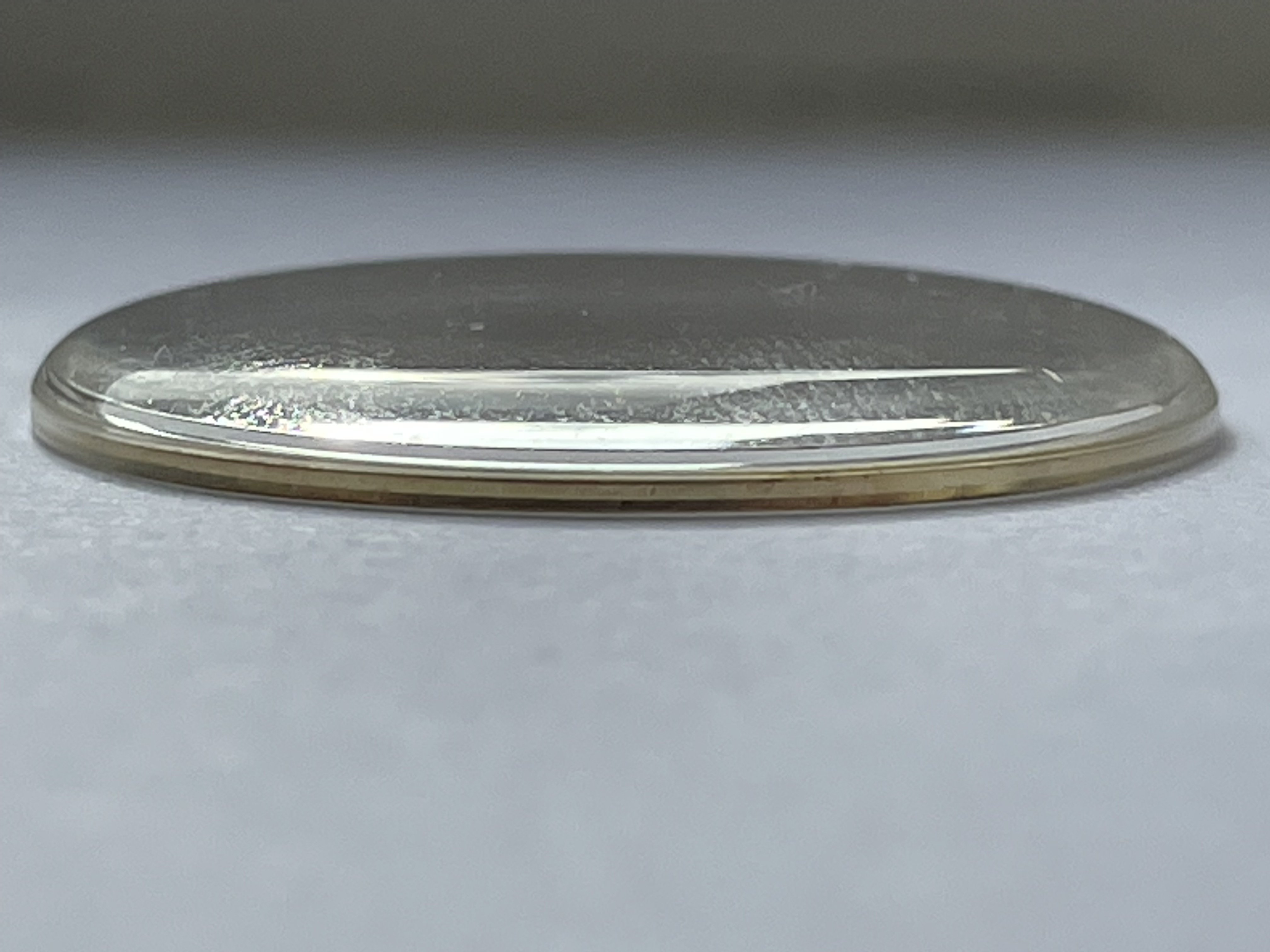

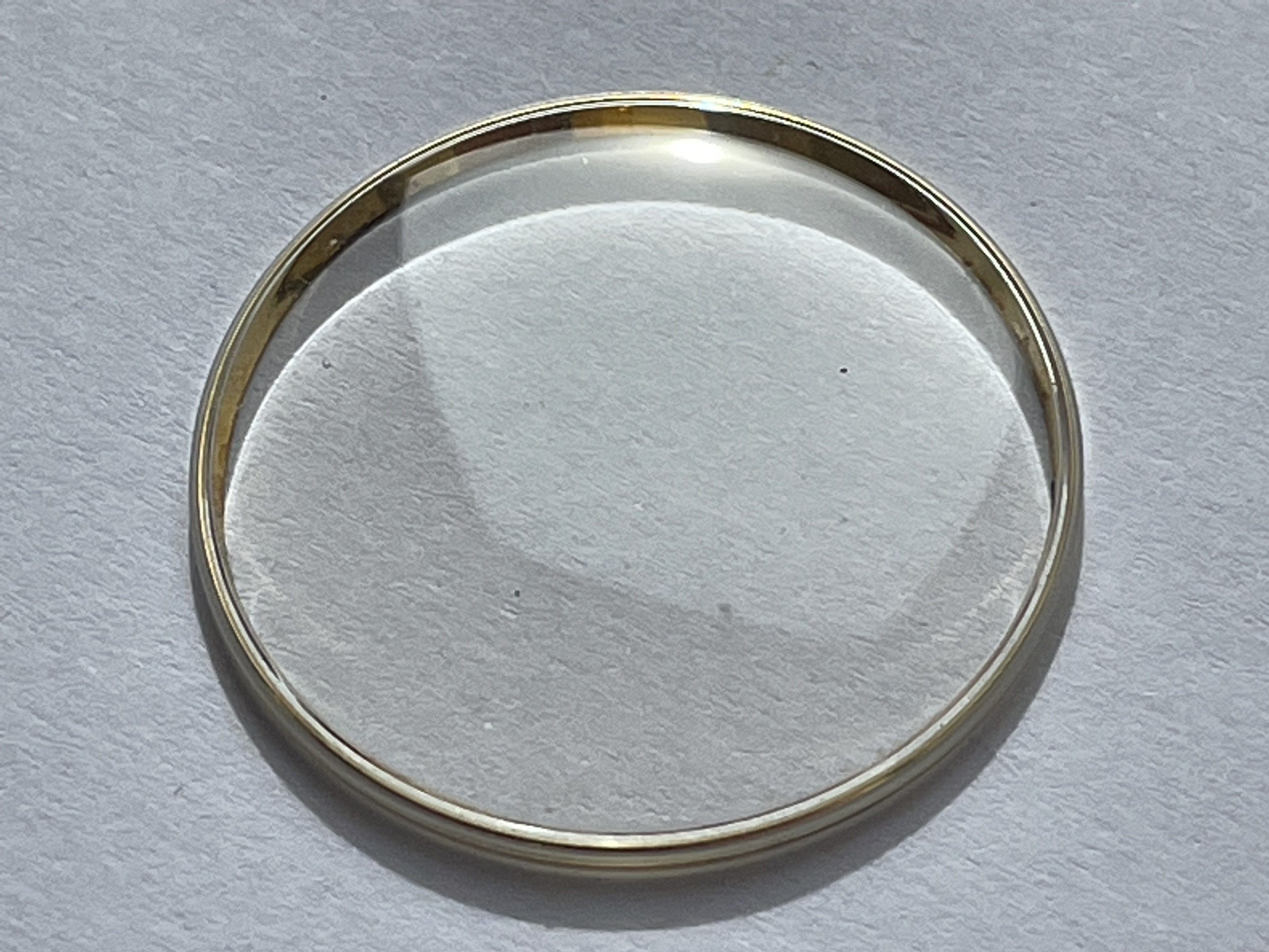

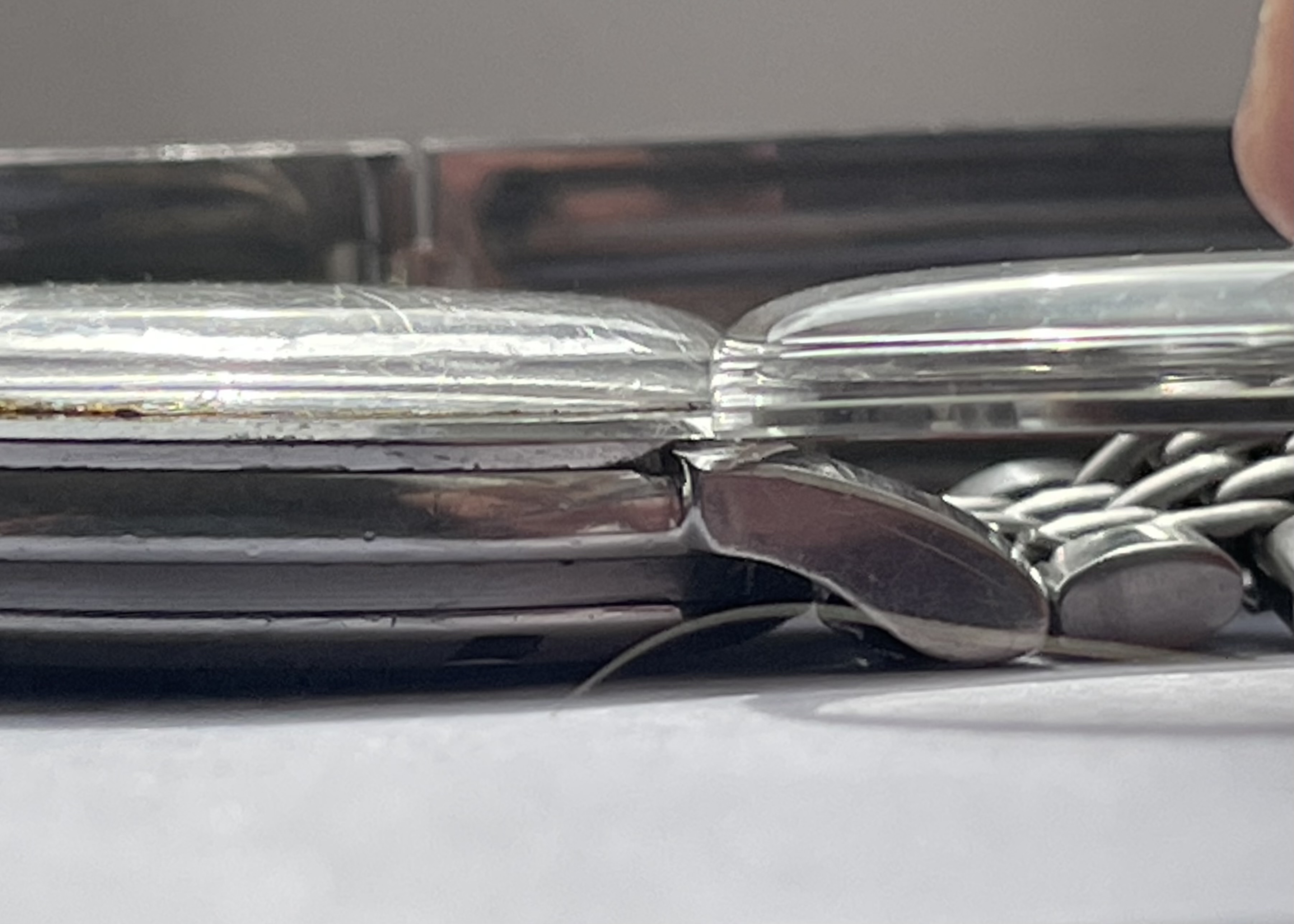

Now the 29.6mm / No. 979 / PX5140 (compared with 14900 instead of 14393):
1,719
7,388
The 29.6mm looks fairly flat?

@felsby I don't know my arse from my elbow yet but yes it seems like a low profile to me! Both the 29.6 and 30.6 look no worse than the crystals that came on the watches and the 29.6 does look better.
