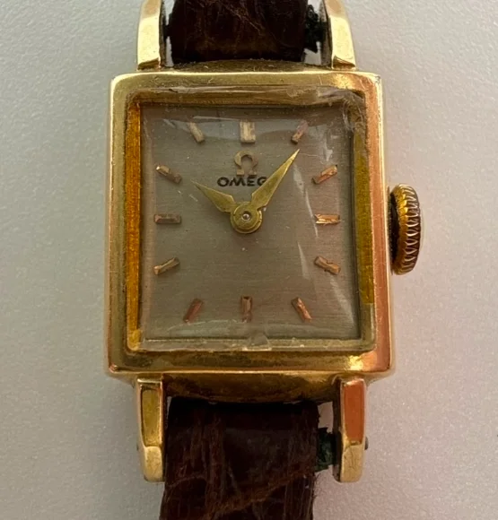

Looking to replace the crystal on this watch as a gift for a friend.
4

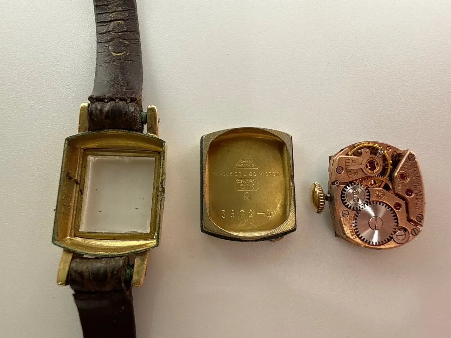

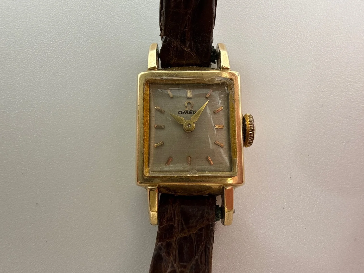

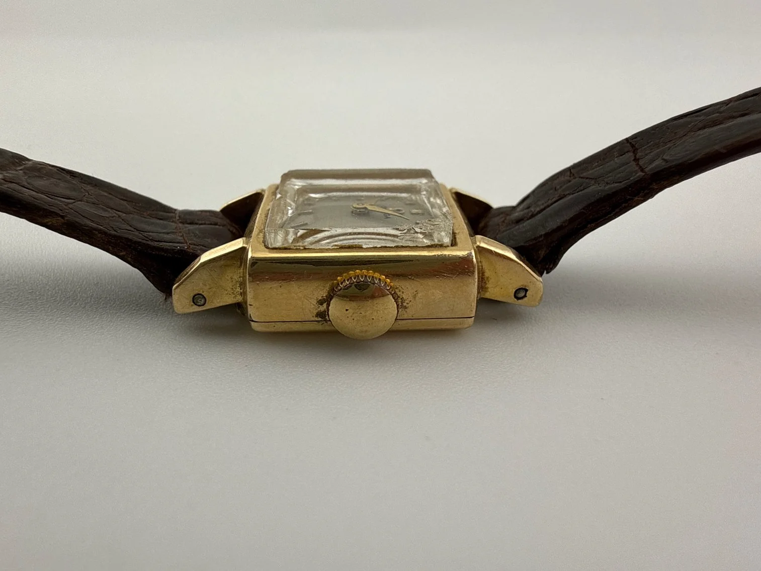

I'm looking to replace the crystal on this Omega ladies watch as a gift for a friend. I'm not looking for original and I'm definitely open to having an acrylic put in. Would anyone happen to know the model of this watch or where I can find something like this?
29,754
77,016
The Omega part number is 062PN2035.
Dimensions are listed as 11.8X10.8 - no height given

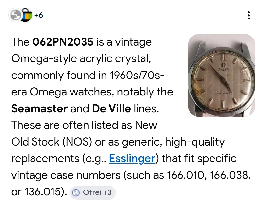

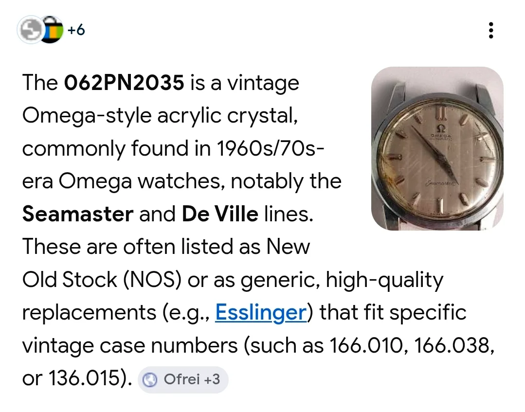

When I search this part I got a crystal for a constellation. Would you possibly be able to send me a link where I can find something like this?
This information is not correct. I am giving you the numbers directly from Omega...
I have no idea where you would locate one, other than to take this to Omega or an Omega certified watchmaker, who can order the crystal for you and install it.
124
109
I think you could try it with those. They need to be filed down to fit anyway, so about 1 mm on each side should get you there.
Can find them by size on cousinsuk..
AI strikes again.
