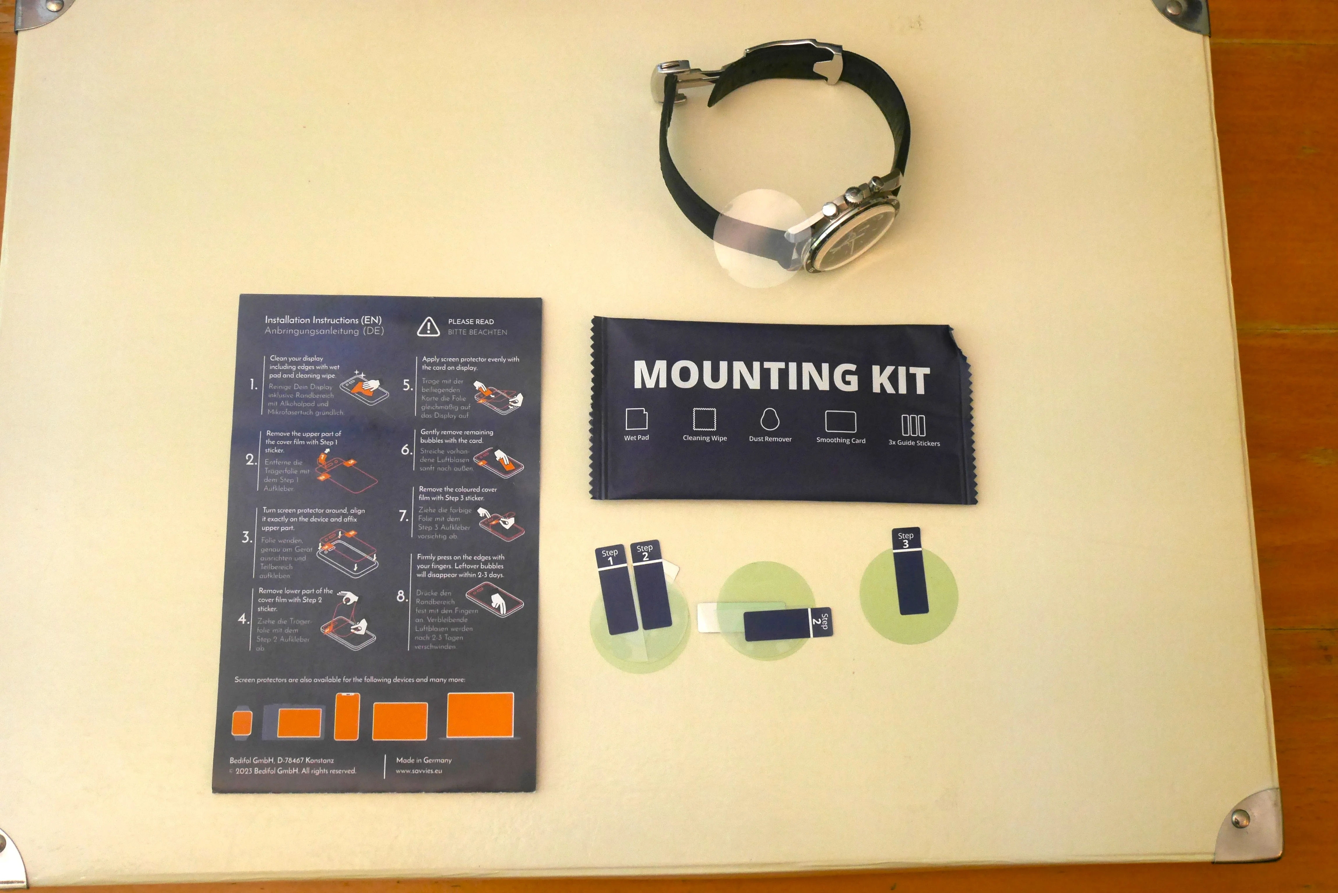

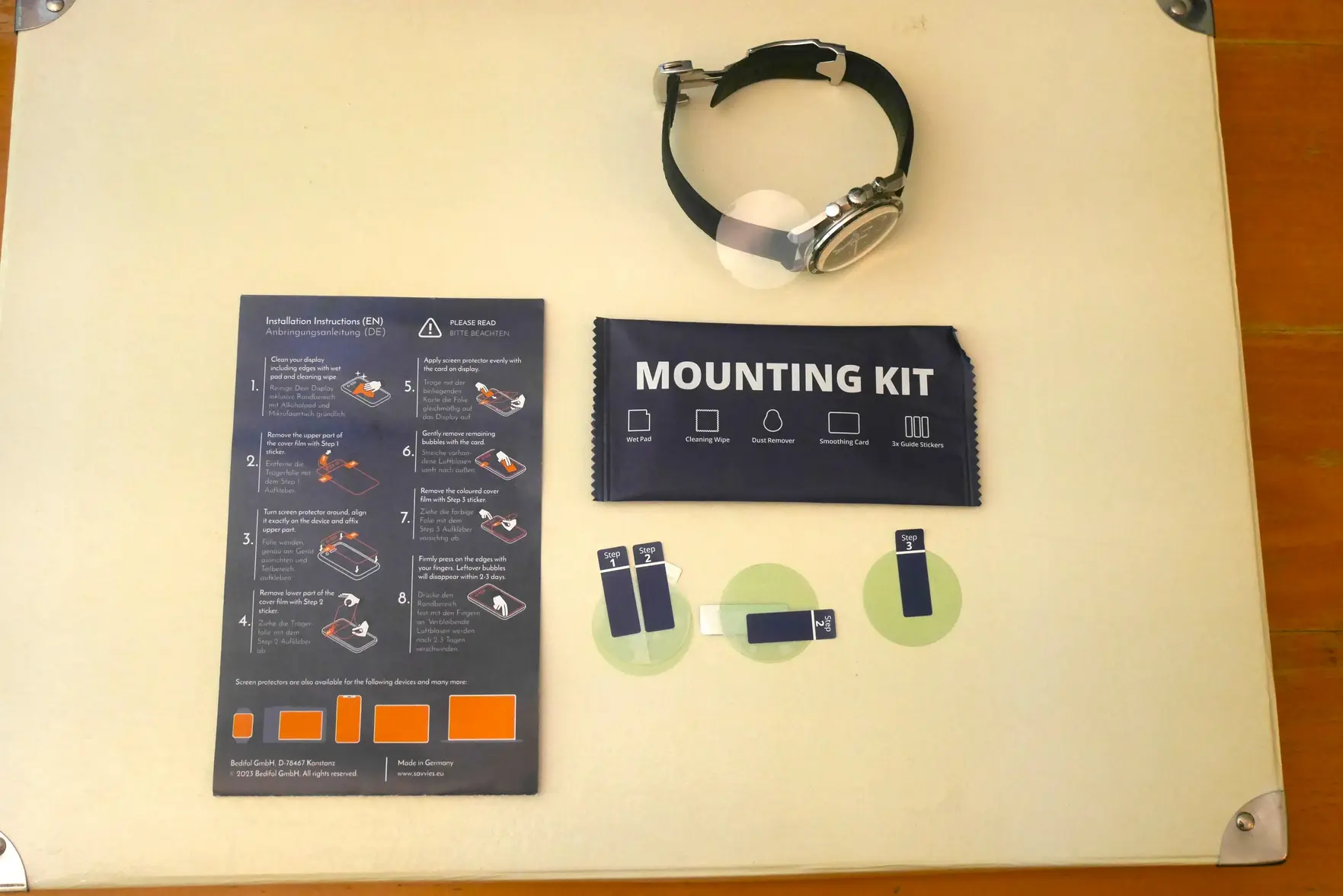

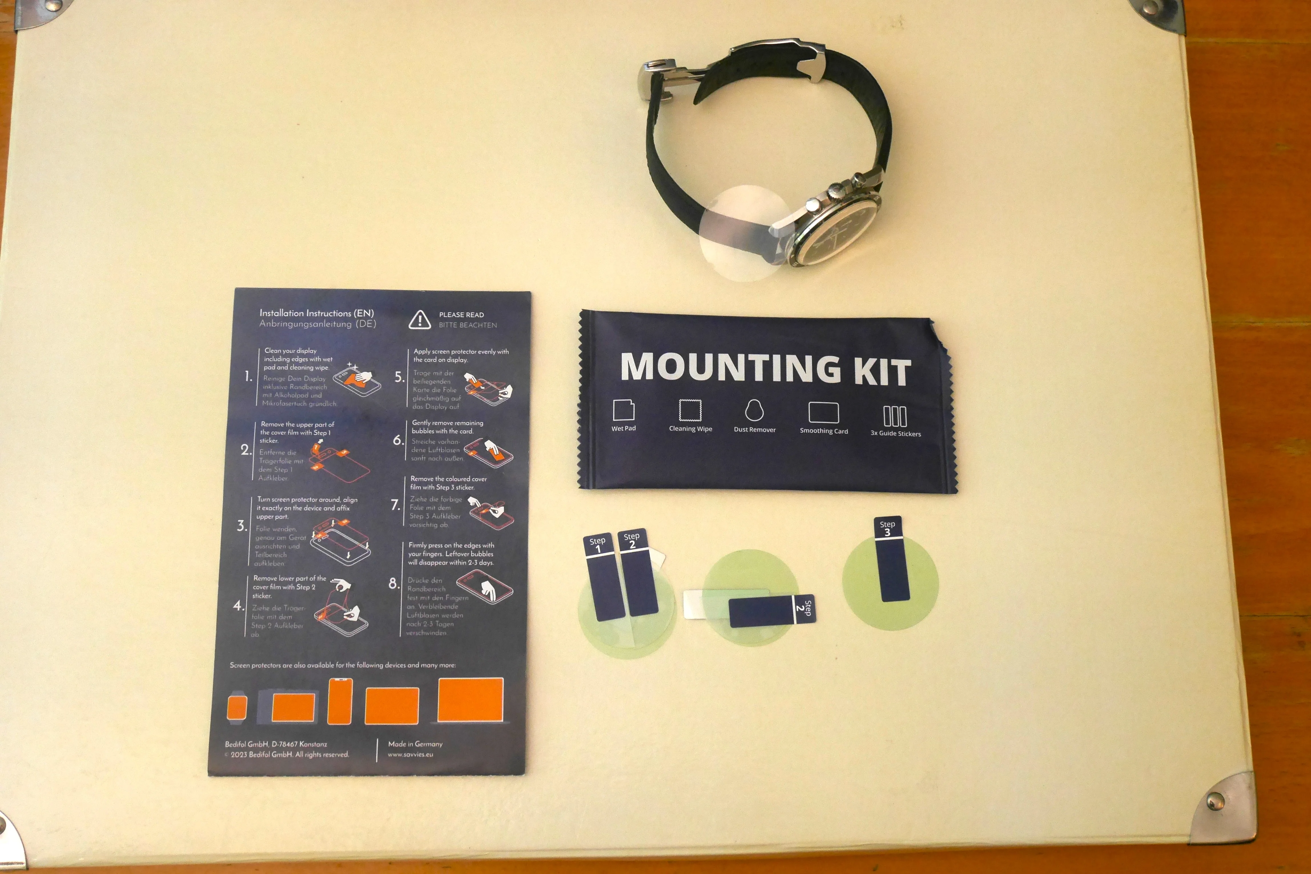

I stopped polishing and switched to Savvies clear stickers
