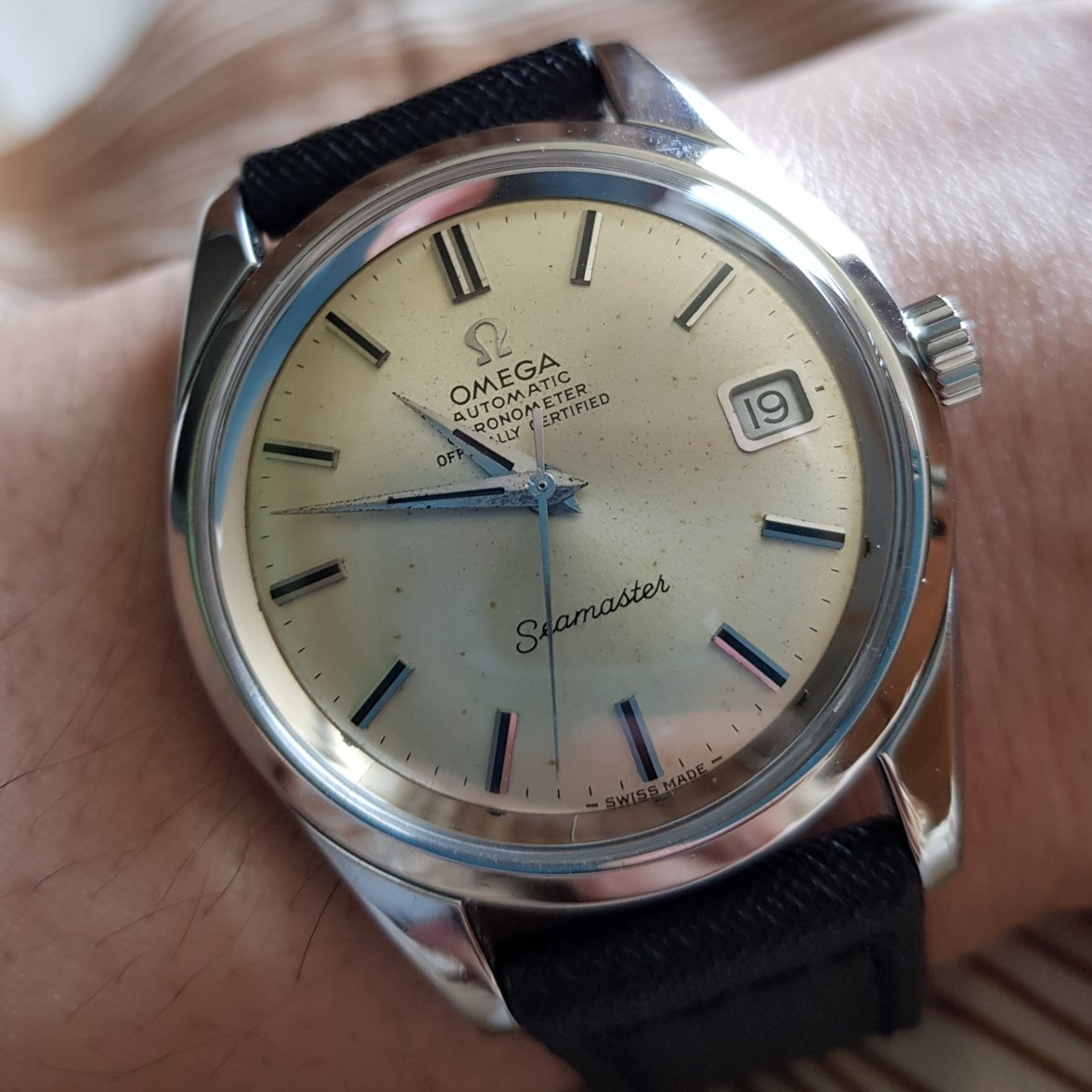

I have to agree with gator, I'm sitting here with a c-case Constellation with a cyclops crystal and the Omega symbol is 90 degrees off, so clearly if Omega didn't care if they were made with the symbol oriented "correctly" I doubt they were all put on lined up perfectly either.
It's 135 degrees out on the cyclops crystal on my sparkly.

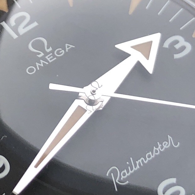

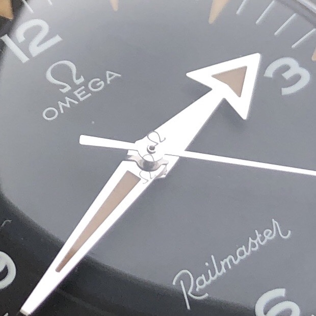

Not so if you include the Trilogy SM and RM, those have logos on sapphire, though that may well just be a historical nod and a one (well two) off. If Omega want to do it they can.

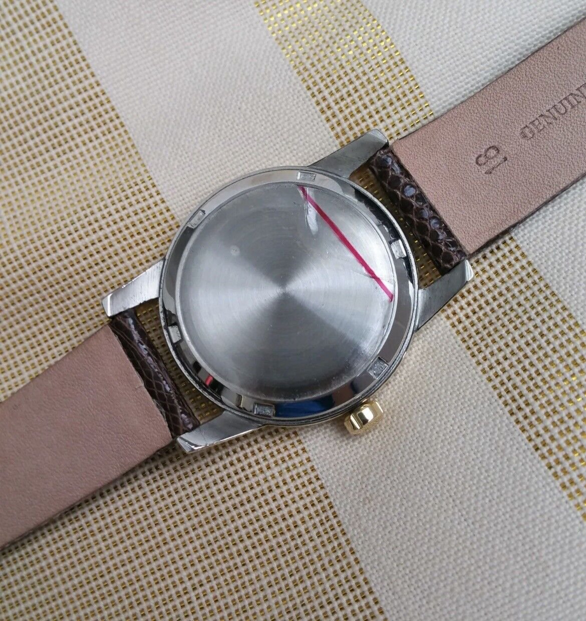

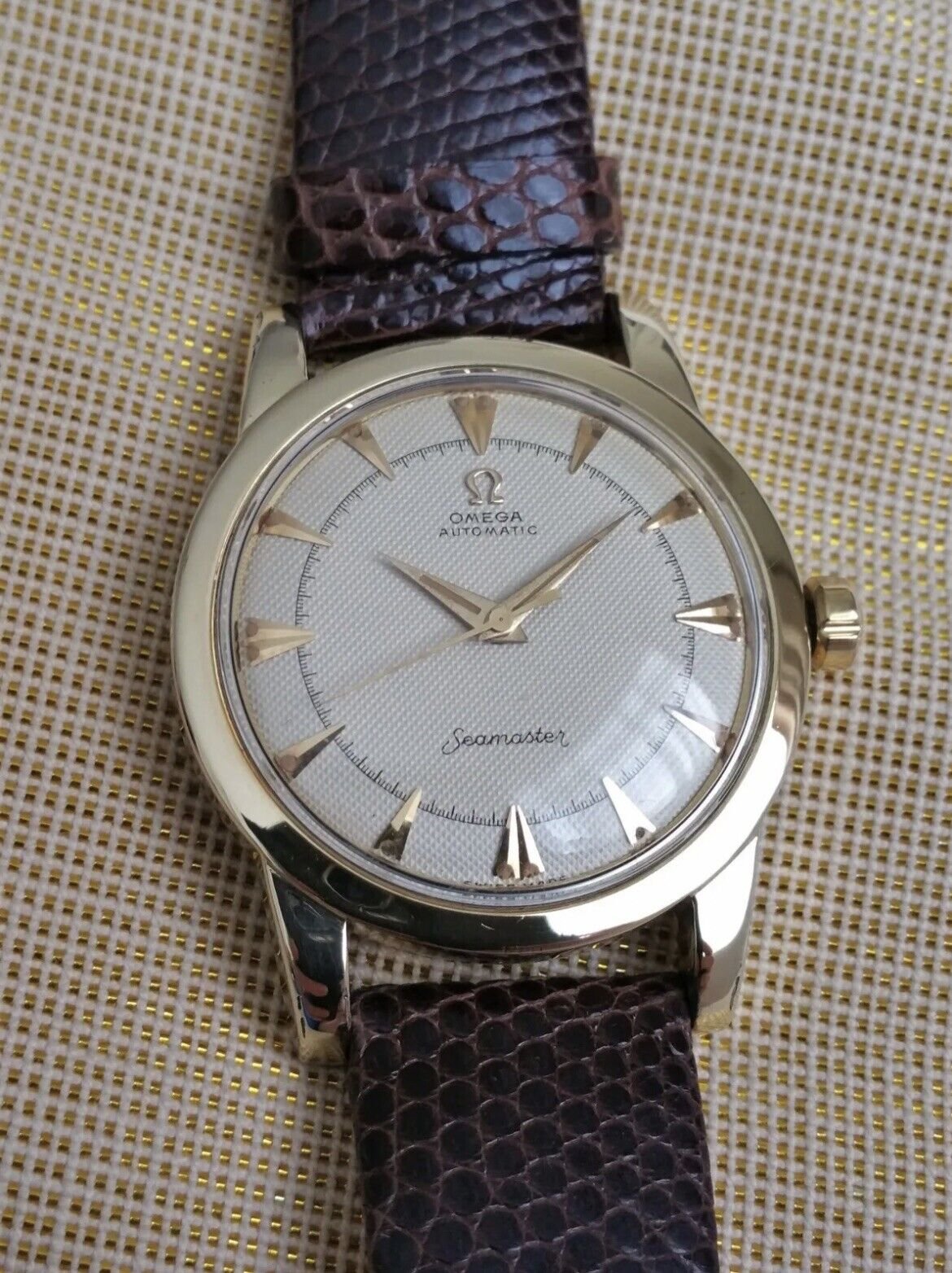

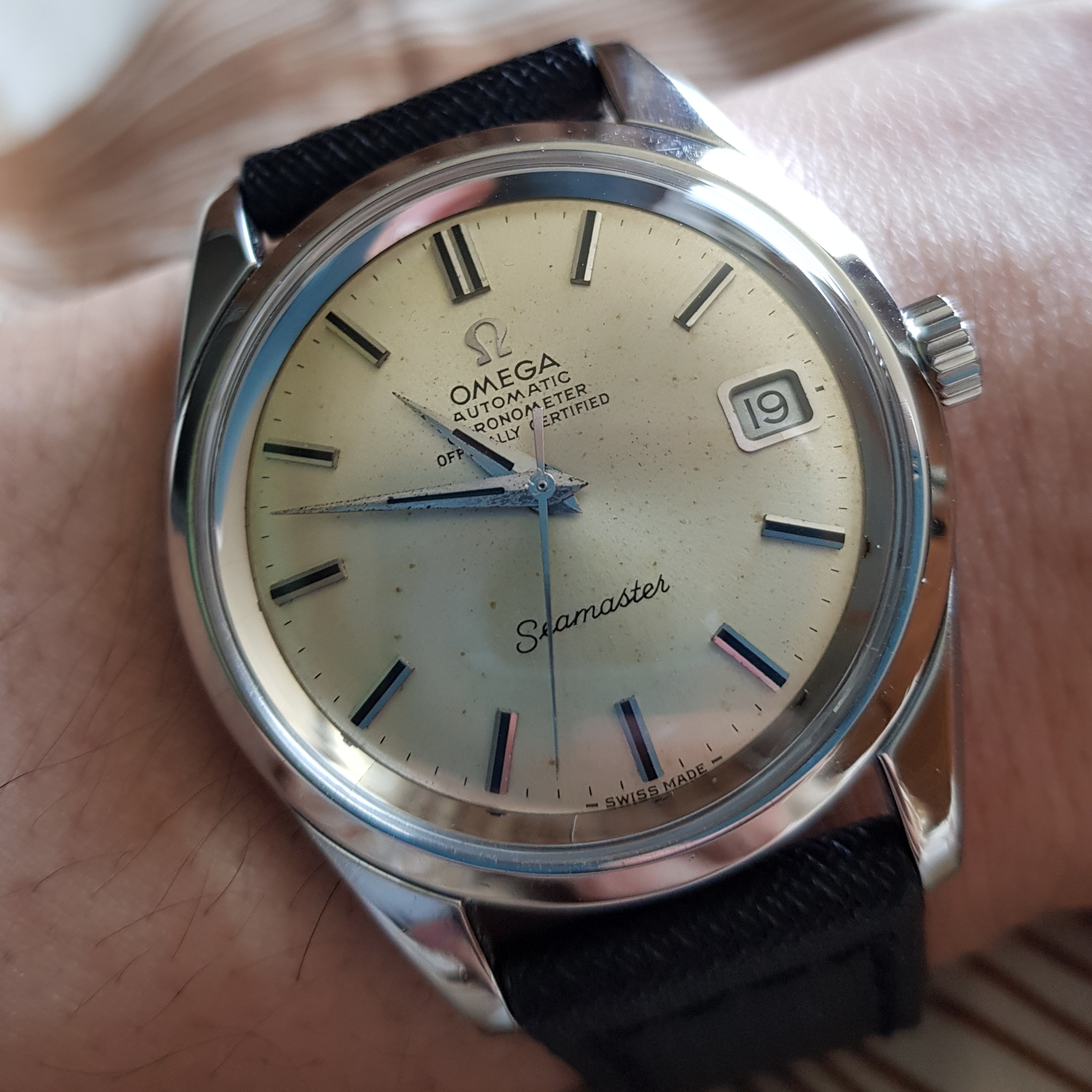

I just bought a NOS Seamaster from 1952 and there's no logo on the crystal. This watch has a seal on the back that is centered on the case back perfectly and looks original, but I'm not sure about that either. There's like no wear on this case or crystal. I've never seen a NOS Seamaster from this era and it checked off the gold Seamaster and waffle dial boxes.
I have several Seamasters from the 50's and 60's and there's not one signed crystal amongst them. I have no idea if they were replaced, many had scuffs and tiny scratches that I polished out.
10,777
16,776
Many Hesalite crystals weren’t signed. I’m not surprised to see an early 50s watch without a logo. There are signed sapphire crystals too. I suppose they meant that there are no mineral glass crystals with logos. That is AFAIK true. I suspect the logo crystal was introduced around 1952-55 depending on model.
What you show there isn’t a seal, it’s a modern caseback sticker. If you have 60s Omegas without crystal logos, they are probably non omega crystals.
