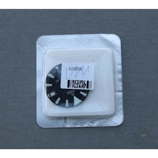

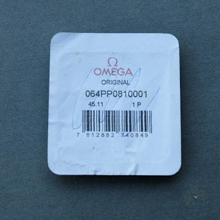

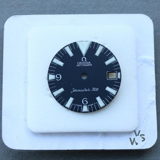

This dial is junk - Omega stopped using tritium in the late 1990's, so a dial made in 2011 as the package indicates would not be a tritium dial. The part number on the package is for a regular date dial, no big triangle, and no "T swiss made T" above the 6 marker - on the proper Omega dial it is under the 6 marker, and just says "Swiss Made"...
Someone has simply placed a fake dial in a real package.
