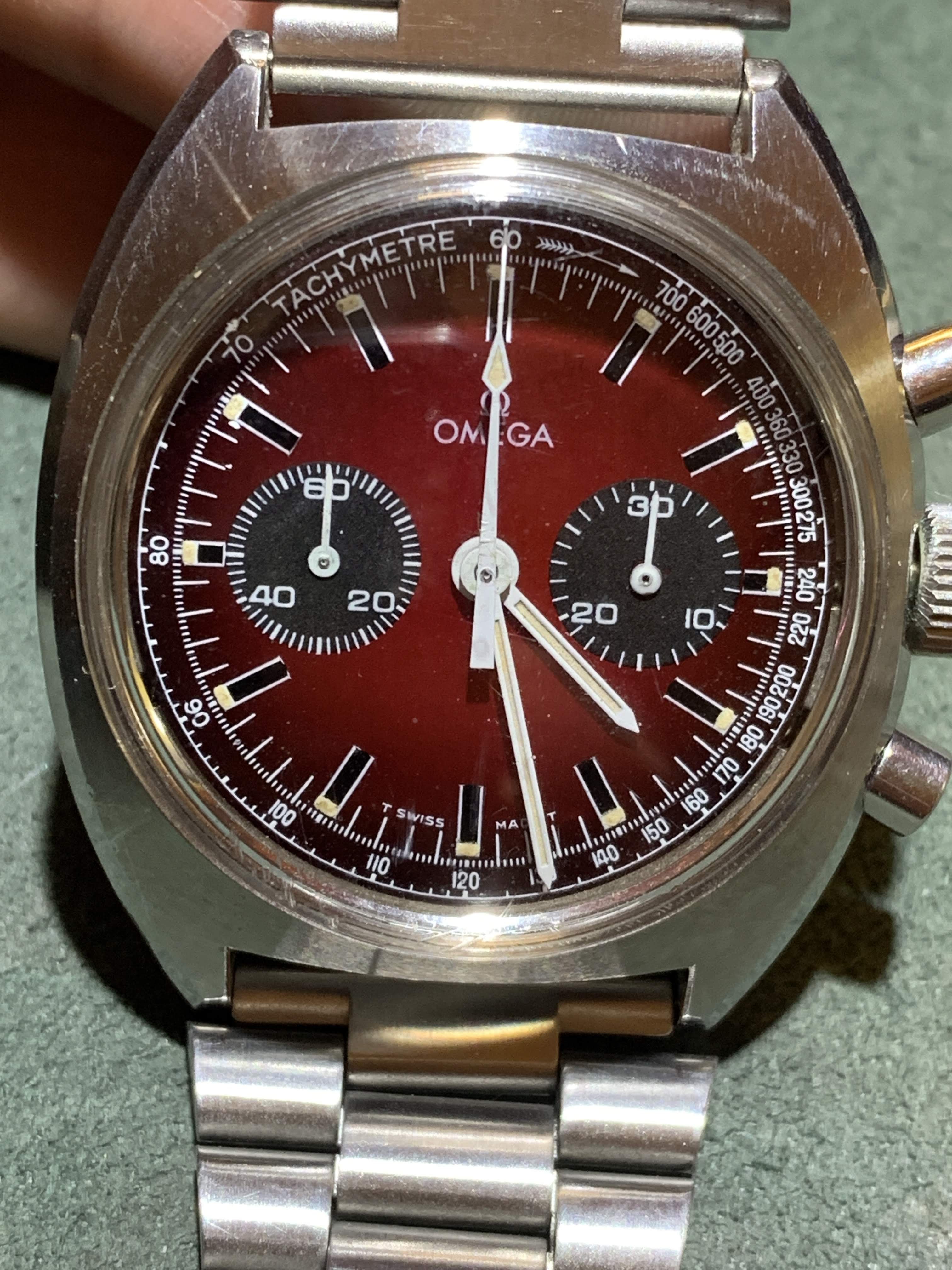

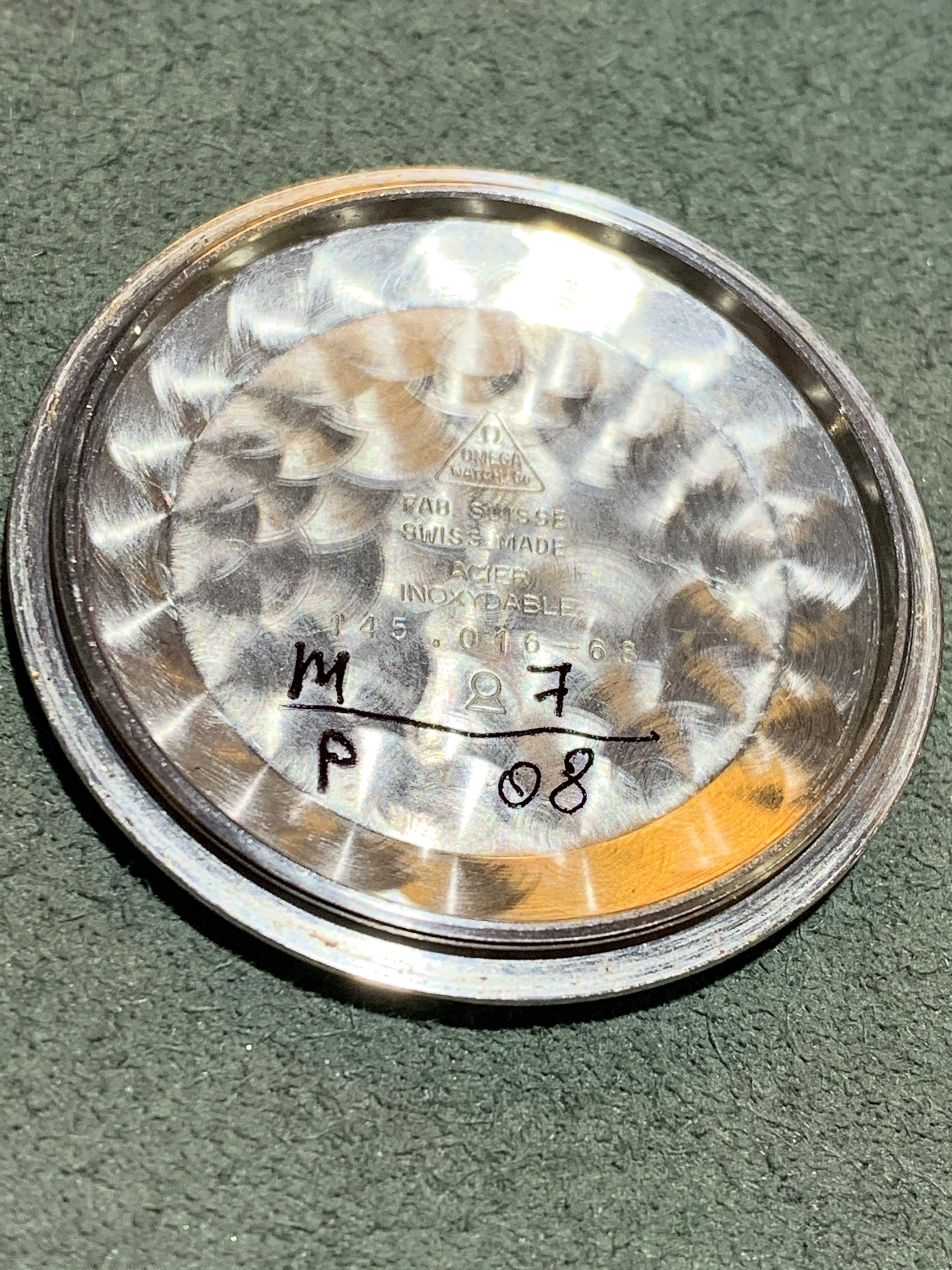

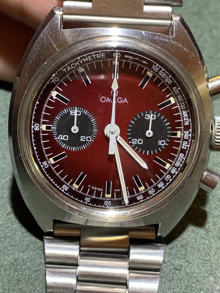

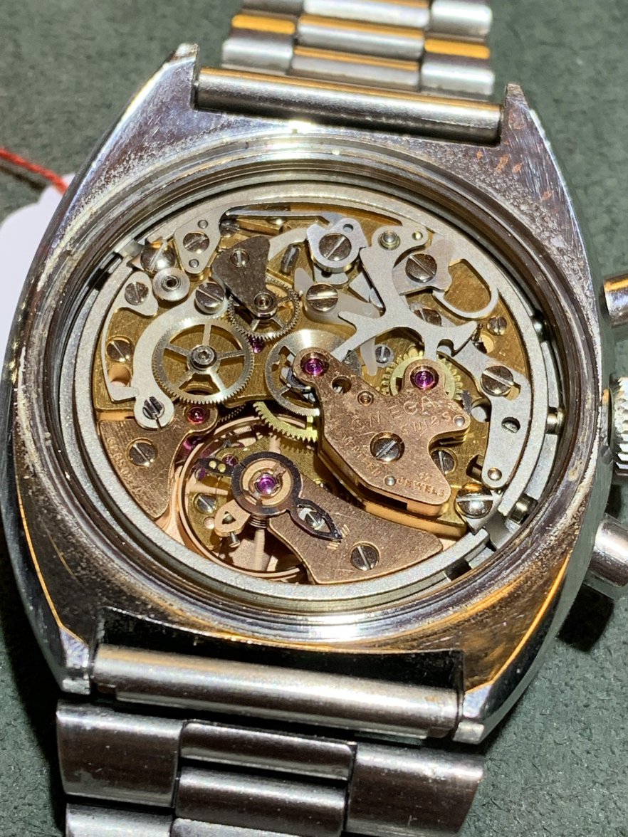

Hello everybody,
I have the chance to buy this Omega, it looks completely original but I can't found any information about it.
The movement is a classic Omega 860, the case looks quite a dial looks a DeVille and the case a Seamaster.
Couls you please help me to better understand which model can be?
Thanks in advance!
1,134
1,690
I've never seen a dial like that, and on top of that I don't like how the subdial print is quite sloppy... so I vote redial. I might be wrong as always though!
8,701
14,612
It's more than a redial; the 145.016 has an 861 with 3 subdials, this has an 860 with 2 (should be in a 145.017). I think this is a good example of a franken.
