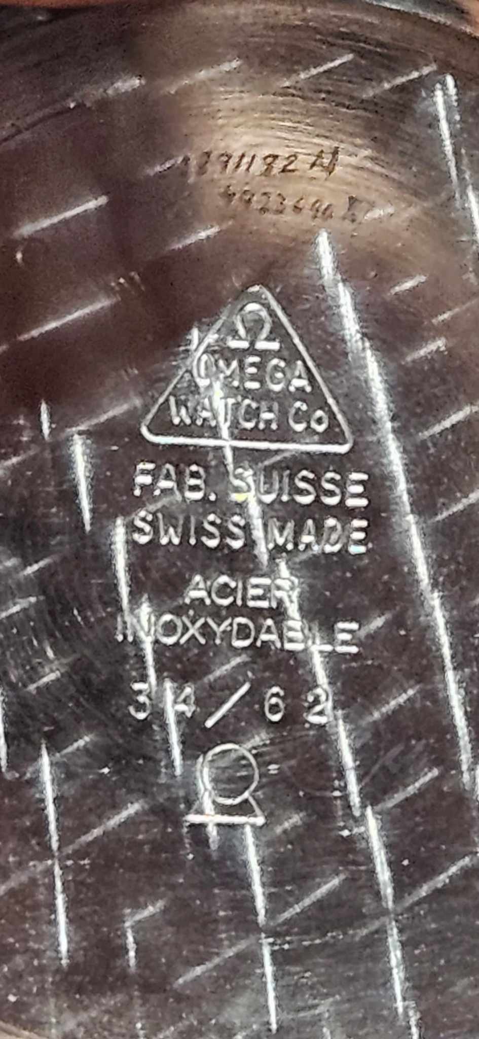

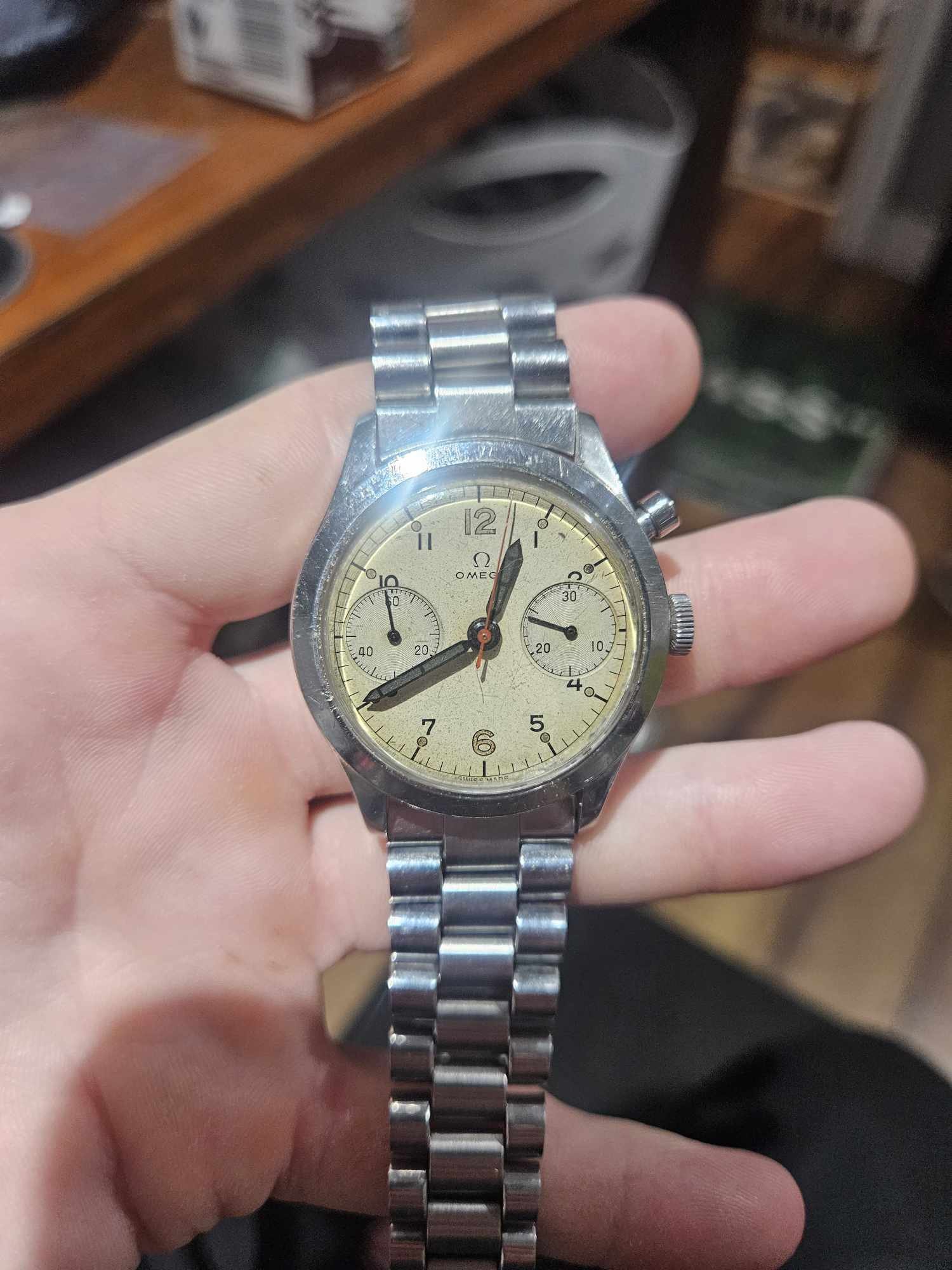

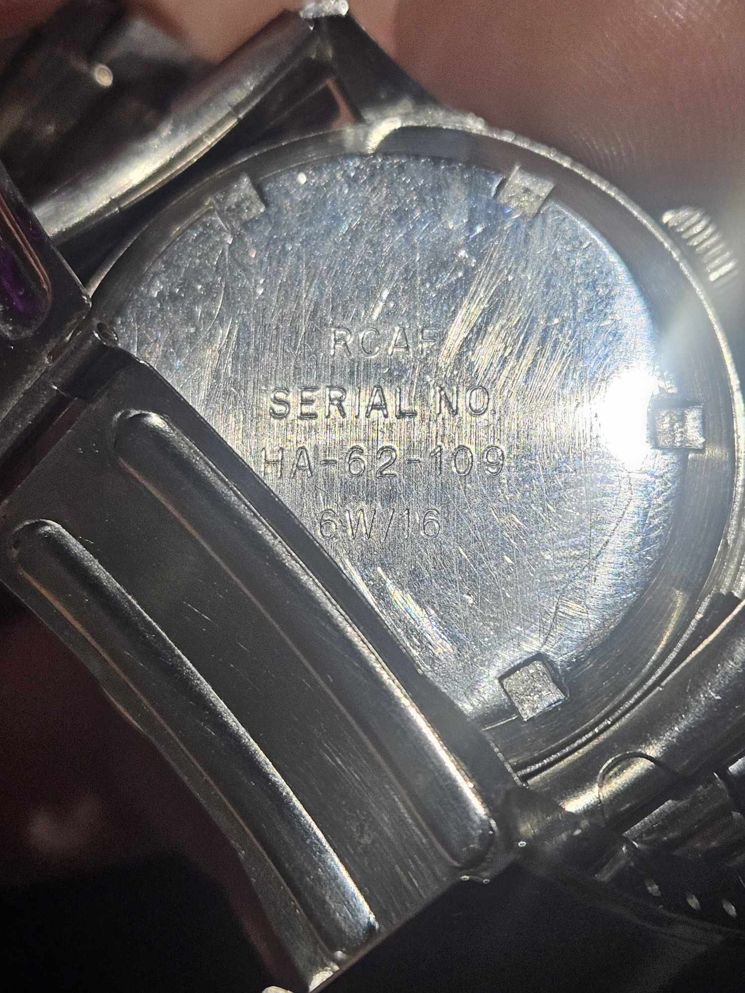

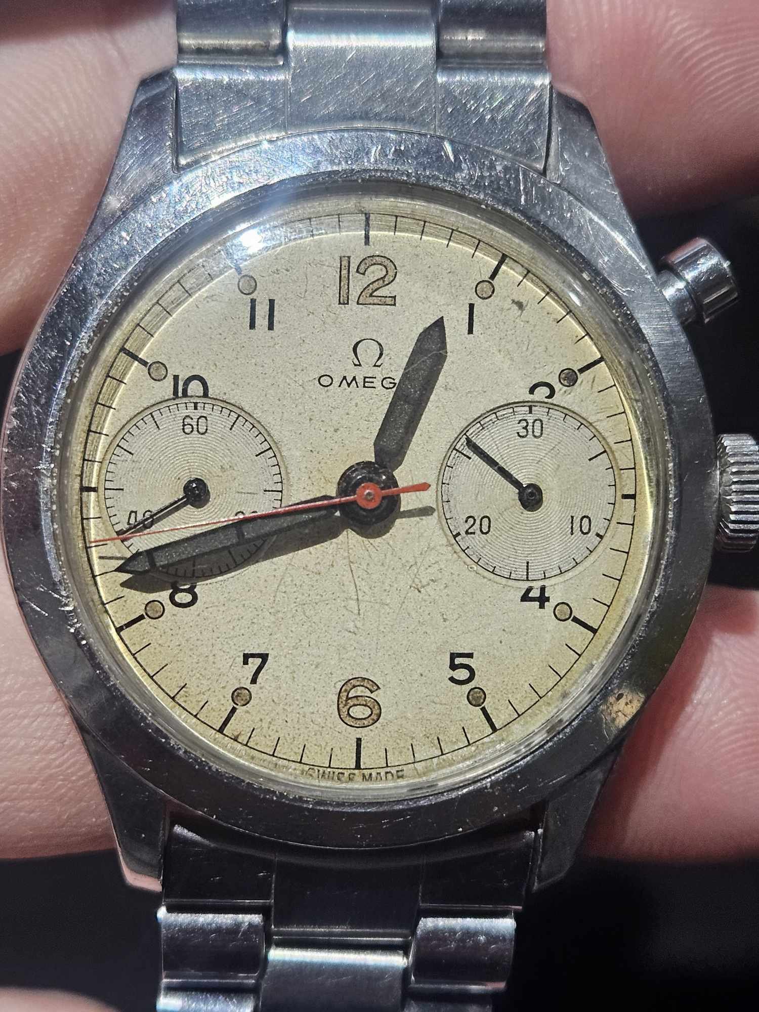

Found this watch and would like some opinions on whether or not its real.
I'm a garbage man and i found it in the trash in a box with 2 other watches, some videogames, and controllers. then house it was Infront of looked like it was going through renos cause there was drywall also in the trash.
iv posted it to reddit with a lot of people claiming its real but im looking for more opinions, i am taking it to my closest omega authorized dealer next weekend.
thanks in advance.

Looks nice, lots of experts here will give you good feedback. I wouldn’t bother with Omega AD they generally do not know much about vintage.
5,729
9,515

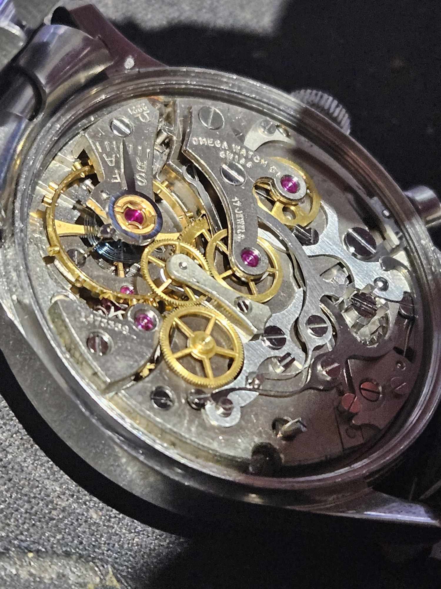

Apart from the minute and hour hand ( $500 plus...) , it looks good. Make sure to take a good movement picture straight from above without your angle here. It should be Caliber 2221 . You might need time to sell it , but Private sale without Omega docus, around $ 12 thousand .
