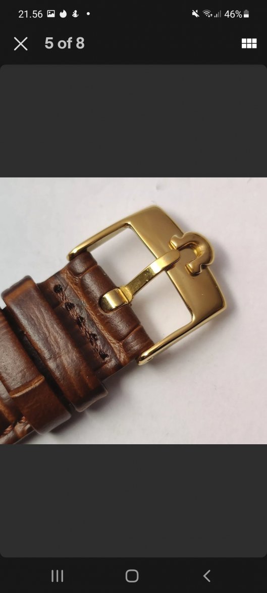

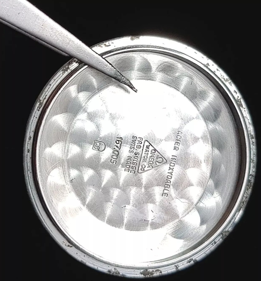

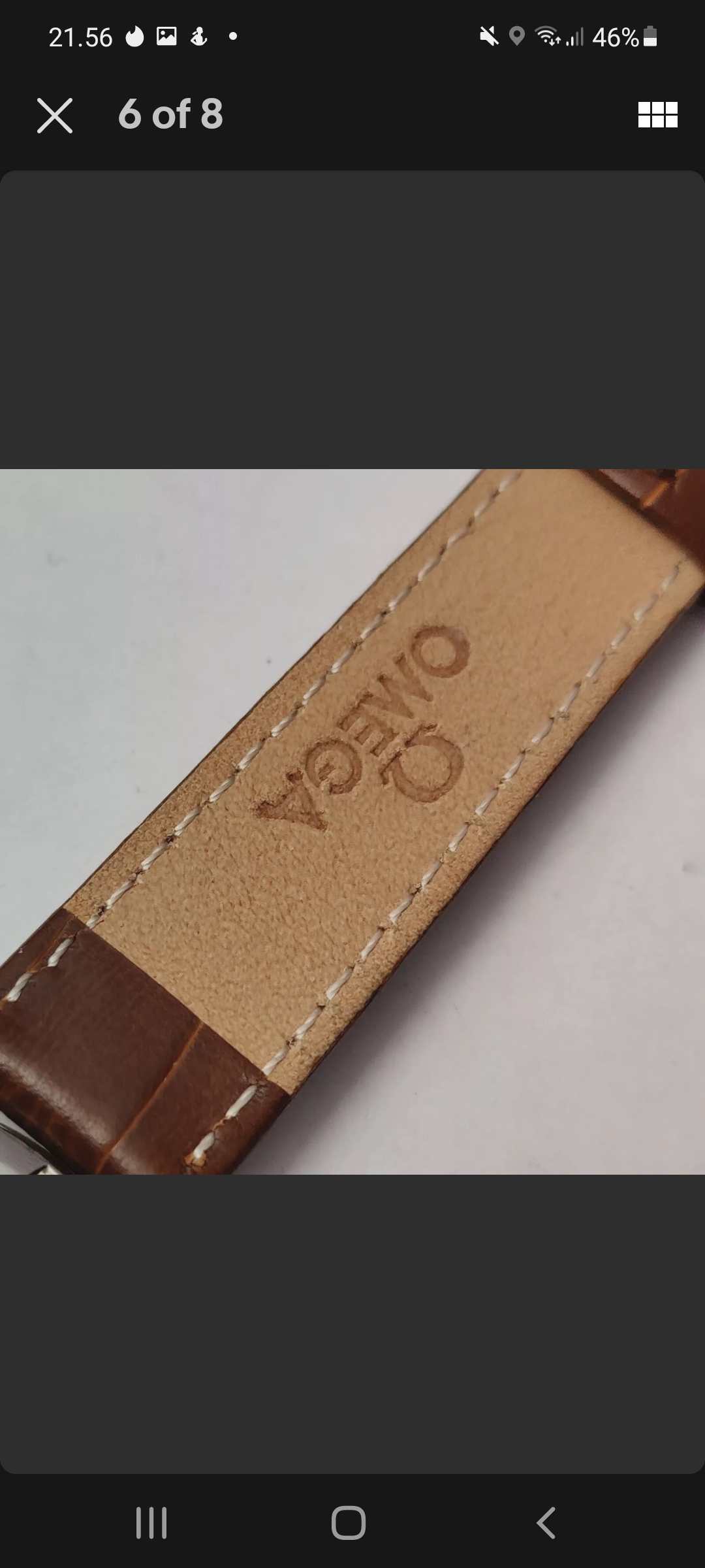

Hello.

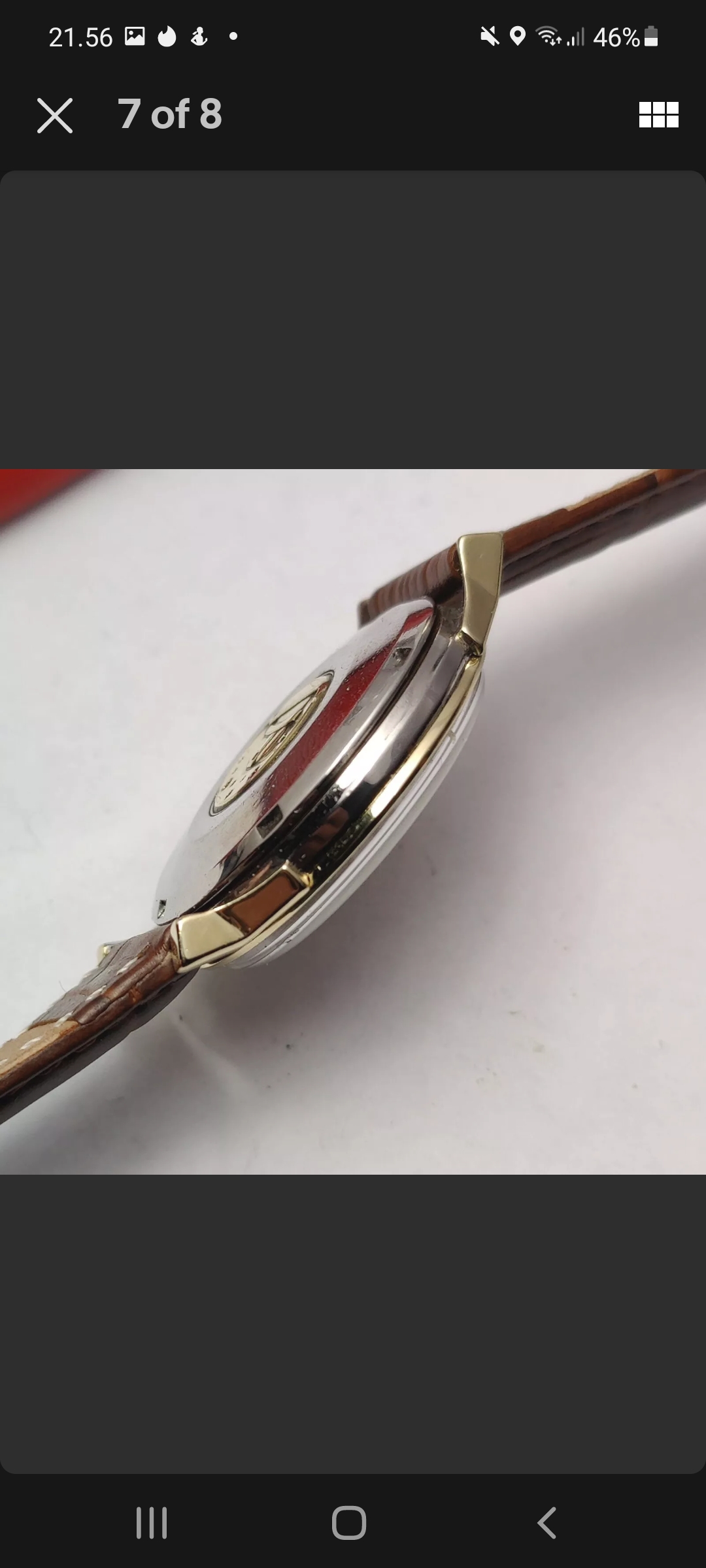

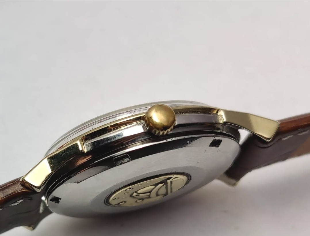

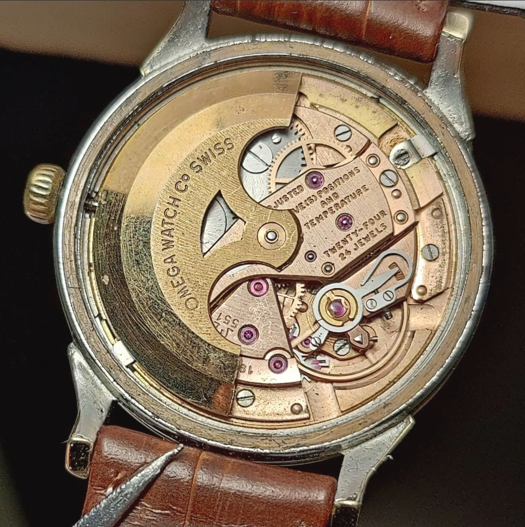

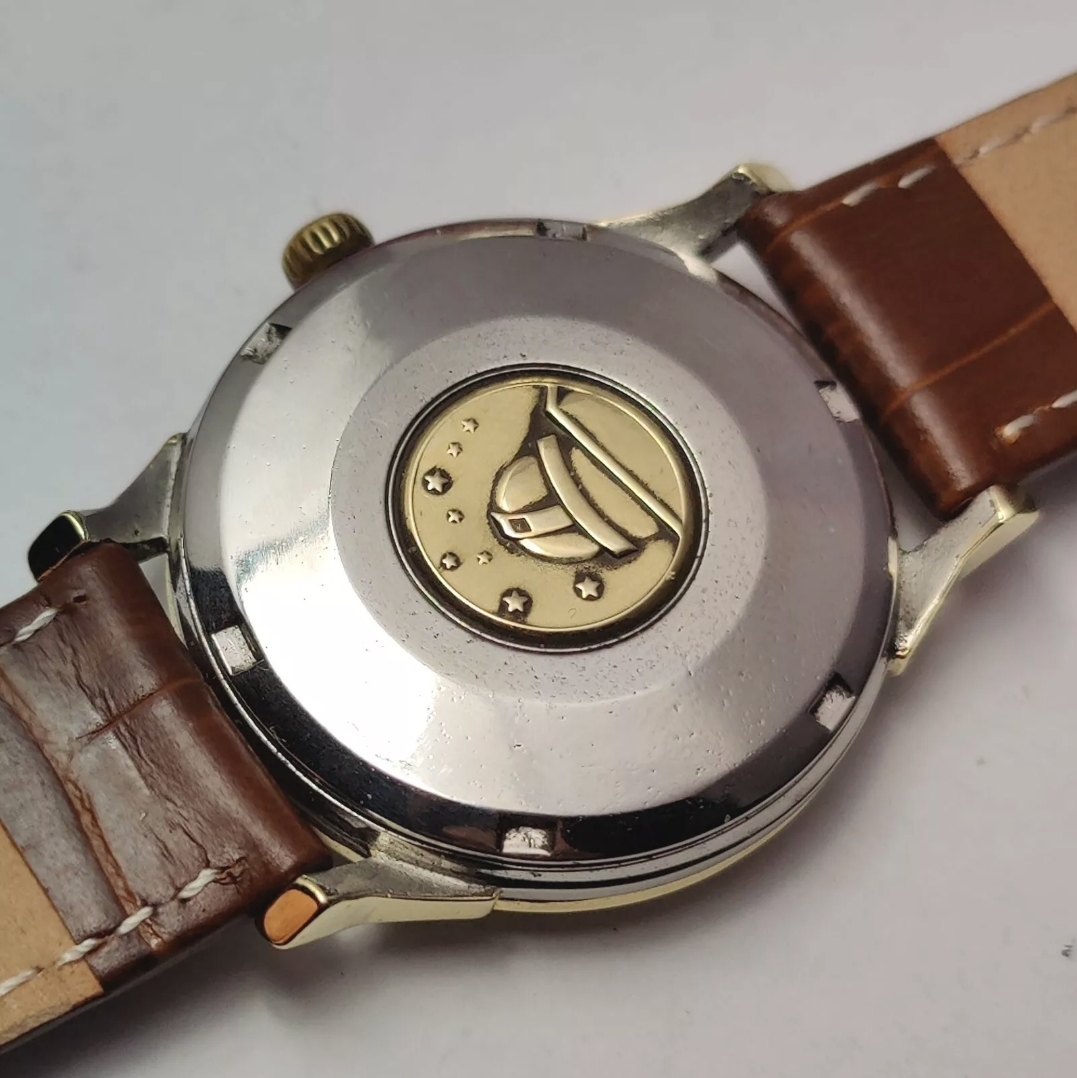

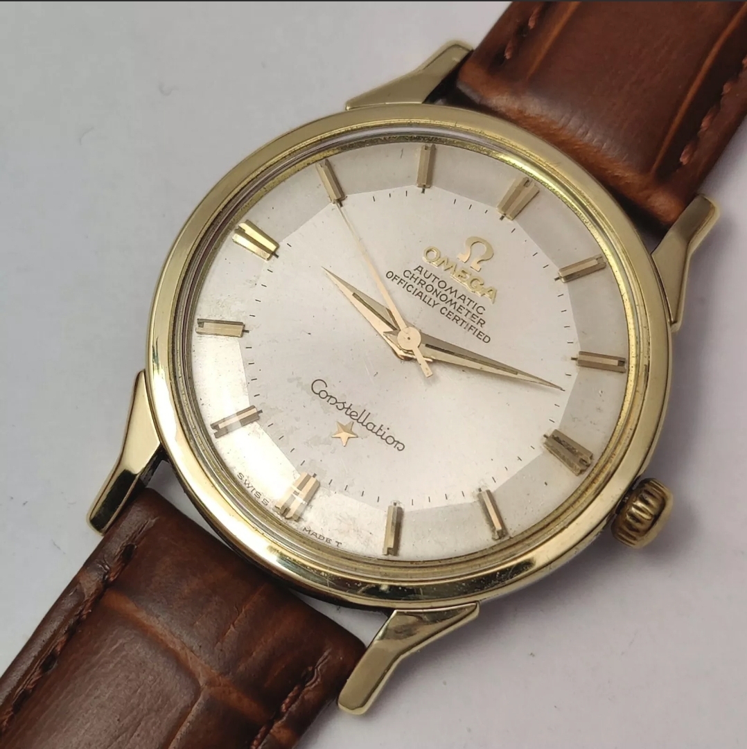

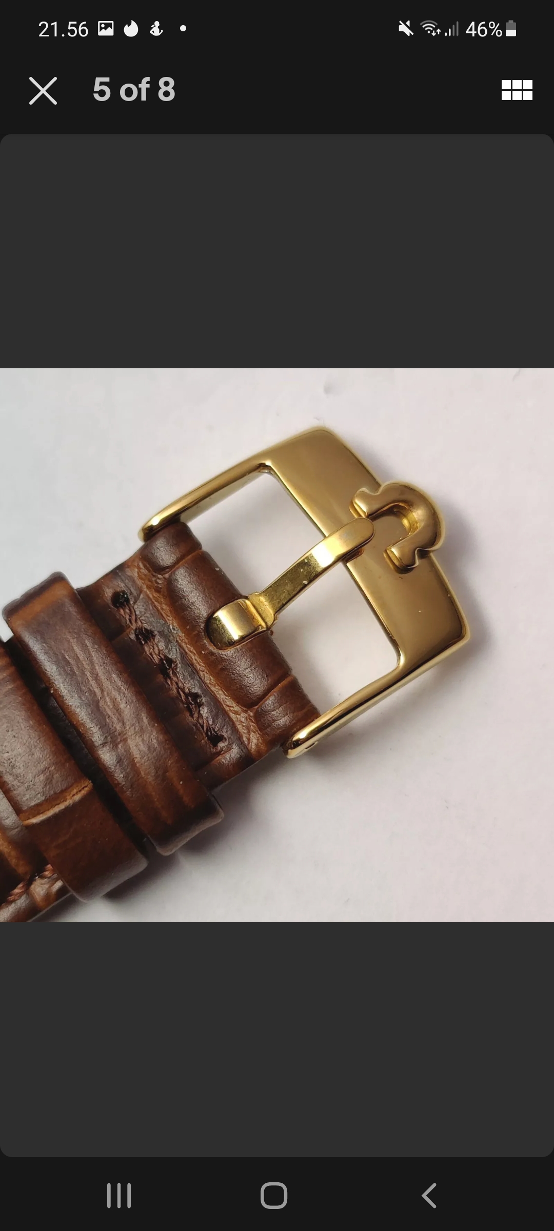

I want to buy this watch (for a guy on Ebay) but I'm not 100% sure if it's genuine. and do not know what to look for (since I am only 19, and am relatively new to the world of watches)
hope you can help me again.

Genuine but the dial would be too dirty for me

Strap and buckle are fakes.
The watch itself looks genuine, but has been ridden hard and hung up wet.
You will have great difficulty finding a 10-sided replacement crown.
I would not recommend this one unless it is very cheap and you can afford no better.
Good luck with your search.

I've seen this one on eBay as I'm also looking for the same reference, but the condition is really bad: dirty dial, overpolished case, movement not in great shape.
Check out this thread to see good examples. The lugs should be sharp and facets should be visible. In your example they are all rounded off by overpolishing.

That calibre is tired and the Centrale Boites needs a good cleaning.

Looks like the seller wanted to flip it without any work done on the watch, dirty dial and case, overpolished lugs and this "authentic" Omega strap and buckle bought for $20 from eBay. Skip it.
