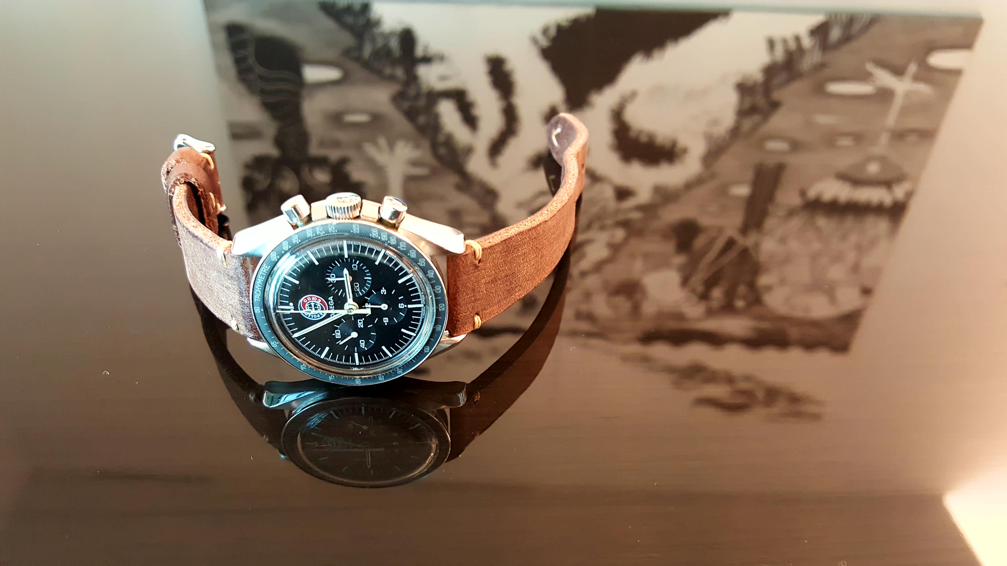

@TsoloT
That watch in your picture appears to show the white halo tell tale of a sapphire crystal, not something you would expect on a watch of that time.
@Apollo-Soyuz
Yes, your watch could have been made with all correct parts in Italy, the issue is it’s falls outside the invoice of the 400 known.
I think your missing the point, it’s possible but there is at this time no way to verify. One way to do this would be to find box and papers for one that falls outside the known range.
As for Omega having to take legal action if a distributor did something like this... no they wouldn’t, they would have noted it if they knew, and brought it up, no reason to trash a relationship over 100 watches. More like don’t do this again... greay area blah blah.

@TsoloT
@Apollo-Soyuz
Not a sapphire it’s the light that’s being used and there is a point that’s being missed ....where’s the money ...surely a watch sold as a watch gives Omega a higher yield than just parts
stop!
my watch is authentic and the glass is exalite and not sapphire!
for OMEGA CH the box and warranty do not feel anything, unfortunately! the problem is the serial number! I have the sales invoice and delivery from Omega to De-Marchi, is it enough?
