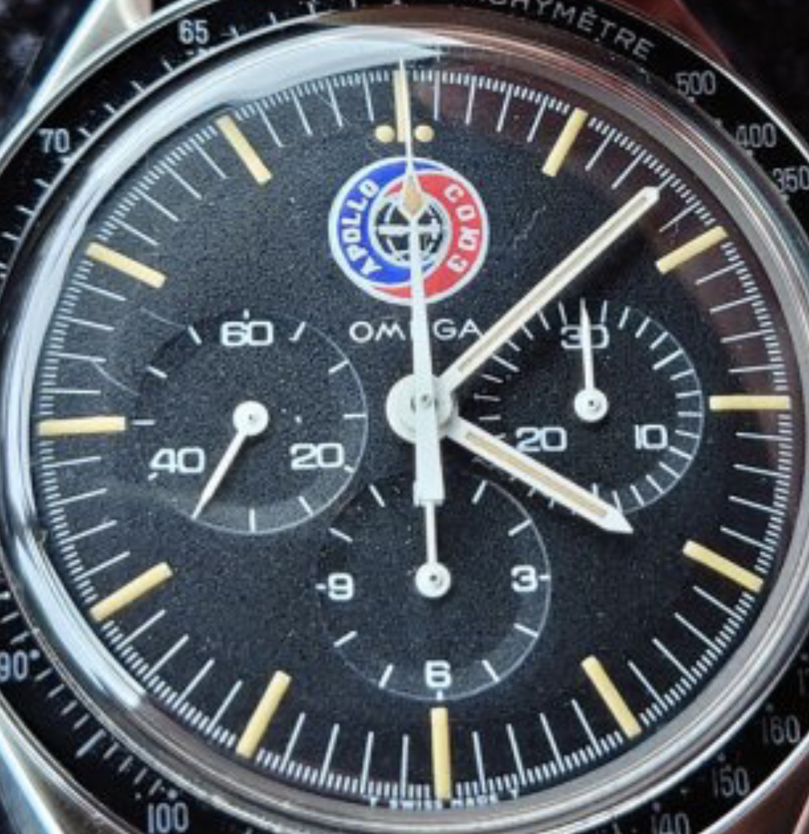

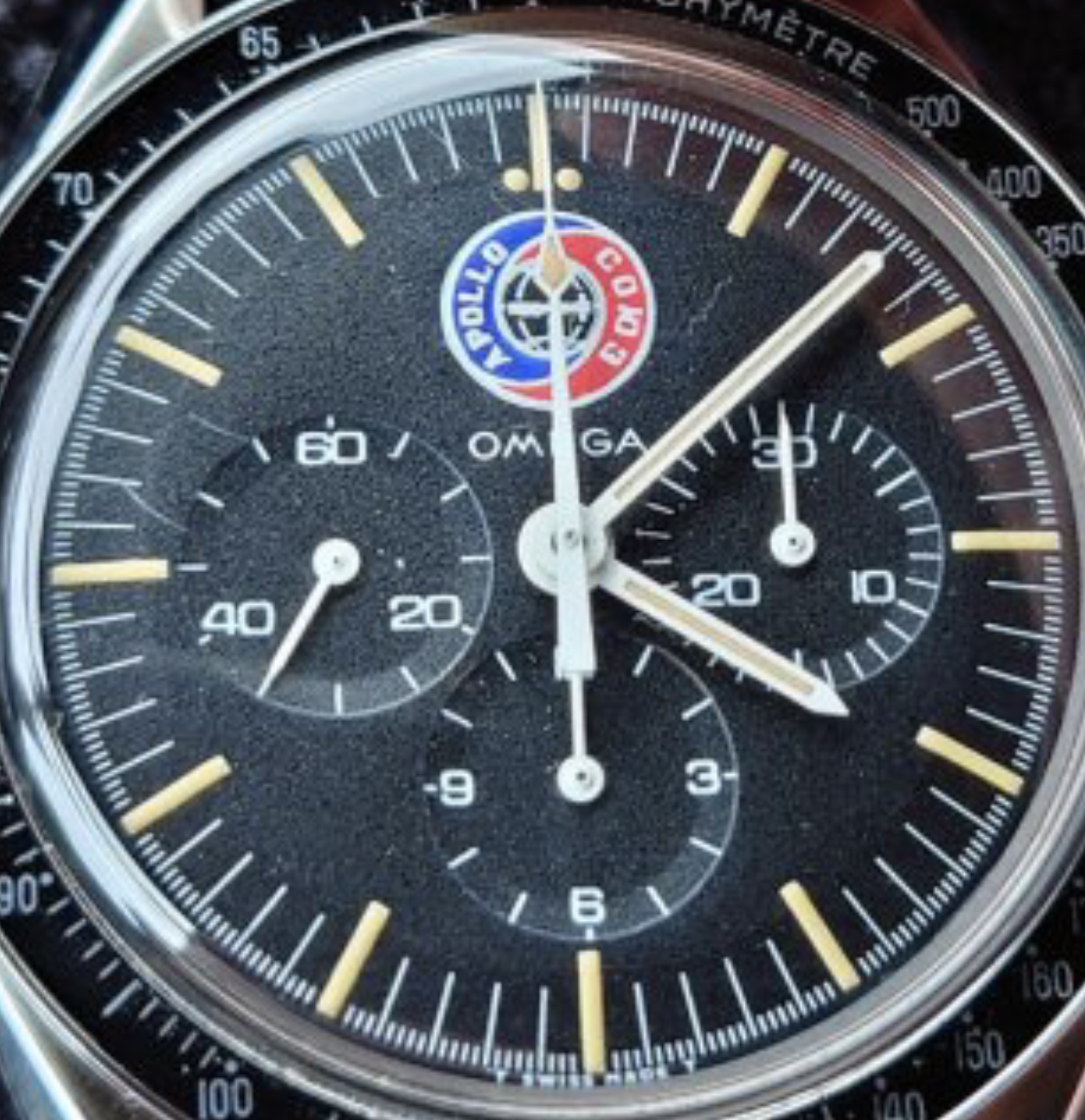

This fake 1975 Omega Apollo Soyuz juts popped up on a Omega Facebook group.
Few tells on the dial, like the wrong spacing of the T SWISS T, the missing concentric circles in the sub-dials, the lines of the AS logo are thicker than the original, wrong font for Omega and more. You can see pretty fast it's a fake but it's not usual to see those on the Omega market... Posting for posterity

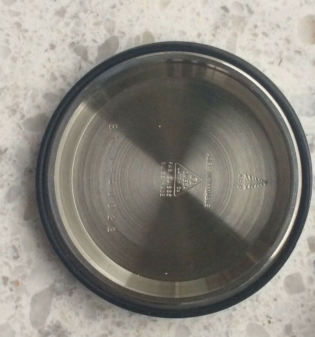

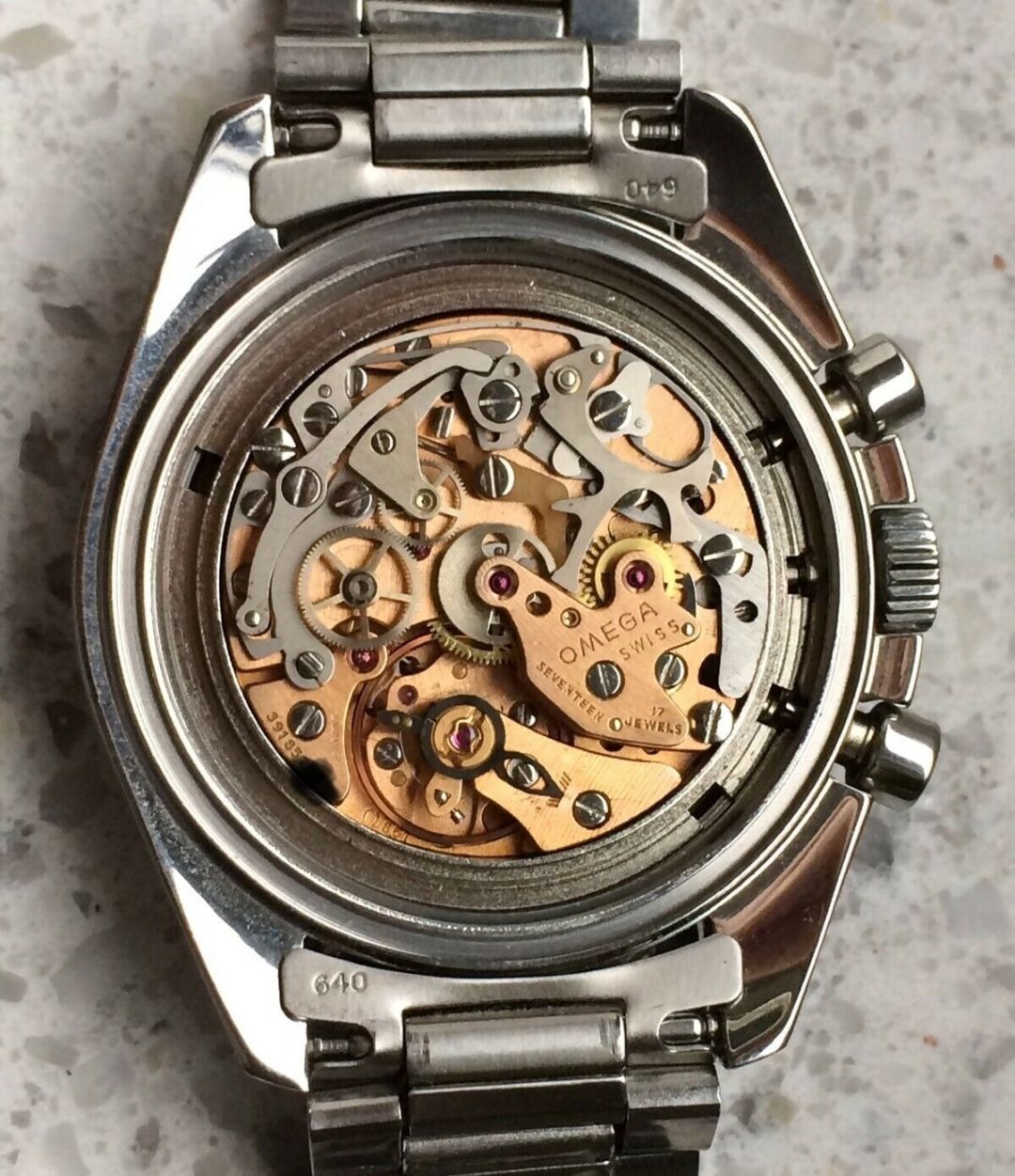

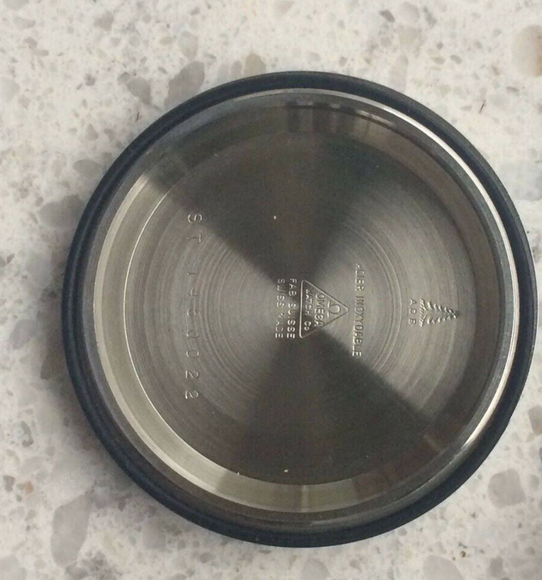

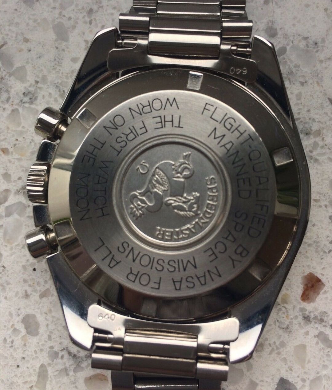

The rest of the watch is a standard 861, wrong case-back, wrong mid-case, wrong pushers

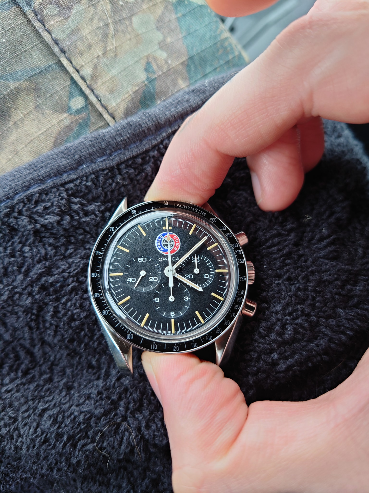

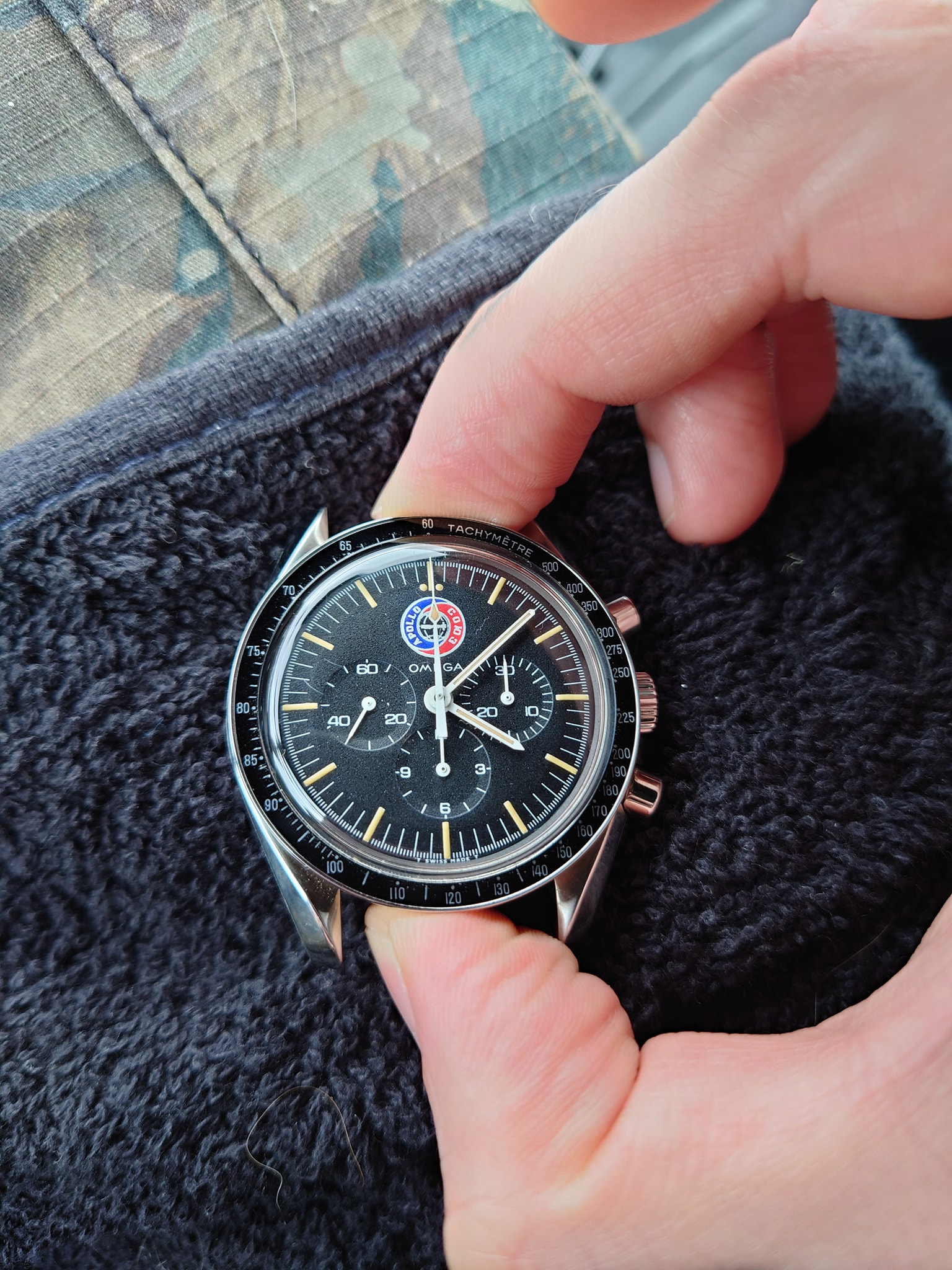

This popped up on my FB thread as well. Interesting example, dial definitely differs from the original - I wonder how they made the dial though? Refinish of the standard speedmaster dial, maybe one from the 80s or 90s? Seems like a bit of a gamble just to get that apollo soyuz logo on there?

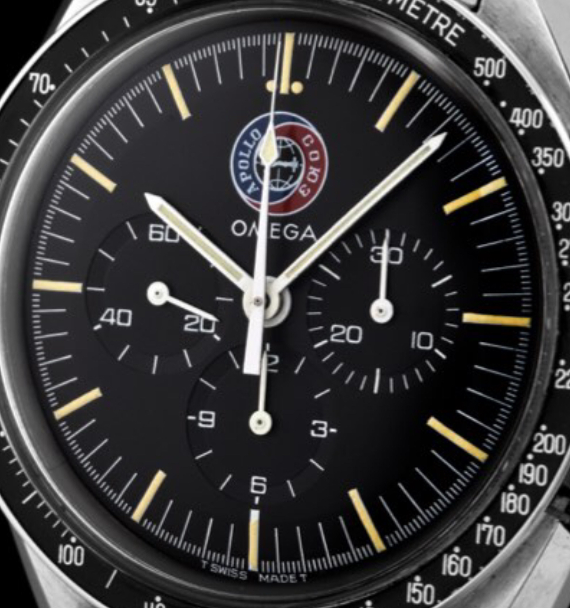

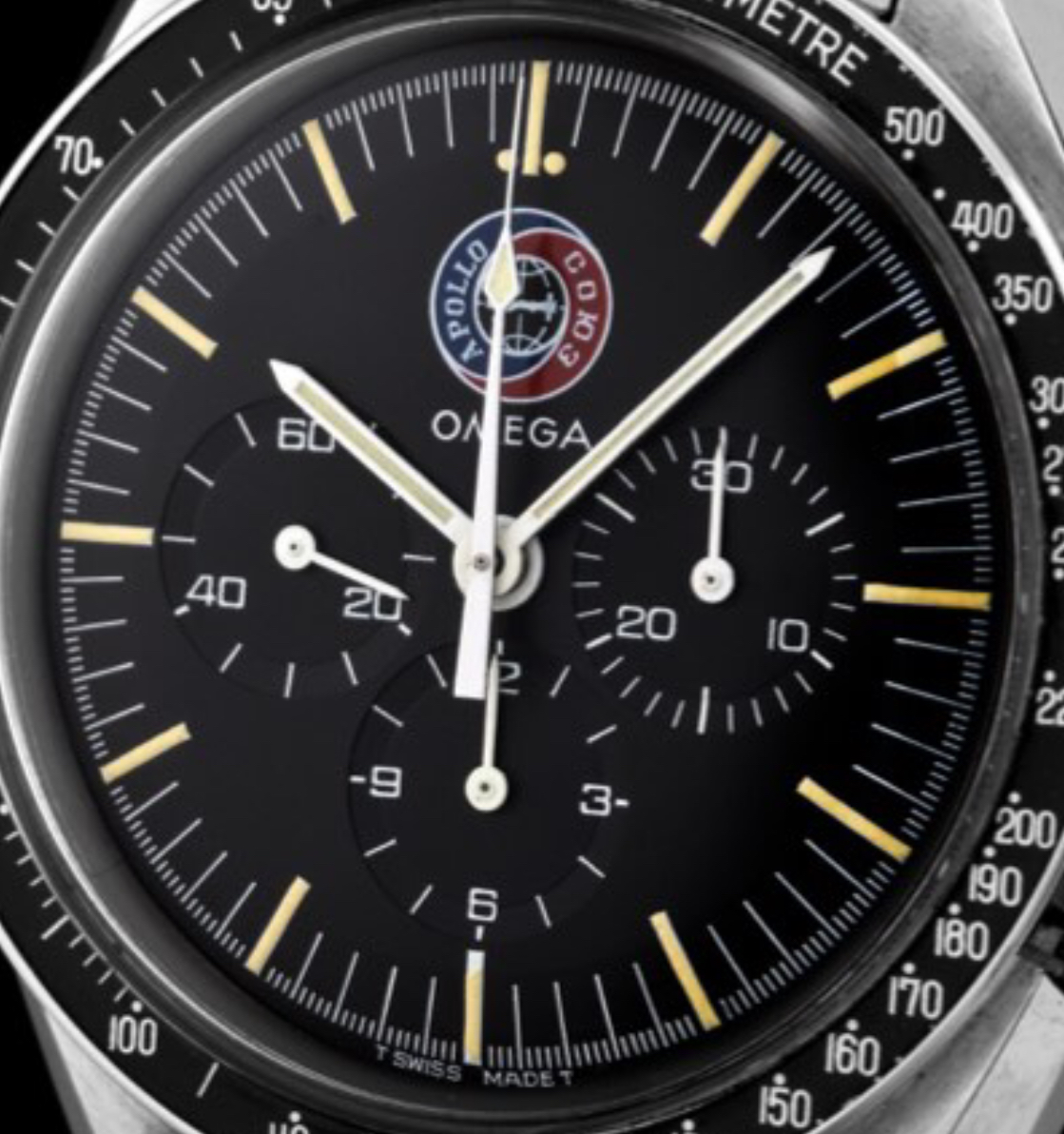

For the record:
OP Watch
MWO photo
The bezel is wrong too.
Easiest dial tell is where the ‘t’s line up at the bottom of the dial.

For the record:
OP Watch
MWO photo
Even easier than the T, that is indeed not correct, you have on the real dial: Swiss / the space of the the marker / Made. On the fake one the two words are too close.
The OP deleted the thread about it on FB so unfortunately I can't ask more informations or pictures.
