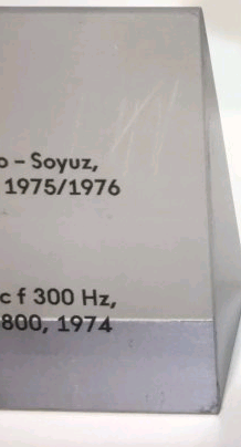

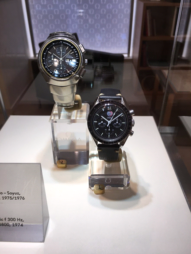

I also noticed another thing in this image; the descriptive card. This indicates two dates or better, two years of production; 1975 and 1976
the experts say that the production of Apollo-Soyuz watches began in mid-1976, but this descriptive card also indicates 1975.
why?
Also Mr. Brandon (Omega Museum) confirmed that production began at the end of 1975.
this is a further confirmation that there is a production of Apollo-Soyuz that anticipates the official one and that the movements of this series are of the year 1975
I apologize to @TsoloT if I have posted a photo of him without asking permission...
