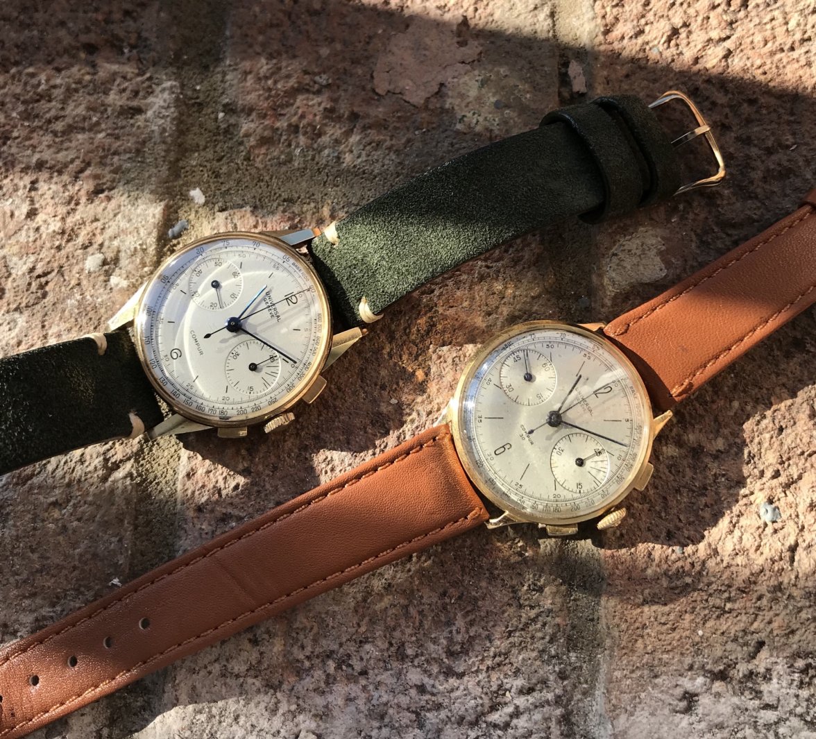

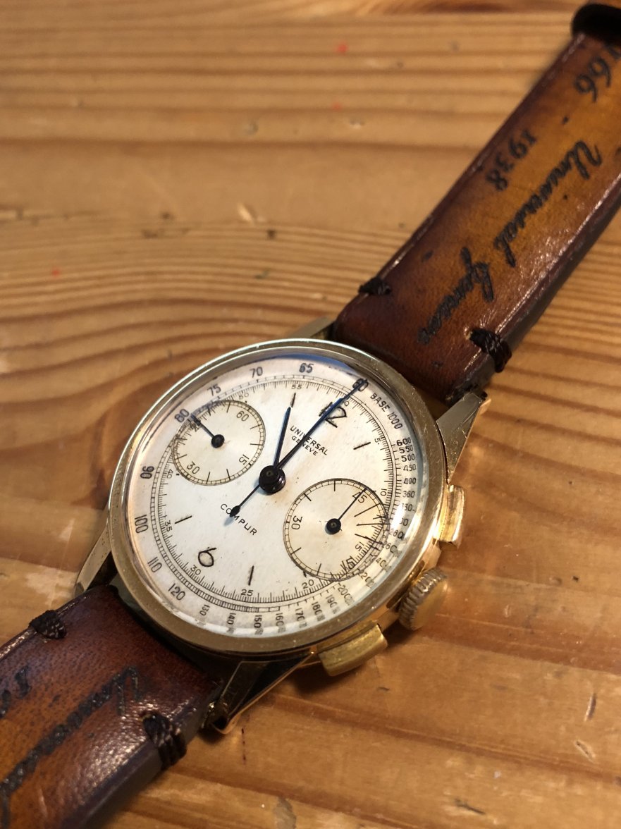

And because this thread needs more pictures here are two of my Compurs;

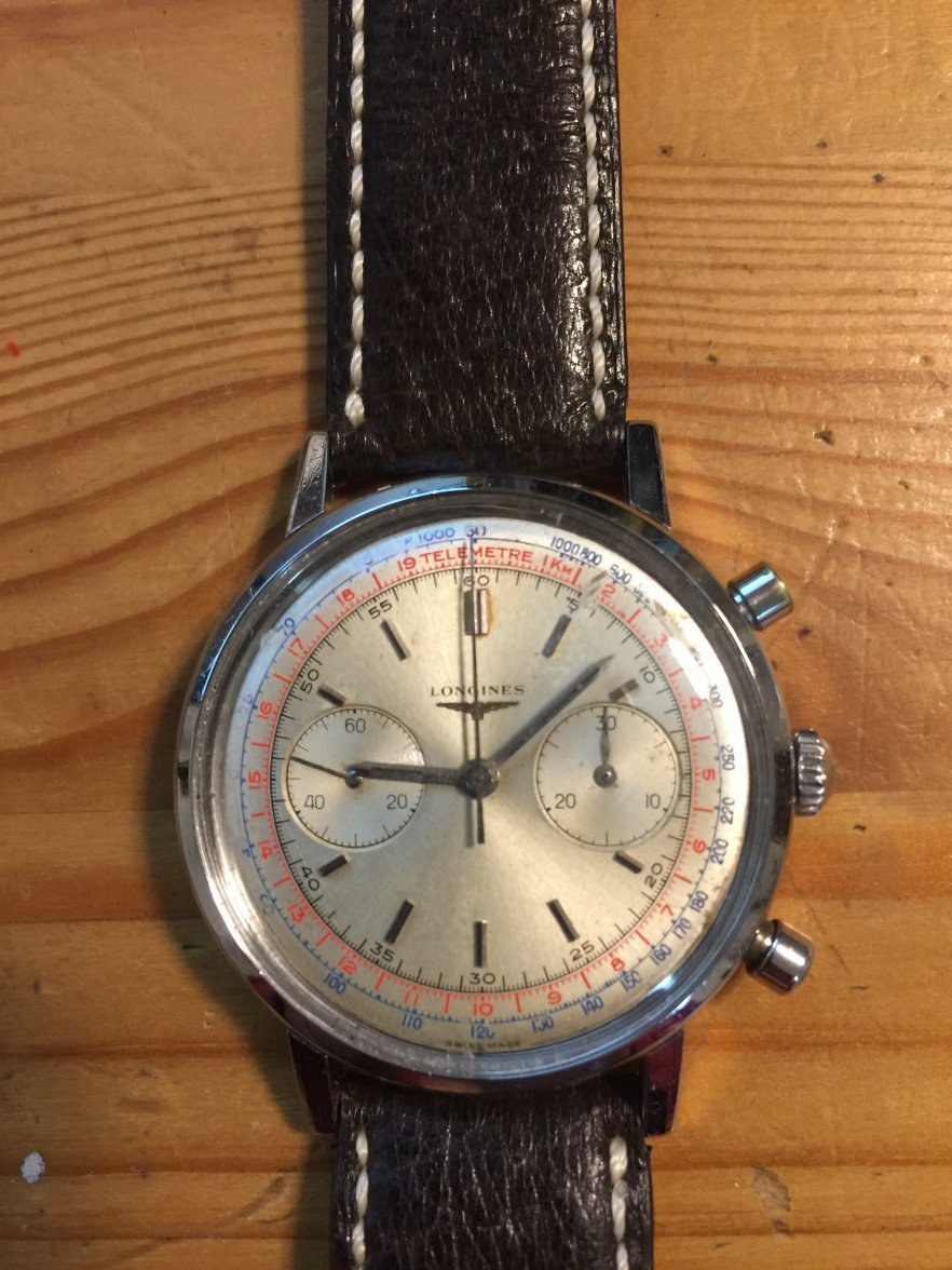

Starting over ...two many beers tonight...2 Register Chrono...
39
131

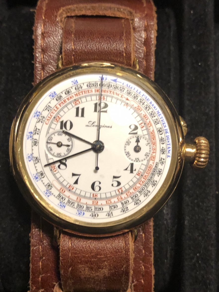

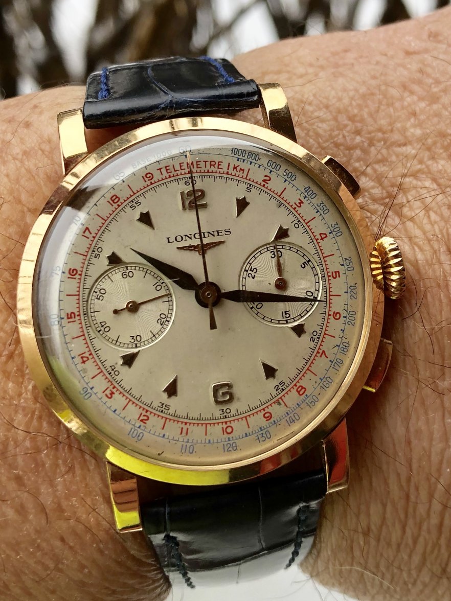

It’s the simplicity of UG Chronos that keep drawing me back. Also the gold. My vintage watch bug was started by a gift; my great grandfathers rose gold JLC triple calendar that was gifted to me.
13,876
54,030
Those Longines are spectacular

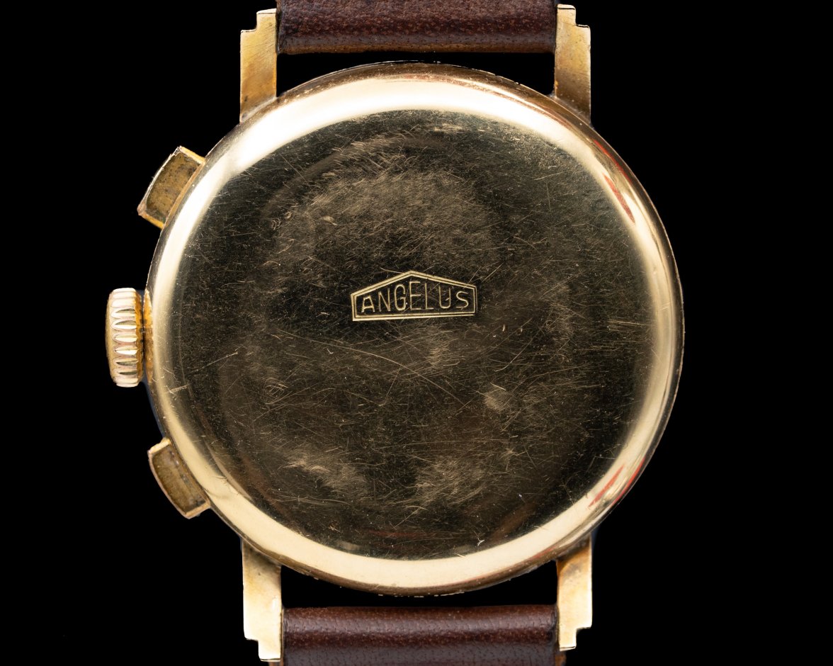

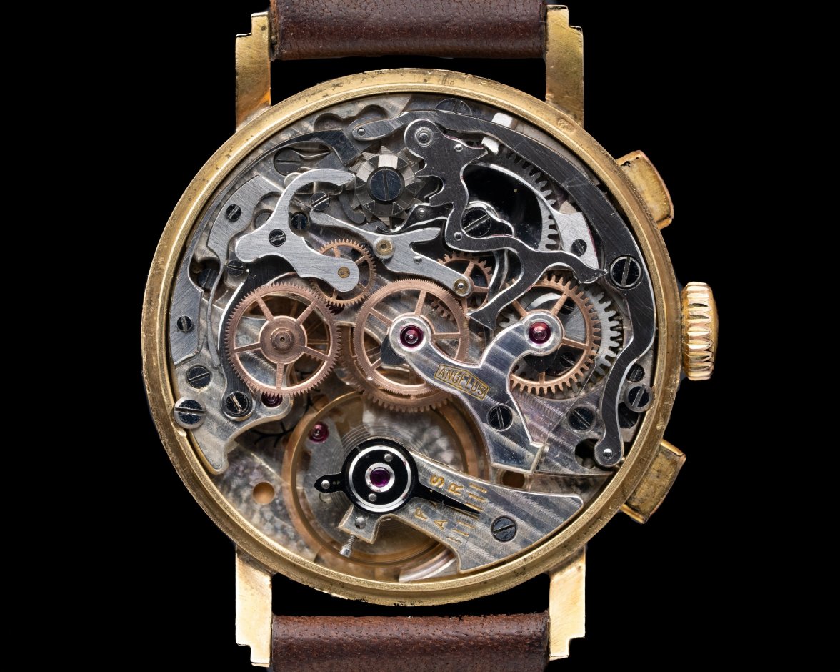

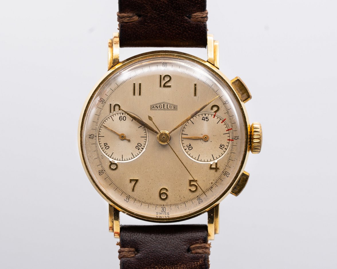

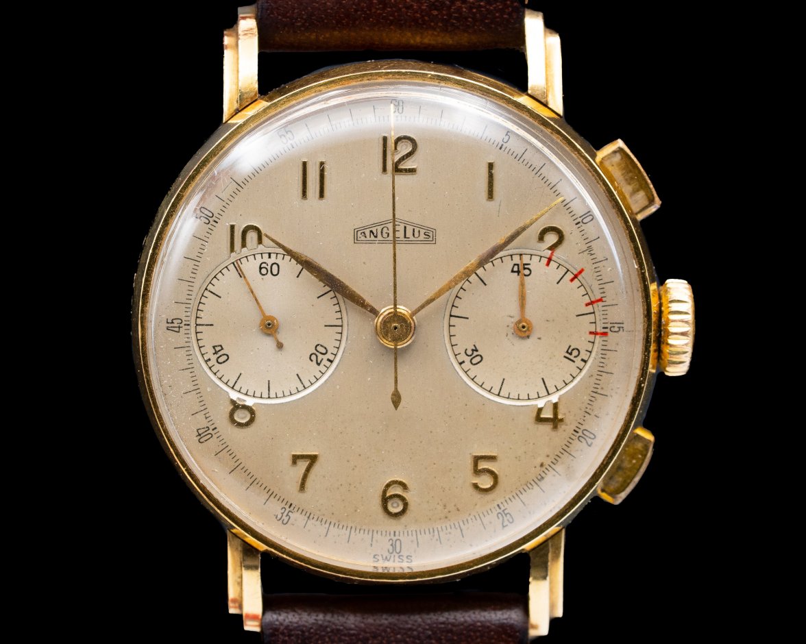

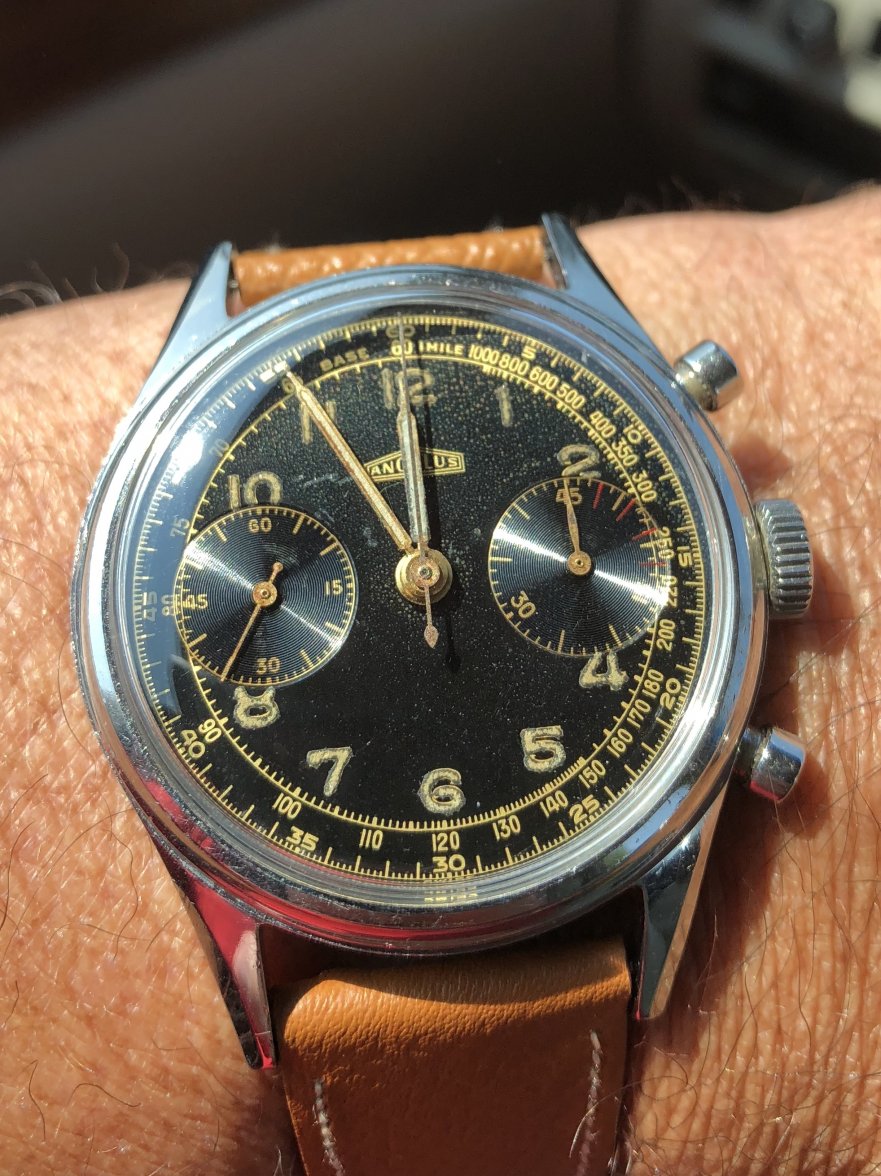

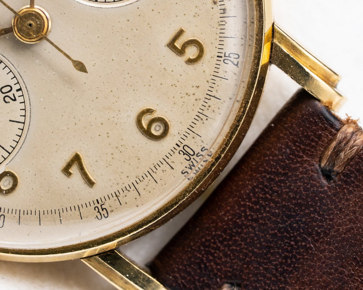

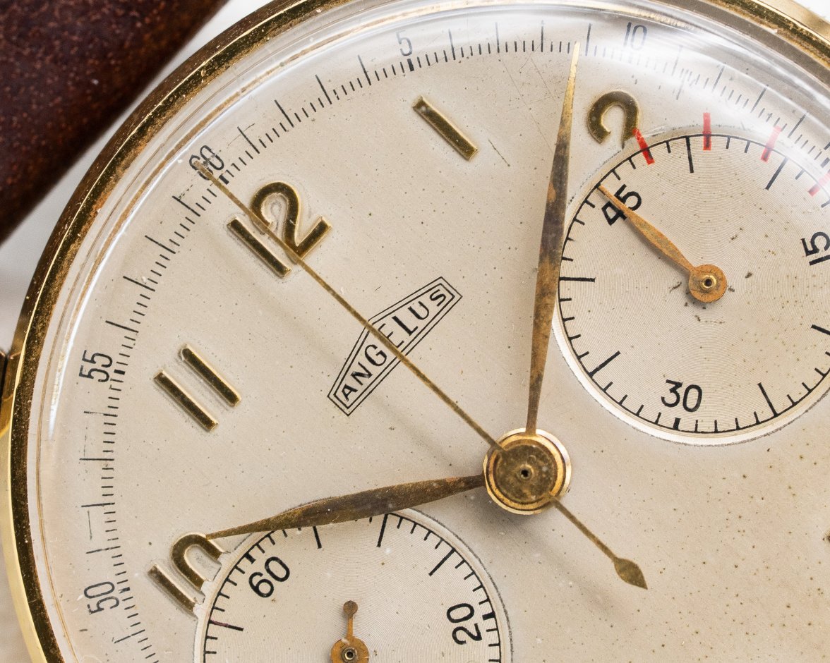

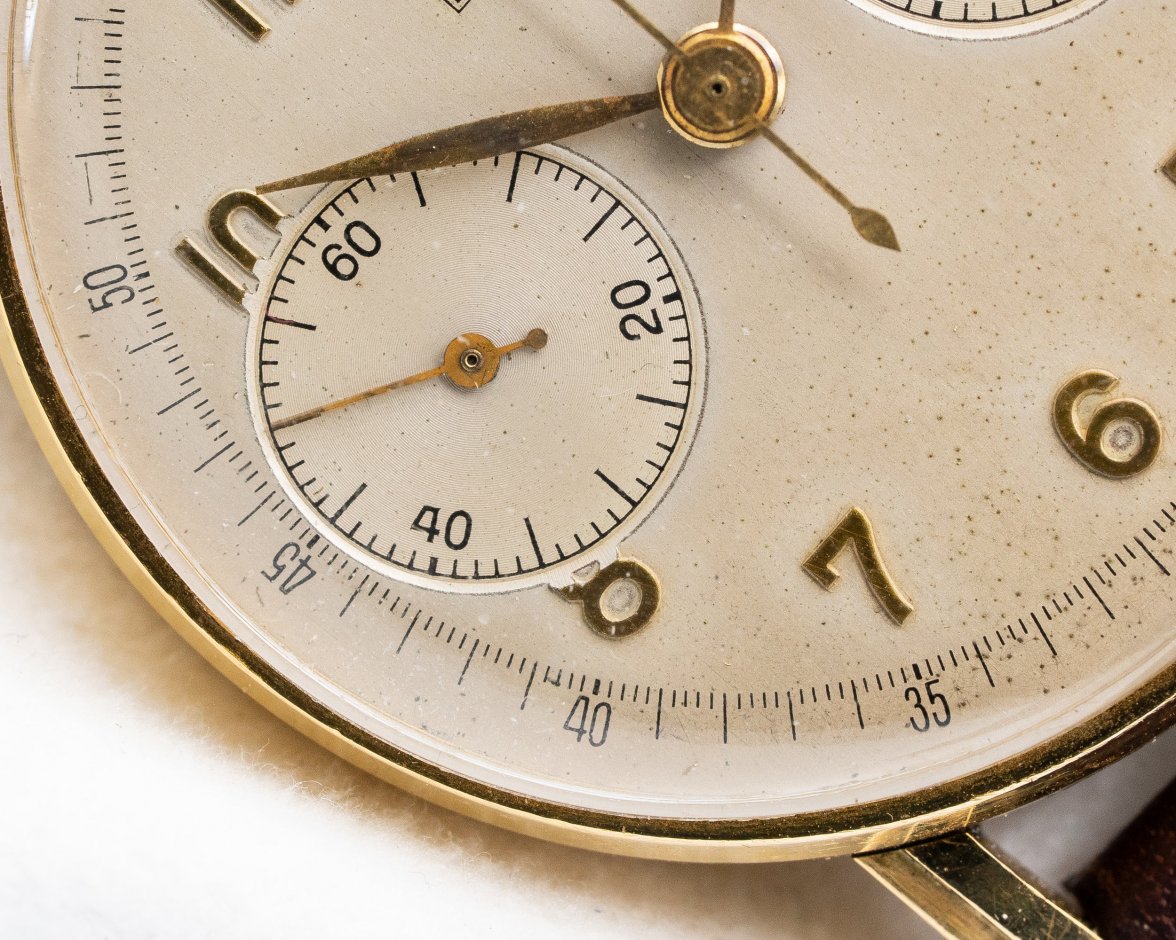

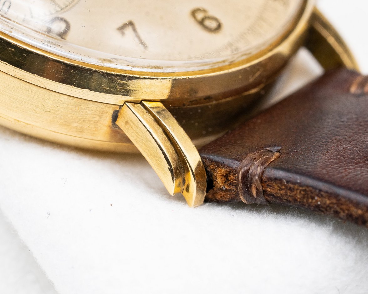

I know this isn't UG, but I have found what appears to be a nice example of an Angelus cal 215; case looks good, lugs sharp, movement clean and correct compared with stock photos I found on fratello watches, pushers with some slight damage but not terrible. Price seems
ok at 2290; any thoughts on this example or these Angelus chronographs in general? I am think about it as well as UG.
39
131

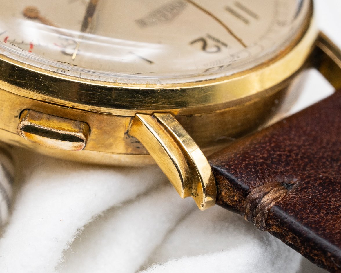

Dial looks fair with a small amt of patina, some spotting between 4 and 6
39
131
Even the small dial defect right below the 1 is identical...
24,790
55,061
It's a nice piece, but I'm not entirely convinced that the red lines are original. Such marks are common in general, but the way they are drawn is not convincing to me. They aren't centered on the actual minute markers, and they spill out of the sub-dial in an sloppy way, even onto the applied metal marker.
