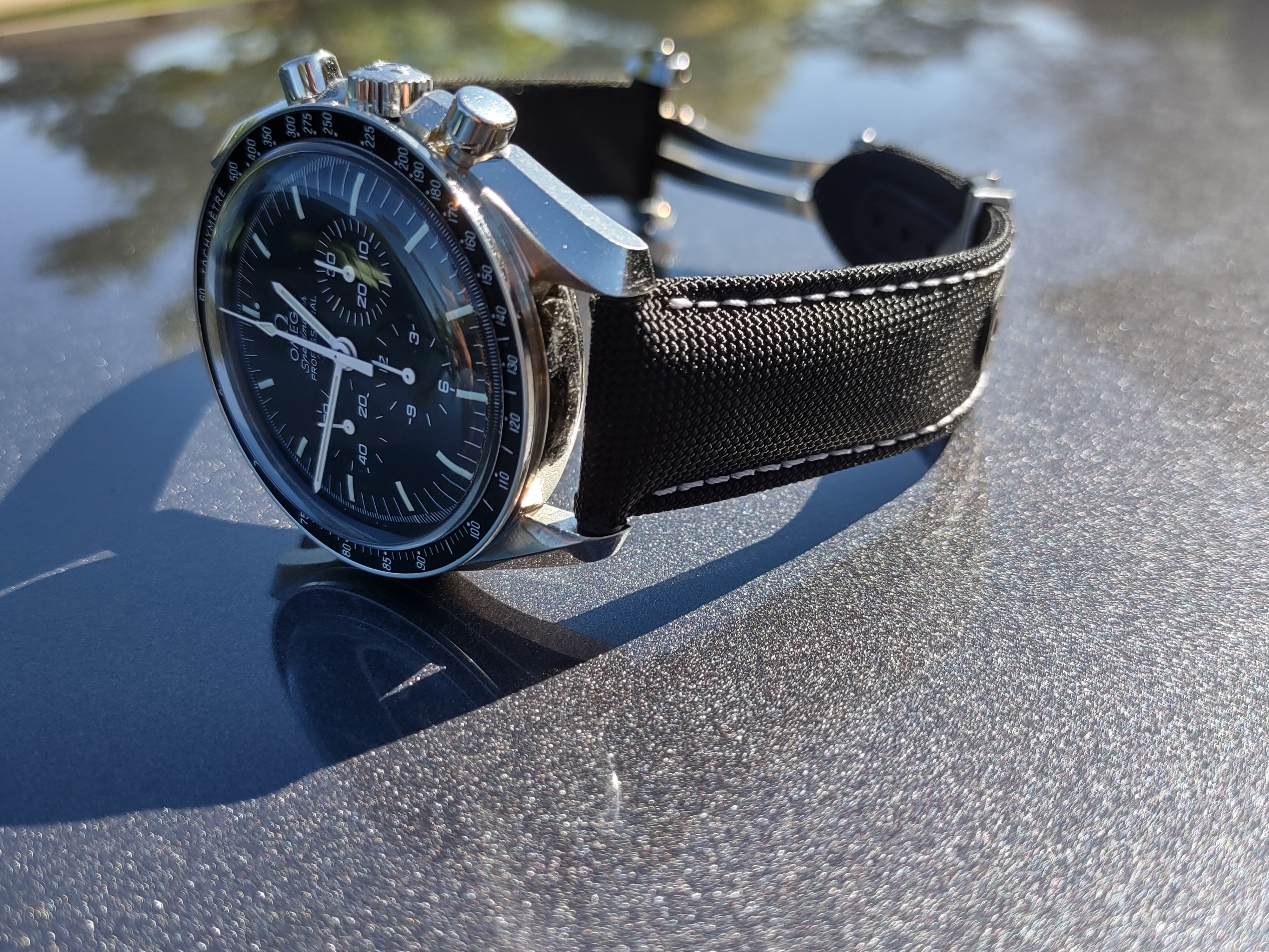

From memory the catalogue lists one particular deployant with a bigger opening to accommodate the thicker fabric strap which comes on the previous Silver Snoopy.
The croc leather strap is thinner so you will probably need to watch out for that.

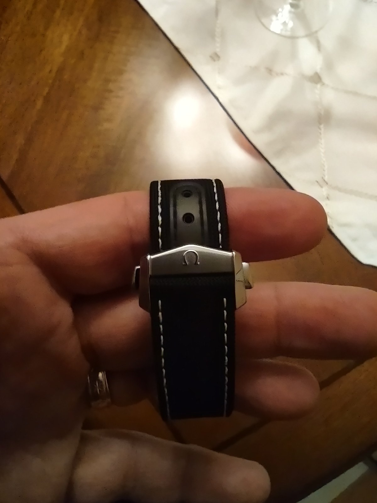

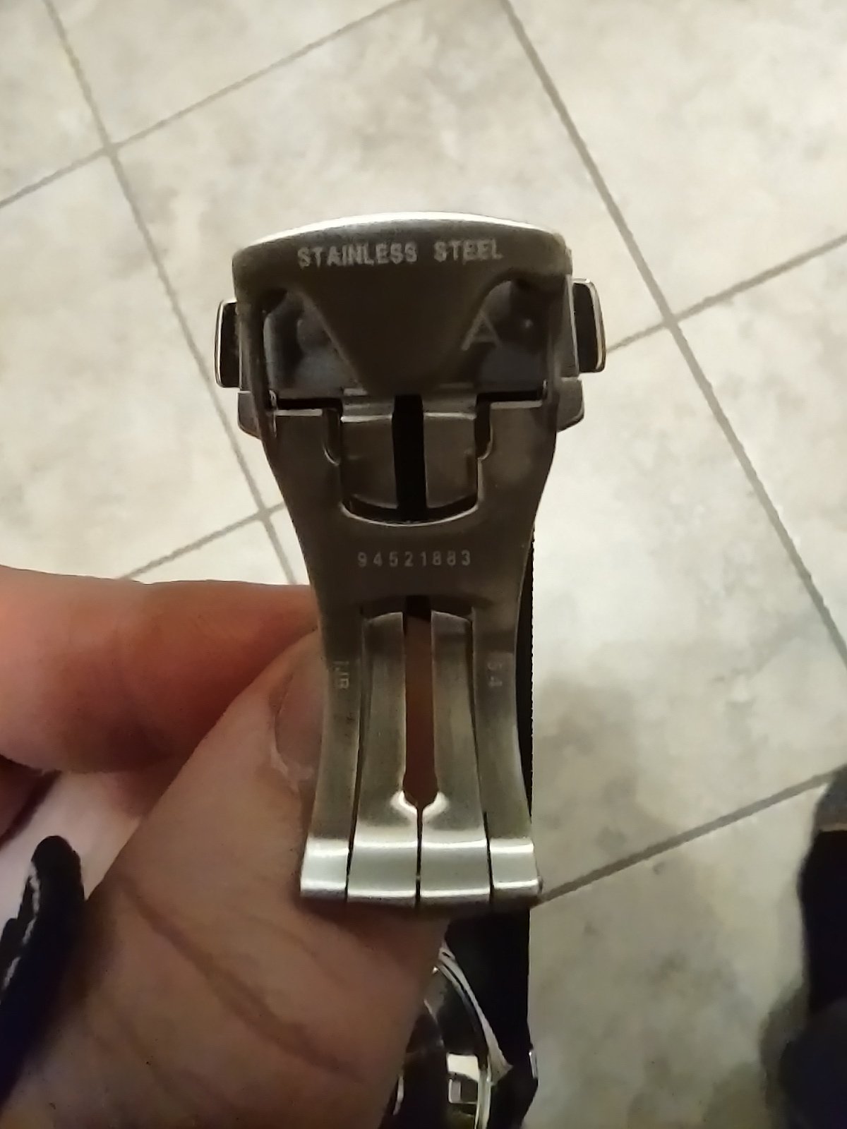

The deployant that came with my Silver Snoopy strap is stamped 94521883.

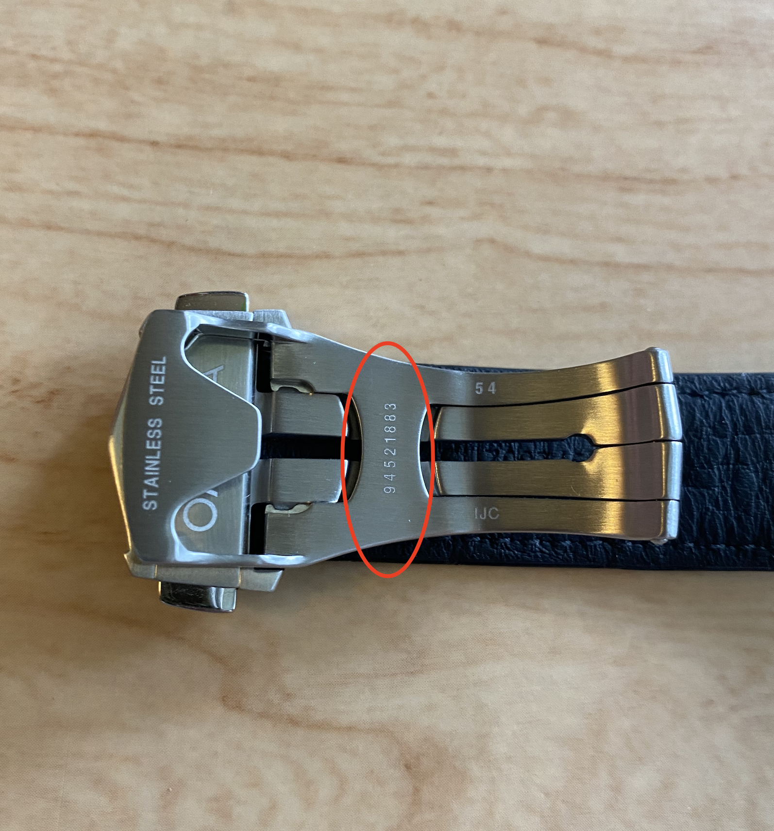

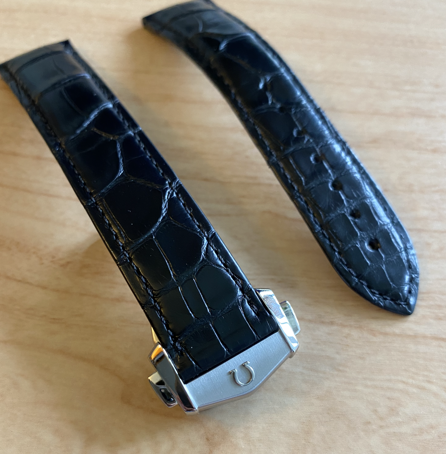

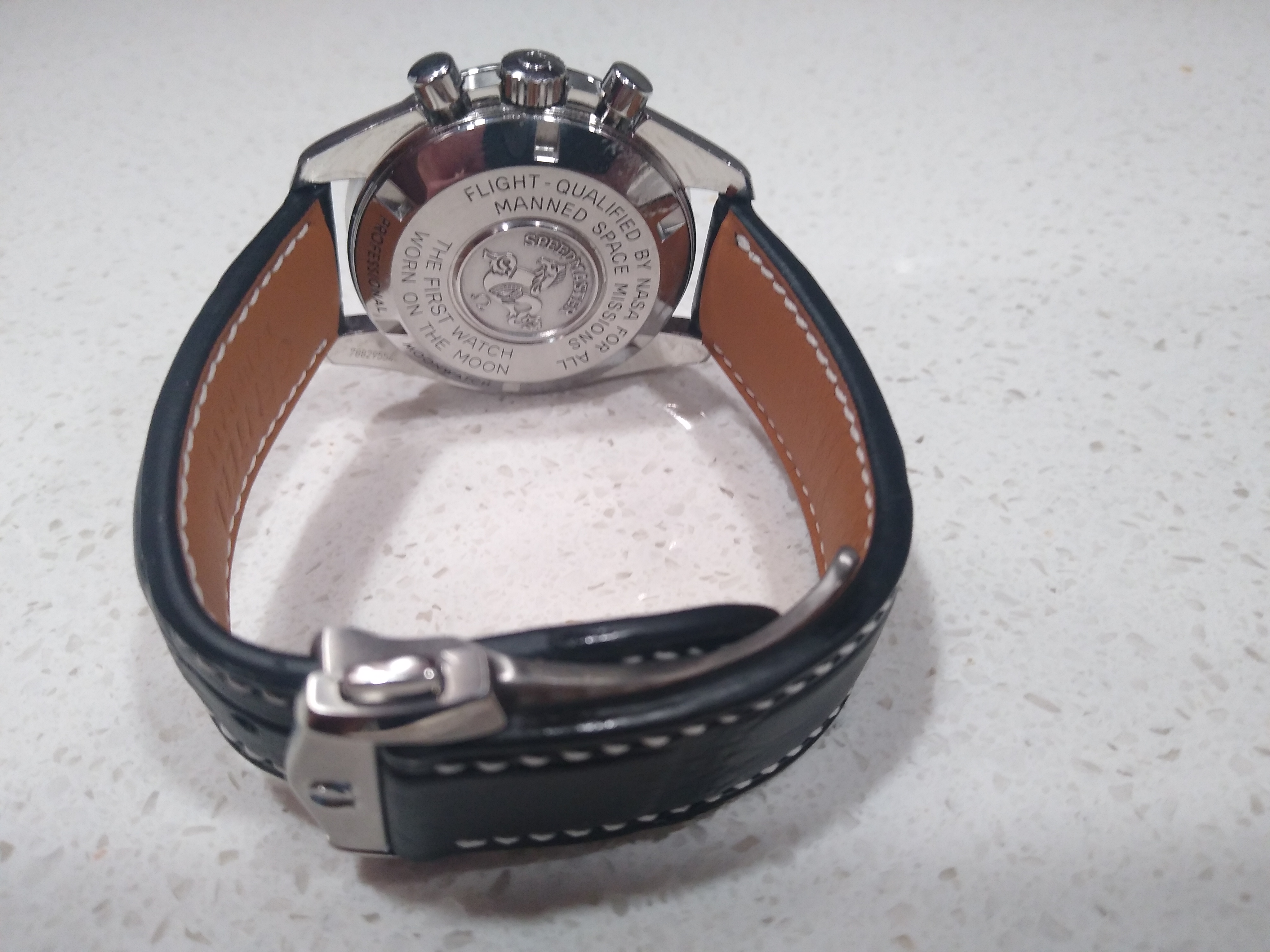

I have the last generation Speedmaster (1861) and have both an alligator from Genteel (really love) and a Silver
Snoopy. I wear both on the
94521883.
It's has a 2.7mm opening as opposed to the 2.5mm. I do not notice any extra play when wearing the alligator. I think if you are going to wear both styles, get the one with the larger opening.
94521883.
