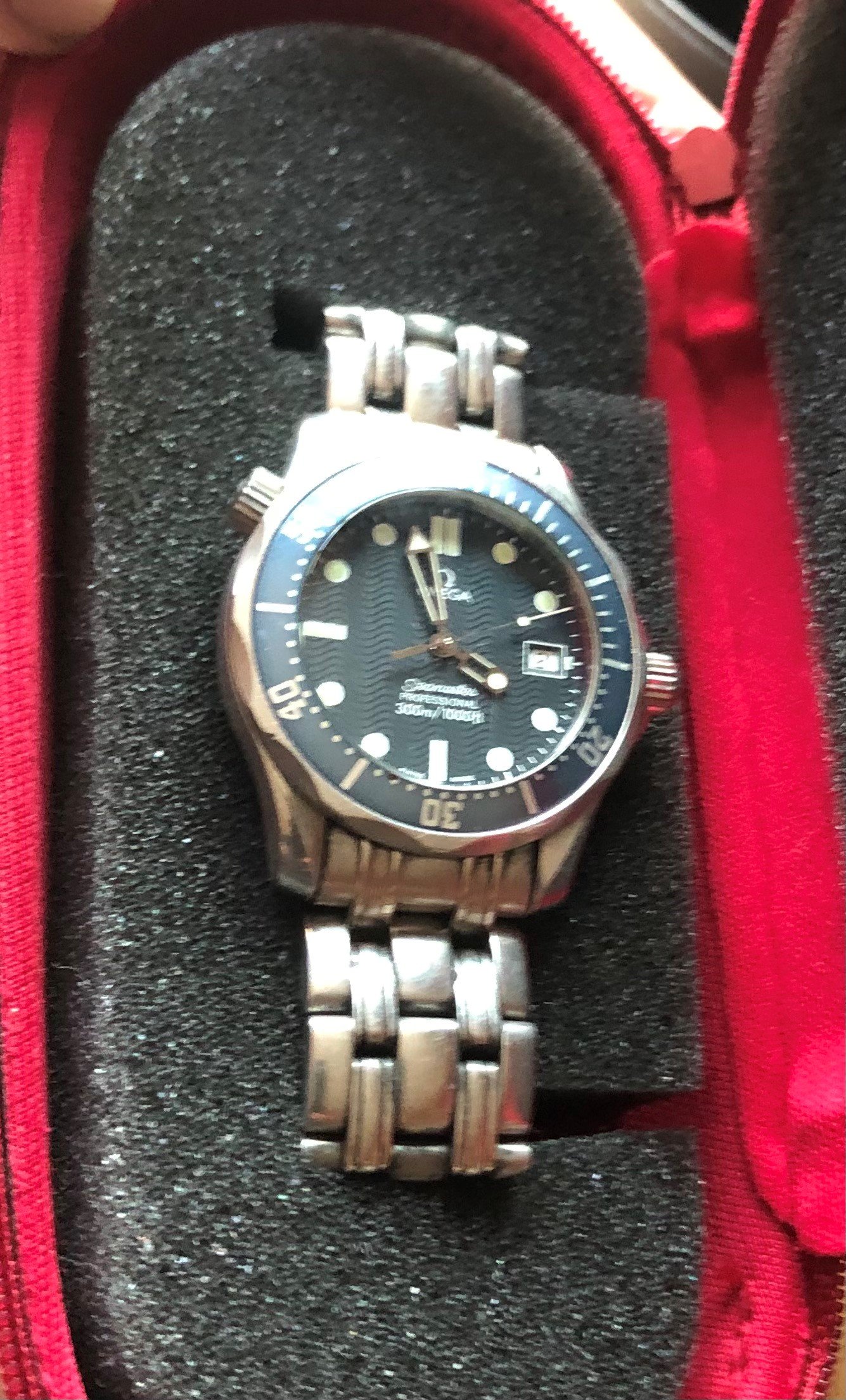

Afternoon all. I've been quoted £585 for a stainless steel replacement (possibly refurbished as well.!) strap by Omega in the UK - it's worn and scratched?. I cant justify that. I'd love to know if there are any alternatives I might try? Are good condition straps about? The watch is valuable only to me so I'd be happy to receive any advice. Kind Regards. Mike ( Cardiff, South Wales)

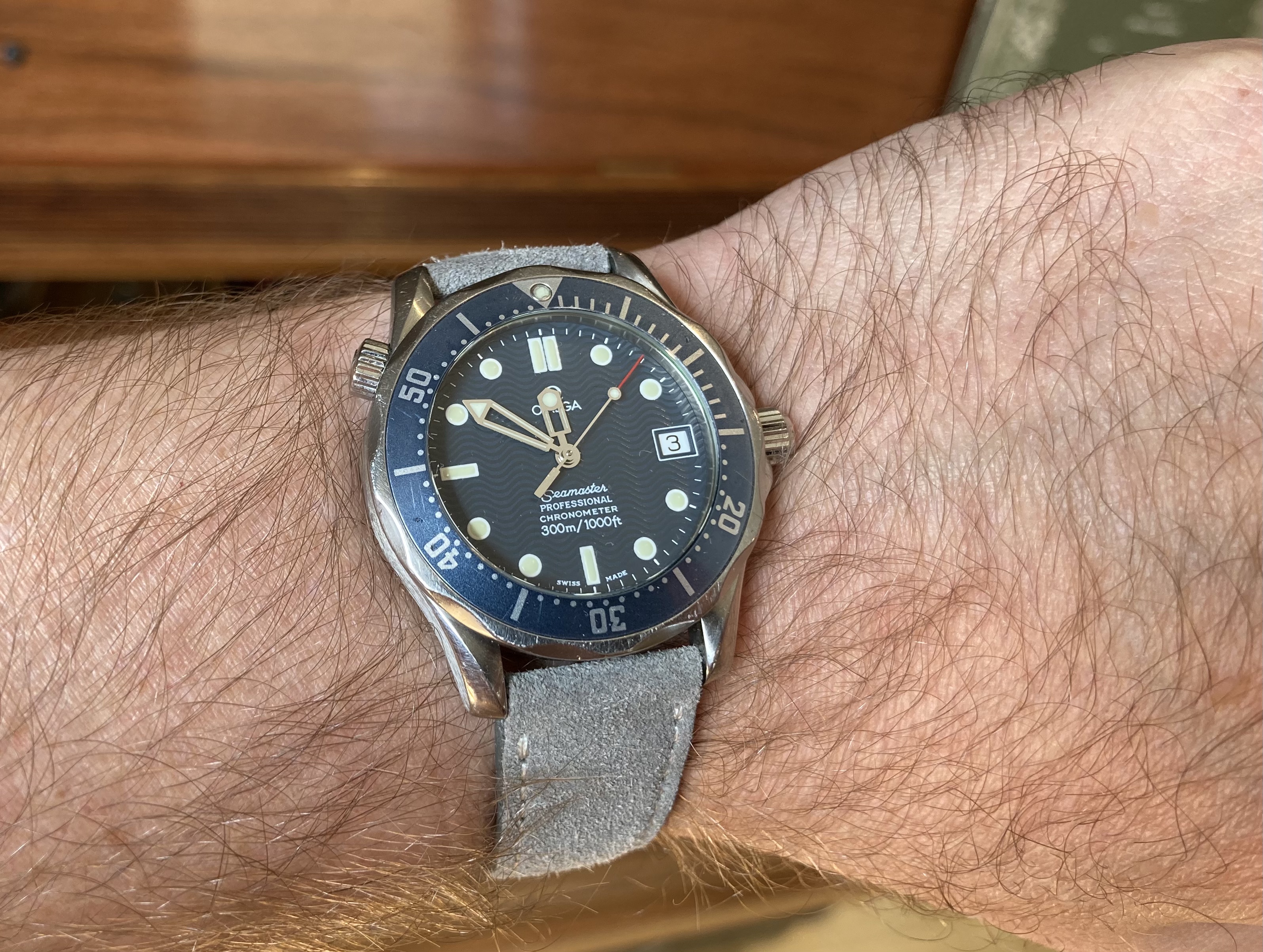

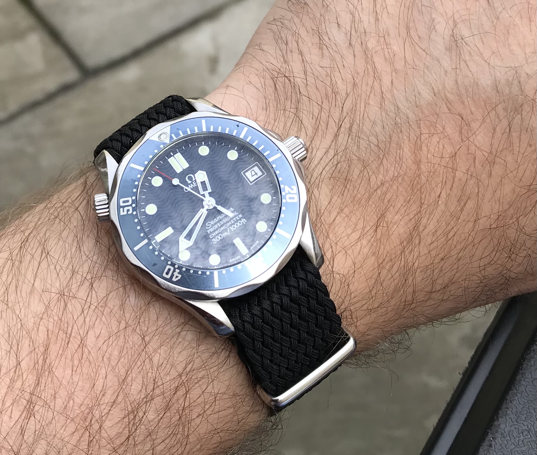

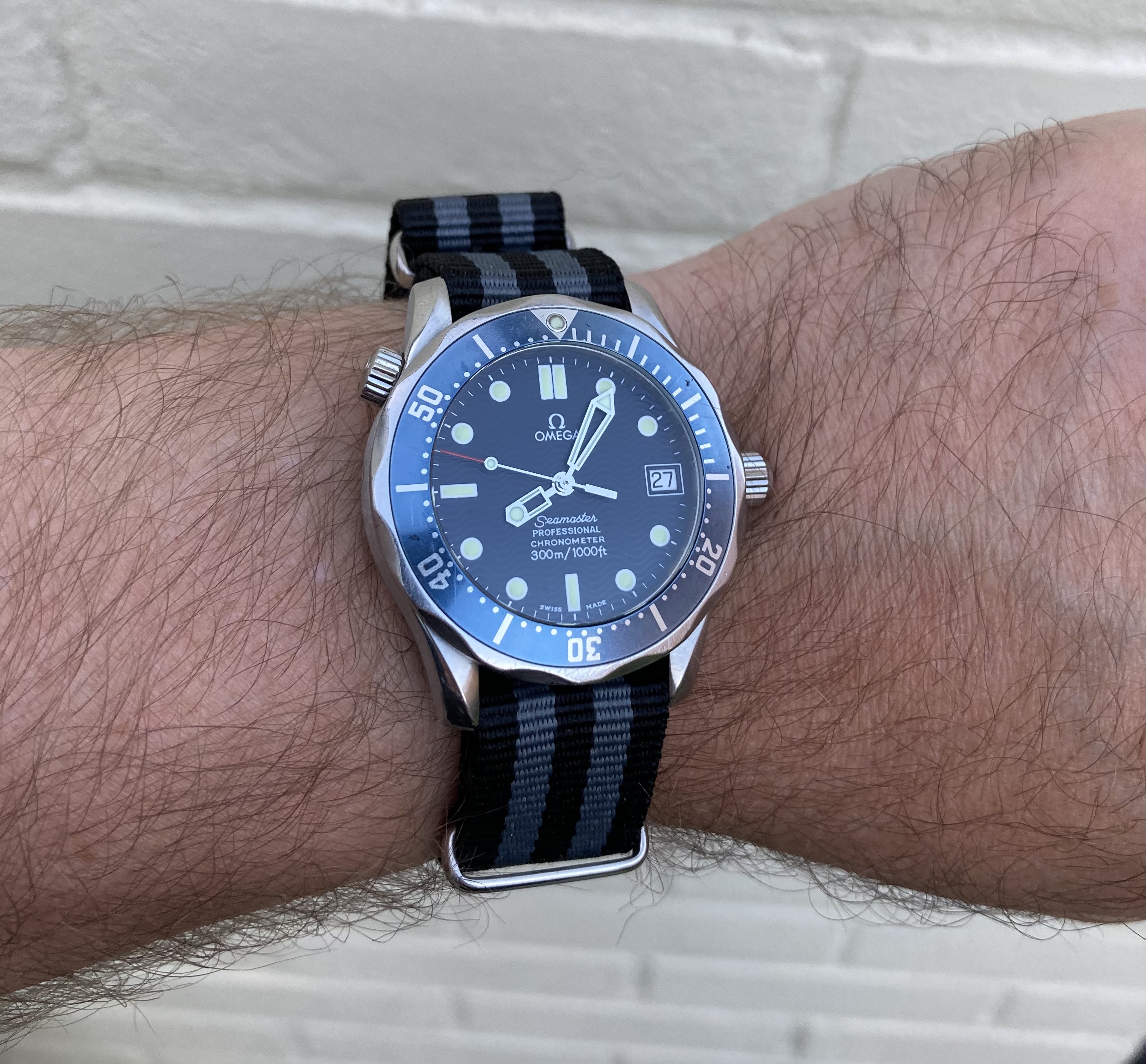

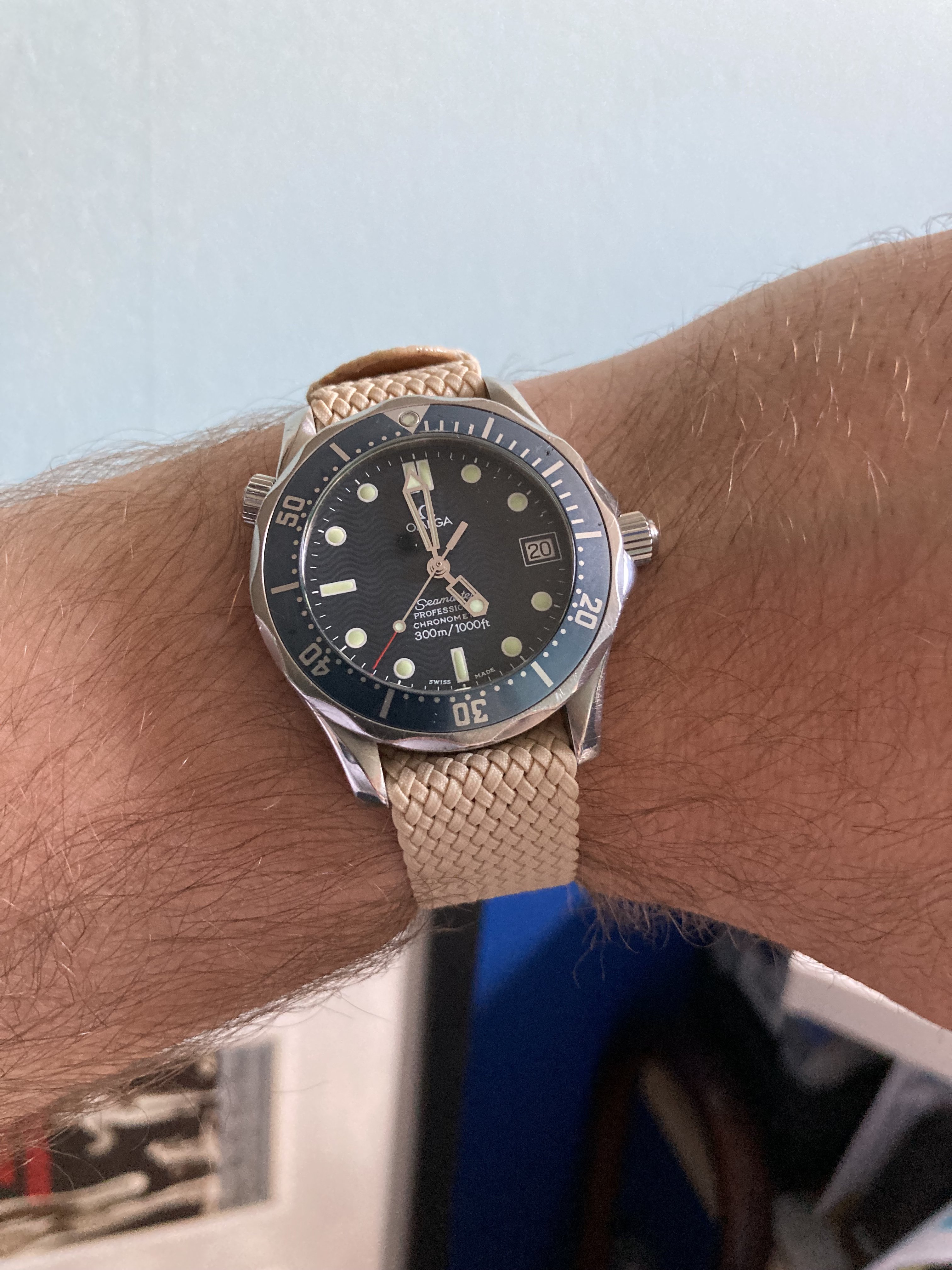

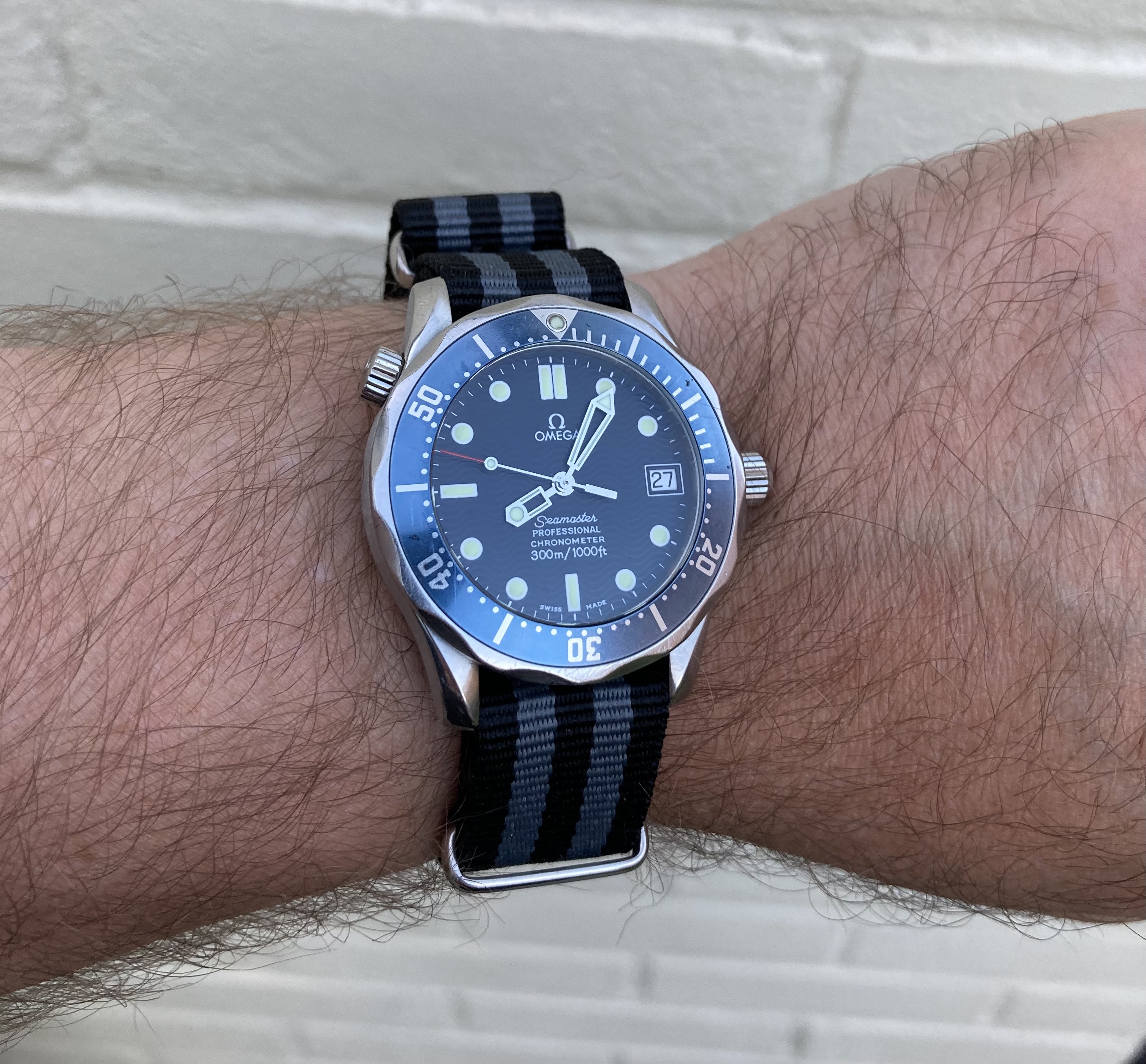

Hello Mike
The above question from @Modernism is a good start to work out what you want, but if it’s the latter, here are a few alternatives I’ve tried on my midsize Bond. Especially good in the summer, as I find that the original bracelet can be a bit heavy and bulky:

Hello Mike
Cheers Wilderbeast, I hadn't thought of that, I guess I was still in shock at the £585 😀 , any pitfalls to avoid or preferred brands you've had success with?

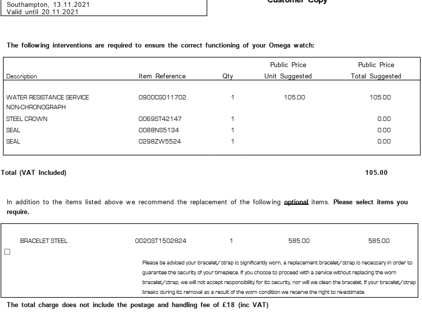

Omega service price for a three hander quartz is less than £400. What else did the quote include?
Hi Dennis, they sent me this quote

I'm sure that if you opted for a FULL service Omega would look at the worn bracelet issue differently.
I doubt they would really. Not sure if you realize, but this is a quartz watch, so there isn't much else to do with a service, as they have apparently determined that the movement is fine.
The text at the bottom isn't some typical text like when they say they everything is scratched when they receive the watch for servicing. The bracelet is worn to a point where Omega is saying they can't guarantee it. So the OP could continue to use it as is if he wants, but the risk is on him, not on Omega. It's very unlikely you will get Omega to reverse that stance once they have already put it in writing.
So Al, are you saying that a water resistance service costing £105 is just as good as a full service and would usually include bracelet renovation?
Why would anyone pay over three times that amount for a full service if Omega won't touch the bracelet?

So Al, are you saying that a water resistance service costing £105 is just as good as a full service and would usually include bracelet renovation? Why would anyone pay over three times that amount for a full service if Omega won't touch the bracelet?
A "full service" on a quartz watch would include replacing the movement if there was a problem. If there is no problem, the only thing Omega is going to do to the case is to replace the parts for water resistance, as the quote states. The bracelet will always be a part of the service, if it's a full service or partial. Do you really think Omega is just going to ignore the bracelet on a watch when it comes in, and risk having the bracelet fail, and them be liable?
If the determine that the bracelet is in bad enough shape, they won't replace the worn parts, and will tell you that the bracelet needs replacing - that isn't going to change based on the type of service.
Incidentally Al, have you ever come across one of these bracelets that has been beyond repair?
I've had Omega condemn bracelets on watches I have sent to them for service - these were older quartz watches that had to go to Bienne, so yes I've had this exact same thing happen.

Much appreciate the comments Archer, thank you. I had no idea the bracelet was worn of course. My first thought was to ask if there was a market for a refurbished strap. But another helpful gent suggested I could change it for a NATO strap which might be the way to go if a refurbished bracelet is not worth the bother. The watch has sentimental value only to me and has been well worn.
To be honest, if you have a strap changing tool and some spare spring bars, changing straps on the midsize is easy and 18mm straps are plentiful. I like changing up the look of my watches with strap options. I do think perlon (the braided straps) work particularly well. They’re available from many aftermarket suppliers.
