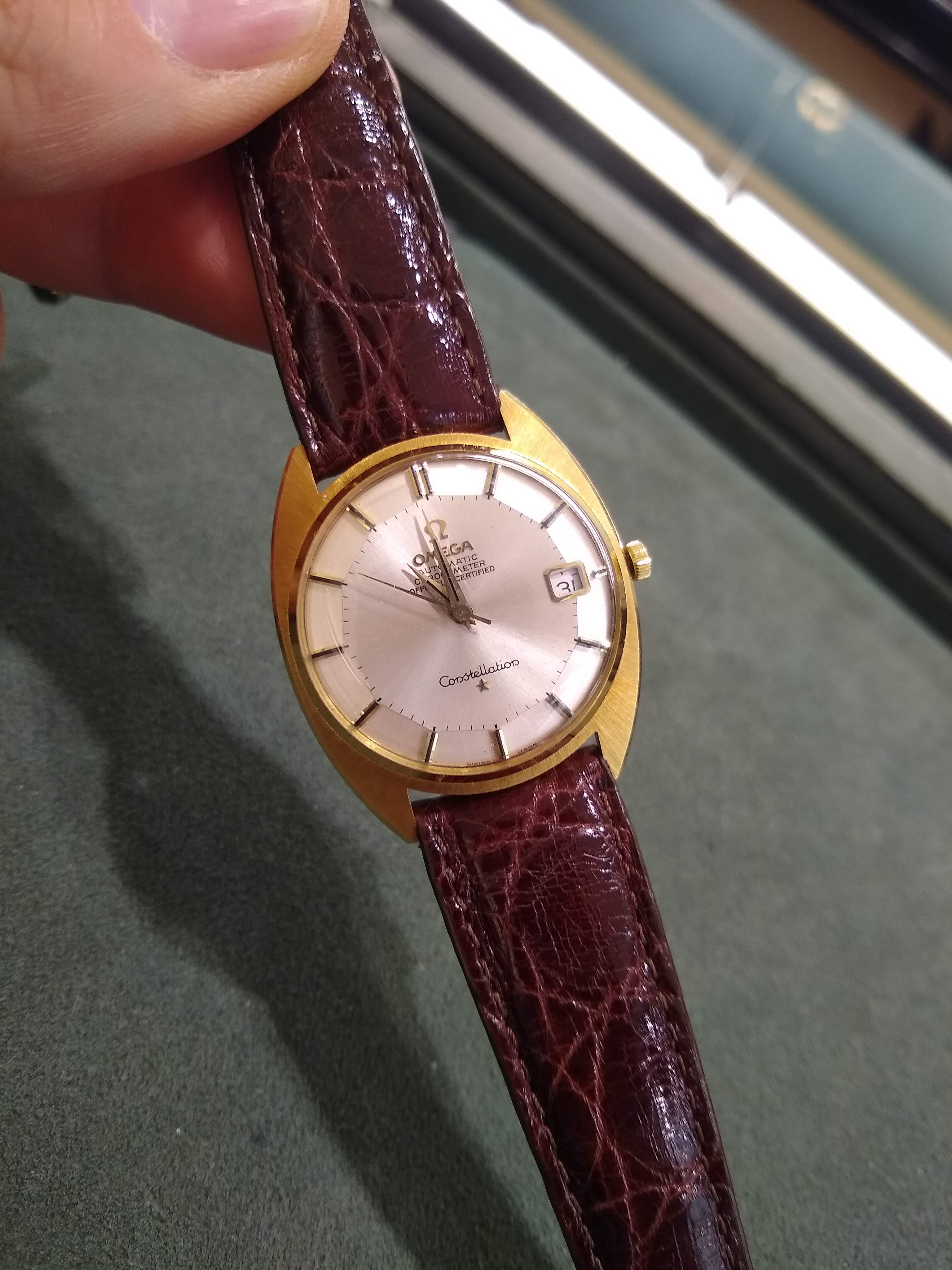

Hi guys, this is my very first post and i'm happy to be part of this community. I know i have a lot to learn (actually a ton...) and i hope I can give something back to you all.

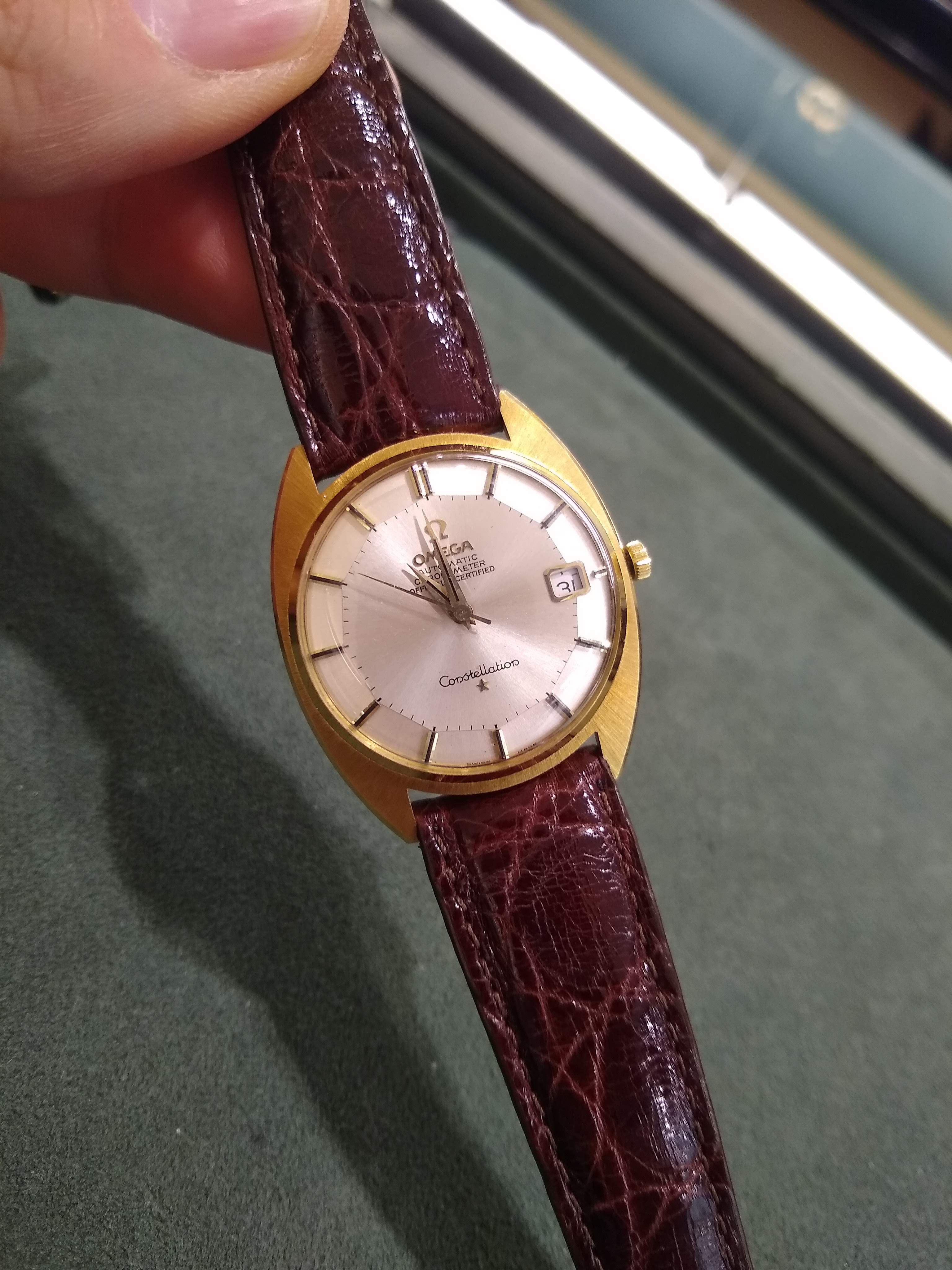

Here's the fact: I found this Omega Constellation Pie Pan dial in a gold c-shape case in a local vintage jewelery store in Florence
I took this three photo and I started my research, on this forum and generally on the internet. The watch has no box/paper. i couldn't find any match with this case and dial.
So i went back to the store and ask to have it open by their watchmaker. These are the pic i took this afternoon.

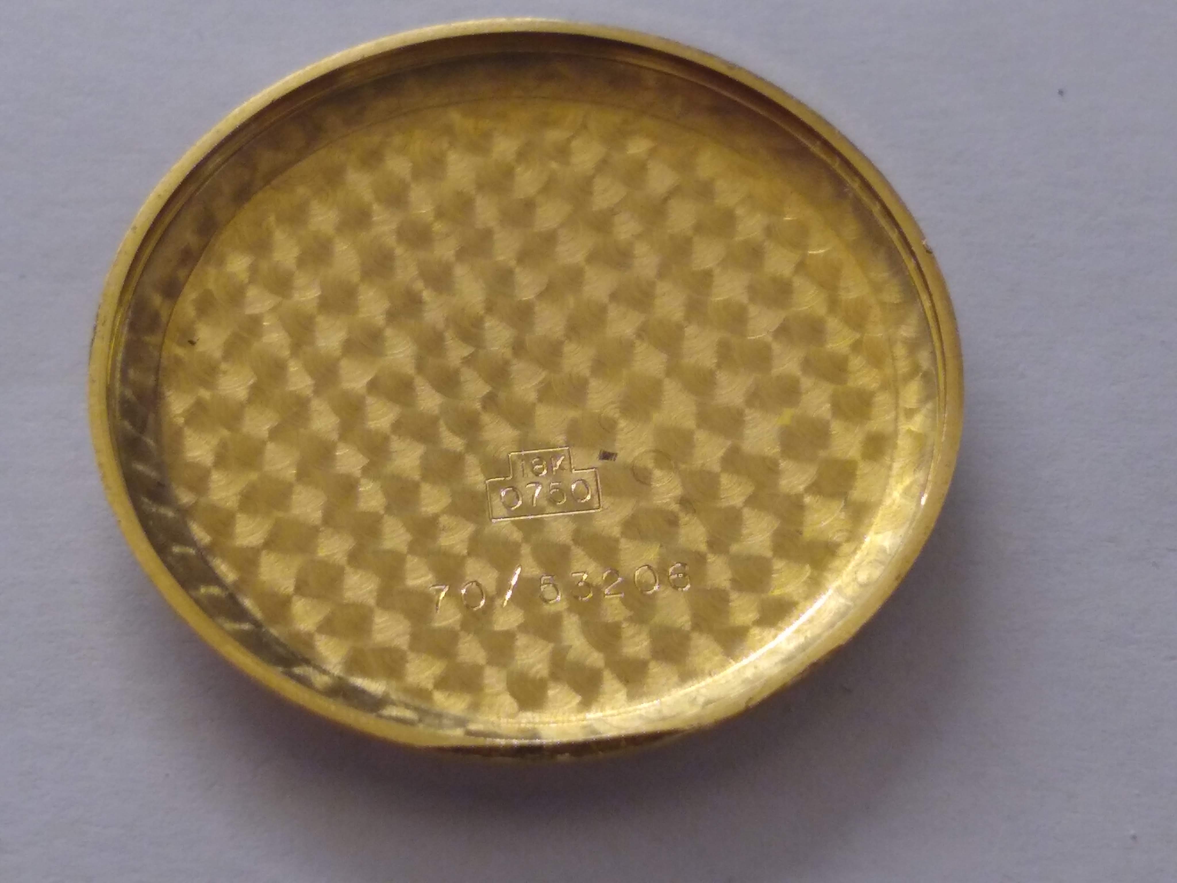

the caseback has no "omega" engraving, and i can't match the reference number 70/53206
Believe me this is going me crazy 馃榾))
this part of the case has beautiful radial finish, it's barely worn, only small sign.

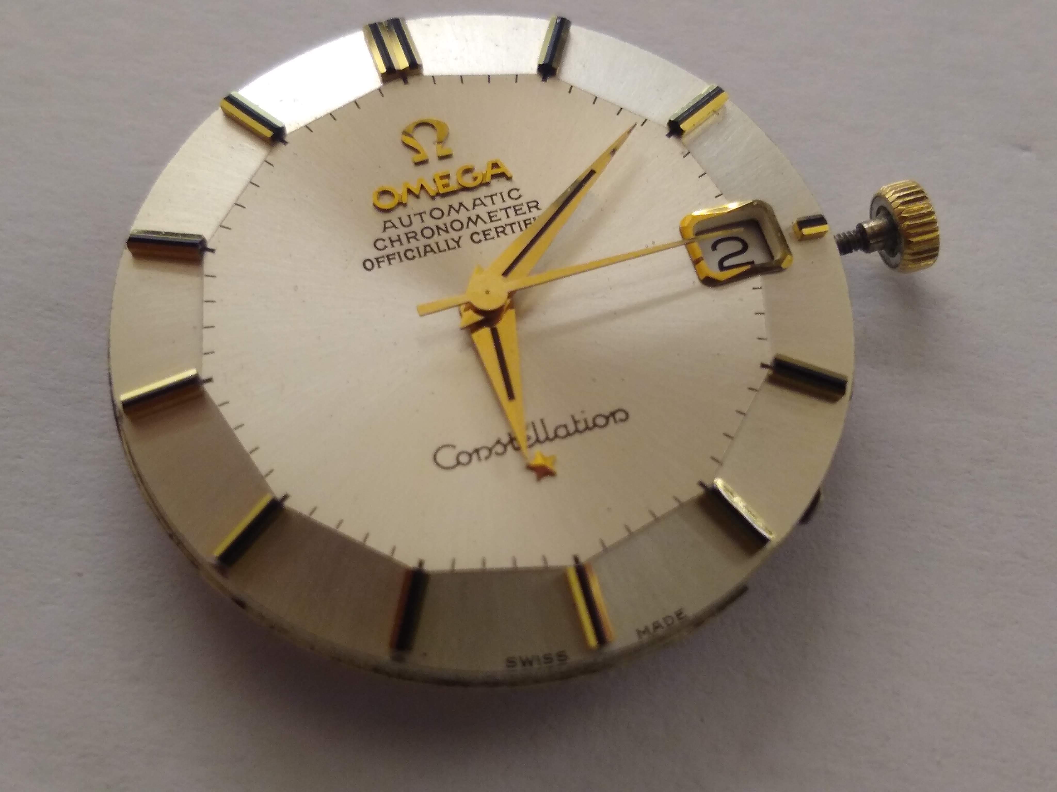

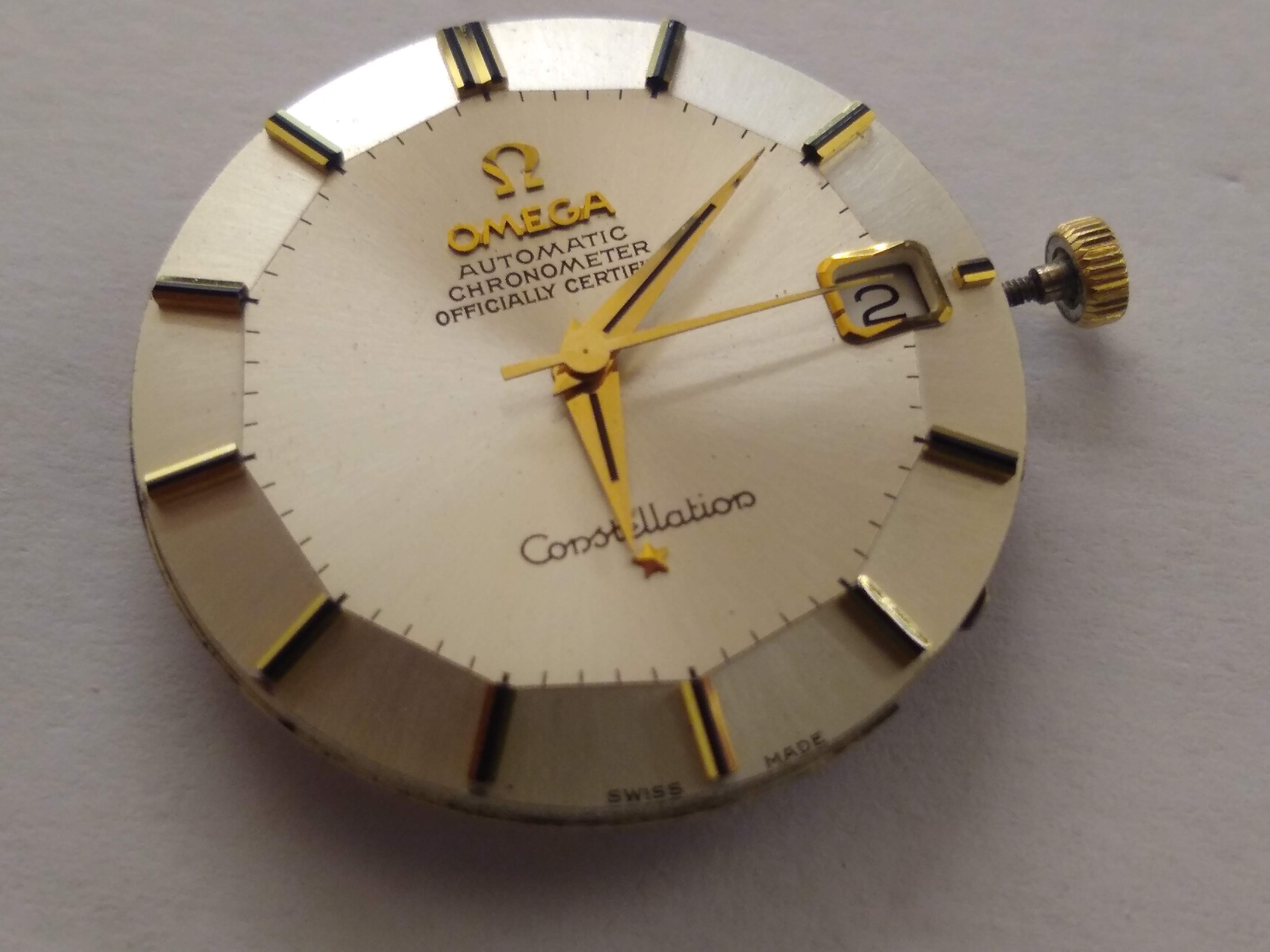

The Pie Pan dial seems original to me, with onyx indexes, logo and star applied, contoured window date.

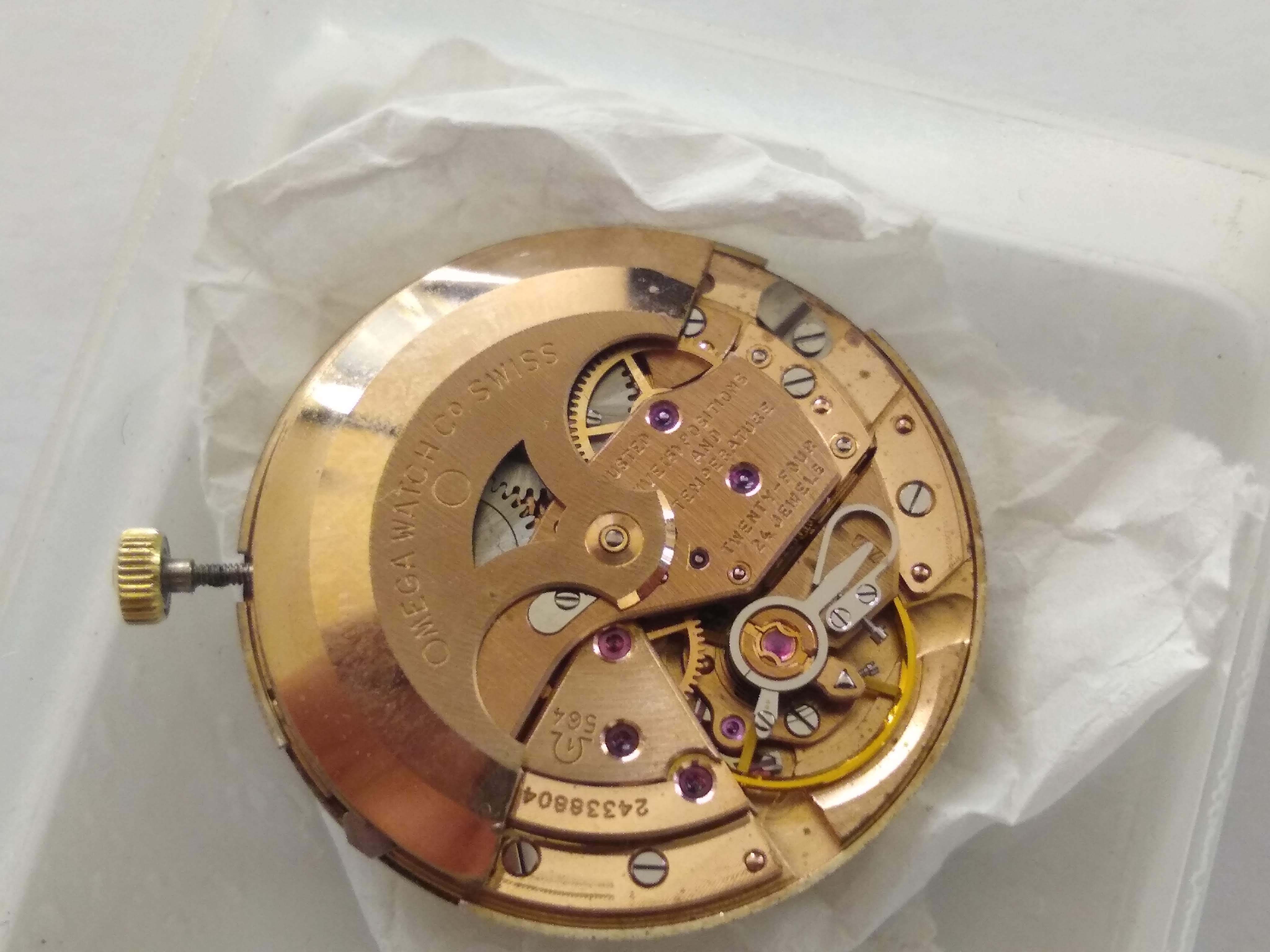

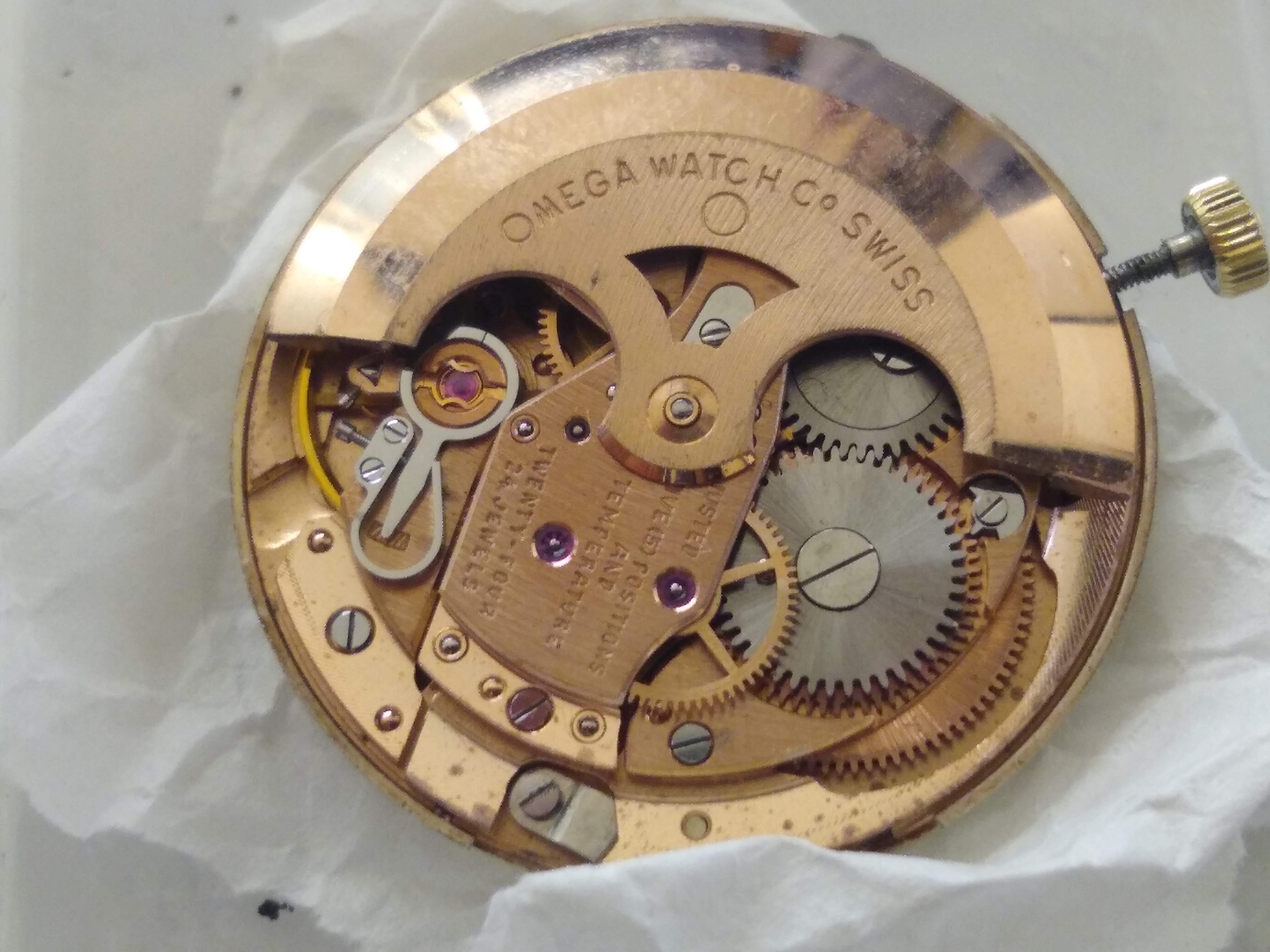

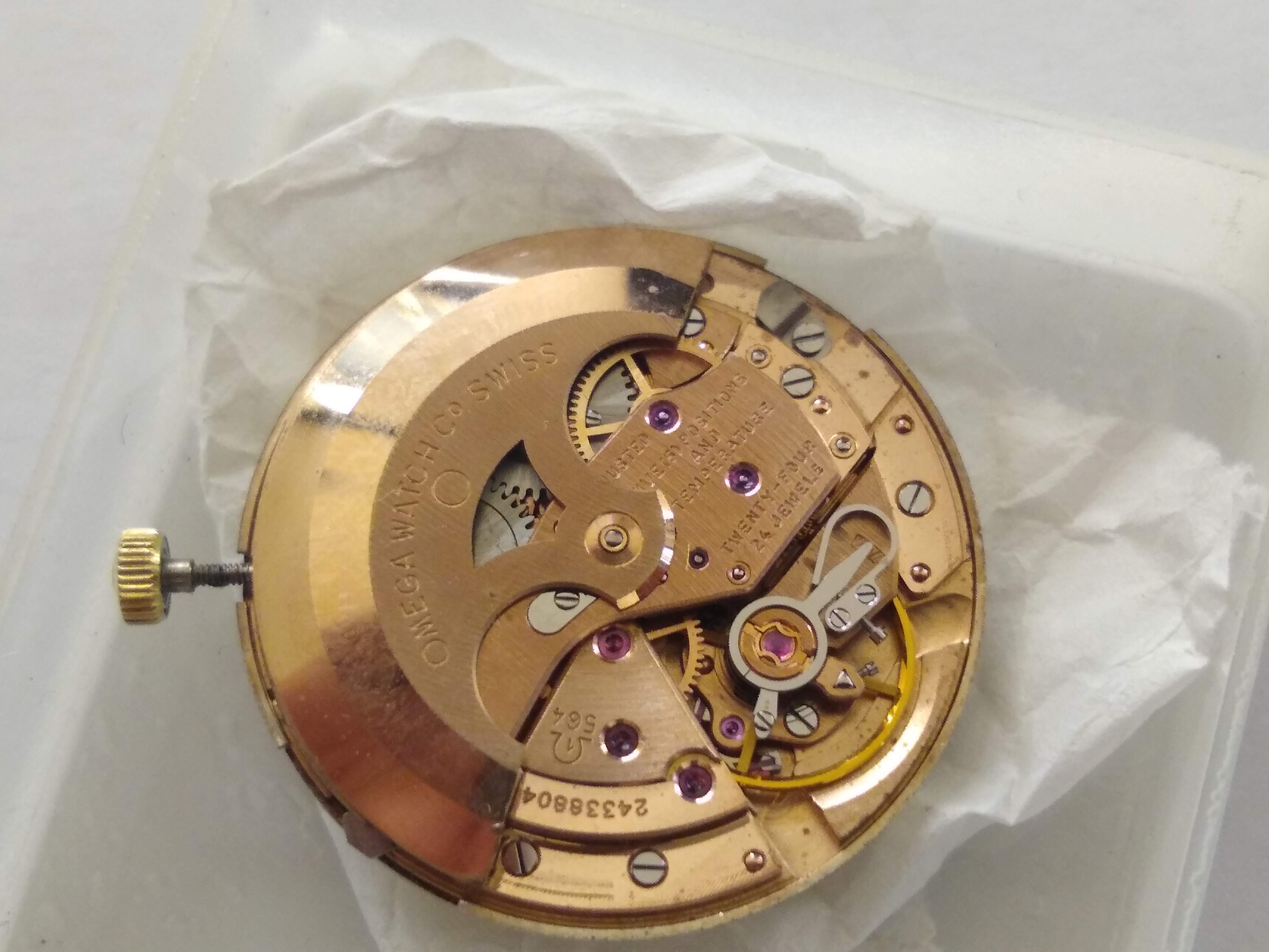

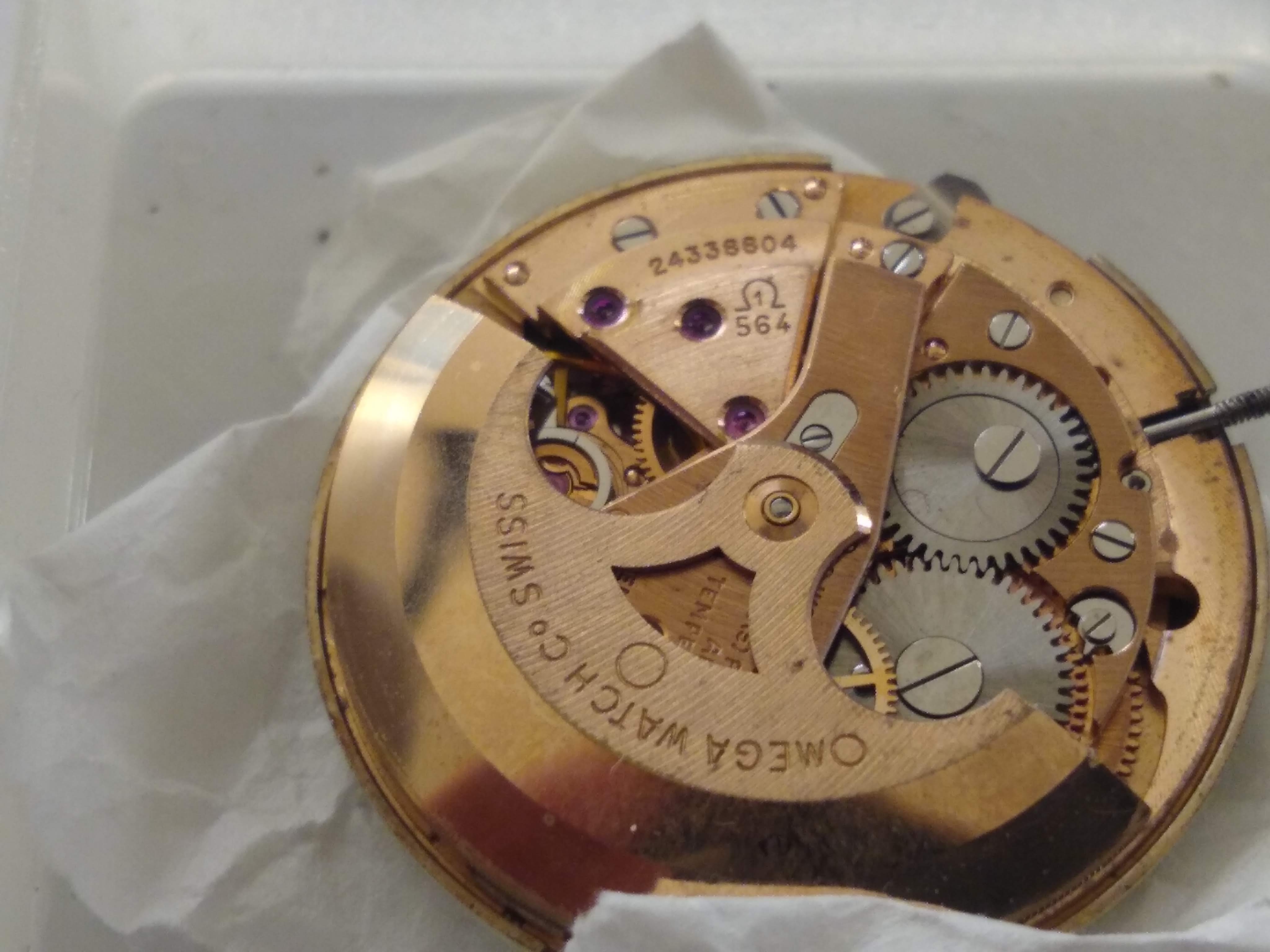

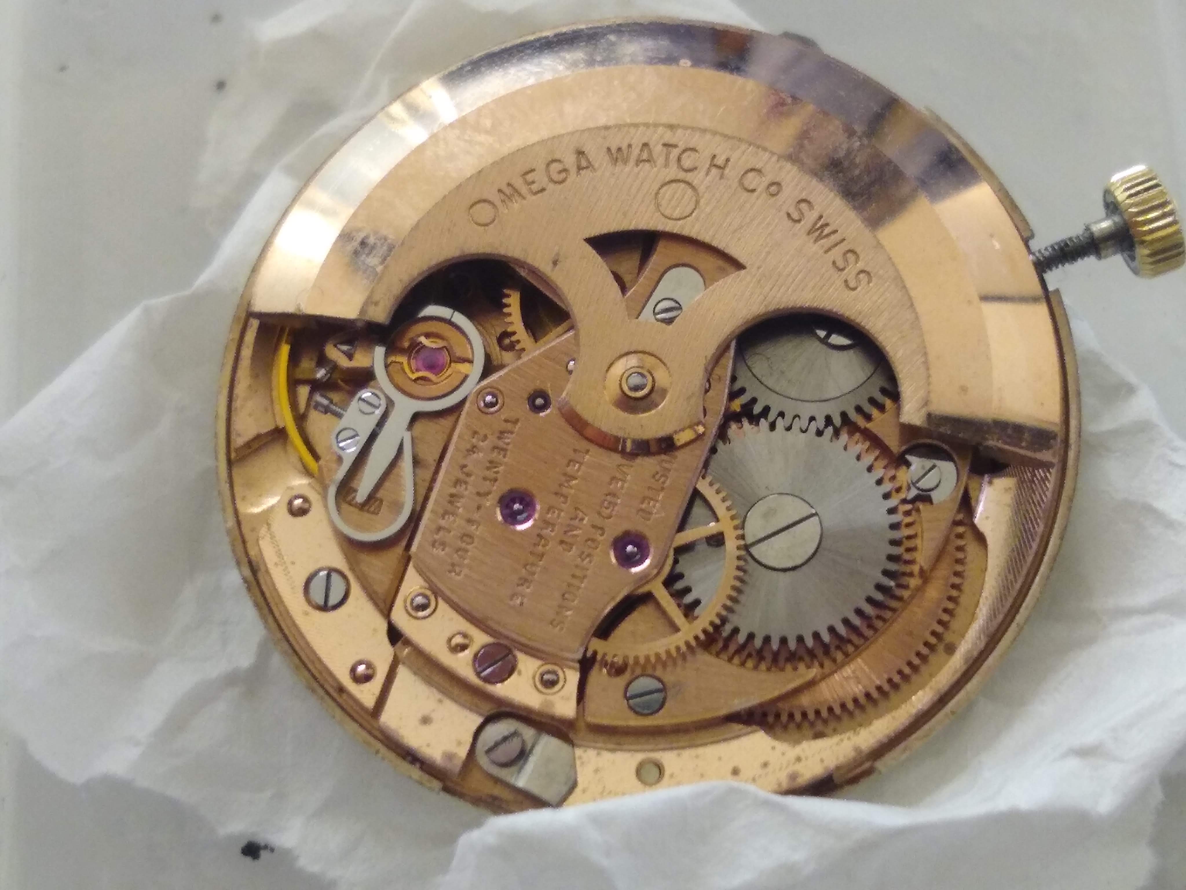

The movement is a classic 564, serial number 24M place it in 1966/1967.
So, Is everything in its right place or do you have any concern?
(my doubt is: do this Pie Pan Dial ever have a gold c-shape case like this one? If not, is this a franken or a complete fake?)
I'm eager to know what you guys think, in the meantime thank you for your time
Federico

Hi and welcome to OF!
Hm, I cant say I have ever seen a pie pan in a c shaped case. So my initial thought is that it is a franken. But on the positive side the pie pan dial looks to be in good shape!
1,325
1,872
Hopefully the real experts will be along shortly to correct me, but i smell a rat here, and i am afraid that your watch is a franken
i have never seen a C cased connie with that pie pan dial
please take a look at the thread on this forum called c cased constellation, and search google for an essay on c cased constellations on Desmonds fantstic site - hopefully the link below will work

I would have to agree that there is something off with the case to. Looking at the 篓convex between the lugs its is way to circular from what I have seen in other c shapes. Maybe there are variations, but looking at other cases they have a lot less curvature. But then begins the question. Did someone take their time to create a false c shape case in 18k gold, with a constellation emblem? It would probably be cheaper to source a real 18k case .

Hello there and welcome!
It is first time I see something so peculiar - case and dial both look good at the first glance and than ref. number on the caseback, which is funky for 564 Connie from this period.
For me it looks like Frankenstein.
Happy to be proven wrong though 馃槈
Other perspectives?

And some other thoughts........

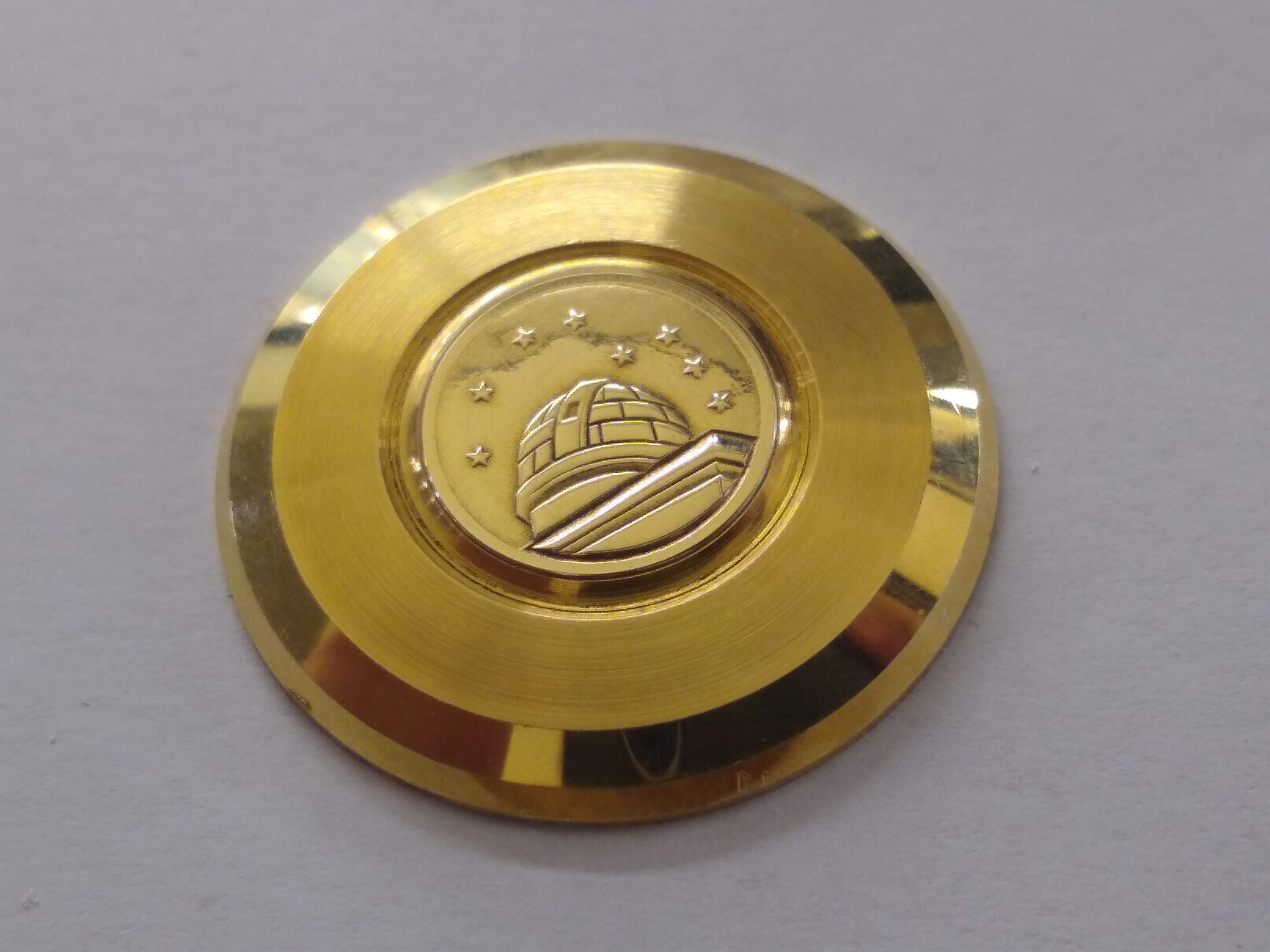

shouldn't the case back be screw fit?

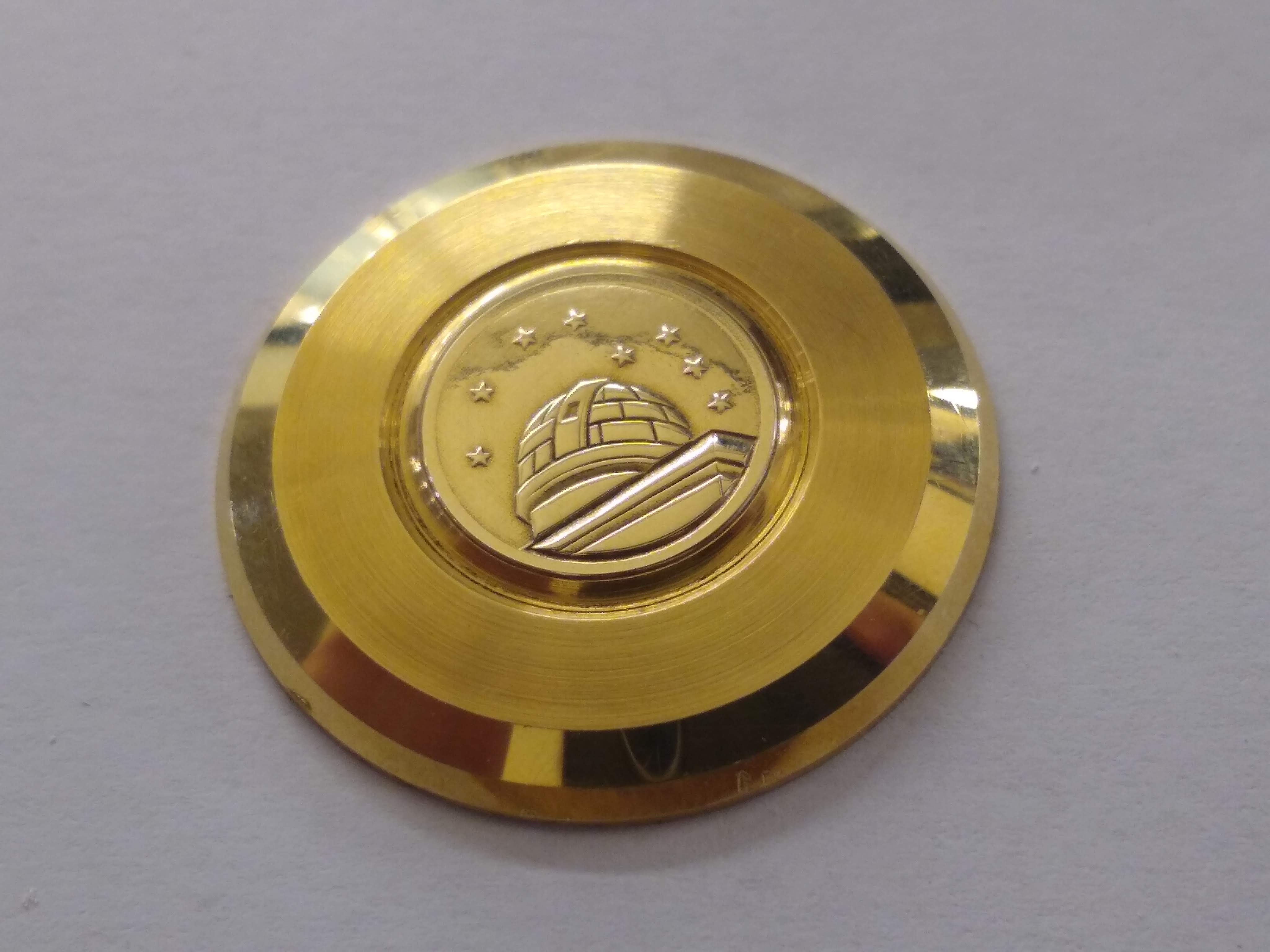

also, the connie medallion seems to be a different colour to the rest of the case back
its not looking good - sorry

Also inside the case back, Omega would always write 0.750 and not 0750 as seems to be stamped inside your case back
Could you show better photos of the back of he lugs - as there should also be 1 or 2 hallmarks stamped there
At the moment, i suspect that the case and case back is not gold at all
Remember that this only applies to Swiss made cases.

It were me and the cost wasn't an issue, I'd ask that the case be tested to verify 18K gold... and then take the whole thing and run like heck.
Eventually the case will either be authenticated or a new case found.

I'm going with a "correct" locally made case.
1,325
1,872
I hope you are right, but regardless, the whole shape of the case, especially around the lugs is completely wrong
so wrong in fact, it doesnt really look like a c case Connie should

I can鈥檛 remember a locally made C-case case coming up before.
Possibly because restrictions on precious metals were being eased in the late 60s?
As for the OPs watch:
Good looking pie-pan dial
Pie pans don鈥檛 appear in C-cases
Snap back case
Significantly wrong shaped case
Medallion looks as though it may be applied not integral
So, definitely some kind of assembled watch.
Someone has certainly gone to a lot of trouble to produce the case if it in fact gold (as above, it needs to be tested)
if it proves to be gold and someone wanted a presentable gold dress watch with an Omega dial and movt then it鈥檚 would be worth having but I wouldn鈥檛 buy it as an Omega watch and price should reflect this.

I am 100% sure that we have seen this exact case shape on a Constellation being scrutinised here before. I can't remember what was made of it then, but I would have remembered if it had been positive...

That case looks remarkably similar to this kind of Eterna case:
It does look similar with the exception that the lugs on the Eterna are slightly flared

I took only these photos, there are no hallmarks in the back af the lugs -_-
they tested the gold as 18k, but not in front of me
