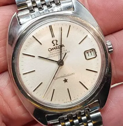

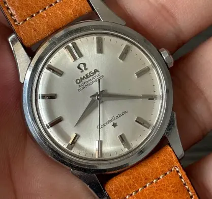

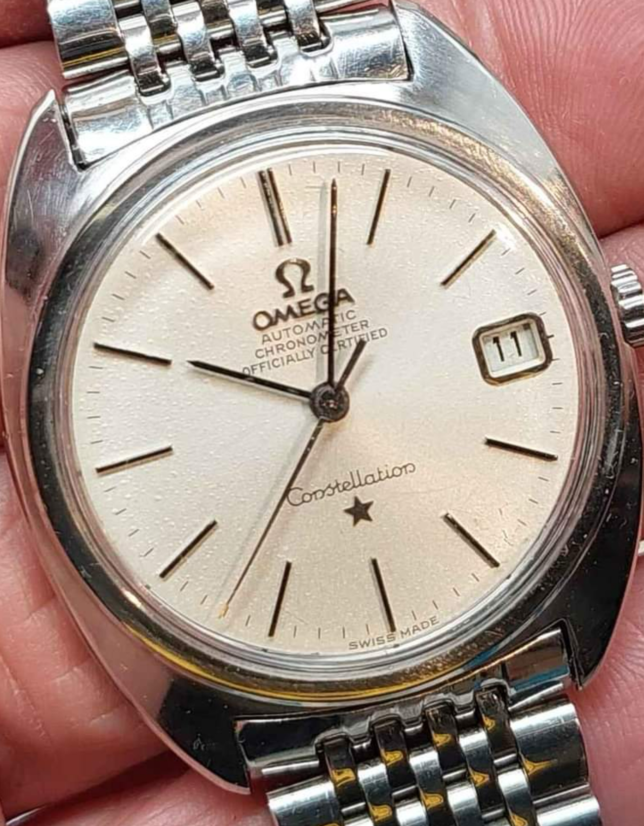

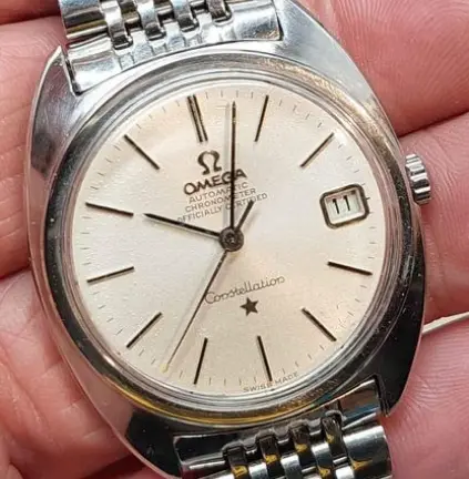

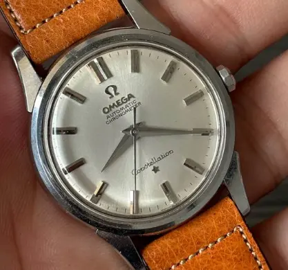

Good morning, I want to get everyone's opinion before pulling the trigger on one of these. Does the MOY test apply here or only on pie pan dials? (how do you Moy test the one with the brown strap if it's not "officially certified?"
Do these look like a redial? They seem quite "clean" and the sellers say they're untouched.

So I'm currently in the market for a vintage constellation as a gift for my brother. I have a few vintage Rolexes and my only Omega is a 20 year old Seamaster 2599.8. Would love to hear someones's opinion on these pieces described above since they have been through multiple owners over the years and it's hard for the seller to know if they've been redialed or not.

Hi there. Can’t tell much from those low quality photos. You should ask for high resolution straight photos of those watches.
IMO the first one looks like 14381, the case retains its original edges but the dial i’m not so sure. The MOY test could be applied to almost all the case, not only the pie-pans.
The second one seems to pass the MOY test but the case is heavily polished so IMO you should let it passes

Thanks Hant26 for your input, it’s greatly appreciated. Good eye on the c case polishing. I think I’ll pass on it since the dial seems to be showing its age unevenly.
FYI the c case is listed for 1000usd and the other is 1100usd.

The pictures are really poor but I think it’s likely the first one has a refinished dial.

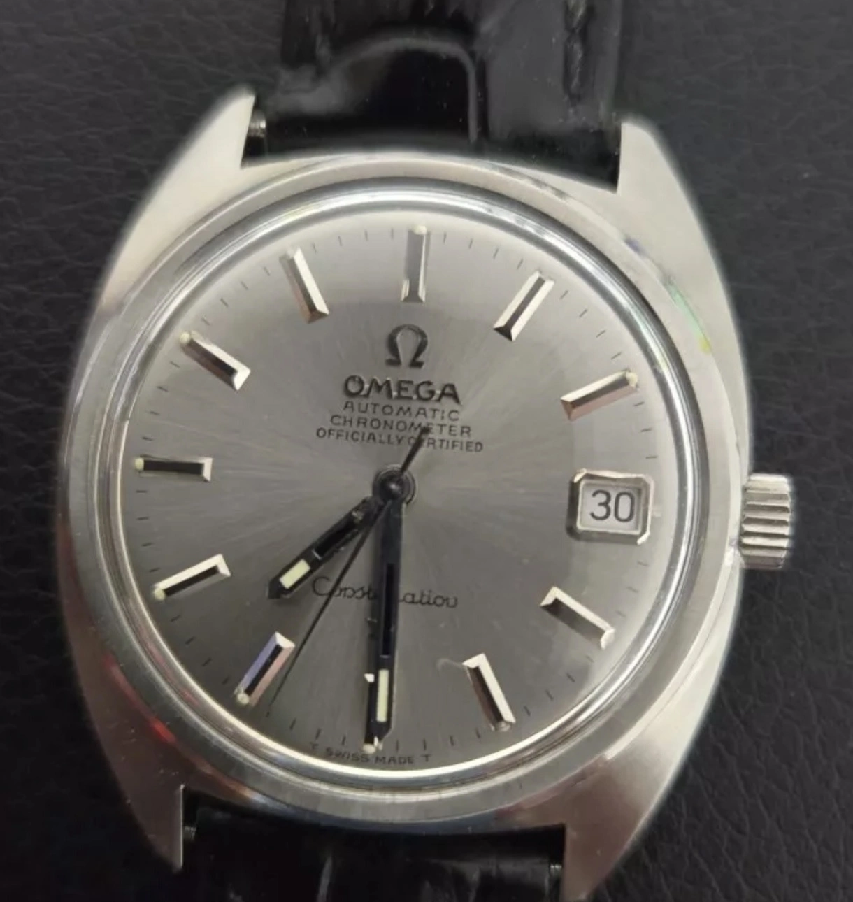

very true, thanks for everyone’s input. I’m still learning, and wanted to know what y’all thought of redials and price? Seller says this one is originally but it doesn’t pass the MOY test, what would you pay for this?

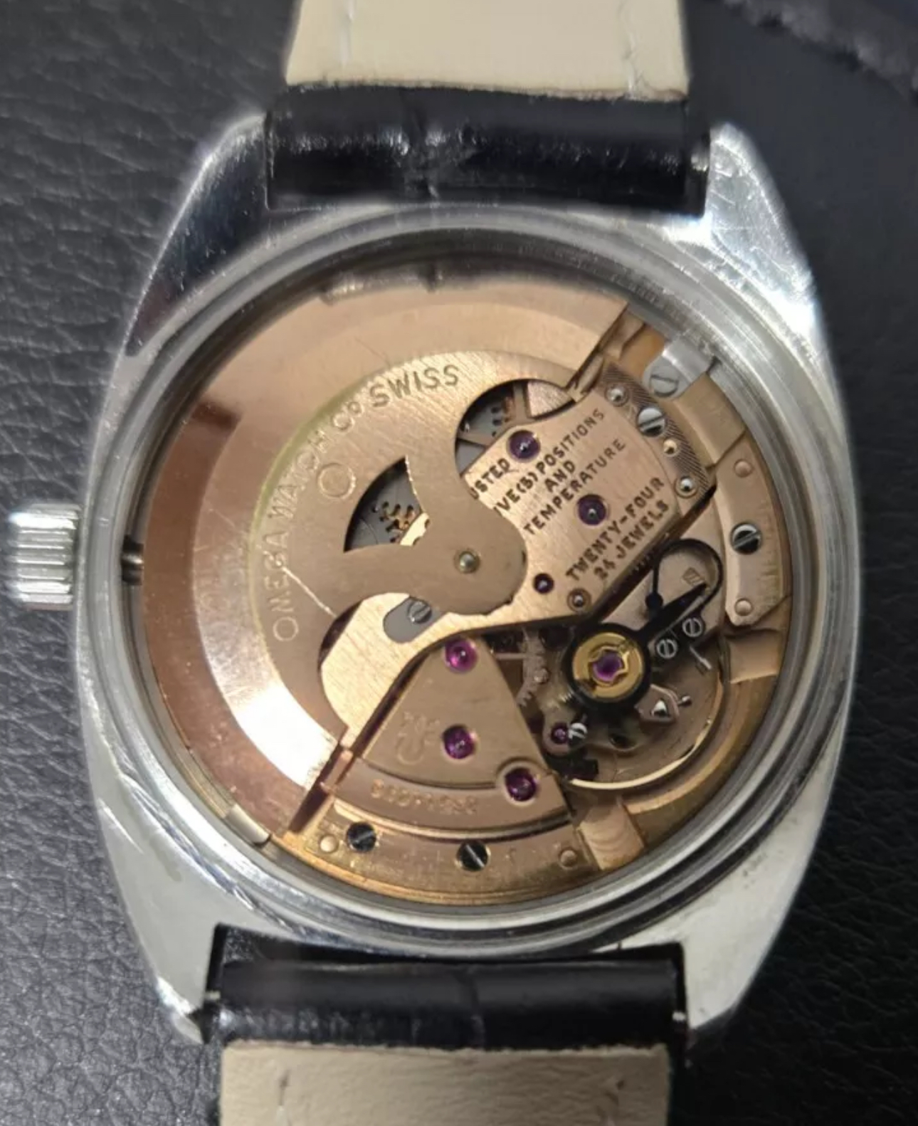

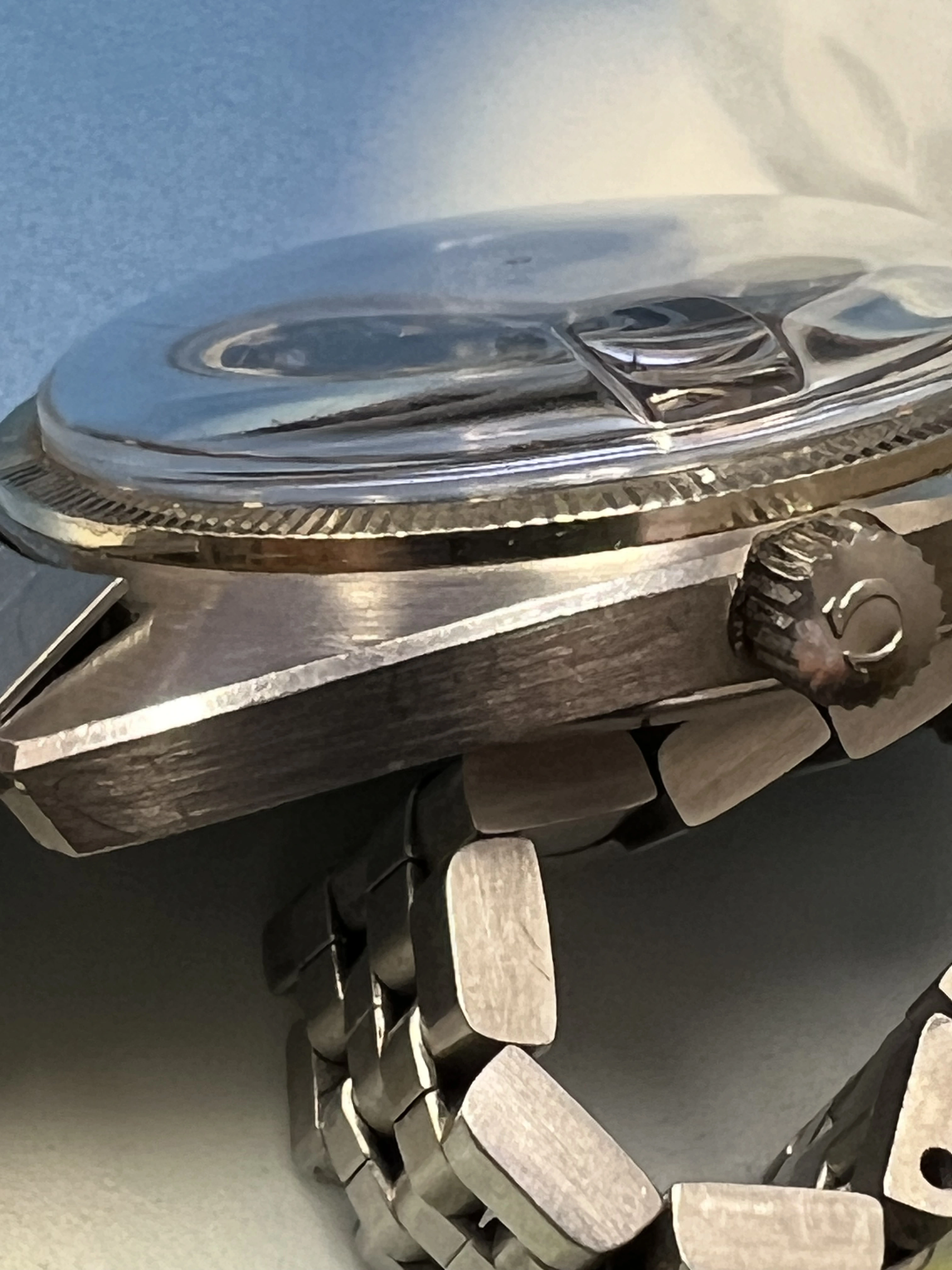

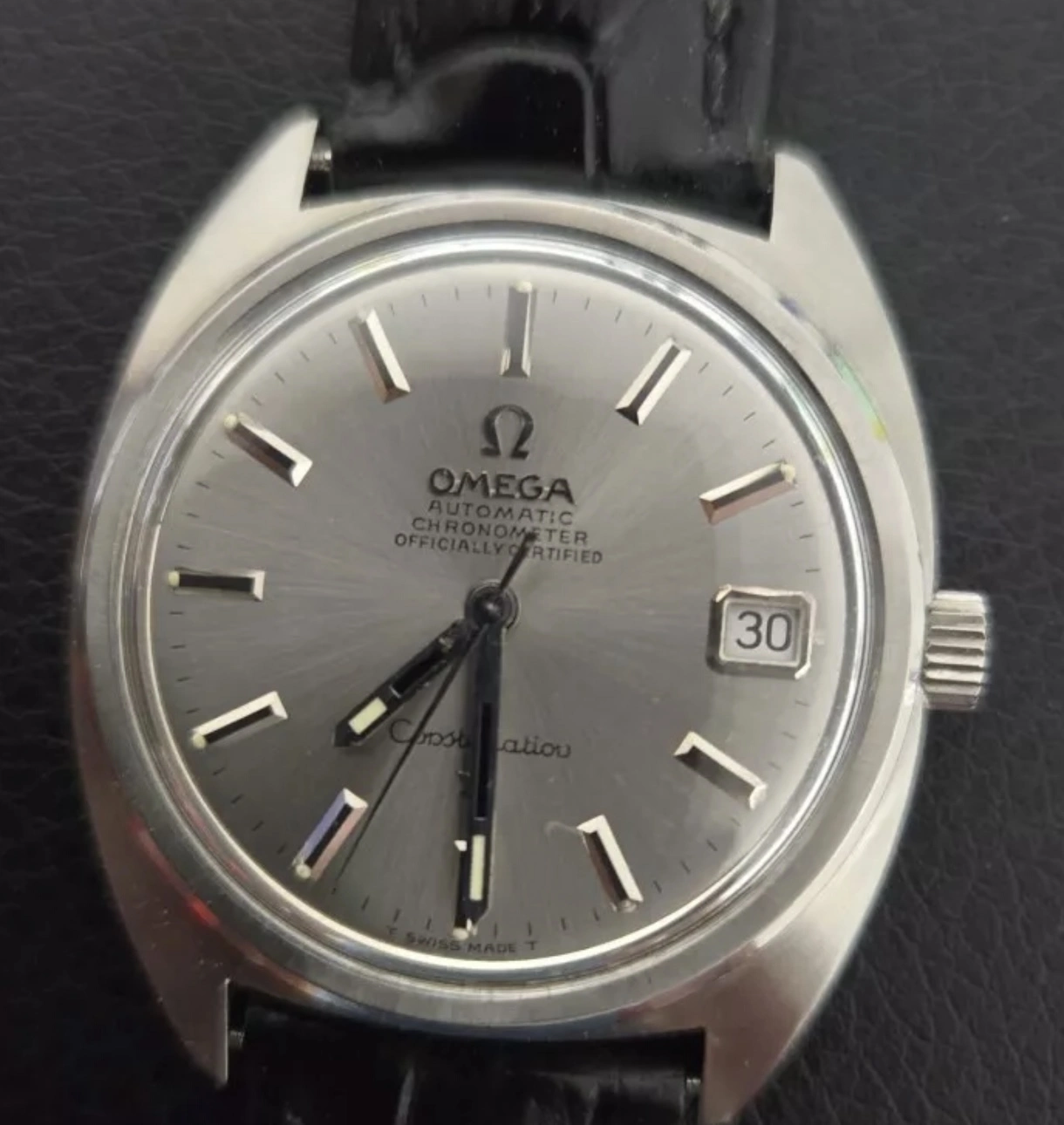

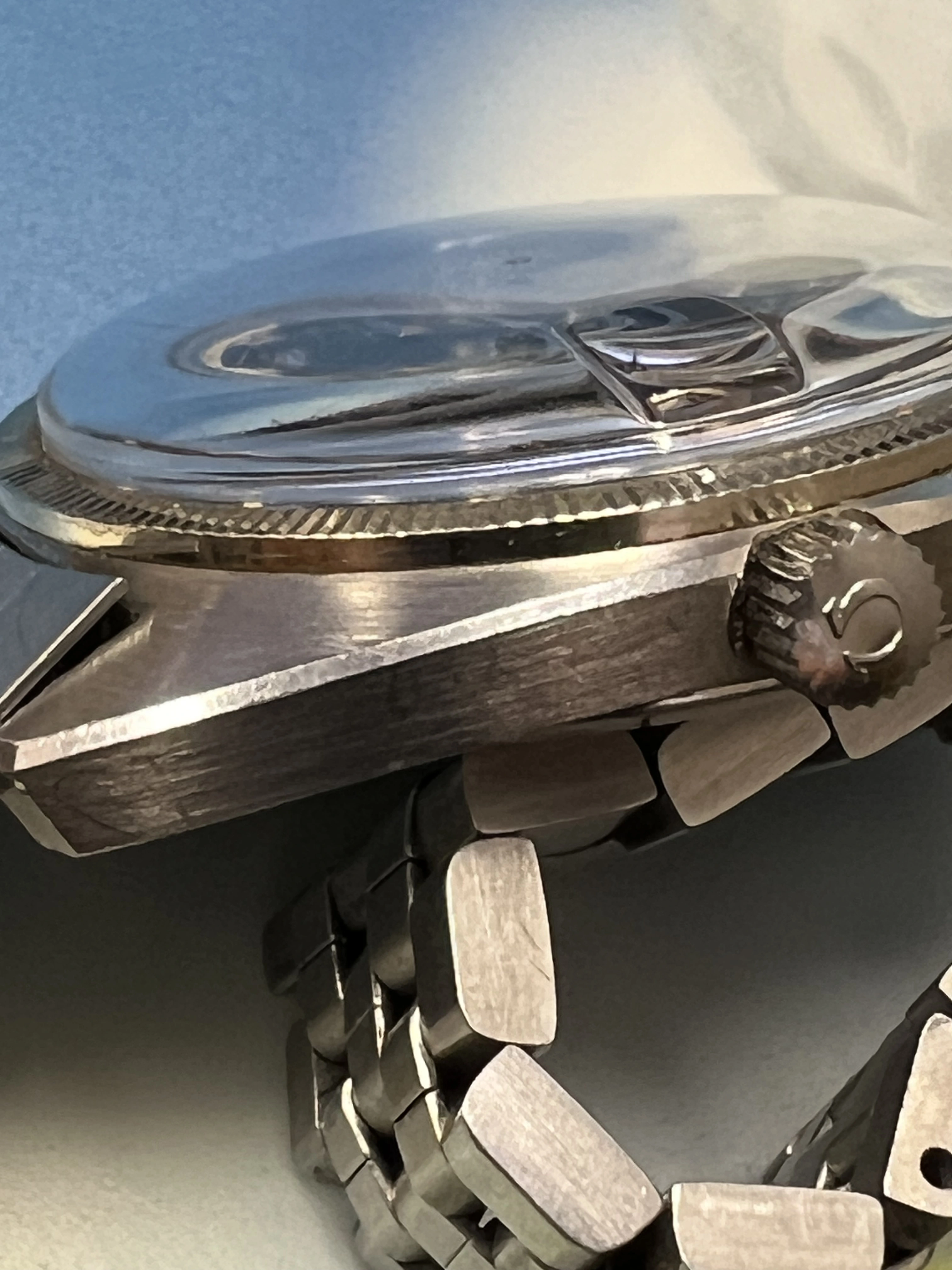

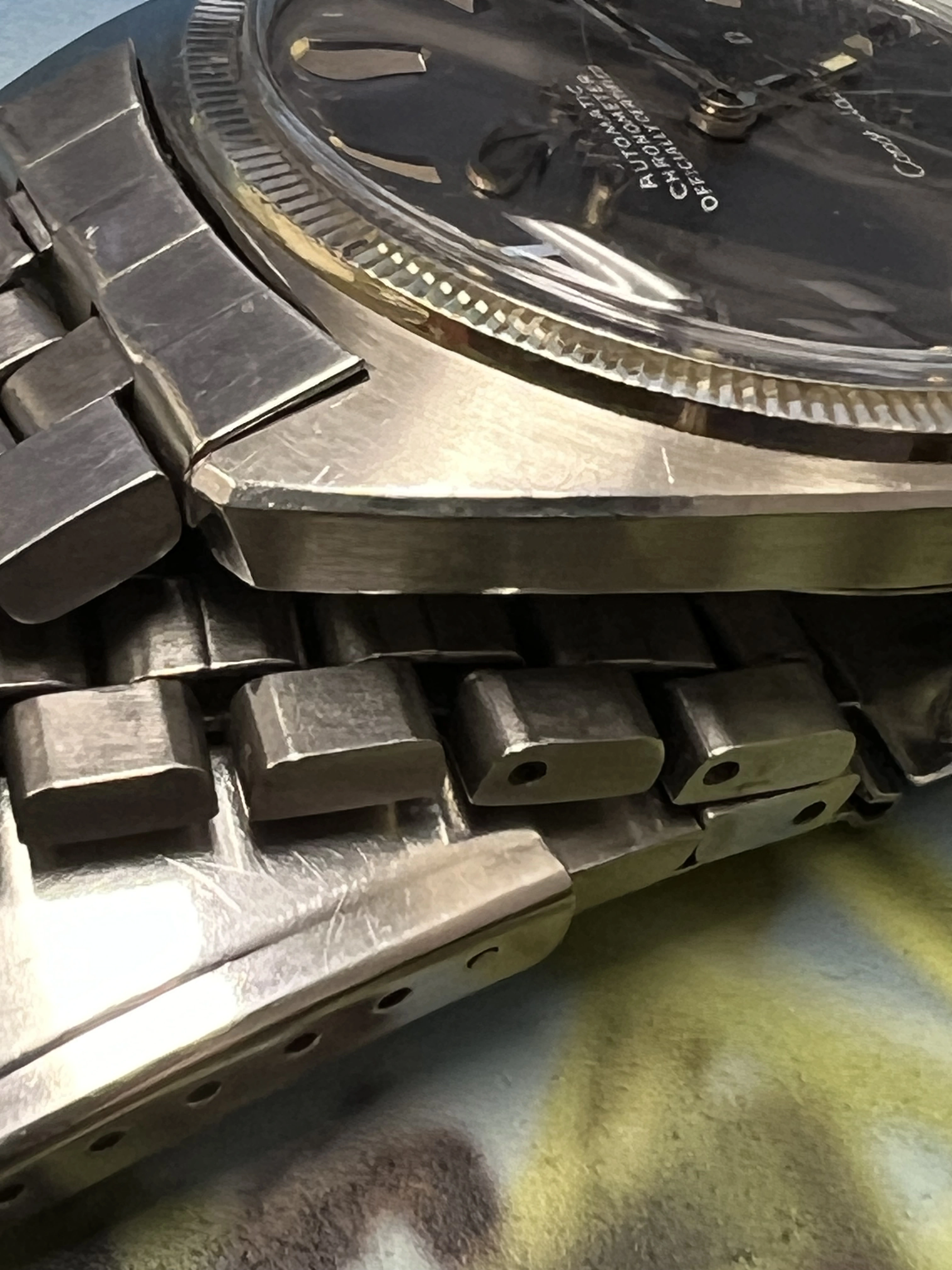

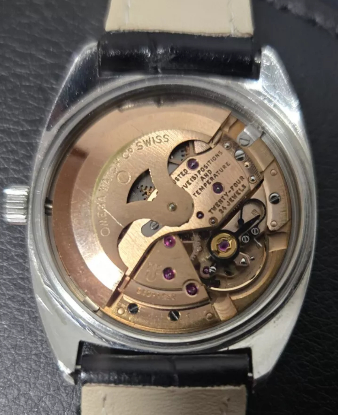

For the C case models I think the MOY rule is not always followed there are more dial variations. This grey dial is quite attractive. To evaluate case need angled photos to show if edges are sharp like this. Note the end of lug with sharp bevel as well.
Movement photo blurry but you can see regulator needle all way to one side which suggests need for service, as well as pretty heavy rotor rub so I would factor cost of service $300-500 range.
I would hold out for one with sharp unpolished case these are often overpolished.
What is asking price?
And great article on these C case by Desmond

Thanks Sog53 for the detailed info! Yes I quite like that grey sunburst dial, I’m hesitant because of the polishing, rotor rub and Questionable MOY test. It’s listed for $935. But if a service can run another $300-500, what would you pay for this?
3,681
8,015
I think dial is ok but I’d pass if edges not sharp and with tired movement with issues. That price would be ok if everything is good. But it’s not. Don’t buy one with issues you will regret it.

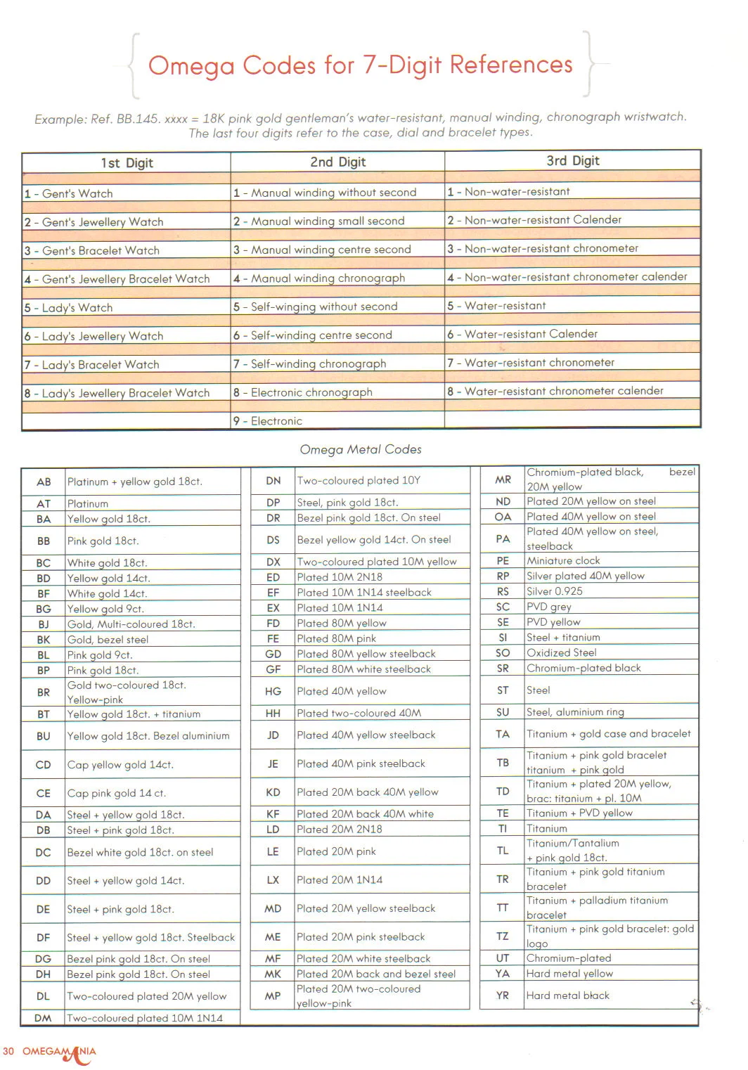

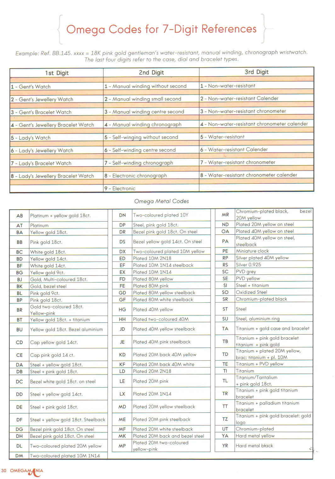

Case references relate to case style rather than case material.
So, e.g a dateless dogleg is a 14900 or 167.005 no matter if it is steel, gold cap or solid gold.
(Gold deluxe Constellations can have a different reference number but the cases are often dual reference )
For completeness here is a table posted by @gatorcpa in a thread discussing case material codes, which are a prefix to the case reference.

Here’s a better photo of the c case. Seems to have blistering on the dial.
I got the seller down to $800usd, thoughts on the blistering? Movement seems nice and shiny with no rubbing on the rotor.
