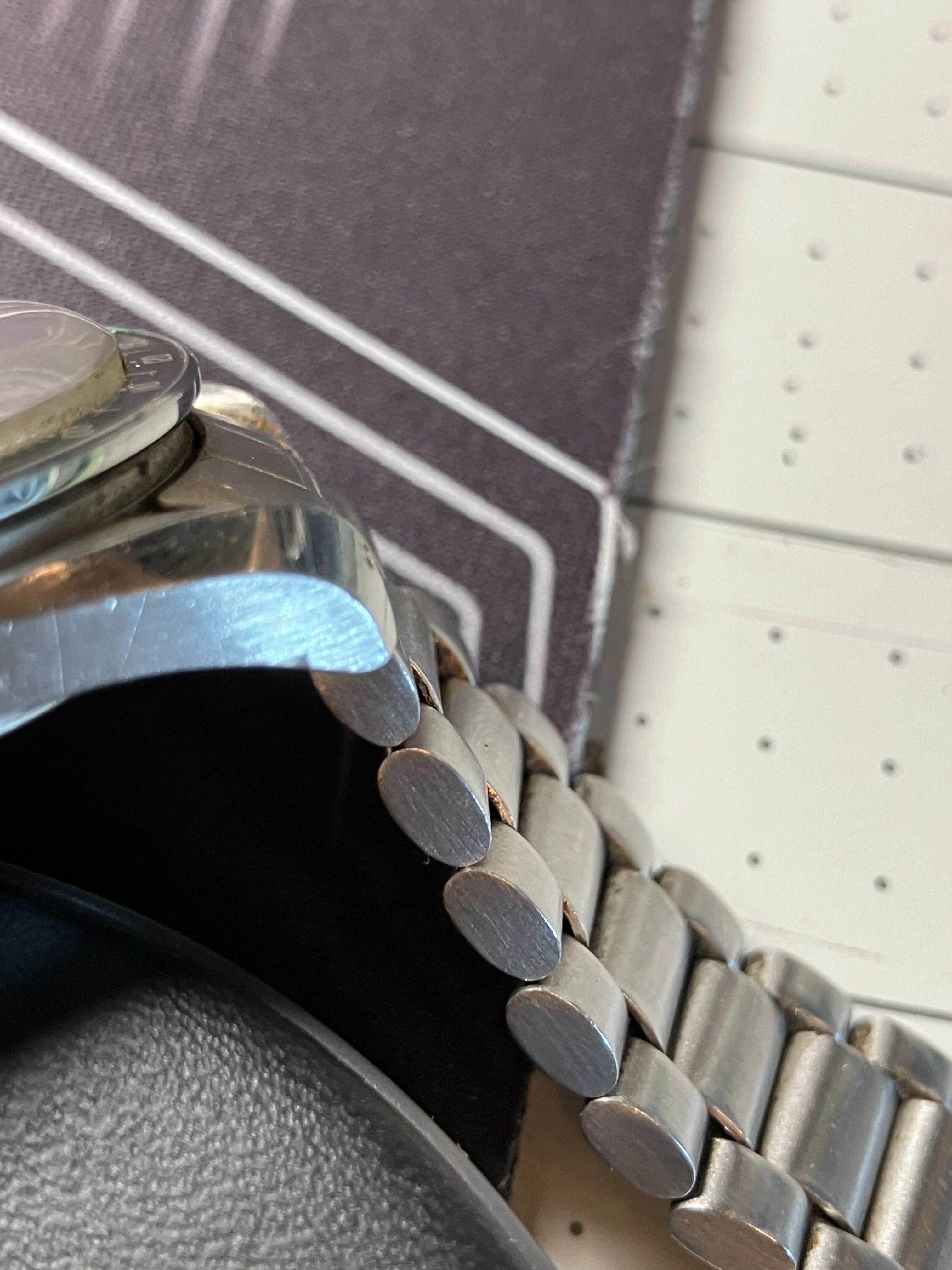

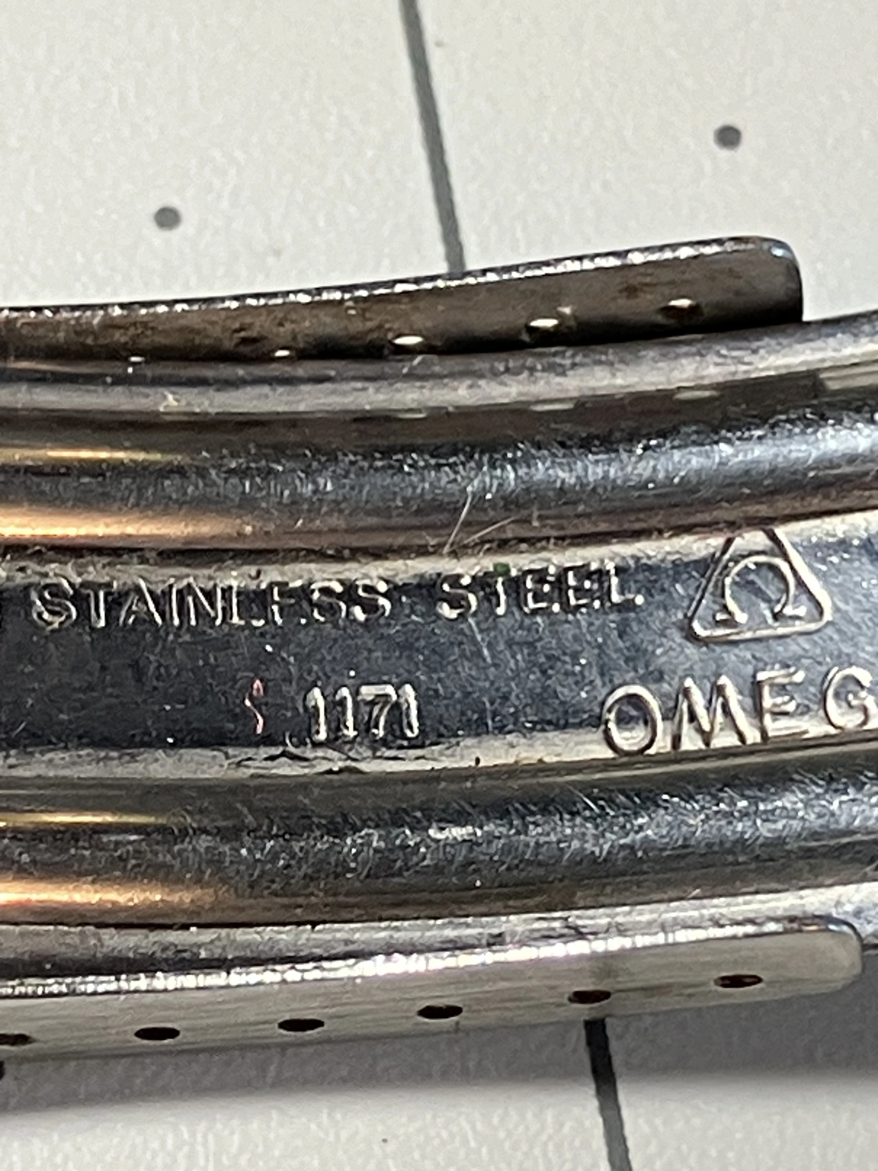

Need help on a 145.022. Any red flags on this Speedy?
213
670
Even comes with a few dead fire ants under the end links
213
670
It was an honest mistake about what exactly was the step and I payed him $2000 for the less desirable year because I think it will cleanup nicely after I got my hands on it today.

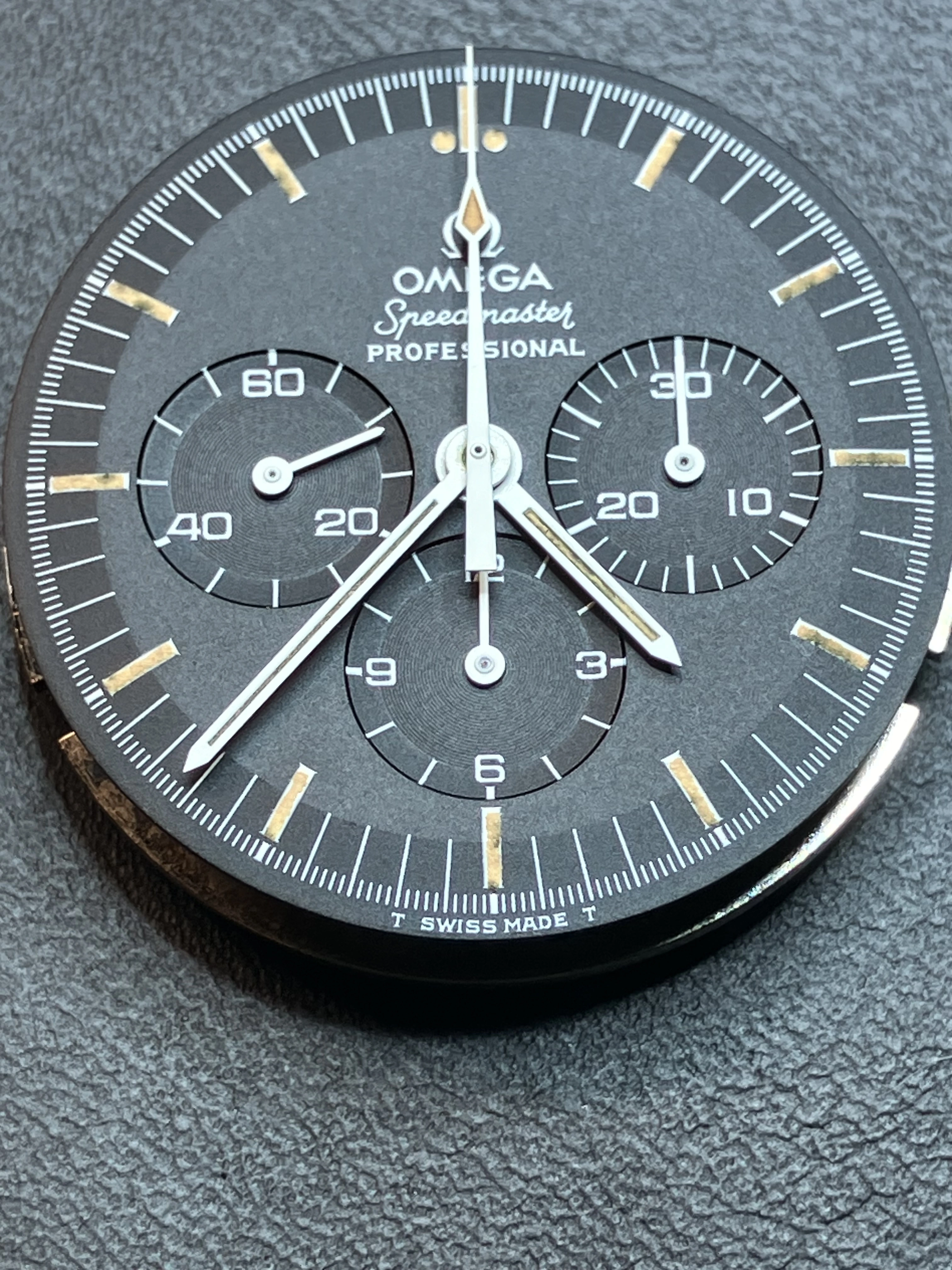

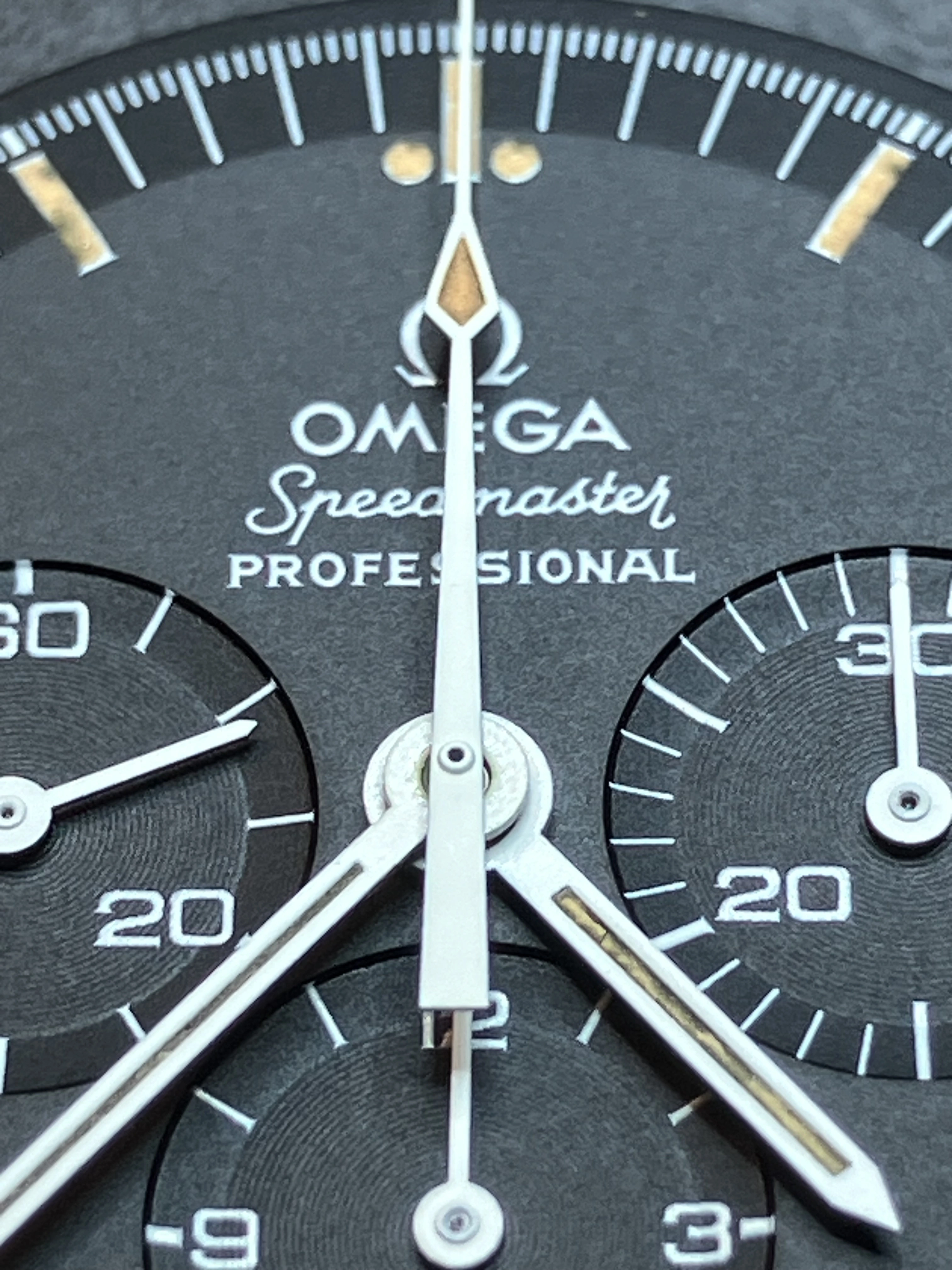

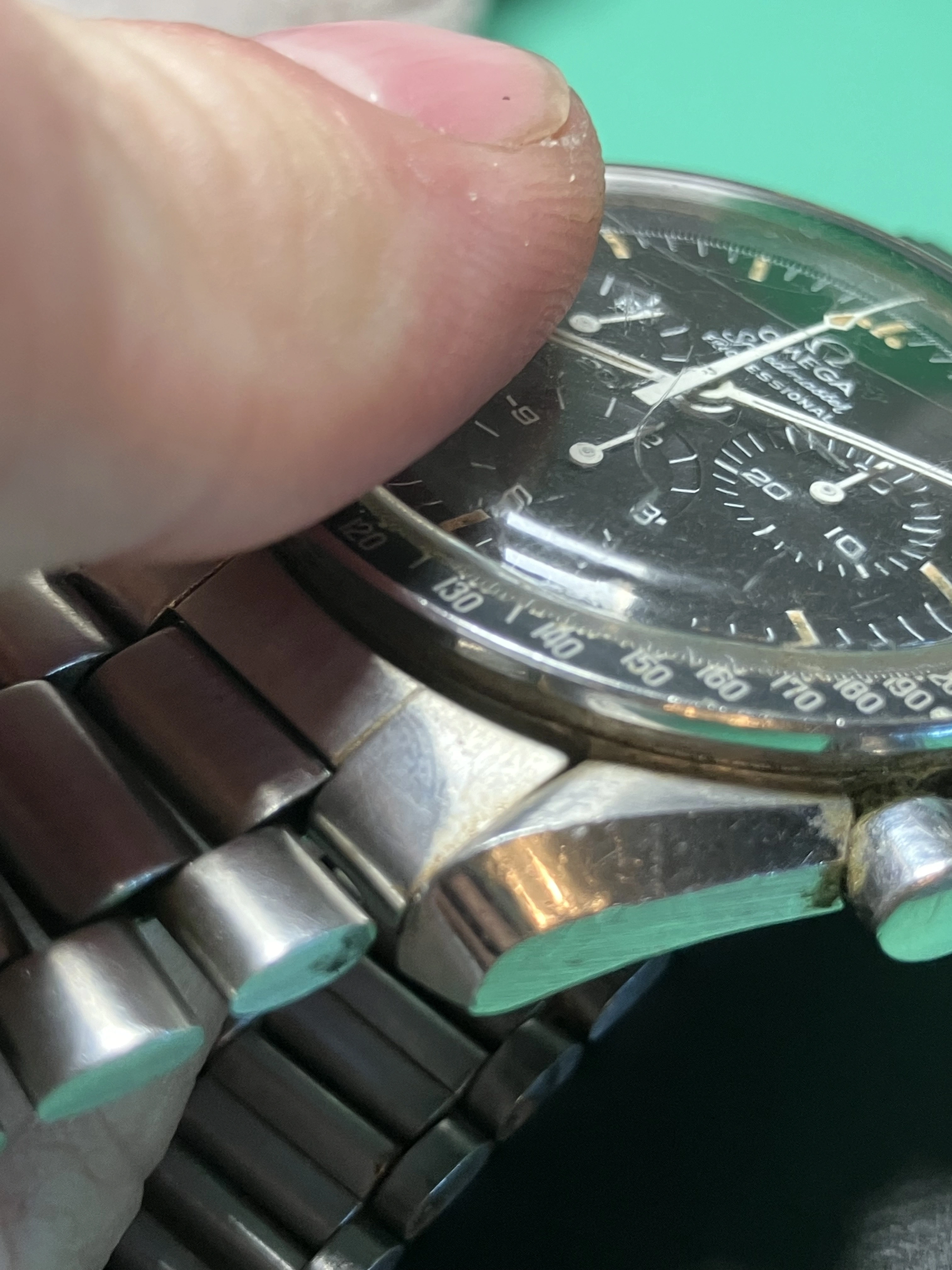

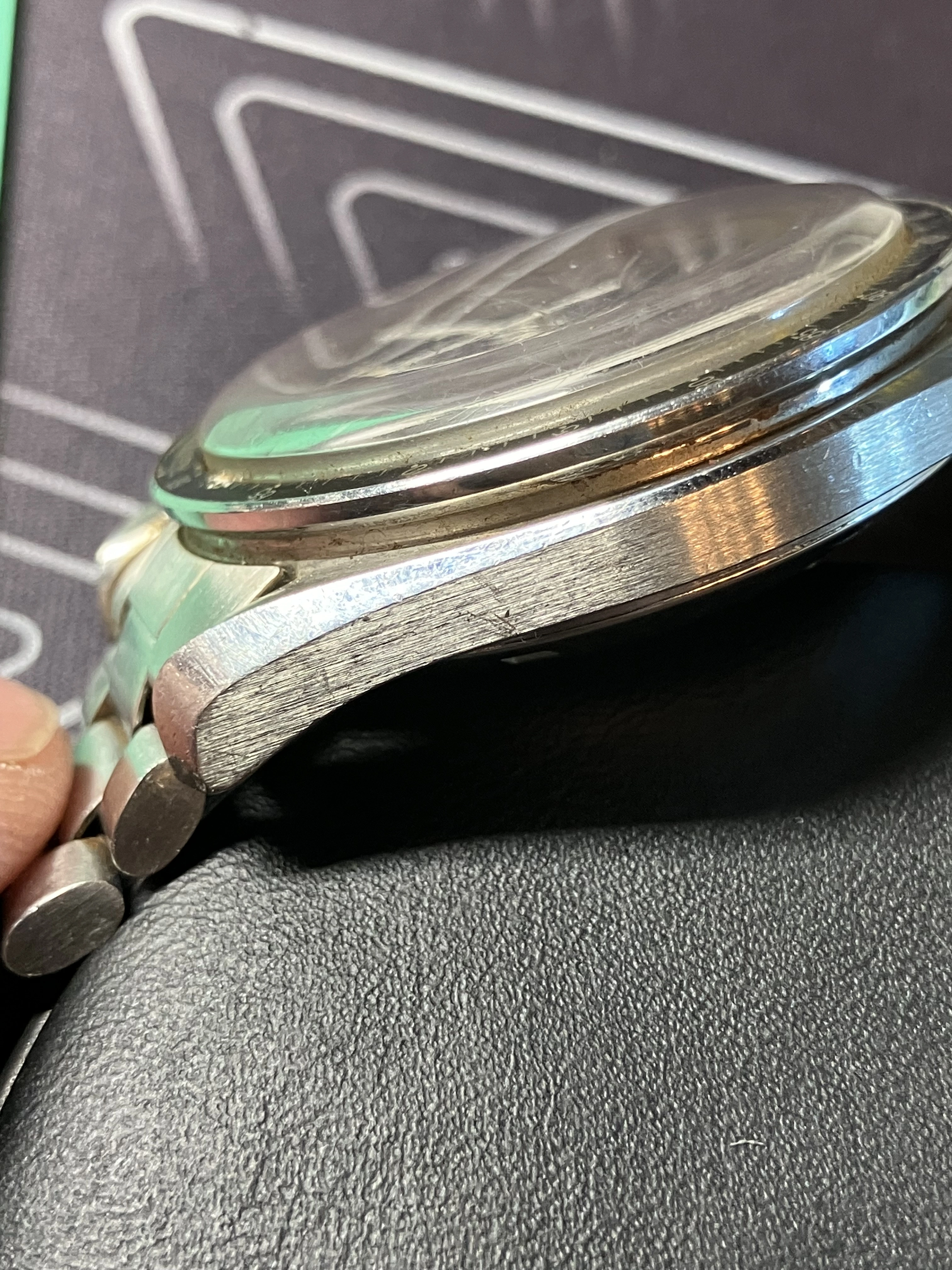

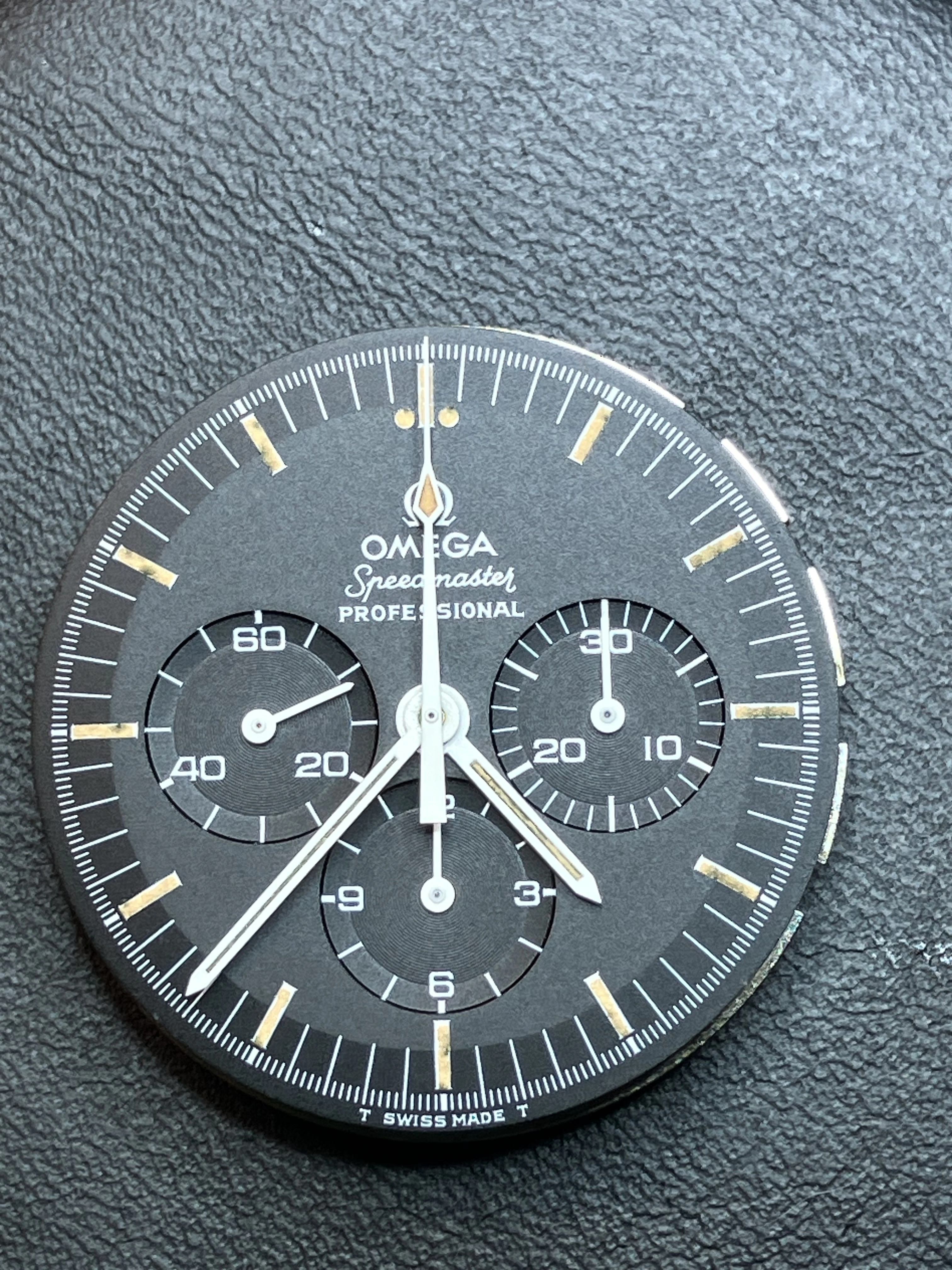

$2,000 seems like a really good price. The movement looks clean, the case looks unpolished, and the watch looks honest. Do you have more pictures of the dial? The lume color/consistency is the one thing not totally clear (it didn't look great from the original photos).
You will need a full service/cleaning asap... as I'm sure you know, do not have the case polished under any circumstances and leave all original exterior parts - I suspect it will clean up very nicely.

No he was a guy who comes across all sorts of things that shine. He honestly didn’t know what it was and did the internet search thing. I brought my case tools and gave it a once over and explained that it wasn’t a step dial and showed him pictures of the difference. He was great when I explained the differences in value and took my offer with a hand shake.

Scrub bracelet in the sink = good
Scrub watch head in the sink before new seals and pressure test =bad

Curious to hear your impressions after seeing the watch in real life. It's definitely not a -71 with a step dial... I do like the bezel and dial font from the late 70s/early 80s though, step dial or not.
There is a similar watch for sale in the private sales section right now that you can use as a point of comparison.

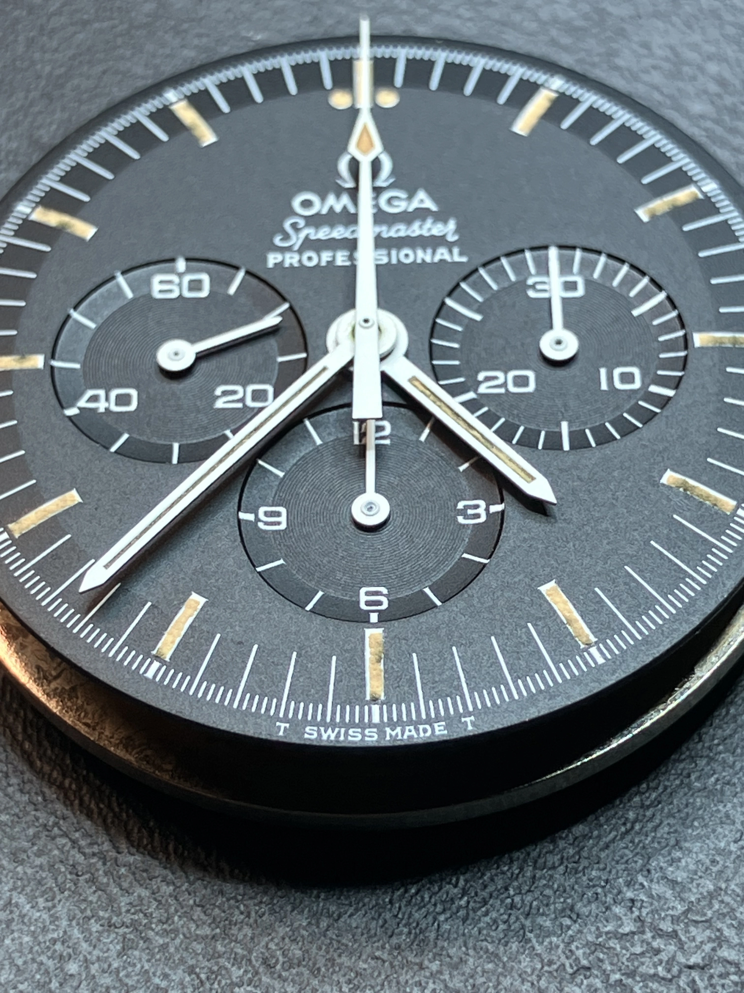

Dial is only from 1974 through Sept of 1977 on 145.022-74 and -76. That is not a late 70's dial as shown by the "Short S" where the "S" in Speedmaster does not drop down to the bottom of the "p." Late 70's through the 80's had the "Tall S" where the S dropped down to the bottom of the p.
213
670
So is this dial correct then?

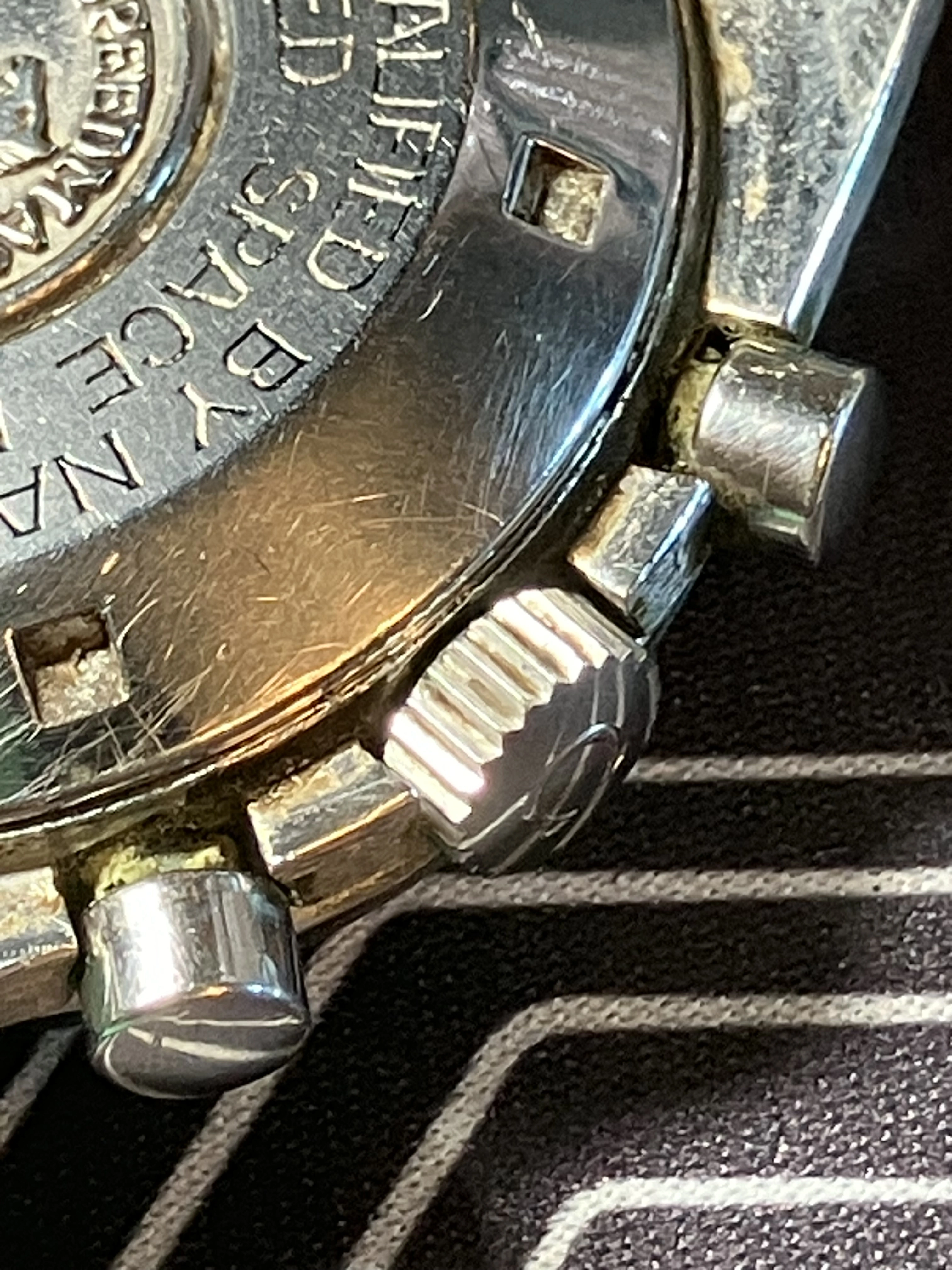

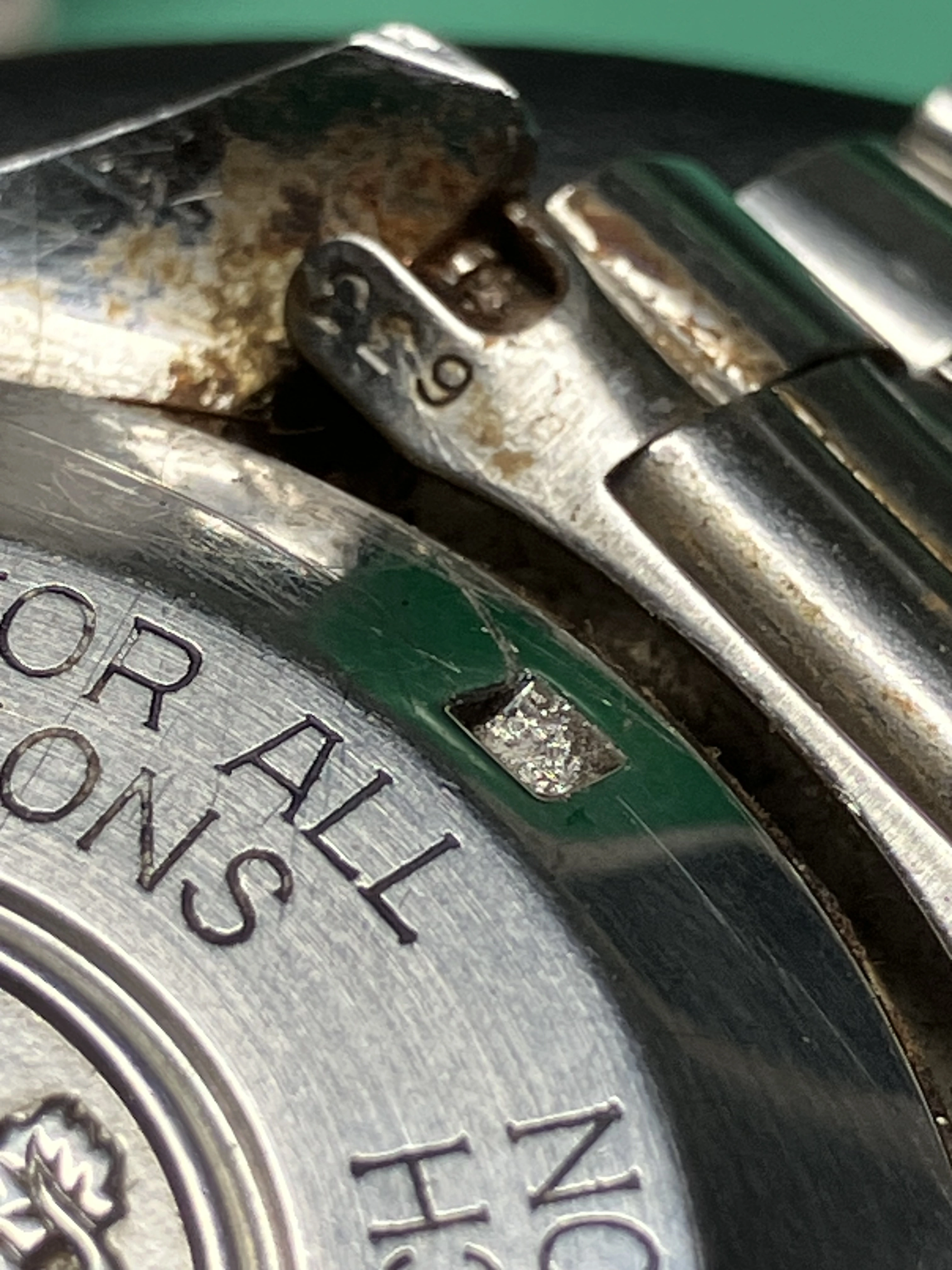

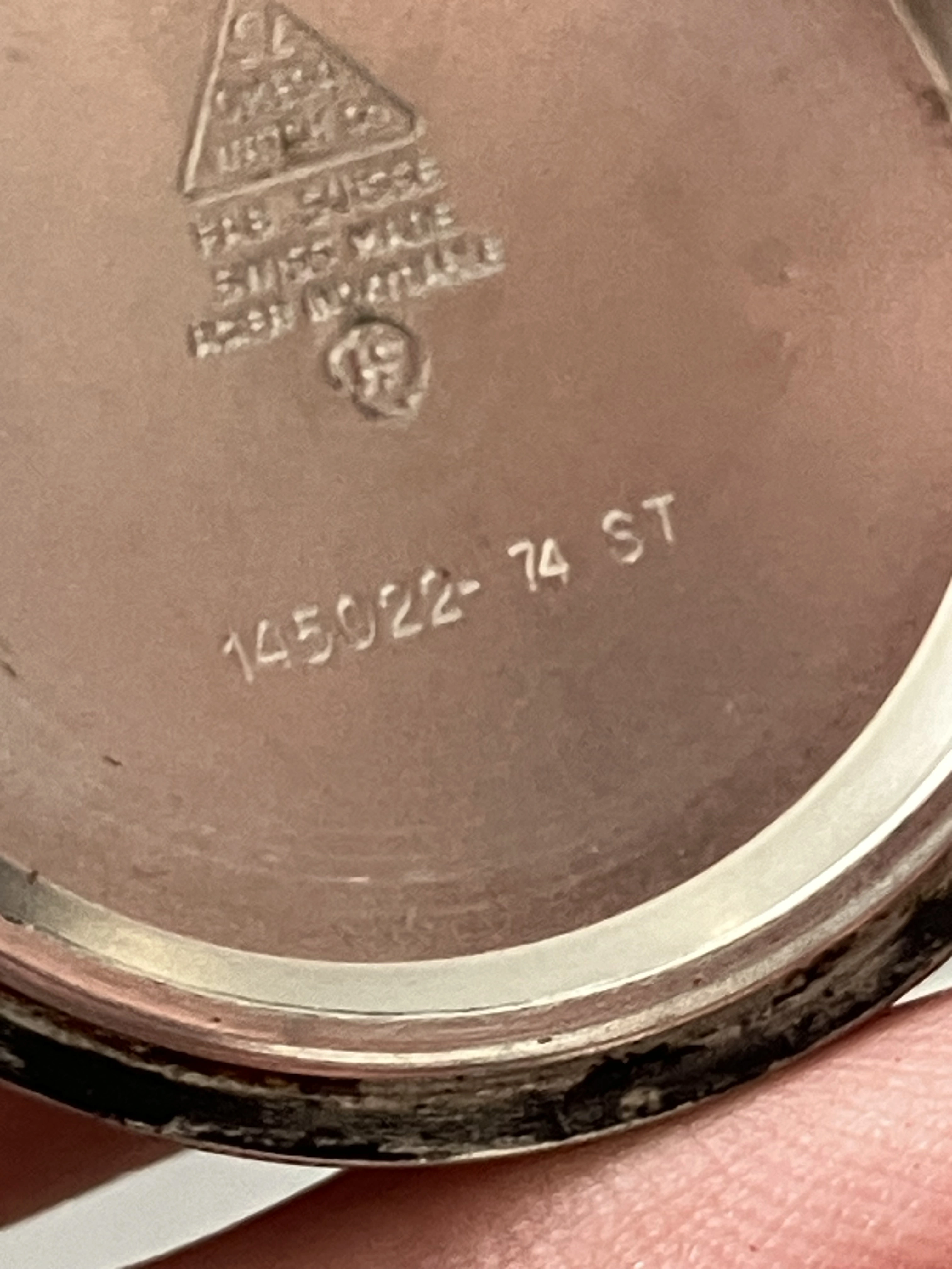

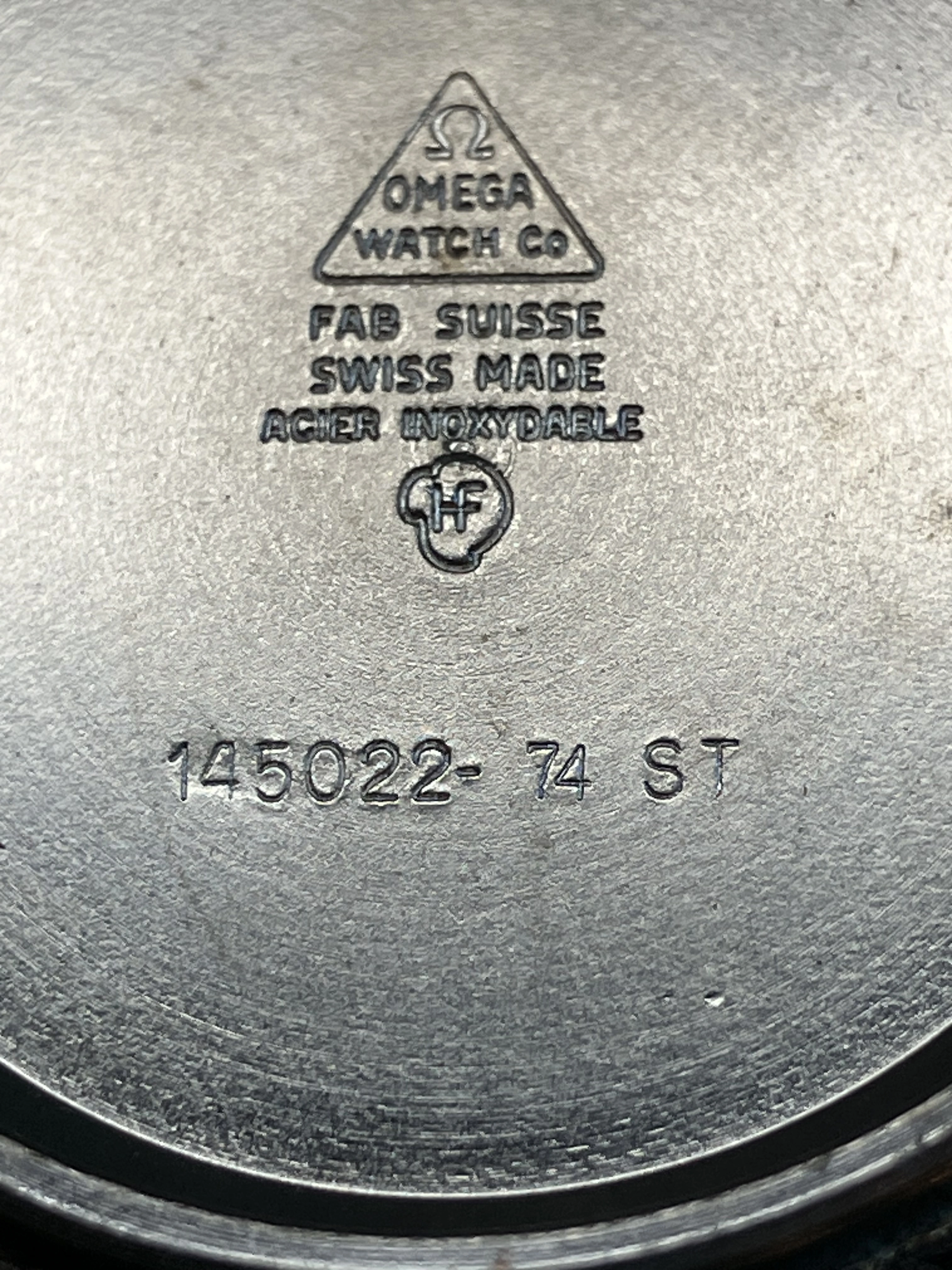

Also note this is appears to be one of the 74's with a 71 serial number and a metal brake... Hmm makes me wonder what the extract states.
There is a chance this left the factory as a -69 or -71 and sat unsold until 74 due to the caseback not being the certified for space caseback.
I have a theory that alot of these 71's sat unsold and then the dealers purchased replacement casebacks which would be marked -74 to help them sell. If this was -69 the hands lume would be expected to go brown, and the the later dial would be expected to go mossy or green, which might explain everything on this watch. The dial would have been losing brightness from the Tritium 1/2 life and would have been in spec for a change at 5 years.
::edit with that bezel though odds are it is a 74 and not modified in period earlier reference::
18,326
27,695
Yes for a -74. But... see what I stated above, which only an extract can determine.

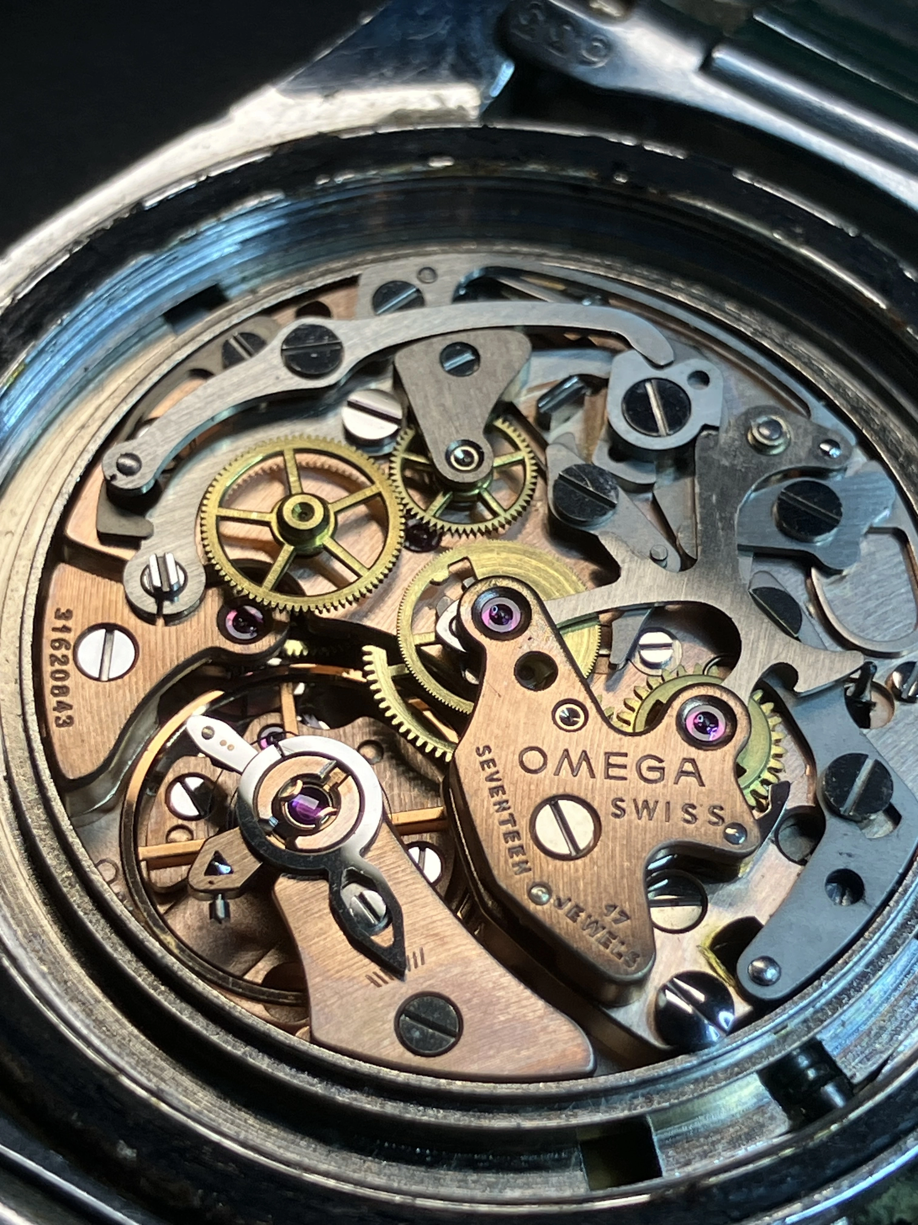

Good work. The movement serial number and all other aspects of the watch are correct according to MWO. Be sure to have it serviced with pressure test if youre wearing it daily, esp around water
Enjoy it and send some photos after the service!

The spring bars were rusted in. Took me forever to free the bracelet. How does the dial look?
