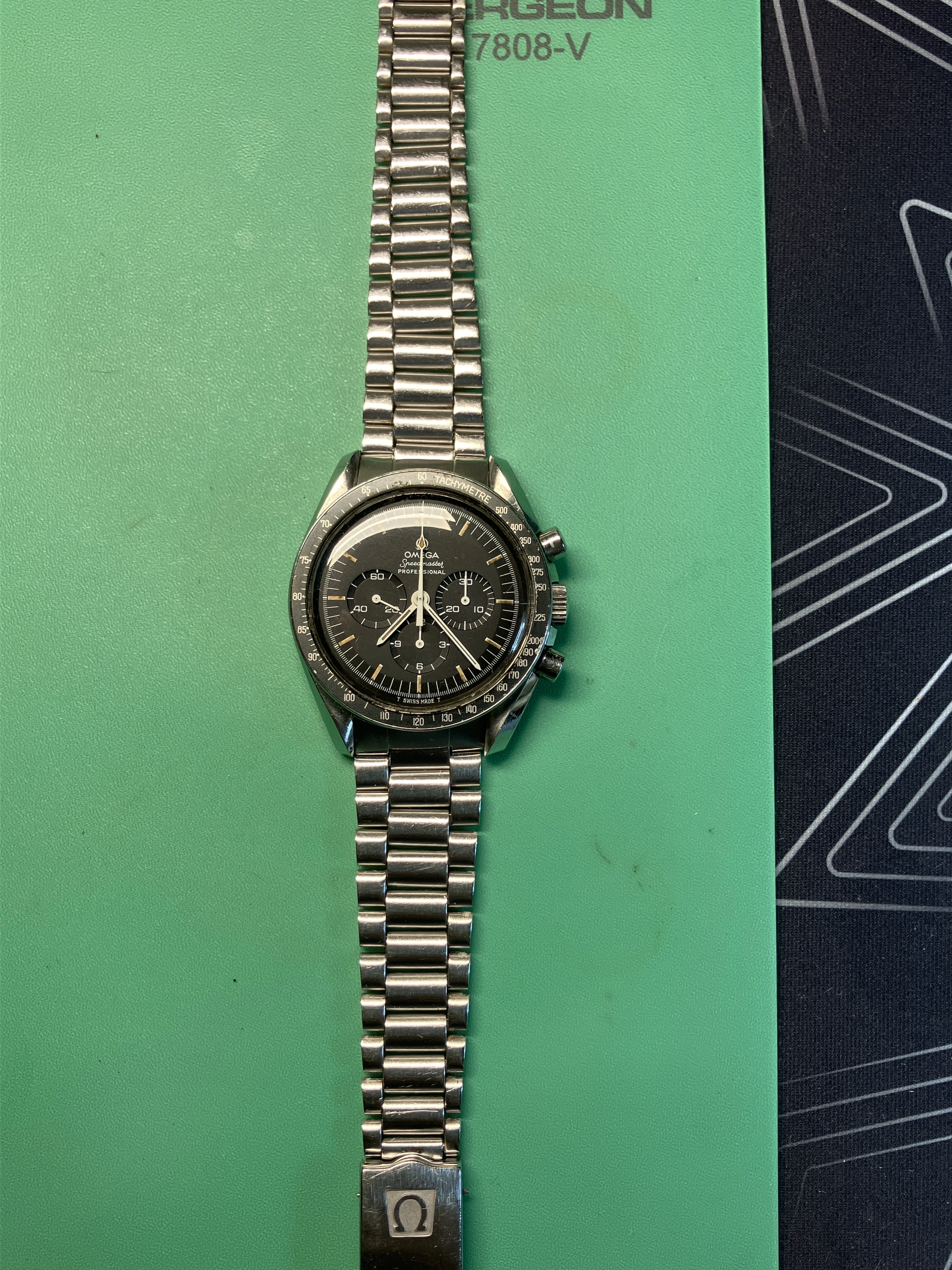

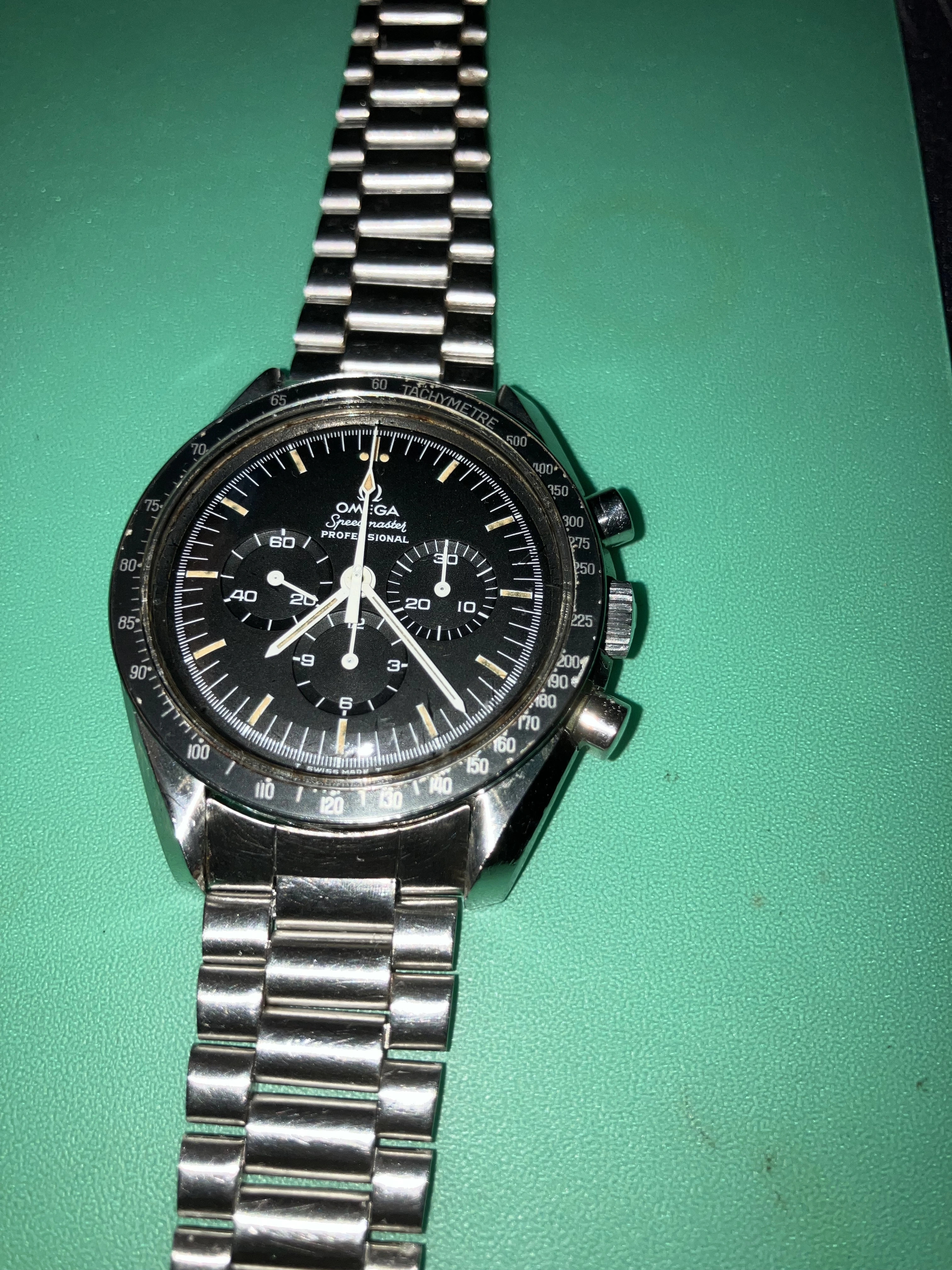

Need help on a 145.022. Any red flags on this Speedy?
24,833
55,246

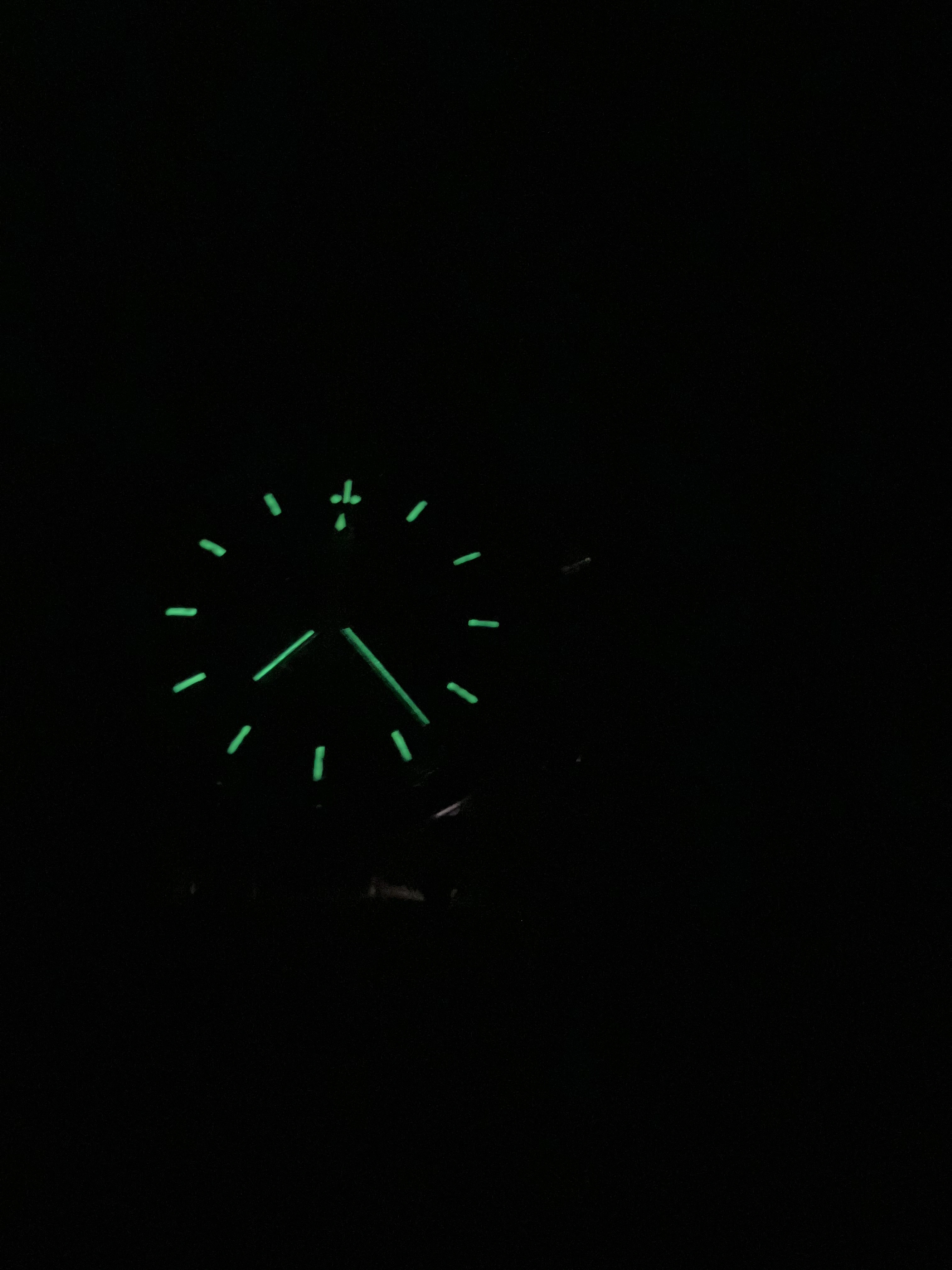

The dial surface looks quite good, the lume on dial and in the hands is a bit moldy obviously. It may continue to darken.
760
907
While the lume is not perfect, seems like an honest correct Speedmaster at an amazing price. Congrats again.

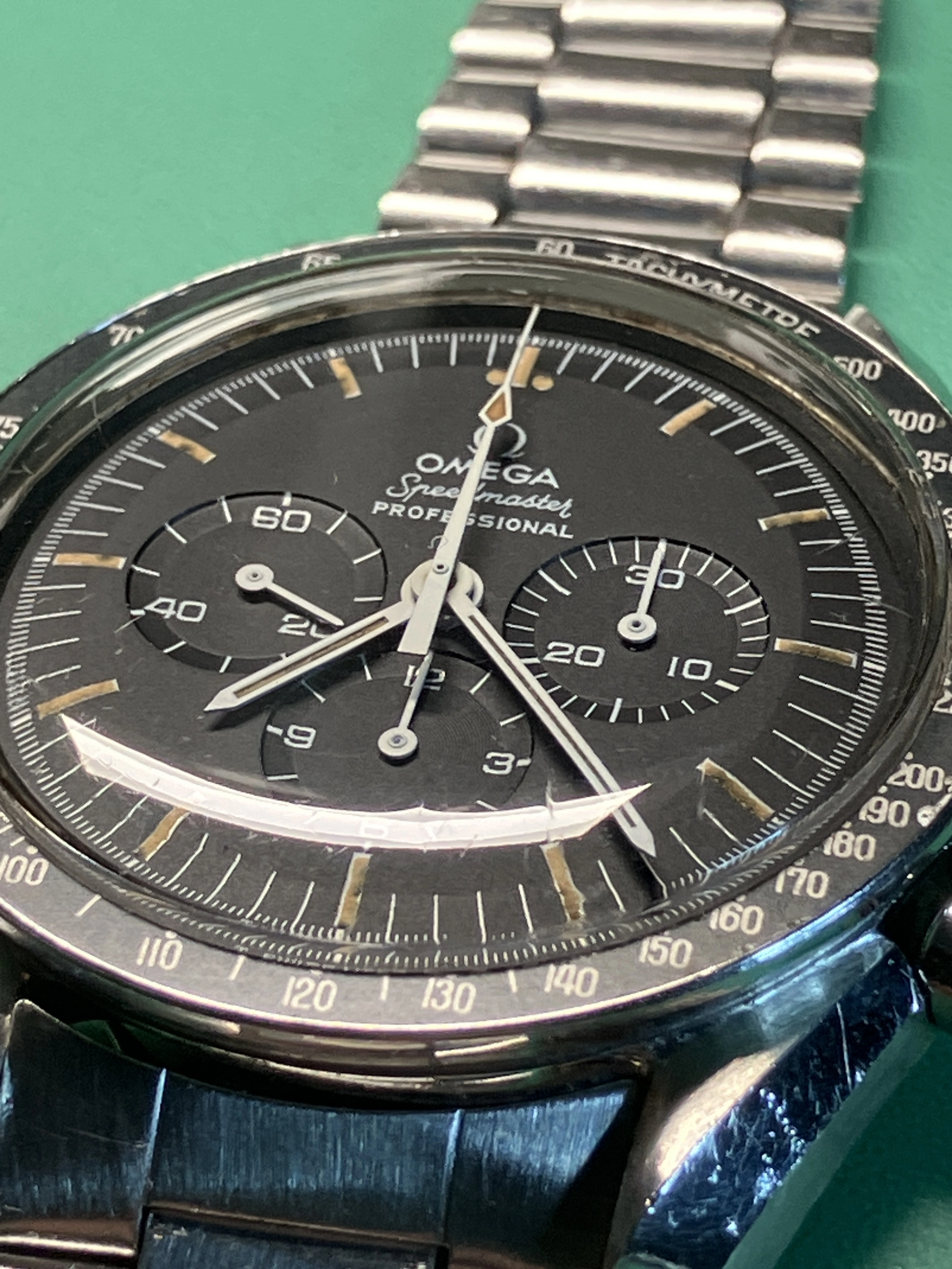

Took it all apart for a bath and a minor crystal cleaning. First round turned out to be productive
213
670
Unfortunately I need to be patient and wait for the 3 rusted spring bar ends to let go or drill them out later. Now for a sympathetic service.

For $2k I would have no complaints even with the moldy lume.
I actually had a Longines Weems that had a spring bar snap off just at the lug hole it was so rusted. It was literally spot welded in place with rust and funk and was flush with the surface so I didn’t have any purchase to try and get it out with a tool.
I soaked it with PB Blaster and let it sit for about an hour. Came back and with a magnifying glass and a safety pin just worked around the nub gently scraping out the grime and wiggling it around in the hole. Within a few minutes I saw it start to move and was able to get it out.
I will advise a good scrub after any PBB as it wreaks to high heaven and transfers to anything it touches, so be advised.
16,305
45,025
Oh, and fabulous job on the clean-up so far. If you haven’t tried wet- sanding the crystal to knock out the deeper scratches, it’s worth doing as long as you don’t get it hill-and-dale and it doesn’t get too thin. New crystals aren’t crazy expensive and makes a world of difference.
Plus pulling the crystal is the only way you are going to get this funky shit out.
