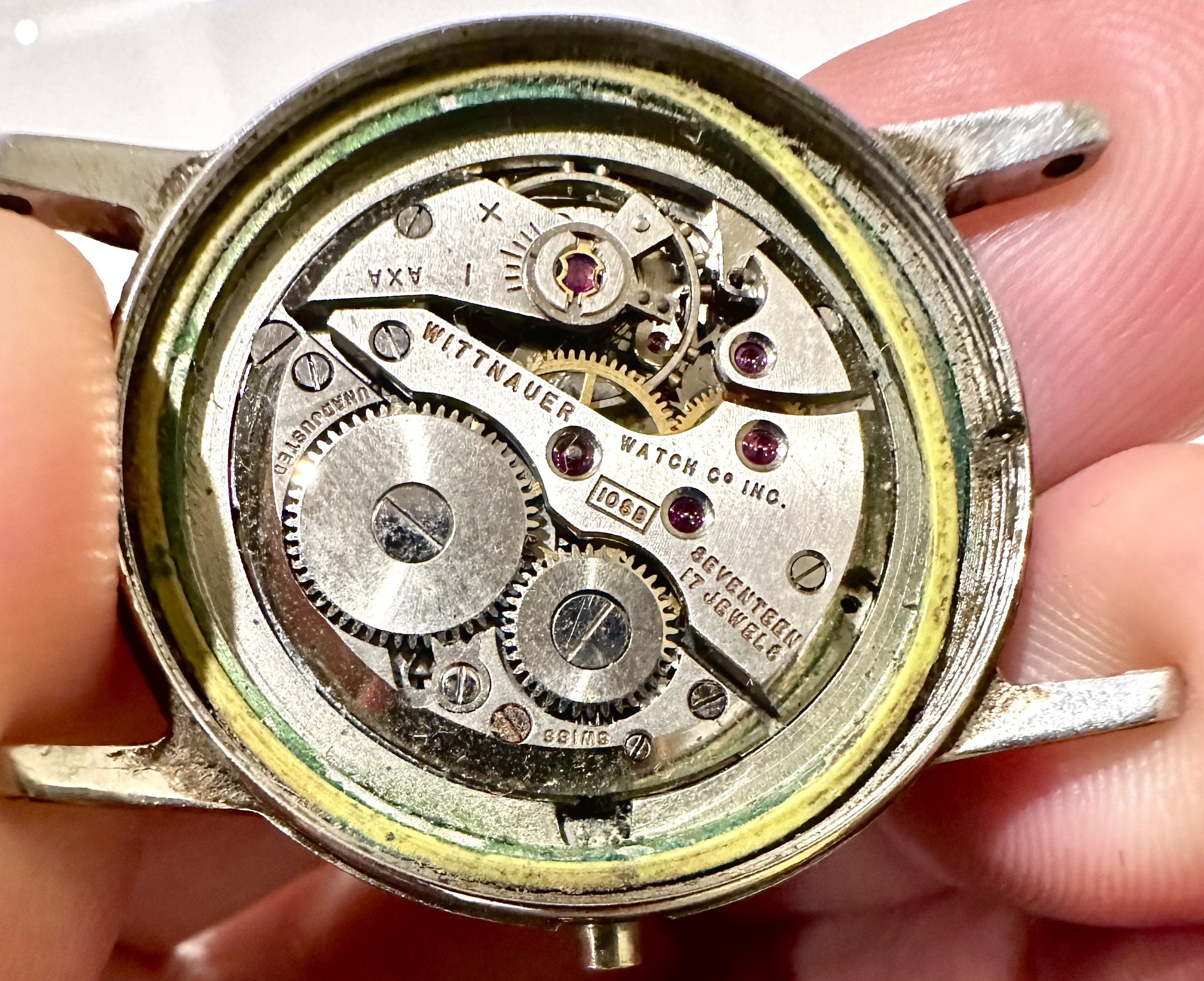

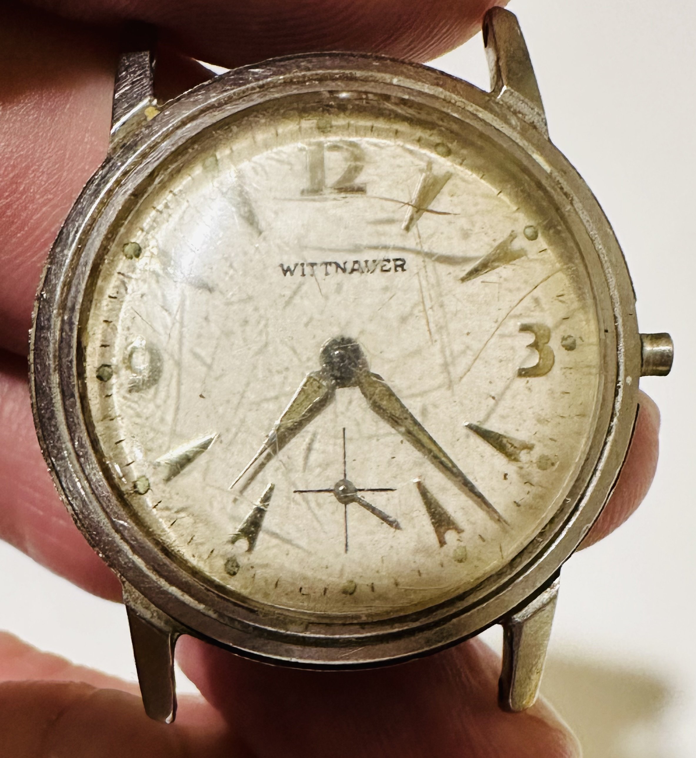

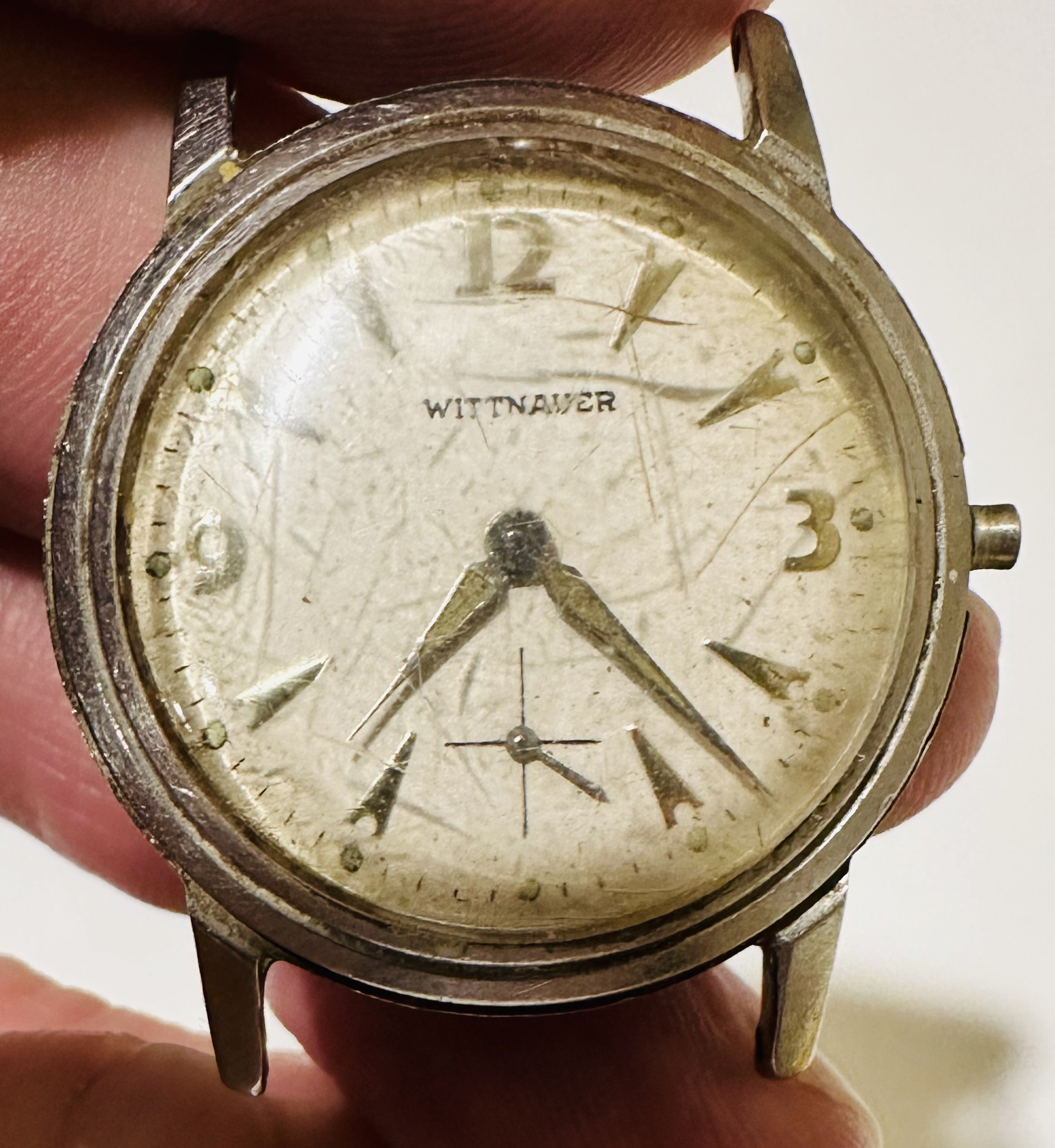

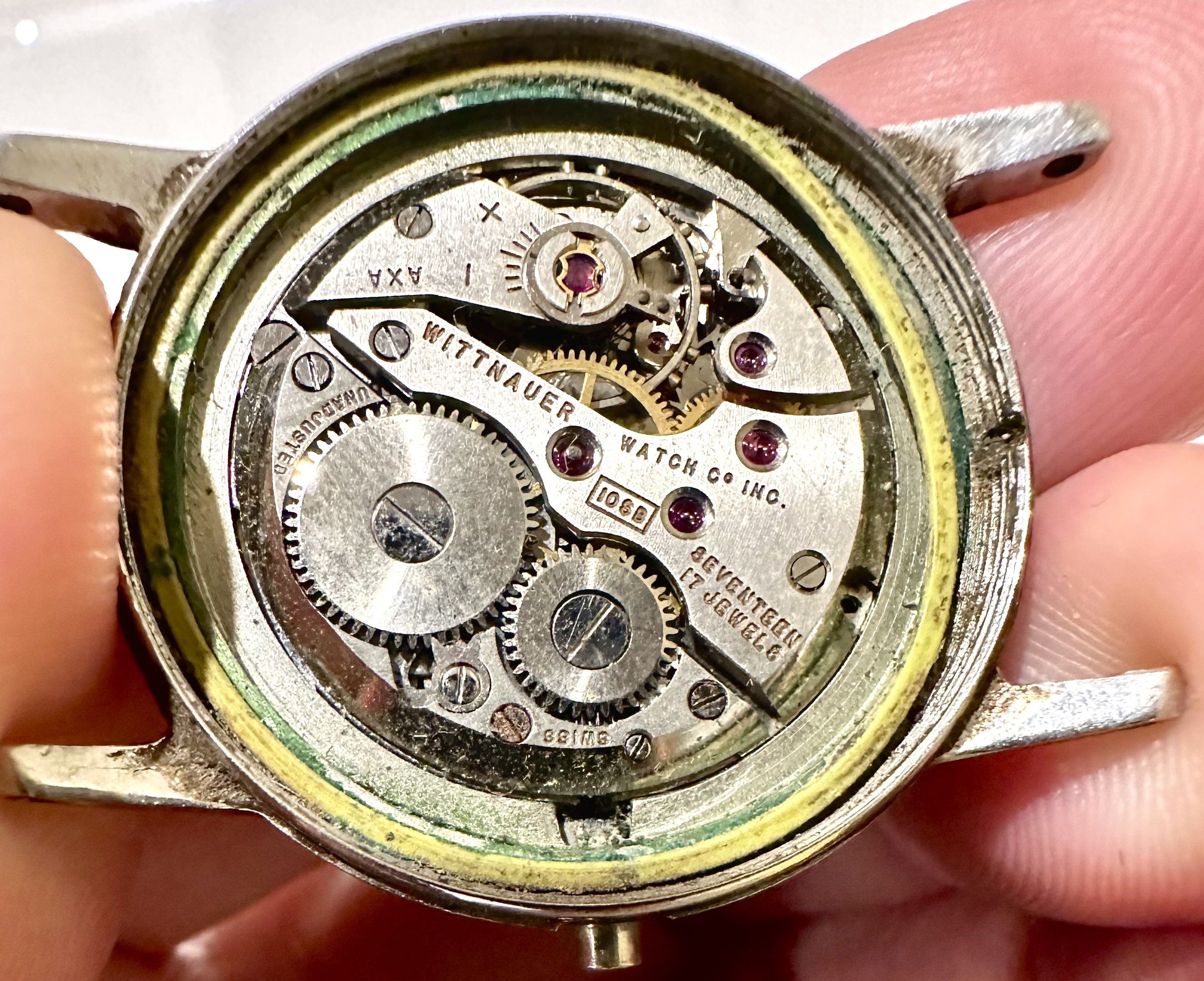

Thanks. Much appreciated. I have a family vintage Wittnauer that isn’t worth much in terms of money but valuable in terms of sentiment. It has no stem and that may just the tip of the iceberg…but I’d like it to be my first watch attempt.
One thing that almost everyone who has gone your intended route to watch repair, and was at the same stage you are at now , will tell you to NOT START on a sentimental piece for which you have hopes! Don’t give up on your wishes to learn about the repair of watches. But trust your Wittnauer to a recommended professional. No book on watchmaking, or course you might take on the subject is a step 1-do this, step 2-do that primer on repairing your Wittnauer. It will likely take a year or more of investing in tools and learning techniques, and acquiring the manual dexterity you will need, before you tackle a watch that really matters. Maybe you are not looking any further ahead than fixing the Wittnauer. If you’re not, don’t waste your time and money in a one shot stab at watch repair. It takes too long, and costs too much money to seriously get into the skill.
