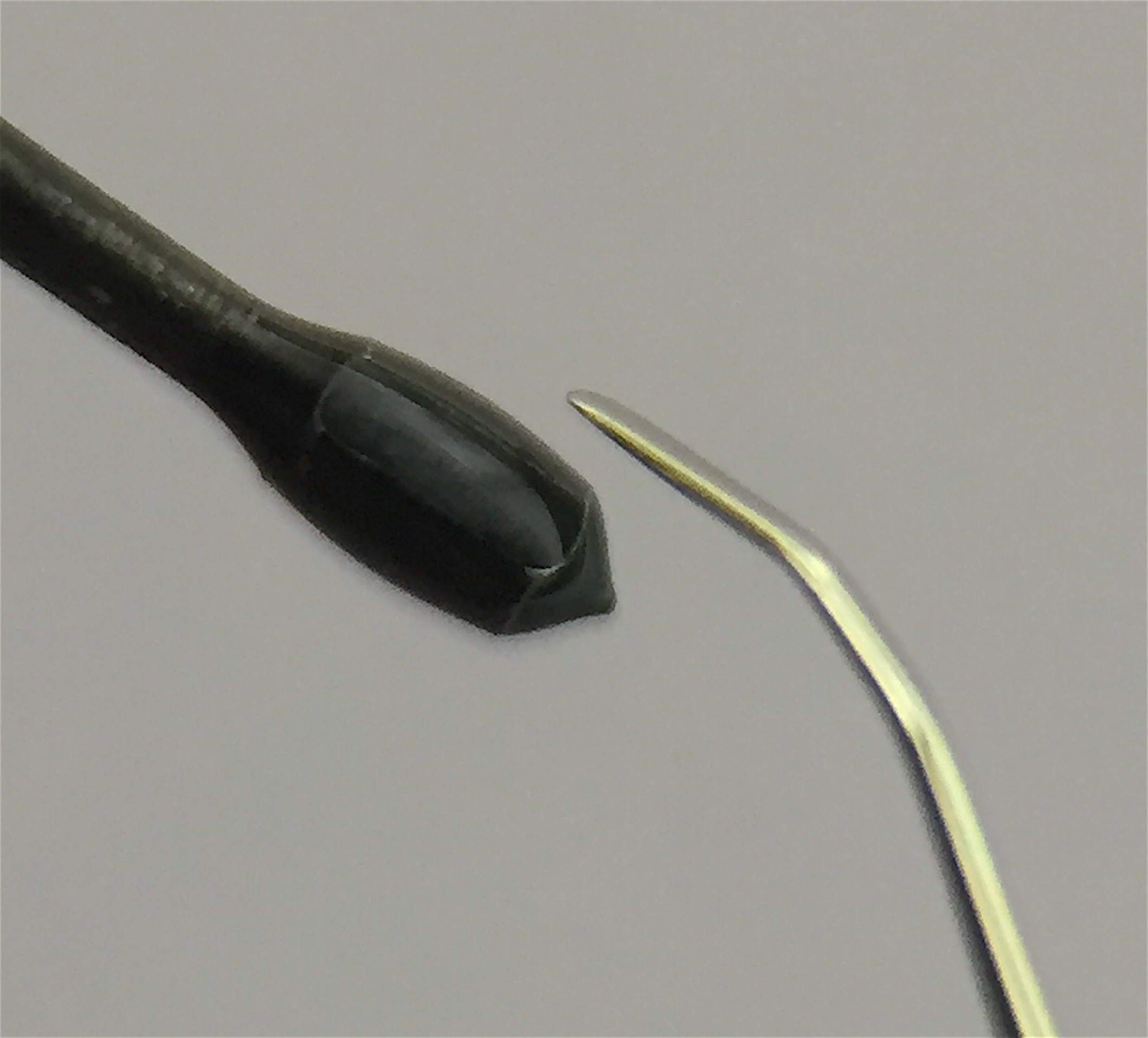

    So I don’t use either of these regularly, and haven’t for a number of years now. I currently use the Bergeon “ergonomic” oiler:
    [​IMG]
    As you can see, the shape of the tip is very different. First it is far more refined than the other two by a long shot – everything is finely machined where the others look like they were made using a forge and anvil. Second, the shape is much more conducive to controlling the amount of oil picked up. I have picked up some oil to show that the flat portion of the tip can pick-up a rather small amount of oil – this is the smallest of the oilers that they offer. Now these are much more expensive than the others – those a few dollars each and these are $35 or so the last time I remember buying one. They are also somewhat fragile, so over time you will bend and eventually break the tip – I just broke one I had been using for over a year this past week. But the control these provide, and the fact that when I break one I can open a new one and it will be exactly the same as the one I just used (not always the case with the others) makes these worth the money for me personally.
    Not long ago I responded to someone on another forum who said they tried these and hated them. They went on to say they could barely pick up any oil with these and the oil they did pick up didn’t seem to transfer well. After some conversation it appeared that the user wanted to be able to pick up a large (for watchmaking) drop of oil and then “wipe off the excess” on the side of their oil cup. As you can probably guess, there’s no reason to do things this way when you can pick up the correct amount of oil with these right off the bat. The problem of the oil not transferring I was able to pinpoint to the user dipping the oiler too deep in the oil. If you get oil past the flat area, and get it onto the narrow part, the oiler will tend to hold onto the oil rather than transfer it. That’s why I picked up a typical amount on the photo above to show you how they are used. Once I explained all this, the user came back eventually and said they now preferred these to the older style oilers.

    I like those ergonomic oilers as well but they are frighteningly expensive, as you say. On the other hand, they are far easier to control so good value for me as well.

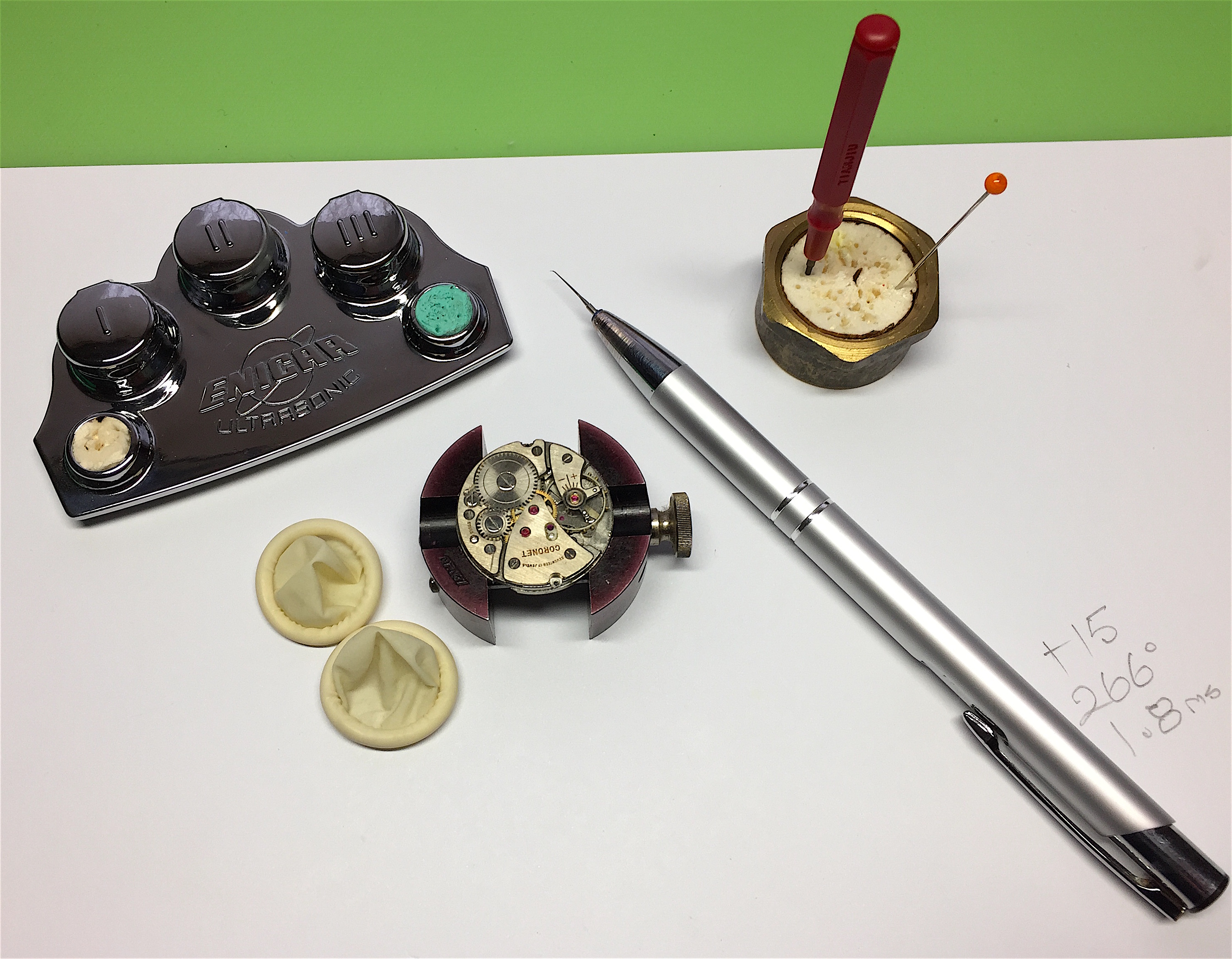

    Thanks to guidance from Al and others, my oiling technique has improved a great deal since I first used a set of el cheapo oilers. As I do oiling under a microscope, getting just the correct amount onto the tip of the oiler was difficult due to my near vision so my approach is to dip a medium oiler and take that to the work. I then use my fine oiler to take off just the right amount.
    I also found using the small handled oilers didn't give me good feel/control, so I cut down and polished a fine oiler and mounted it in a ballpoint pen barrel and I found it gives me much greater control when picking up from the donor drop and placing it correctly.
    Here's my basic oiling setup, seen here with a junker movement I run through the cleaner and use for practice.
    And here is the donor oiler and my "pen oiler" ready to pick of some oil. You can see that the amount of oil on the donor is more than enough for all of the jewels.
    DaveK, Eve, Dr_P and 10 others like this.
