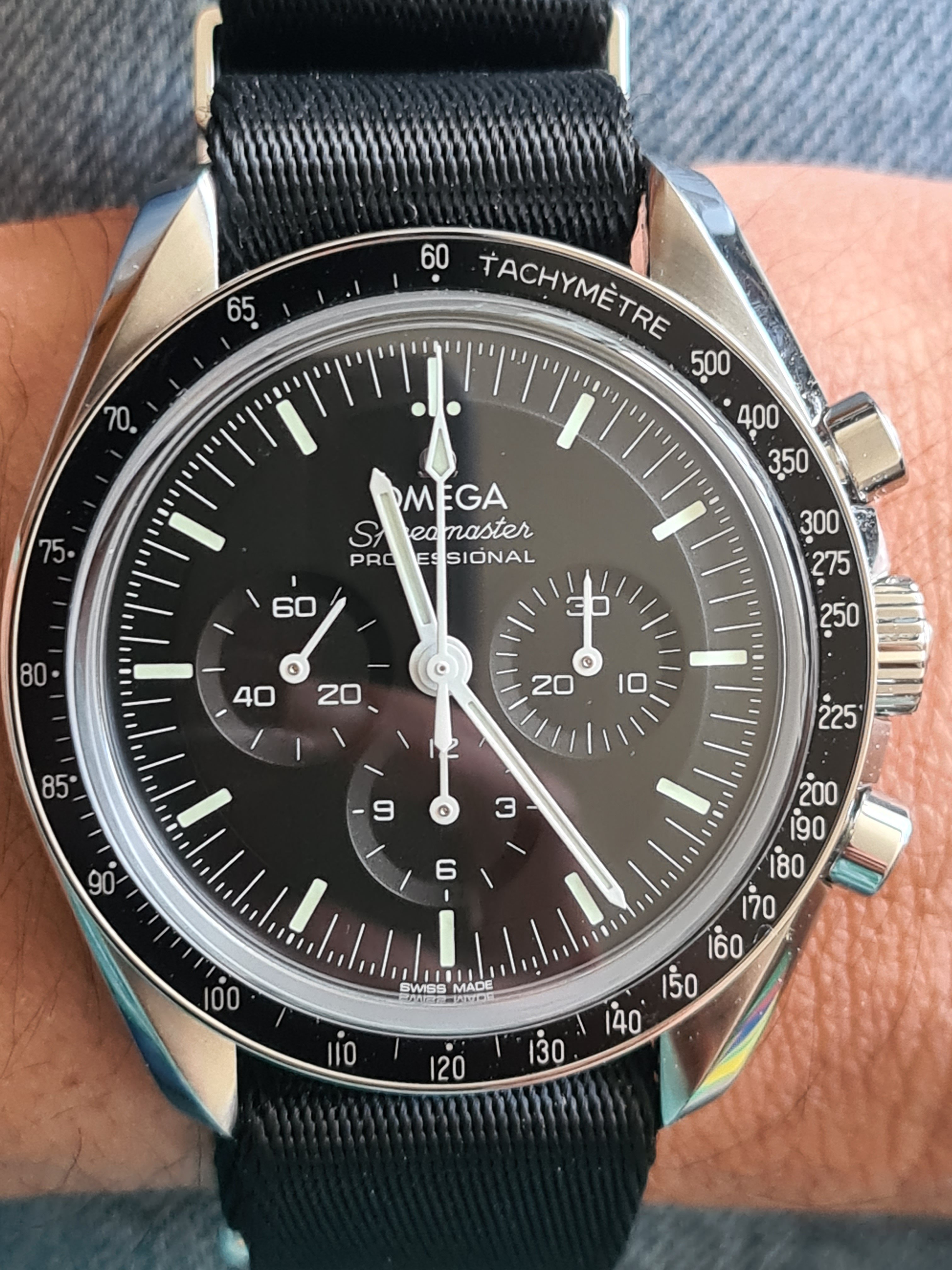

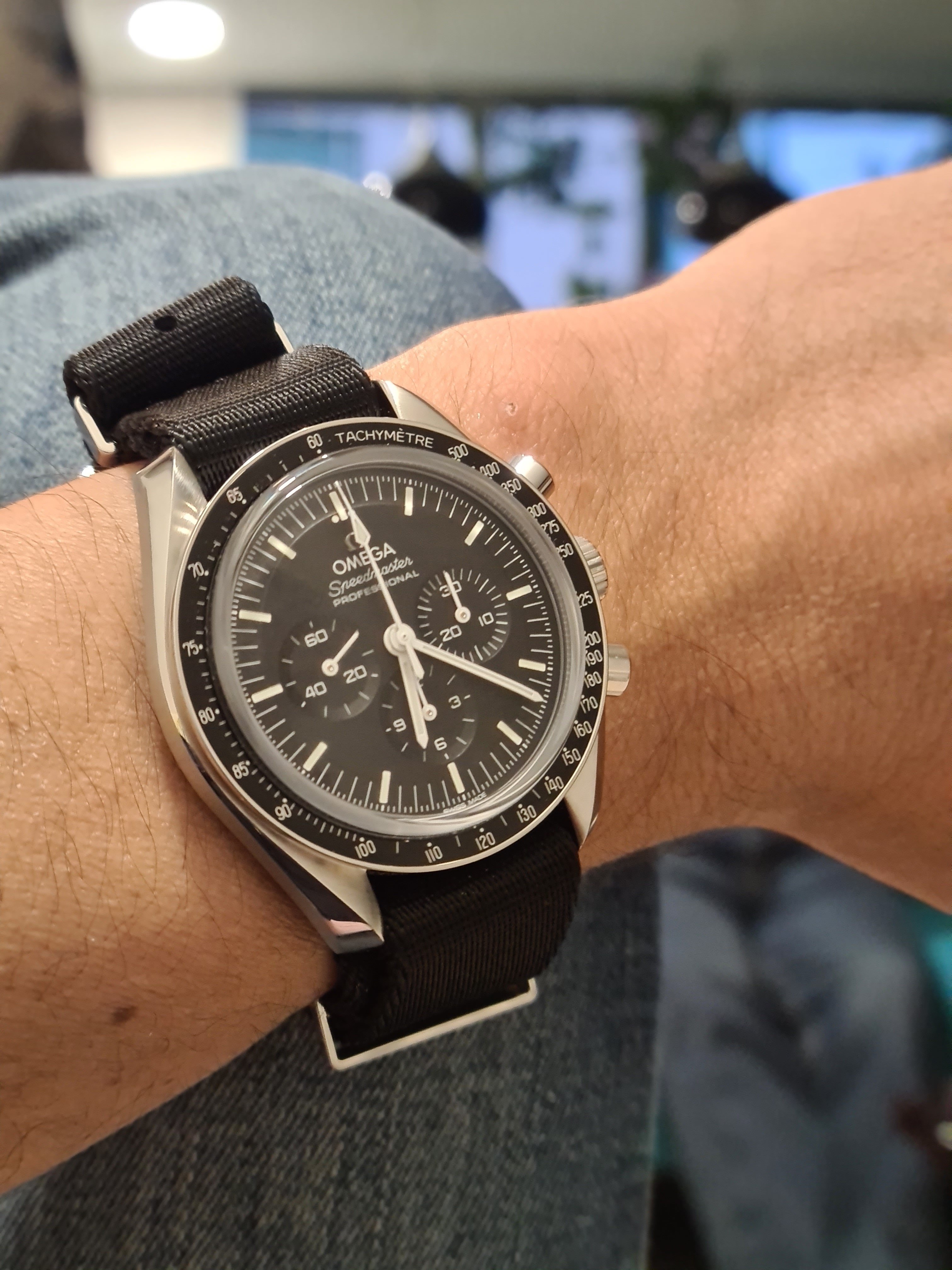

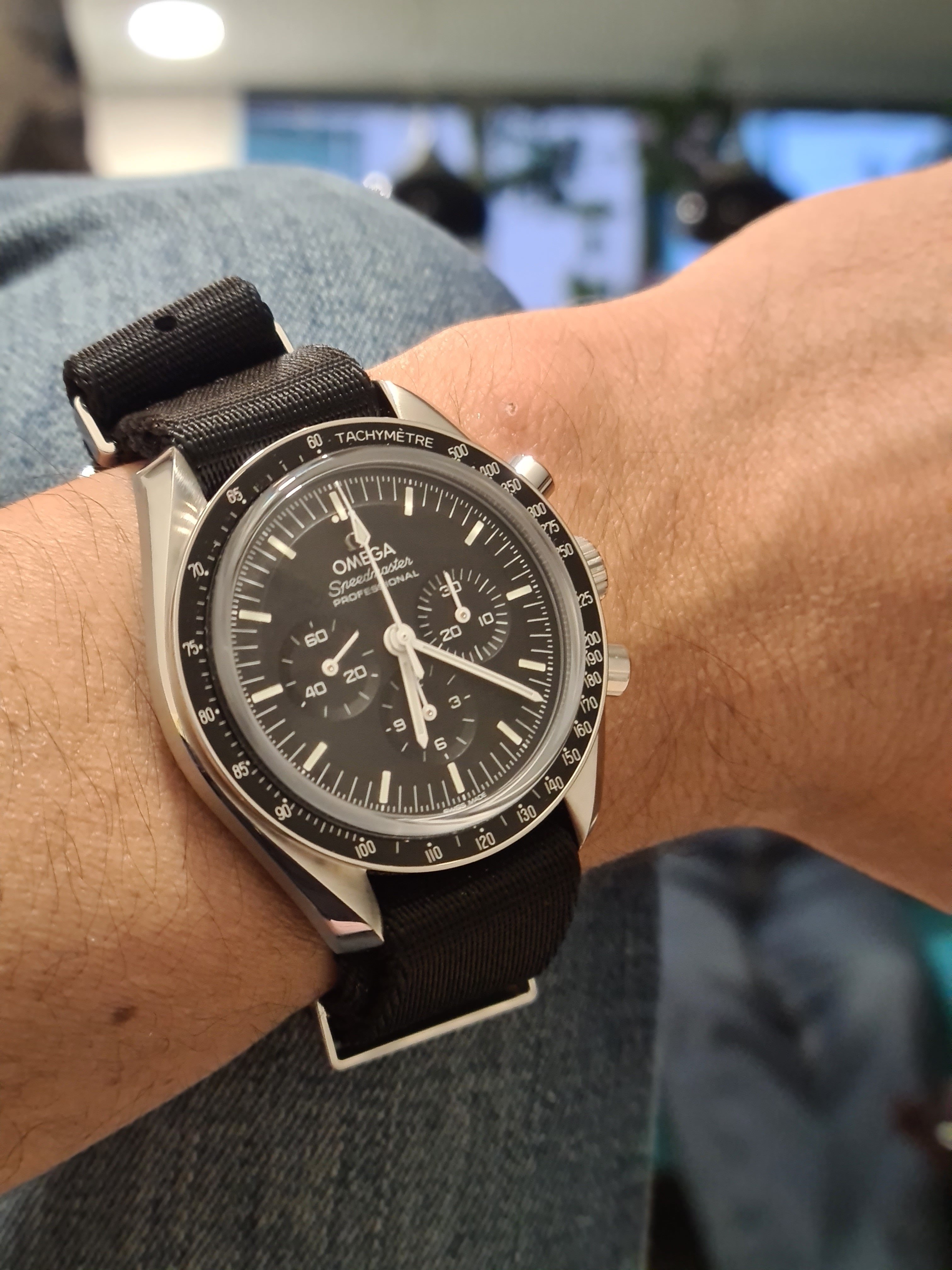

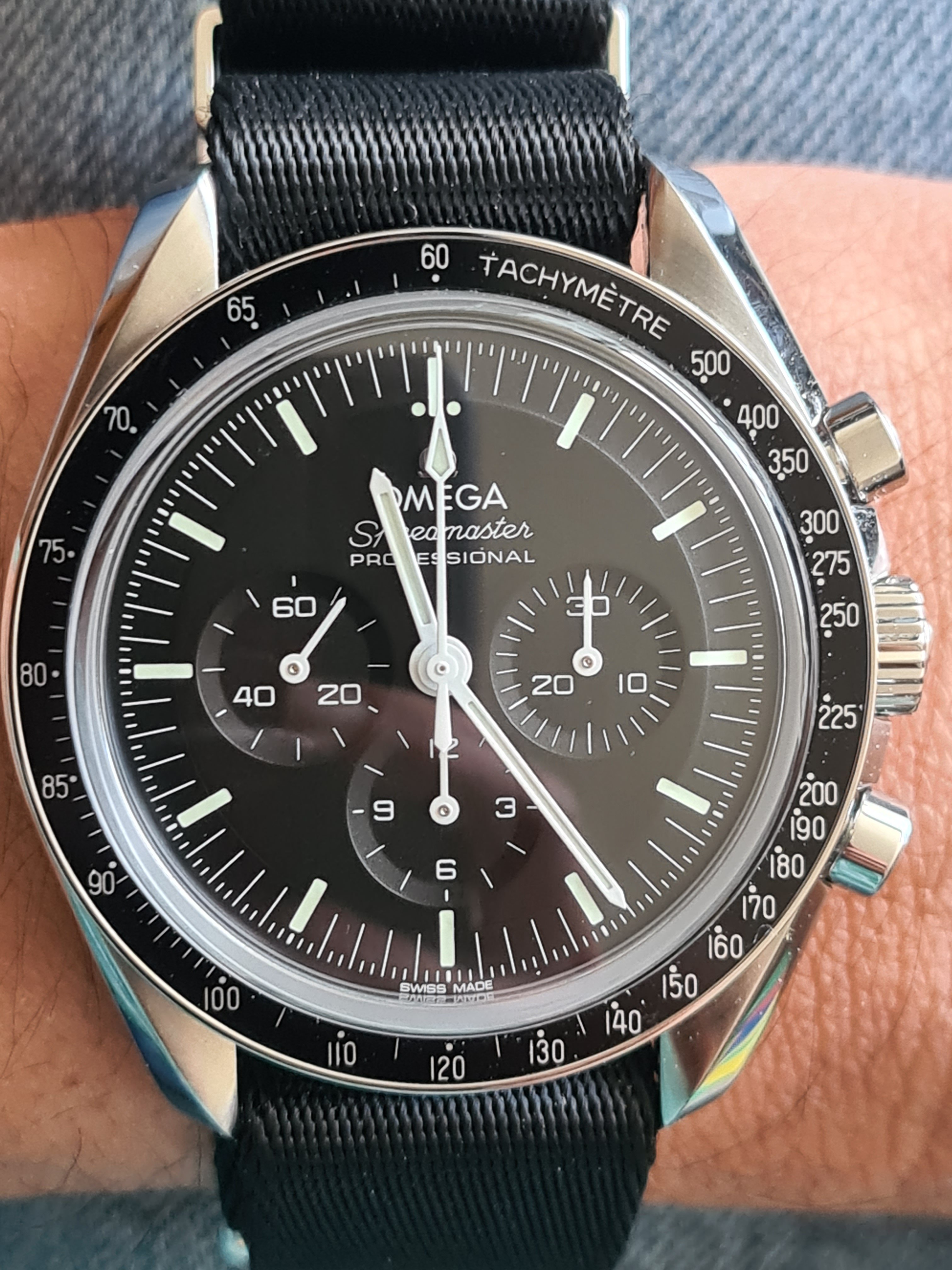

Welcome to the forum though mate and congrats on the new watch, any pics?

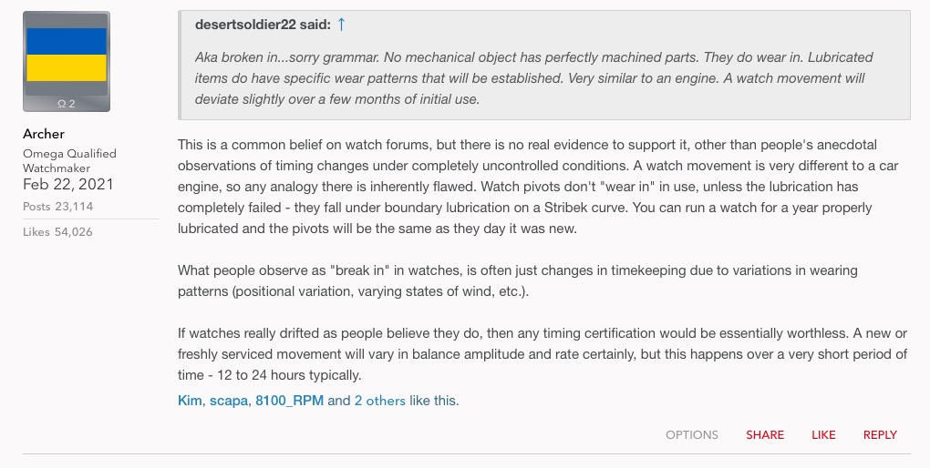

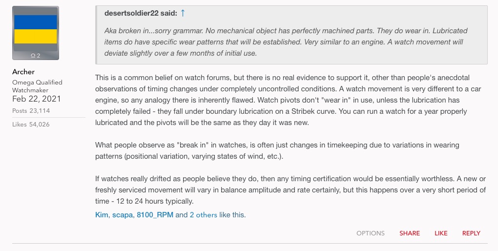

Sometimes if after a while, a movement settles in a bit. I have come to the belief that I prefer a new watch to be a little faster (+1 to +4 SPD) becuase as the movement settles in, in my experience, the movement usually slows down slightly when it breaks in a bit.
7
9
