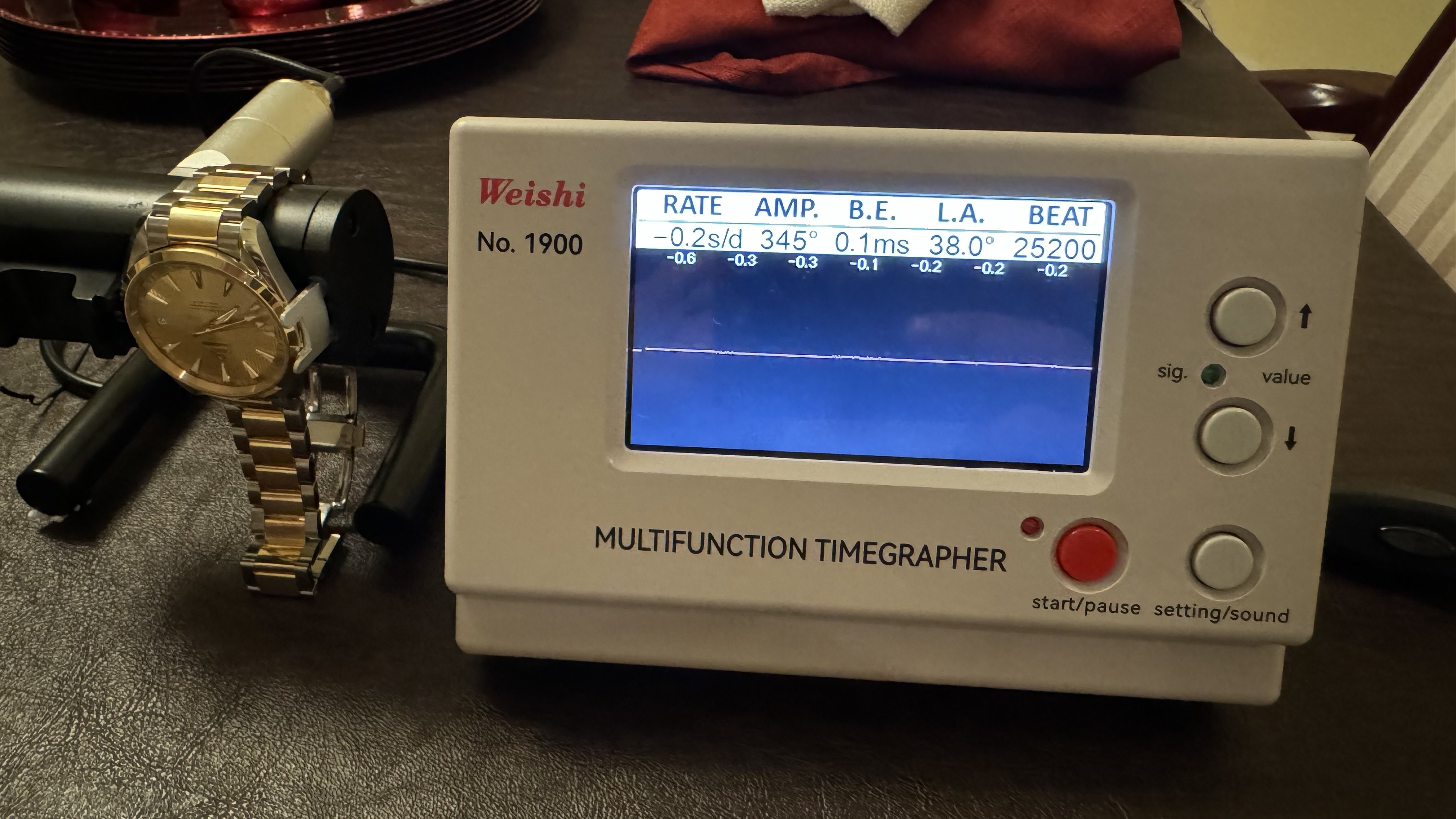

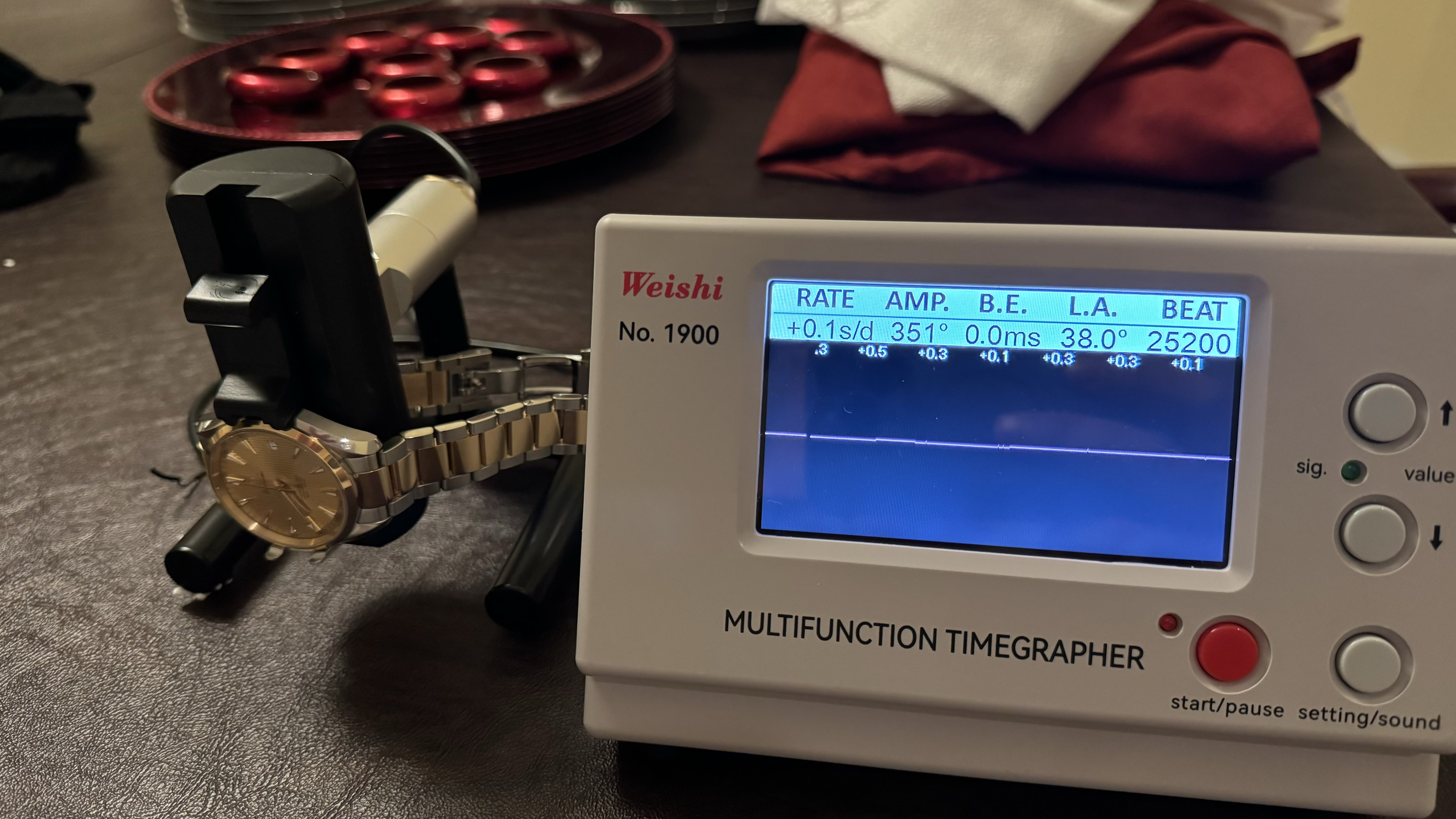

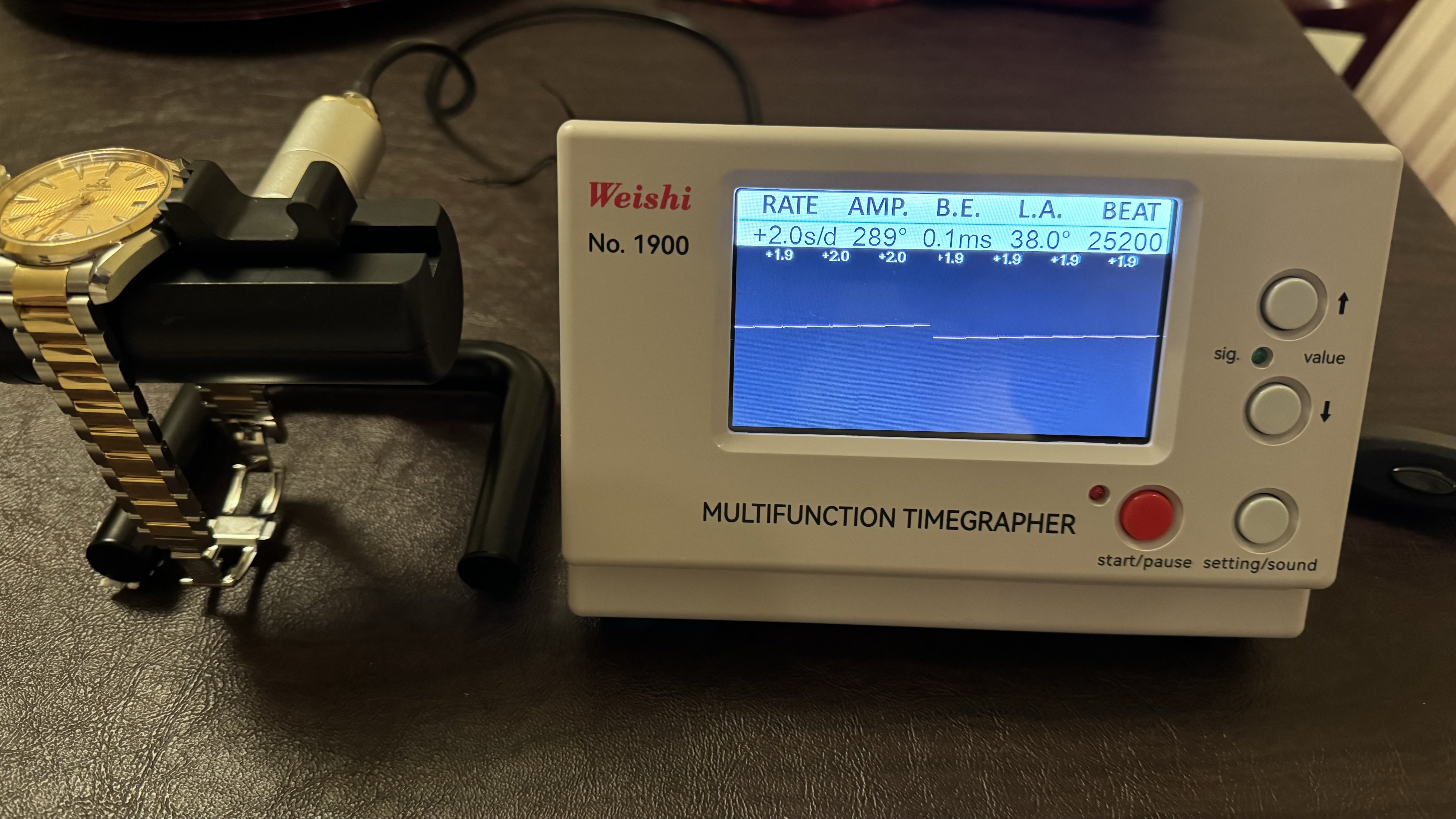

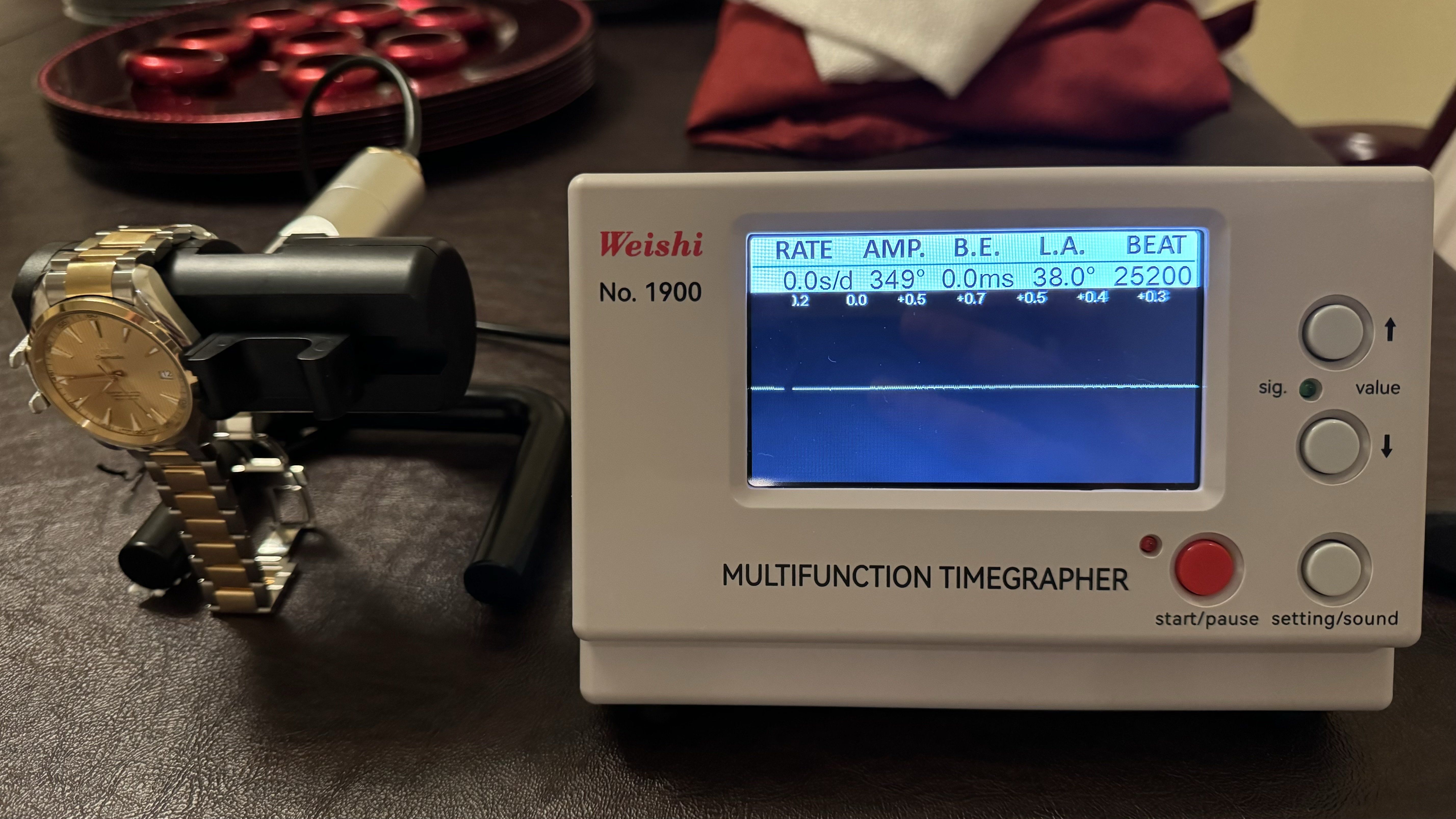

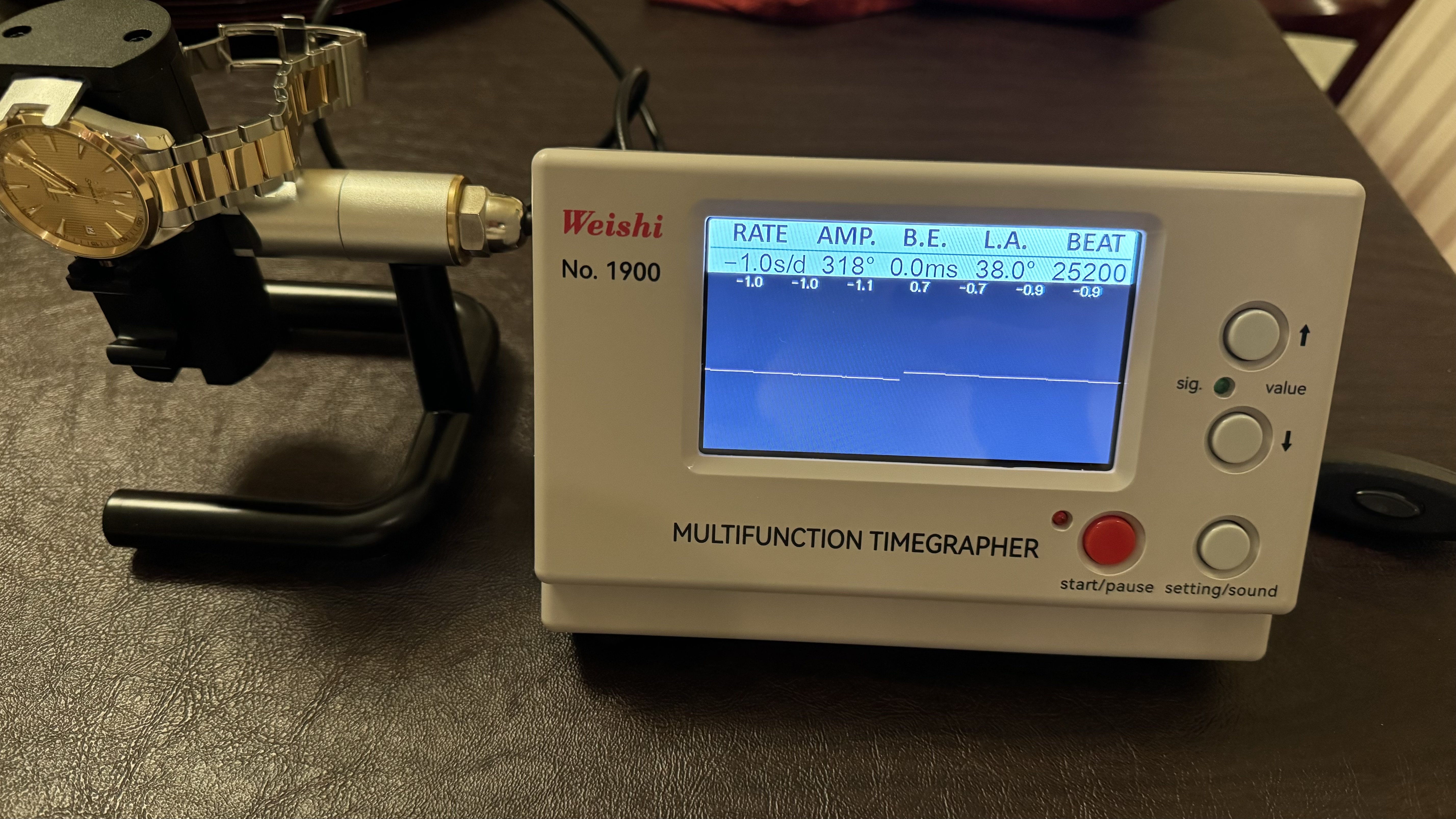

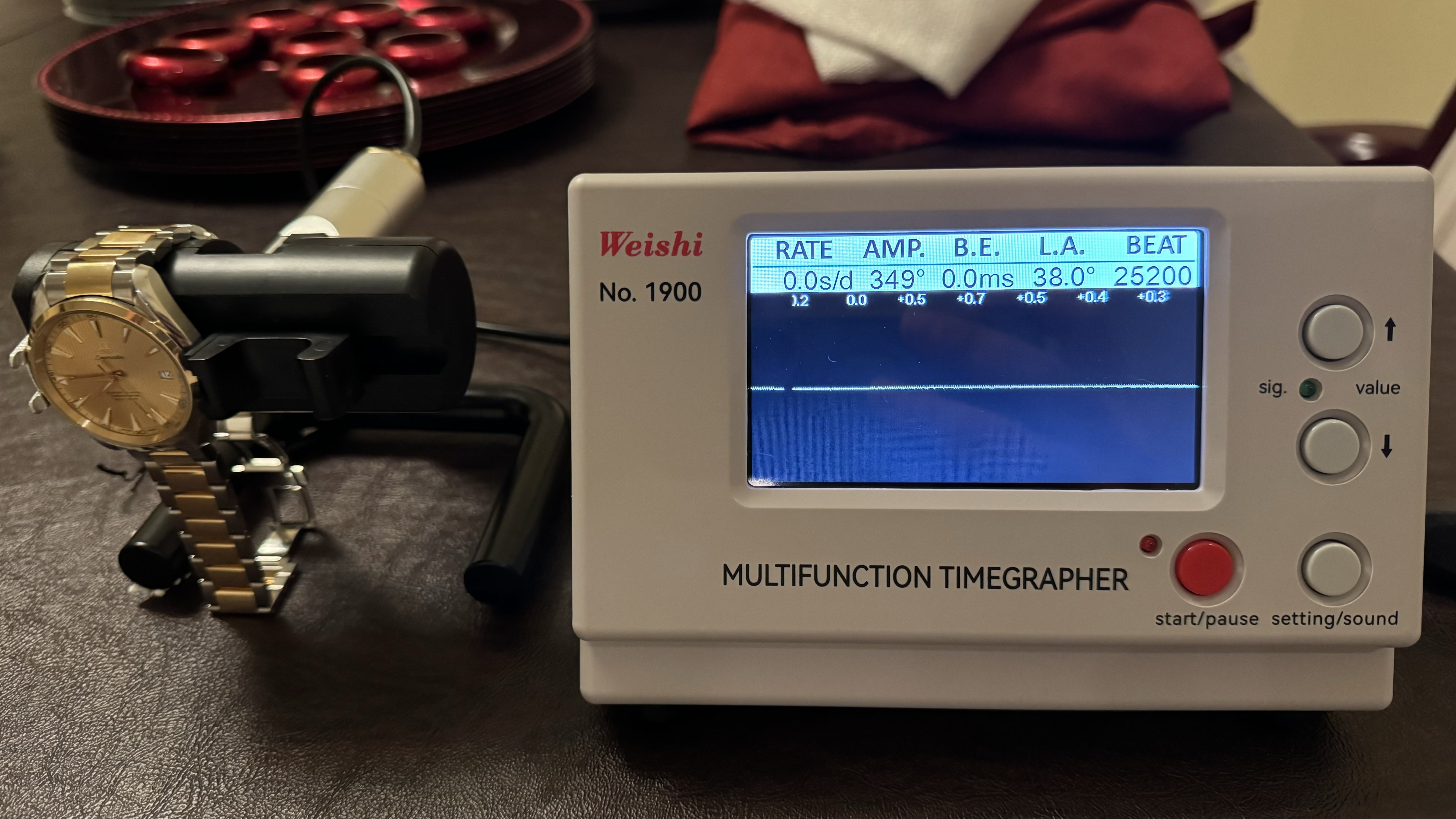

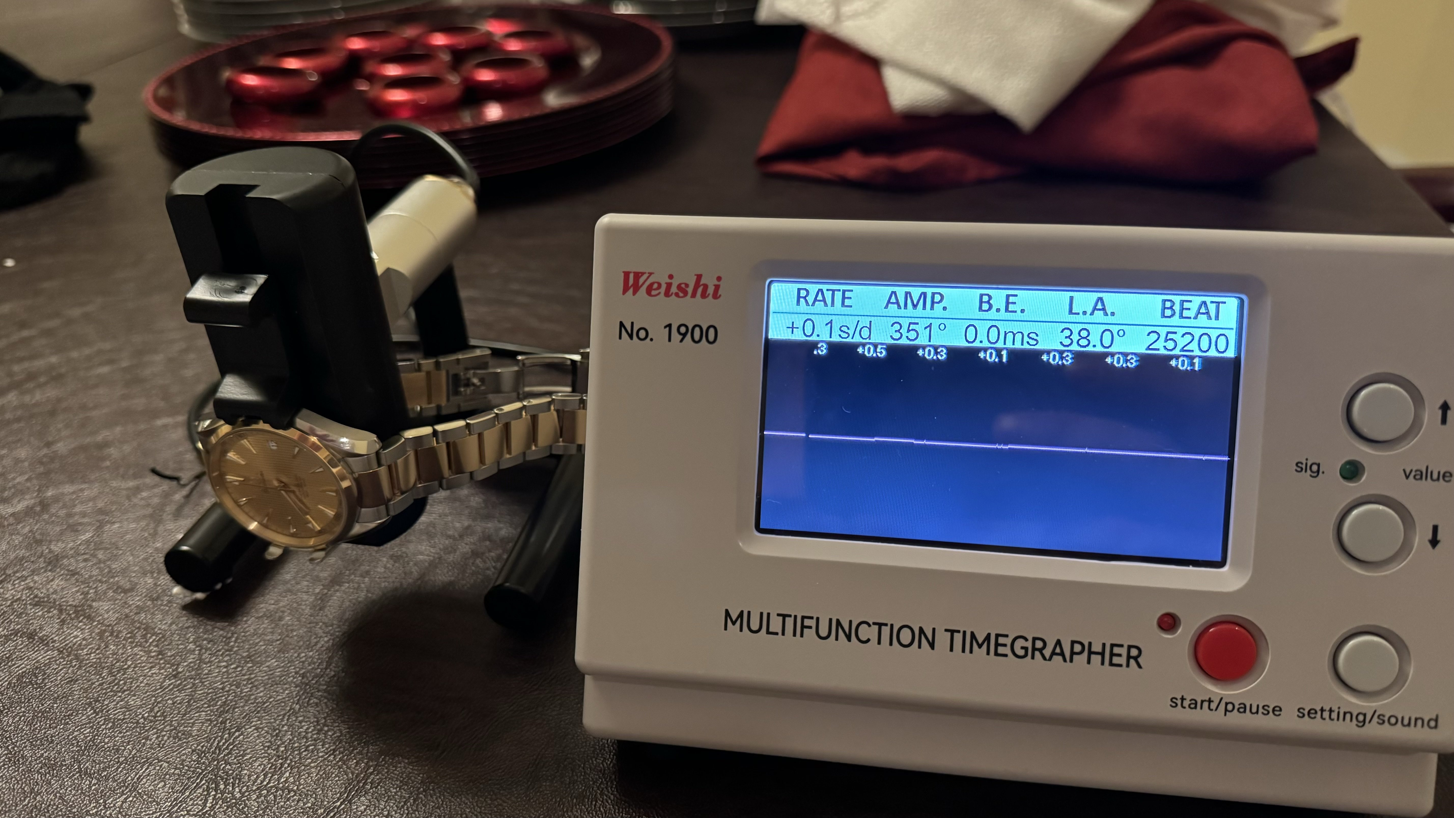

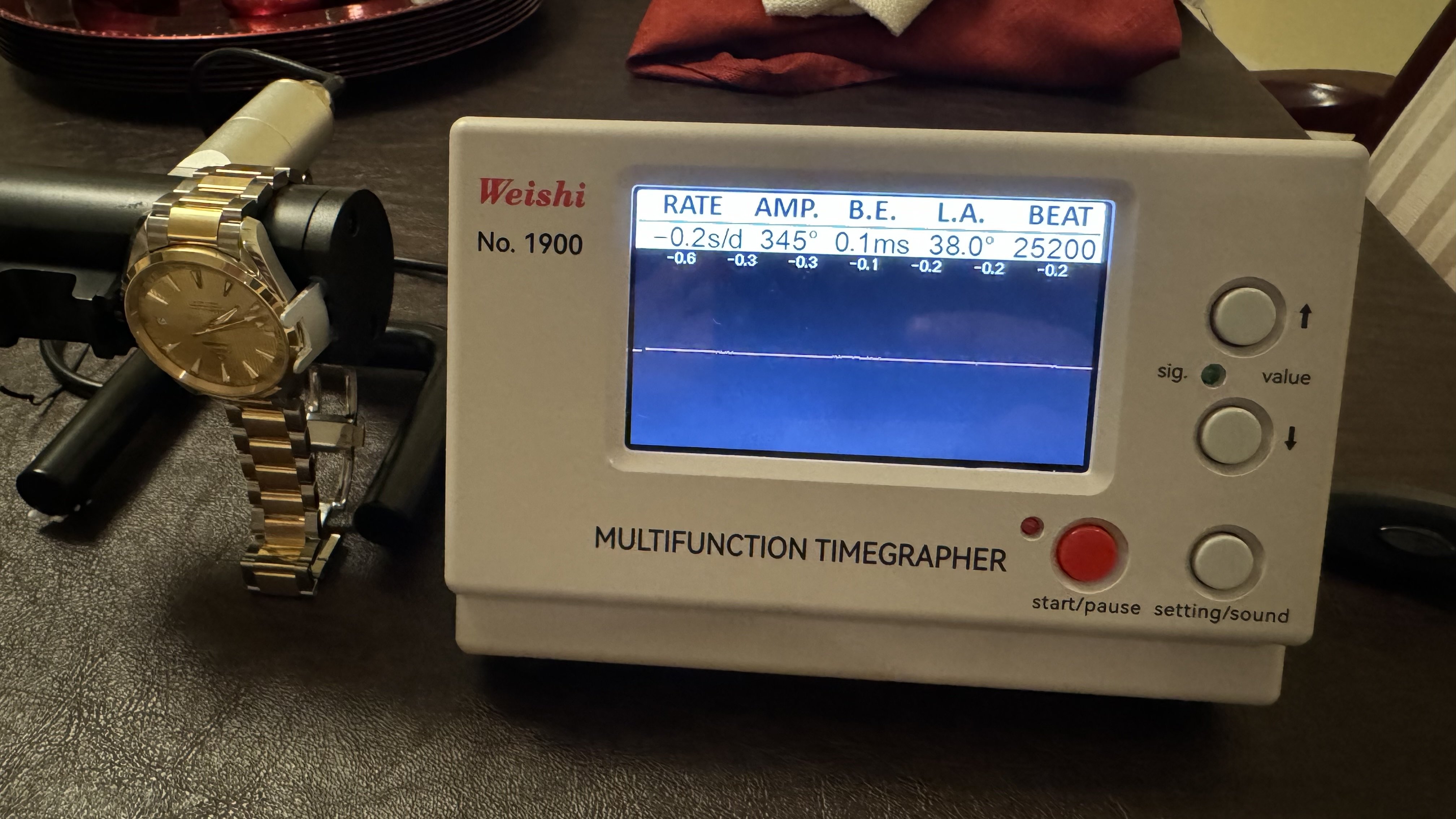

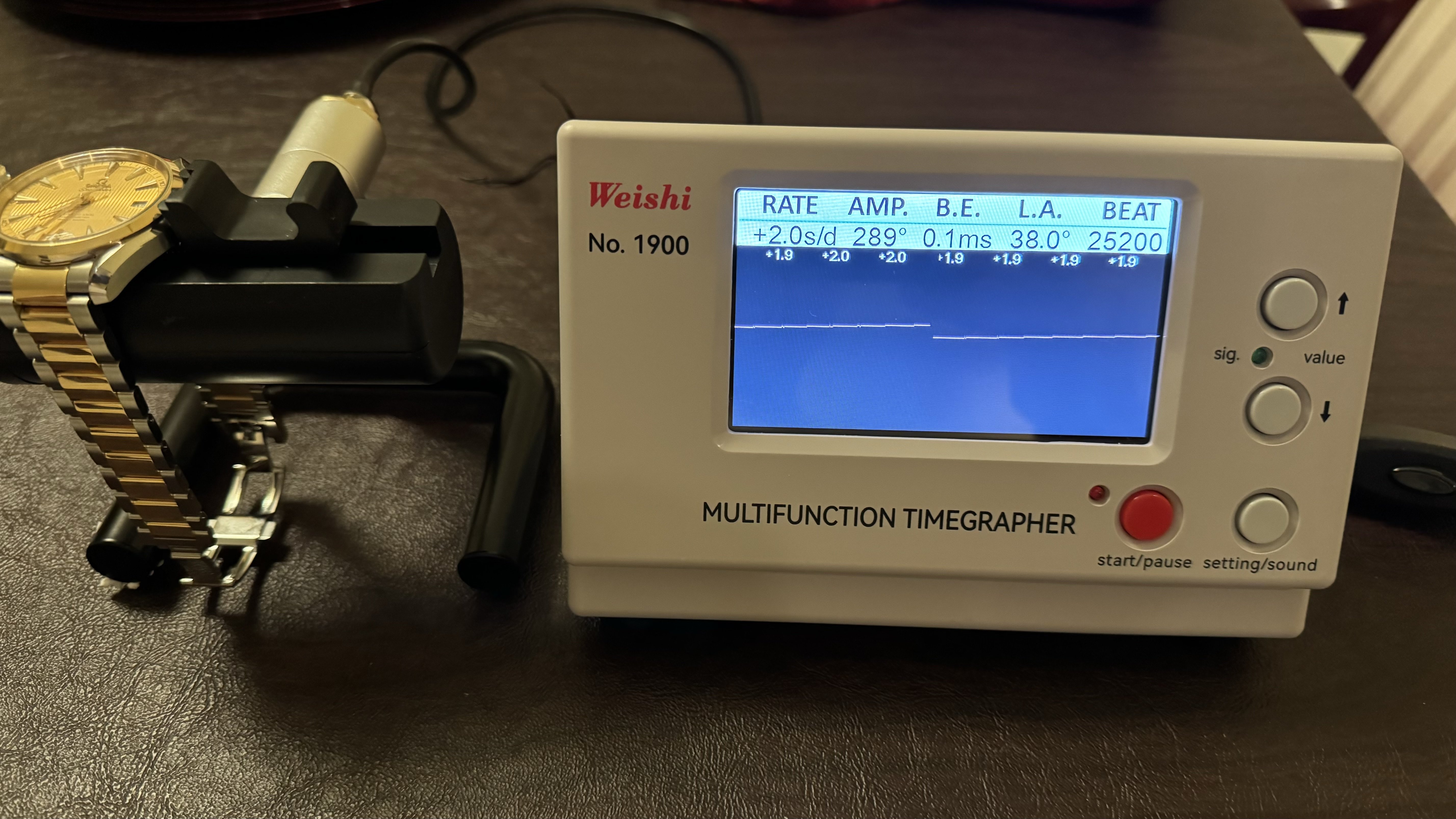

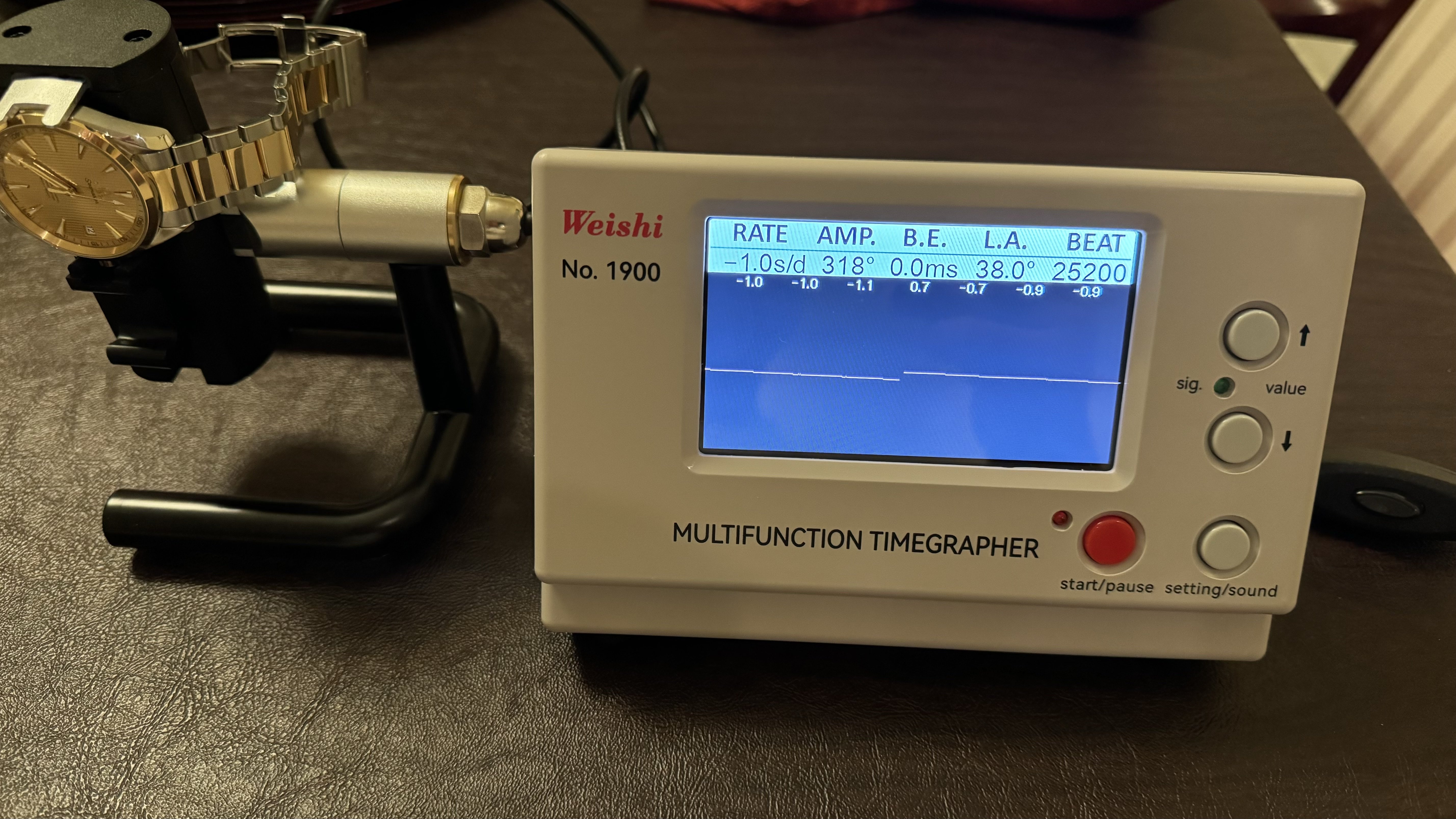

I added pictures of the watch on the timegrapher. The amplitude and accuracy varies with the angle of the watch. I don’t know whether this is normal.
30,274
78,127
Thank you
Yes, it’s normal. Note that your machine will not read the amplitude correctly on a co-axial watch. The machine requires special programming for that.
