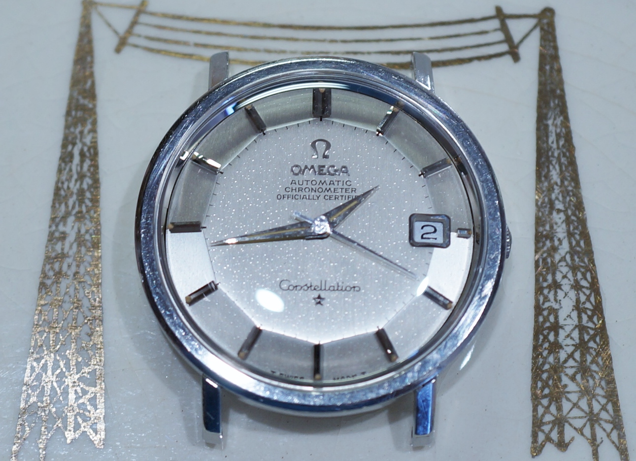

My first Constellation .... and she´s from 1962 ... but not the dial ?

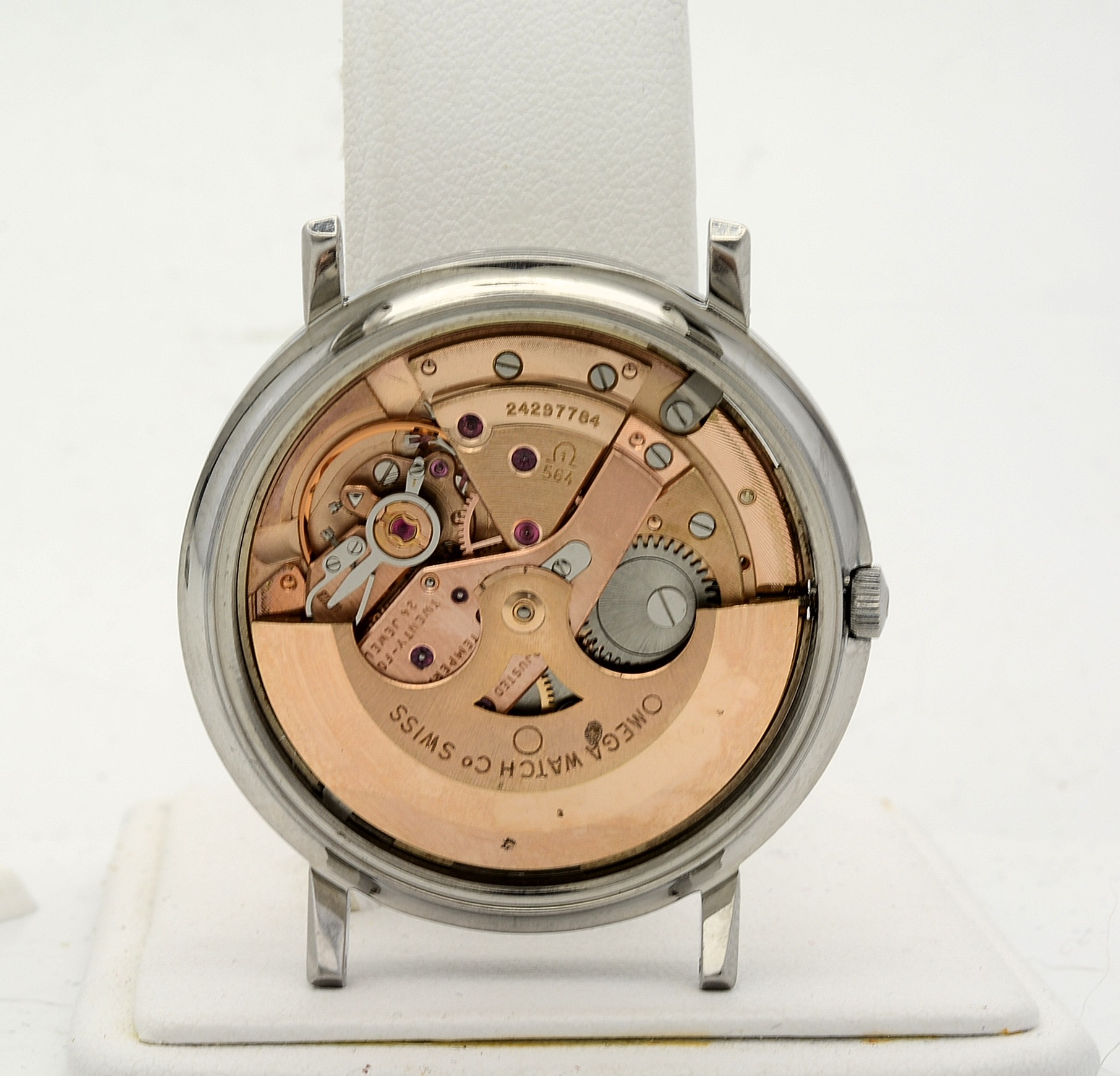

My .004 564 with serial number
24297784
6,832
10,502
24297784
Only 582 apart, so pretty close.
I know it’s only two examples but it’s the start of a grouping IMHO.
I wonder how many (or few) of these ‘rump-end’ .004s wangled their way onto the .010 production line in order to be fitted with 564s.
At some point I must get around to writing to the Omega museum as they only quote 561s for .004s in the OVDB.

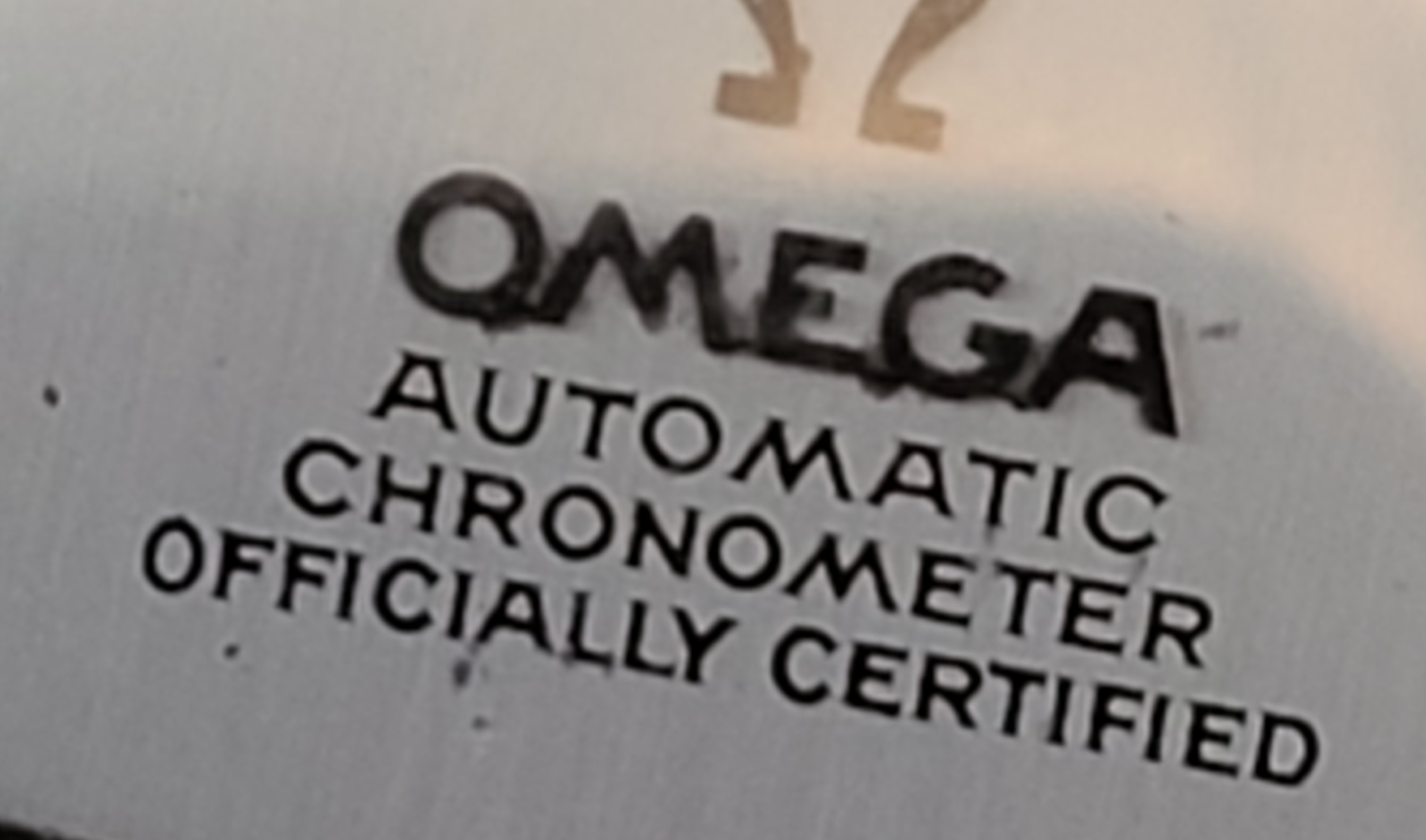

From what I see, OP dial has been repainted by a good redialer.(with no knowledge)
Compare to an original and you will see.

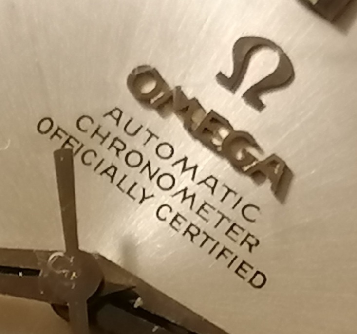

I don’t wish to pour cold water but there are some issues with your dial.
The hands have black infill and the indices look inlaid with onyx yet on the bottom we have T SWISS MADE T which indicates a lumed dial. I am not sure how this came about, possibly a later dual reference service dial or a very good redial. Other more knowledgeable may know the reason.
Edit:- Or a third possibility the guy/girl who put the original dial together picked out of the wrong box.
Hmm, I was told once that the T would also indicate that just the hands have tritium, so no tritium on the dial itself. This watch could have originally had lumed hands but somehow got swapped with the wrong hands. Hands are the most likely things to get swapped. Dials, not so much.
Incorrect in the case of Omega, don't know if it holds true with other brands. In general it is rare, if not very rare for a watch to only have lume on the hands and not the dial too.
Thats not correct, the ones spreading that rumour was probably the same ones that did the hands/dial swapping.:whipped:
Watches came either lunmed both dial and hands or not att all.
I'll find out from Biel once they reopen. I think I've seen older vintage Seamasters with T with just lumed hands only.
