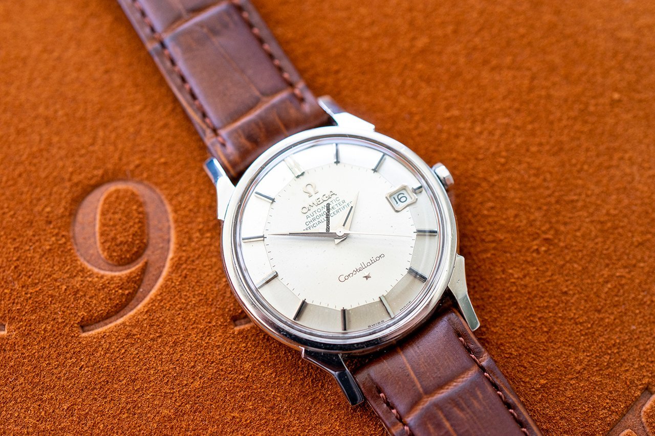

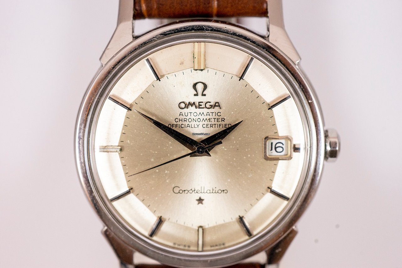

As of this subject, I got some advice from Desmond himself, and he believes it to be an authentic dial and watch as far as he can judge from the pictures of course.
For anybody interested, I will share the pictures underneath (hope this time it's the correct way to do so 😀 )

Welcome Stefan and congrats on the purchase.
+1 on originality of the dial, not that my comment means much after Desmond has spoken. The case is a bit “soft”, eg polished. But if the price reflects this and the spotting on the dial you could’ve certainly done worse. 😀 Can’t comment on the crown until we see a picture from the side - note that these had a flat feet Omega logo originality, service replacements at some point started to come with a more modern logo. But that’s a detail that, while it’s nice to have the old, original style, wouldn’t put me off of a watch I like.

Dial looks good, although I can see why you say the MOY rule doesn’t check but, I wouldn’t worry about it specially if Desmond has given it a positive opinion.
Those thin crowns, although a bit difficult to wind and set, I believe are the correct vintage ones. Replacement crowns (and fake repro crowns as well) are thicker so I think it should be OK.

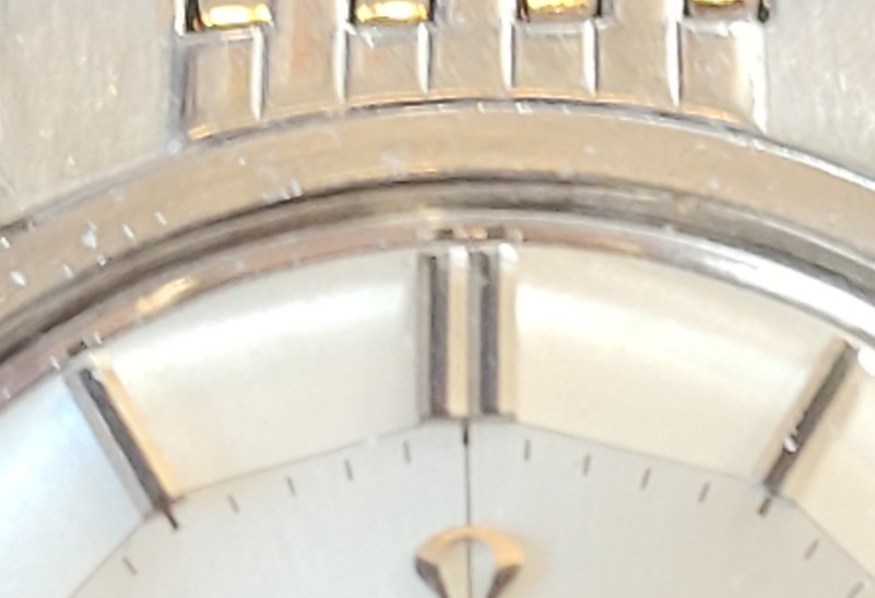

Are my eyes cheating on me? I don't see any black stuff on tops of 12, 6, 9 markers.
Do you guys see the same or just only me?
Mh - on the small phone screen, it appeared like reflection to me, but you're right. Also, the 9 marker looks too short on the first pic, weirdly.

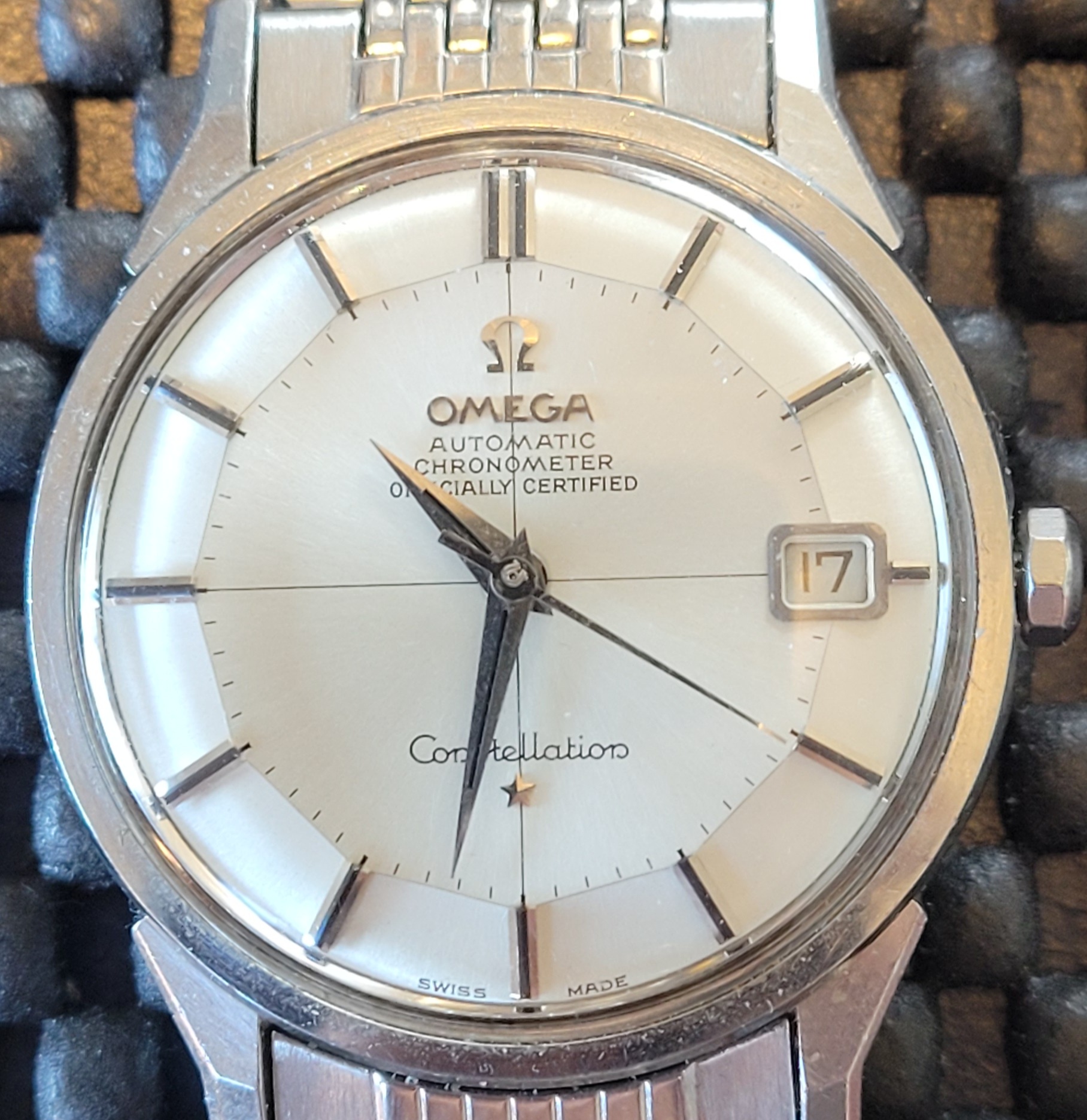

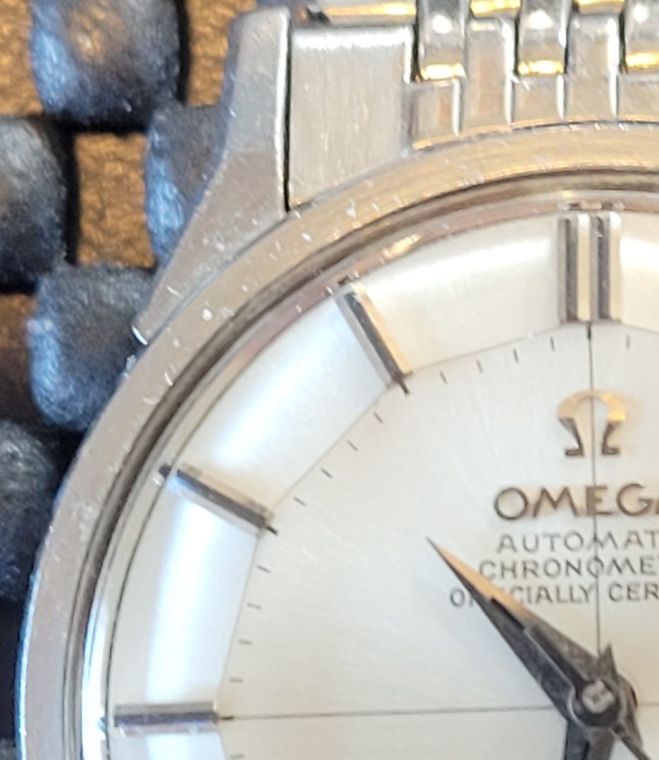

Hello Stefan.
I think your watch has problems with the hour markers.
All hour markers on your watch should have "black stuff" called black onyx inserts on tops of them.
I looked carefully at the ones at 12, 6, 9 and saw nothing. They are not the same like the others.
More than that, they are a bit longer and protrude out a bit too far into the dial.
Looks like they came from another model and they tried to stick them in here.
I attached some pics from one of mine. So you can compare and see.
Keep it or return it is your decision.
Regards.
