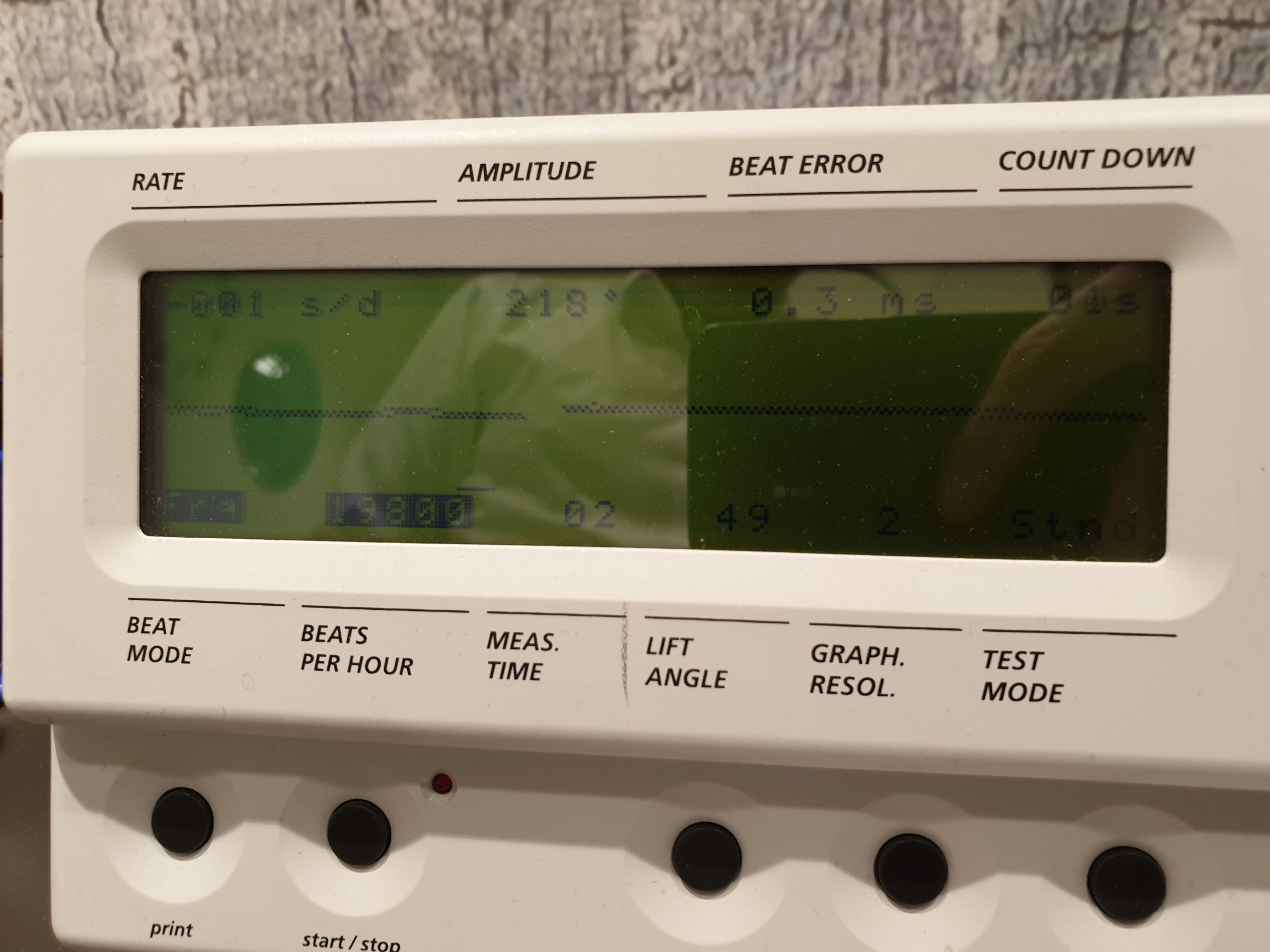

Hello guys, so I have a Seamaster 600 and it has the cal 611.
It had an amplitude around 220. Otherwise these were the other values as shown in picture.
So my question, is 220 a bit low?

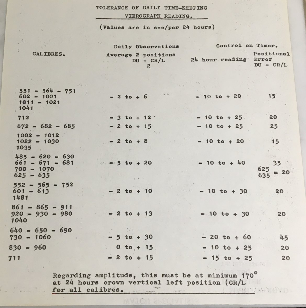

170° is minimum according to Omega as contained in a document Michael posted in another thread.
Yes but after 24h and in vertical position, so not fully wound as I supose the test have been done.

Yes, quite low in fact...
Should I do anything with it? What's to be done with it anyway? Need a new mainspring?

I'd generally expect a good watchmaker to not be happy with returning a watch with such low amplitude unless specifically requested by the owner.
30,284
78,150
If the amplitude is this low at full wind, then the service didn't address the issues that the movement most certainly has. It's standard practice to replace the mainspring at each service, and I can say with some confidence that if you only have 215 degrees of amplitude at full wind in a horizontal position, there's no way you will be above the minimum that Omega requires in vertical positions 24 hours after a full wind.
Is this cause for using the service guarantee and ask them to replace it, you think? And is a new mainspring ordered from Omega?
