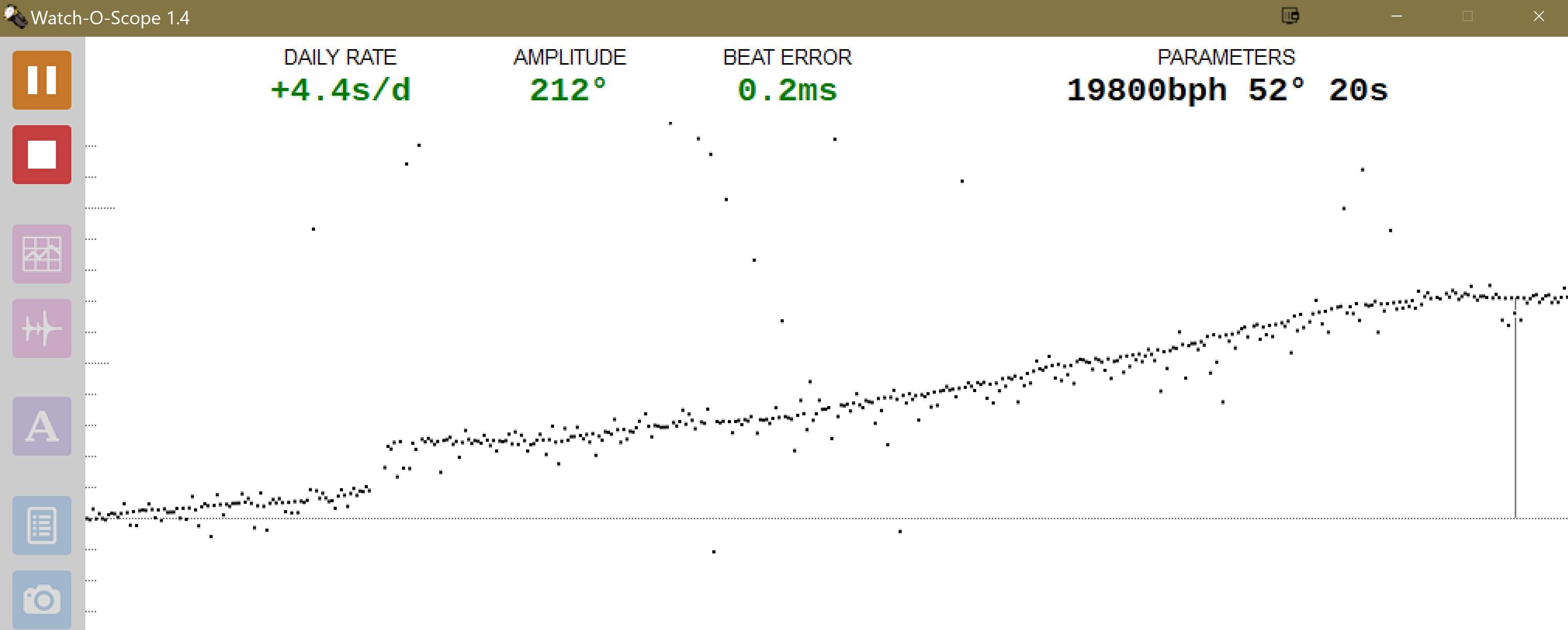

I just got a watch back from service. IWC cal. 401 from the '50s. It is within spec on timekeeping, but the Amplitude seems low at 220. Should I be concerned?

The lift angle of cal. 401 is 56 degrees, so the actual amplitude is 7.7% higher than you measured.

The amplitude seems to say 212, not 220. But you should probably check the lift angle since you apparently have it set to the default.

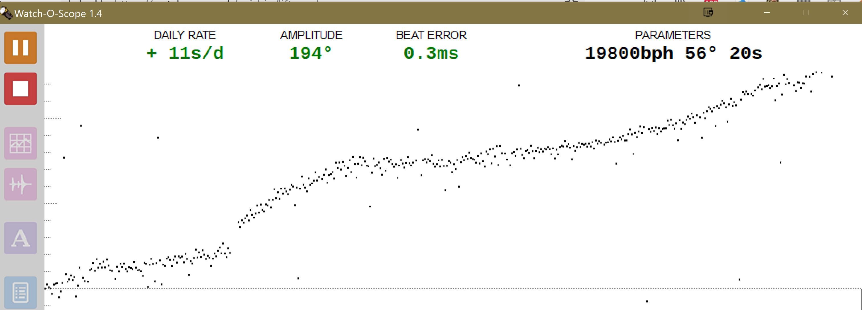

Here it is with the correct lift angle. Amplitude seems pretty low for a serviced watch.

With a pattern as scattered as that one is, you might consider checking with who it was that did the job, and asking them why it shows rather poorly. The watch could be 65 years old, and perhaps it has been over the road, and you may have to keep your expectations in check.

I don't consider the amplitude to be low for a 50's watch that had no parts swapped.
What I find interesting is the pattern of the reading. That doesn't look like the watch was particularly good serviced or some parts have defects.

The watch got a new mainspring. For a $800 service I expect new parts if needed for cost, I could of had a clean for $300. I'll hear back from them after the holiday. I know it is an old watch but the IWC Cal. 401 is a good movement, and should perform better than this.

If things remain the same, increasing the lift angle setting should increase the amplitude as a result, and should not affect the rate. Something else is in play here, it seems.

it could be many things but with a new mainspring ... rather low. how is the +/- delta?

Weird how the timekeeping is wandering around so much. I don’t usually see that on a watch that has been serviced unless maybe you changes the position.
