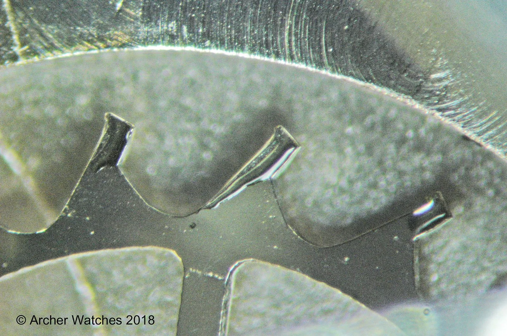

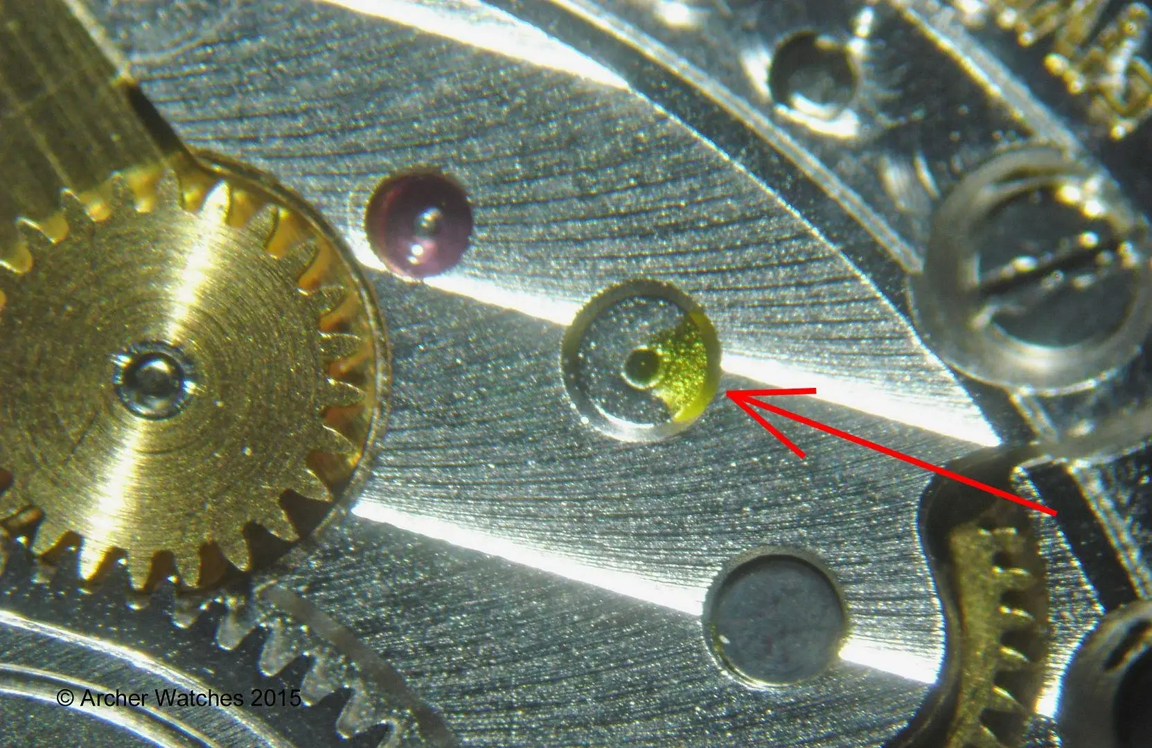

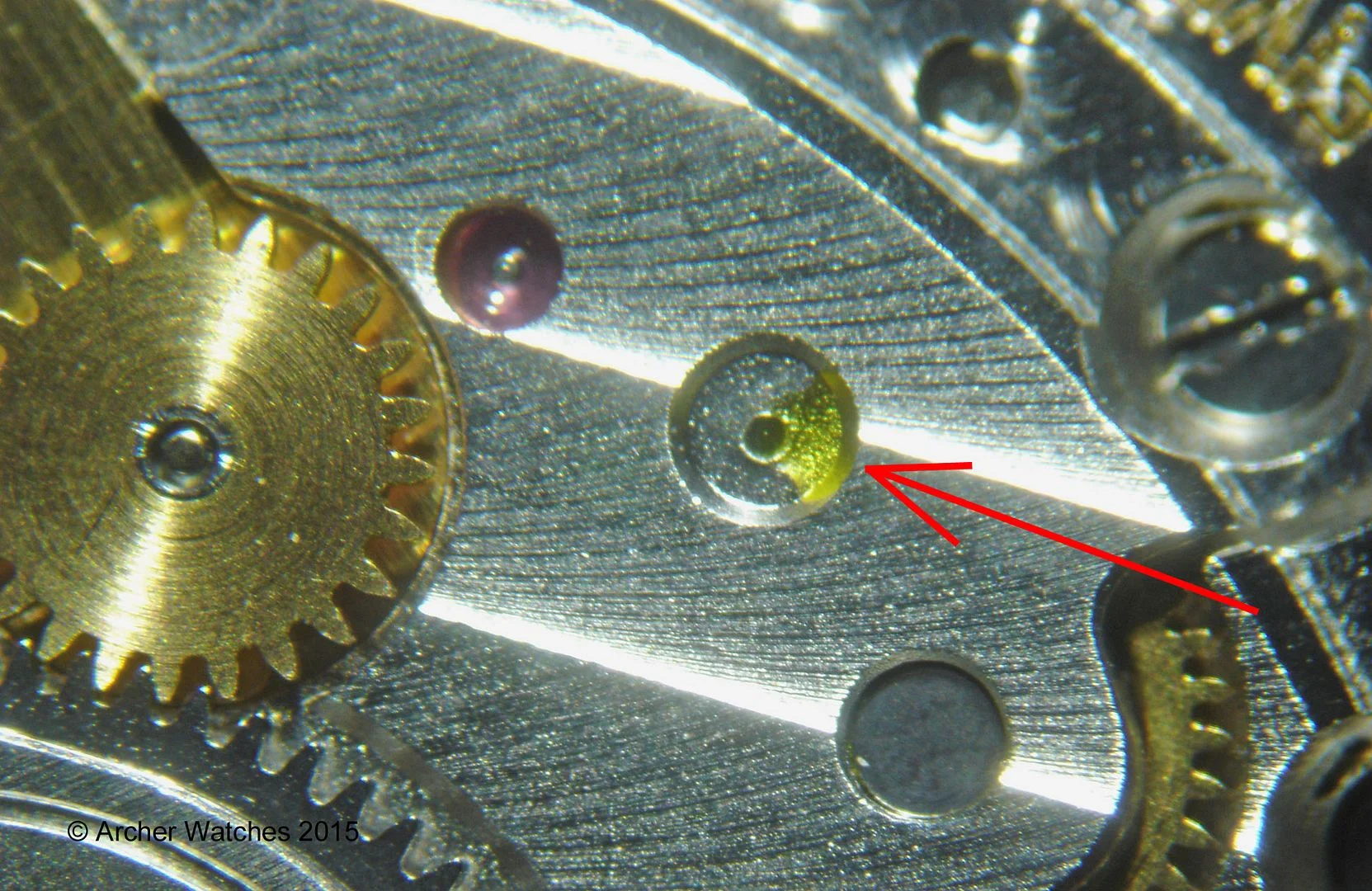

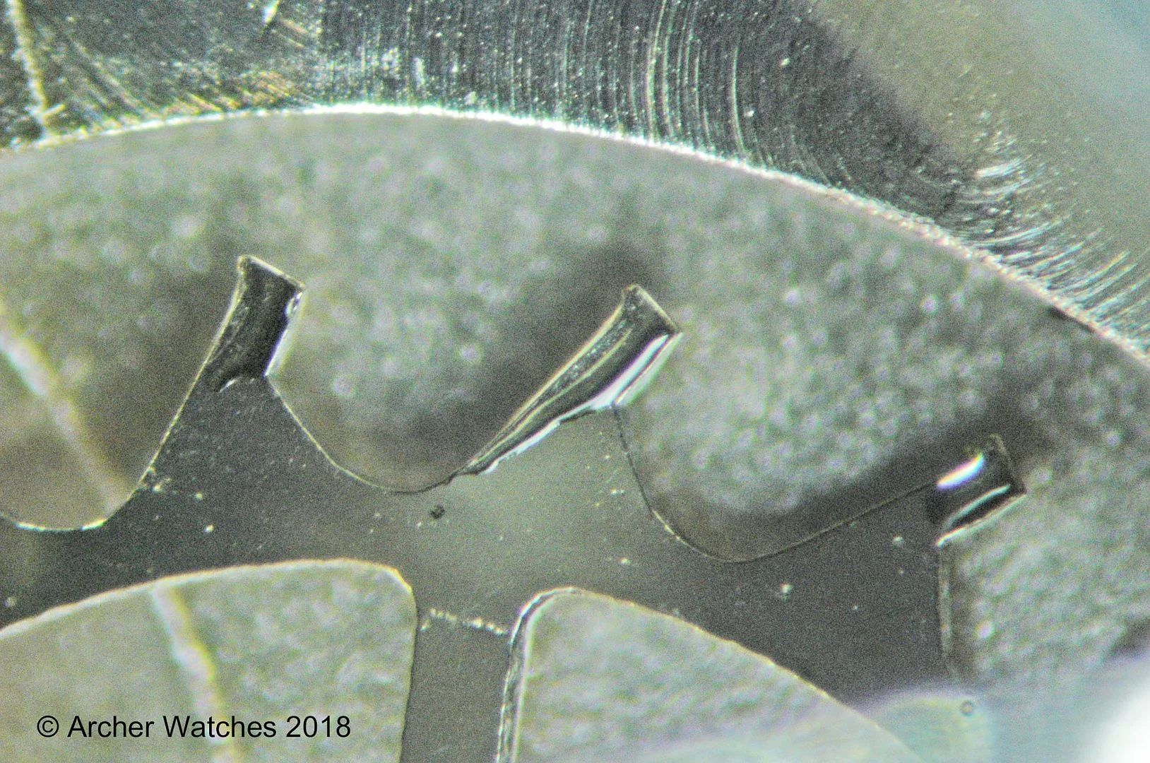

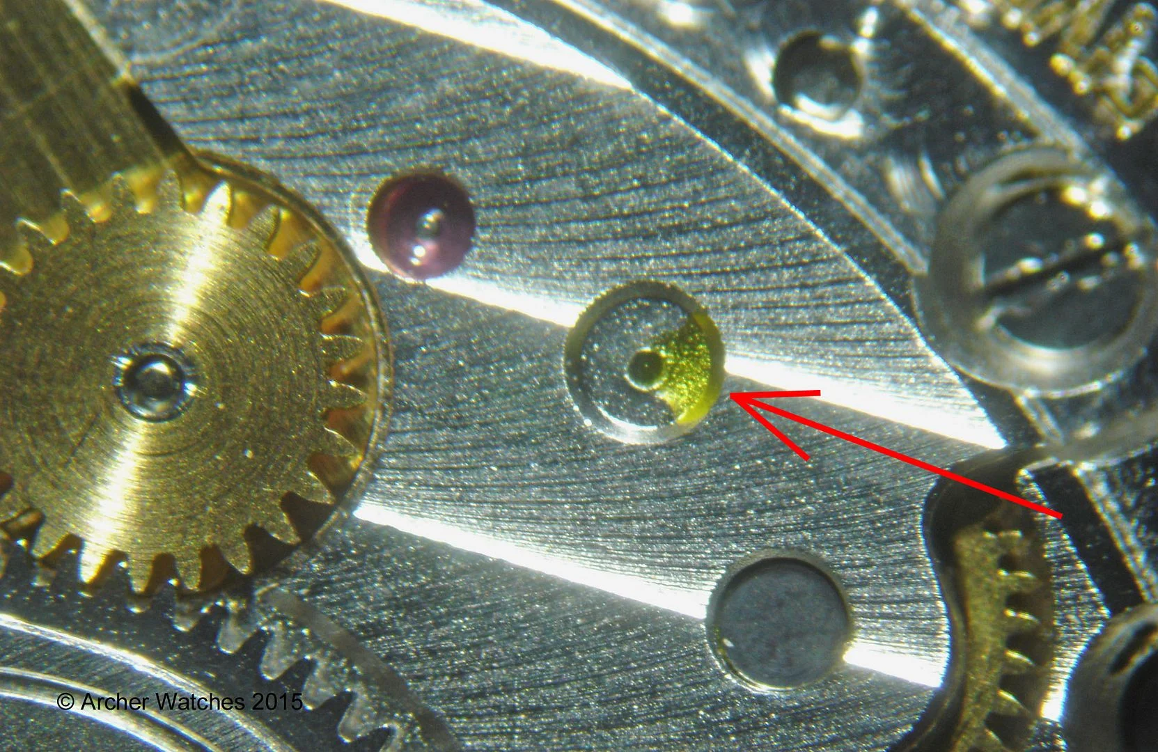

There was a reseller on WUS (not sure if they are still selling there or not) and he sold a lot of the type of watches that the OP bought - the pre-coaxial generation of Seamasters and GMT's, both mechanical and quartz.
They were all sold as being recently serviced, but for about 2 years a steady stream of these end up on my bench. I asked one customer if he asked the seller for proof of the service, and one of them did, and was given a receipt - total cost for a complete service of a watch like the OP's was $150. You can imagine that the work wasn't exactly good.
I would see escapements oiled like this:
Enough oil for a dozen watches applied to one...
Here the watchmaker applied oil to the back side of a pressed in place post - there's no moving part here at all, but it's now protected from wear I guess...
On top of that when I would check the serial numbers to verify what the watch was supposed to be, often they had been modified and were being sold as something they were not. There's a lot of shady stuff out there - why I generally wouldn't buy from dealers.
