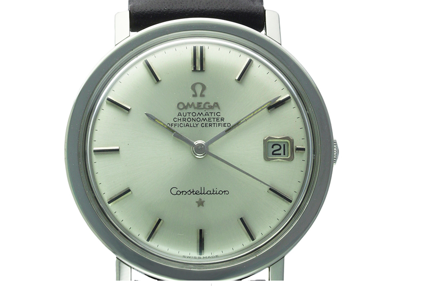

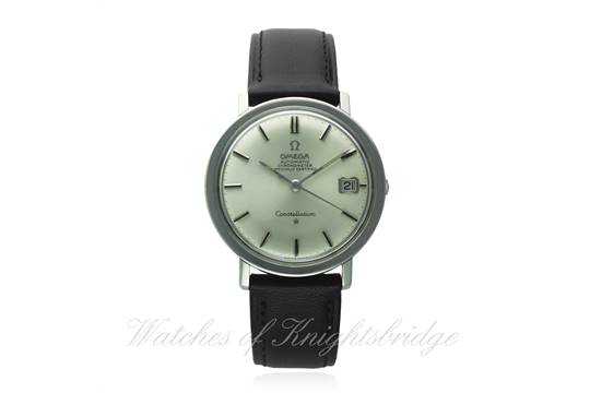

Good morning all,
This Connie ticks a lot of my 'like to haves'
The auction house description says it is 'original'-but I would appreciate your comments please.
A couple of things stand out to me:
Would the 'dagger' style hands (if that is the correct term?) be used on a watch of this type/era?
(they also look a bit ropey)
The dial looks good to my novice eye -but the star is crooked
From all the posts or advice I've read, isn't this usually a sure sign of the dial being messed around with?
here is a link as I'm not sure that the image is good enough to look at in detail (Lot 275)
http://watchesofknightsbridge.com/view-auction-catalogues.html
Philip

Sgt Bilko's post reminded me about this Constellation
I realise that it is a pain for folks to go to an auction house web-site -and then to have to find the lot
so I've managed to get an enlargement of the face.
The site says original dial, 1961, Cal 561
Same comments as before from me -are the hands correct for this kind of watch and is the wonky star a tell-tale to someone messing about with the dial?
I'd love some expert feedback please

The auction says it's a 168.004. Have a look at this link:
http://omegaforums.net/threads/jumbo-omega-constellation-168-004.6060/
I don't have one but in my opinion, the hands are wrong but the dial looks OK although the wonky star is worrying. These are really tricky and I've been wrong before so take this as me bumping your thread in the hope someone with better knowledge comes along.😉
Cheers, Chris

7,225
24,428
Agree with Chris, hands should have black inserts matching dial...case looks polished too.

thanks
all opinions are most welcome
for novices-what is and isn't a polished case is very difficult to tell until you seen many many of the same type (ref your post on dials)
6,077
9,412
Look at the Constellation Sgt_Bilco just purchased in the following thread (bottom of page 1), see how sharp the facets are, the one you're looking at has had these polished down to a rounded edge. Look at the bezel and lugs specifically.
http://omegaforums.net/threads/very-proud-new-owner-of-my-first-omega.22494/
His also has correct hands.
got you -the one above has rounded edges -hence being over polished
-and the hands on his Connie are really nice and in excellent condition
I didn't know if the one above -being older- might have had different hands from later models
-so if this one is a 1961 version would it have had dauphine hands or did Omega use hands like the one in the link from the early 60's?
The whole hands thing -and when they started/stopped using certain styles -has me a bit baffled
