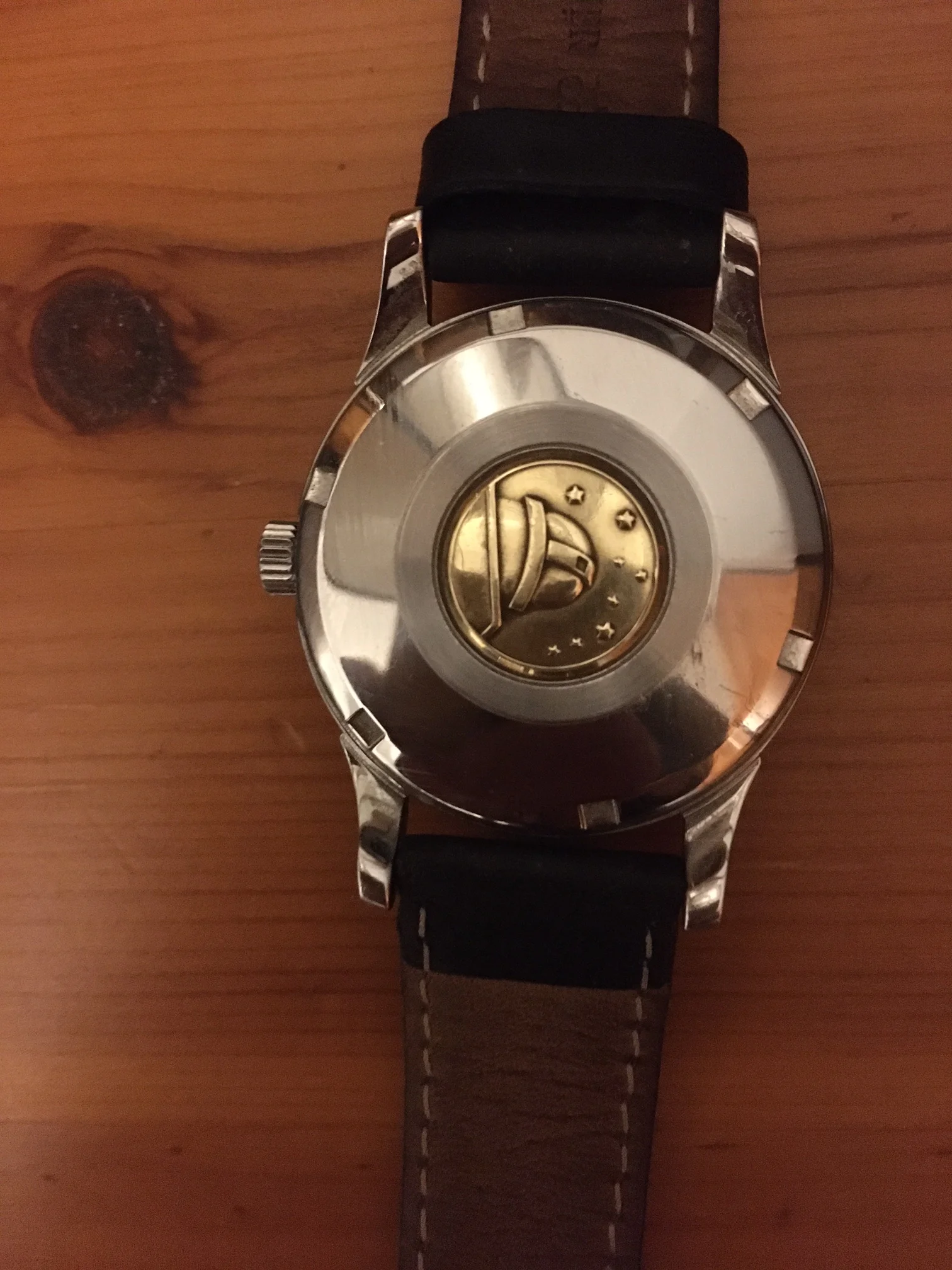

My father passed away December 2024, and I found his Constellation in a drawer. It was given to him as a 21st birthday present on 28 January 1964, so I 'm guessing it is a 1963 model? It has no papers or box. I would like to get it running and wear it daily. The second hand ticks away and the hour and minutes move sometimes and then don't.

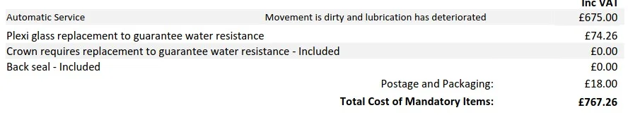

I have sent it to Swiss Time Services and they have sent this repair schedule in a diagnostic report:
Crown requires replacement to guarantee water resistance - Included £0.00
Back seal - Included £0.00
Fixed bezel scratched/marked
Case back scratched/marked
Case scratched/marked
Aftermarket strap/keeper broken-New Omega black calf strap/pin buckle
Plexi glass replacement to guarantee water resistance
Hands scratched/marked - New set of hands
Automatic Service
Our Mechanical Service Package: Full dismantling of the movement with any worn parts/damaged parts replaced. Cleaning and
reassembling of the movement, lubrication, gaskets, water resistance testing to manufacturer's specification, light
refurbishment of the case and bracelet (if applicable), ultrasonic cleaning, time and functionality testing and aesthetic control.
Plates and rotors are excluded from the service price and will be estimated separately if required. Any casing components and
rusty parts will also be subject to separate estimate.

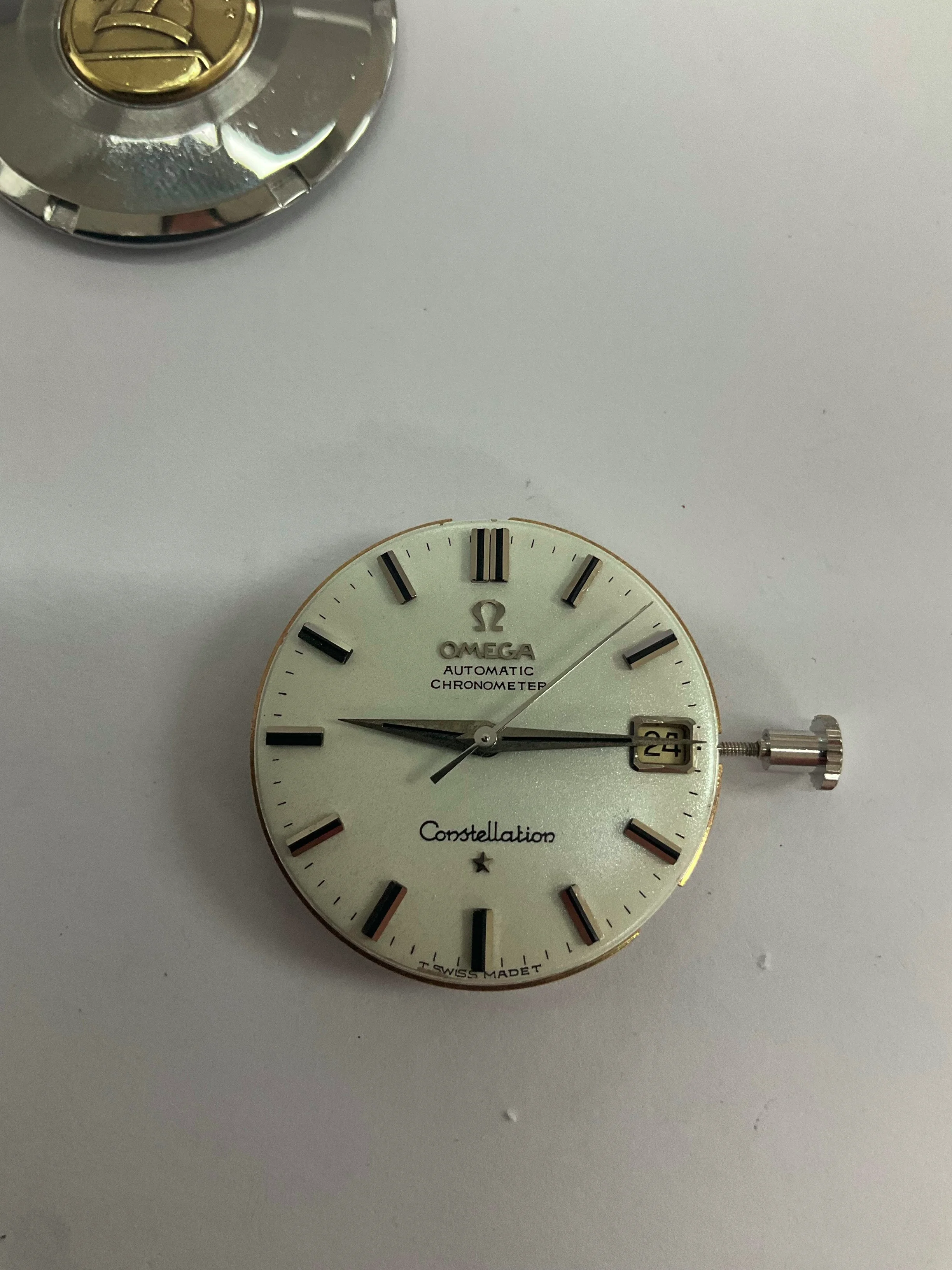

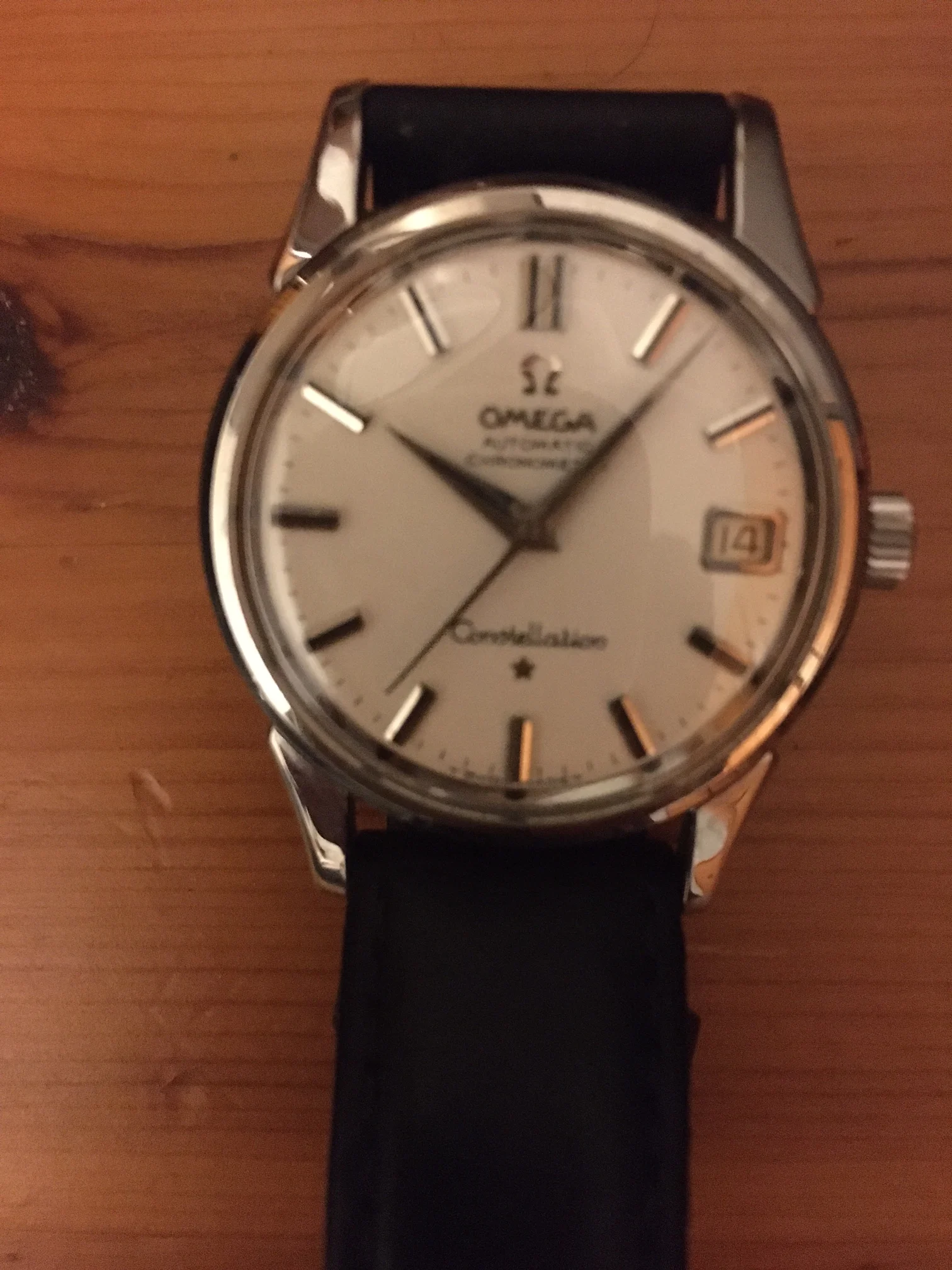

1. Is getting the hands replaced a bad idea? I am sorry the pictures are so bad, so it is hard to see the hands ; I don't have any other photos.

We can't really give an opinion on the hands from that photo. But unless they look awful, I'd probably keep them in place. The tip of the sweep hand appears to have broken off, so maybe they can replace the sweep hand and keep the original H/M hands installed. Or, if they look terrible, and the replacements are identical ... replace them. (Usually replacements are not totally identical, which would bother me.) You need to decide what you prefer.

The hands looked fine to me, so I think I would rather keep them, perhaps replacing the sweep hand, as you suggested.

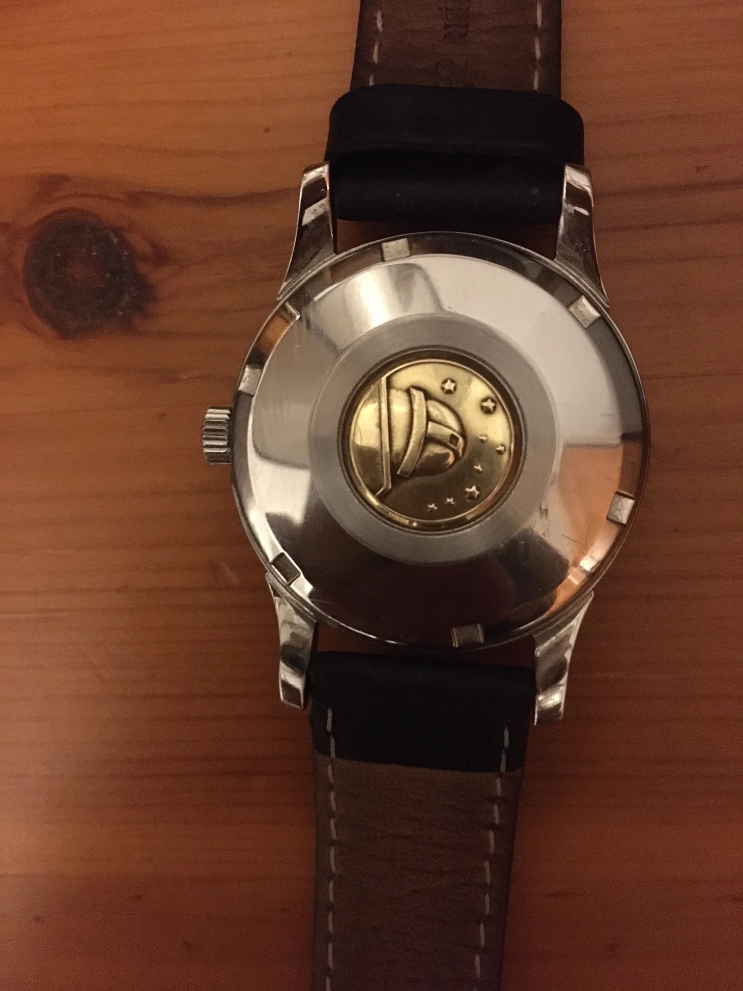

The quote mentions "light refurbishment of the case" - is this something I should refuse?I am probably never going to sell the watch, but I would like to avoid anything that would change the character of the watch. Any scratches were caused by my dad, and I'd like to keep them, if you get my drift.

Generally we don't recommend case polishing, but it's a personal decision and also depends on the current condition of the case. Preserving scratches is generally less important than preserving the original shape of the case, e.g. sharp edges and facets. However, if those edges and facets have already been lost through previous polishing, there's not much left to lose. Again, that's pretty hard to judge from the photo.
Incidentally, I don't think that the crown in your photo was the original crown anyway, so replacing it is probably not a big deal.

Photo very blurry but I think I see T SWISS MADE T at bottom of dial which means tritium lume. I can’t see lume on indices due to blurry photo. If they replace hands the new ones will not be tritium and will look different so that’s a consideration when replacing. I would ask about that but imo unless hands look terrible I would try to keep original HM hands just replace sweep.

And regarding polish, I would tell them nothing more than light hand polish with cloth, nothing that would alter case edges. But this is personal choice of course. My approach would be to keep it as close to how my dad saw it as possible.

@SOG53 is correct in saying the dial looks to have Ts at the bottom but there is no lume.
It’s likely that the dial has been refinished in the past ( a common practice) so I would also keep the original hands unless they are losing the black paint and just replace the seconds hand.
The crown is a replacement - so just have them replace it with a new one and have a new crystal fitted (both these items are part of the waterproofing for the watch.

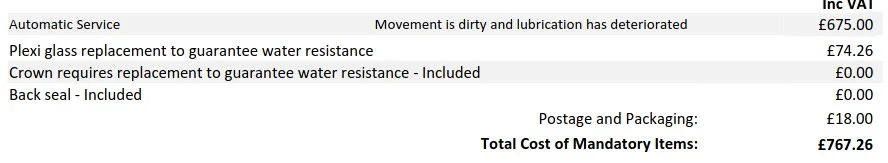

@Peemacgee, here is the breakdown of costs:
Automatic Service £675.00
Bracelet Leather
Movement No. 18859643
Serial No. 18859643
Watch Ref ST14393
Case Material Steel
Brand Omega
Watch Specification:
£767.26Total Cost of Mandatory Items:
£18.00
Estimate Valid Until: 11 March 2025
Plexi glass replacement to guarantee water resistance £74.26

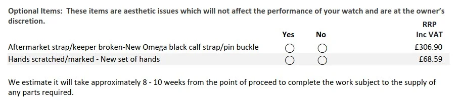

Optional Items: These items are aesthetic issues which will not affect the performance of your watch and are at the owner’s
discretion. RRP
Inc VATNoYes
Aftermarket strap/keeper broken-New Omega black calf strap/pin buckle £306.90
Hands scratched/marked - New set of hands £68.59

That was what I was rather afraid of when sending the watch to STS.
Don't get me wrong they will do a good job - but they are a large commercial watchmaker and act just like Omega in their pricing strategy (IIRC they may even be used by Omega)
As I said above, this method is a good hedge against unknown costs but you are paying a hefty premium for some kind of 'surety'.
To put this into perspective, an independent watchmaker might charge £200-300 for the service, this will include a full strip down, clean and lubrication plus a new mainspring and gaskets. (all as good as STS can do)
Any additional movt parts that require replacement will be extra.
Crown, crystal, hands etc would be extra too.
I think the most I've been charged for a service was around £450 - and that included a crystal and an expensive winding part - and that is only for one watch out of many Constellations that I've had serviced - you may not need anything replaced but it is of course a bit of a risk you would have to take.
You certainly do not need an Omega strap - and modern Omega straps are often far too heavily padded for vintage Constellations (I have a watch like yours and it looks great on a very simple black strap from Hirsch - which cost around £30)
The difficulty you may have is finding an alternative watchmaker that has an Omega account as Omega restricts genuine parts to Omega-certified watchmakers and therefore parts can be difficult to come by.y
Unless money is no problem, you could contact @Mitka or Christian at Watchguy to see if they have spares availability and what their costs might be as an alternative to STS - both are members here and have good reviews for their work.
(don't be concerned about getting your watch back from STS, they must get this all the time)

It’s a bit high but you will get a quality job and a warranty. Watchmakers around
me are drifting upward in price significantly. See if they can clean up the hands without damaging them, often a difficult and risky process. You can choose new ones if that does not work. Lotsa good strap options far less than an OEM.

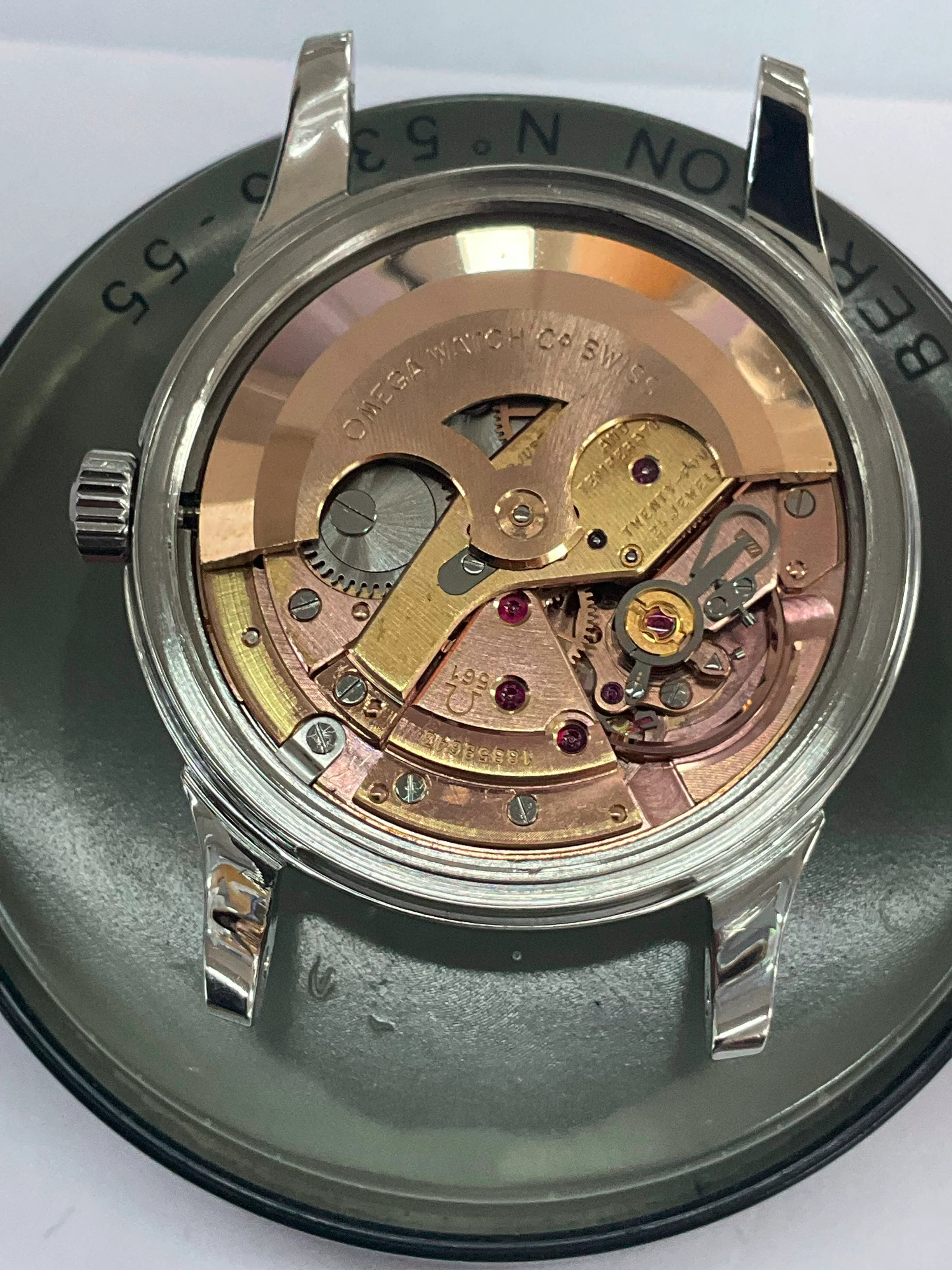

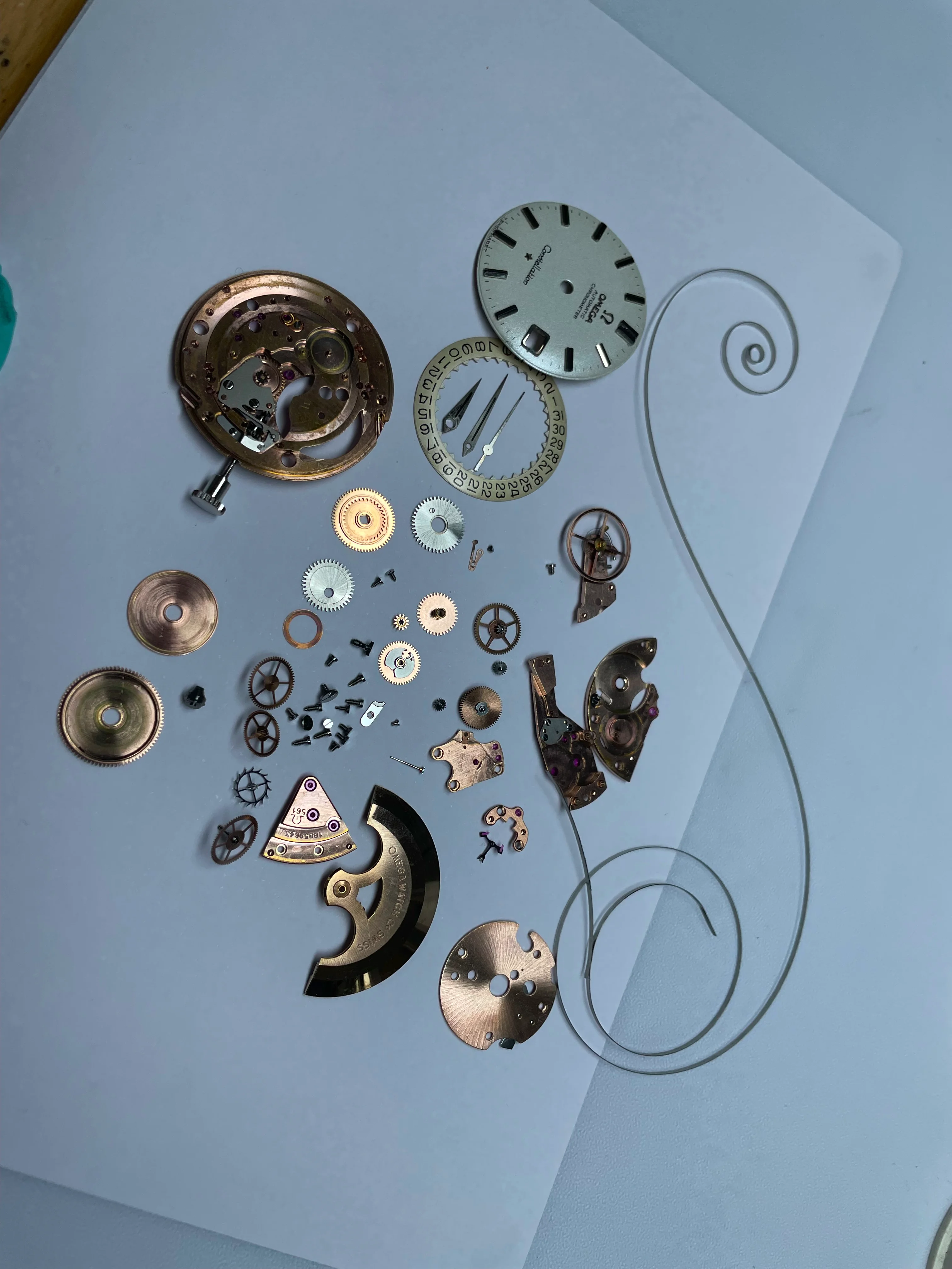

I hope it is OK to give an update on this. I kept it at STS, they have sent some photos. I need to approve the new sweep hand, then I think they are finished.
