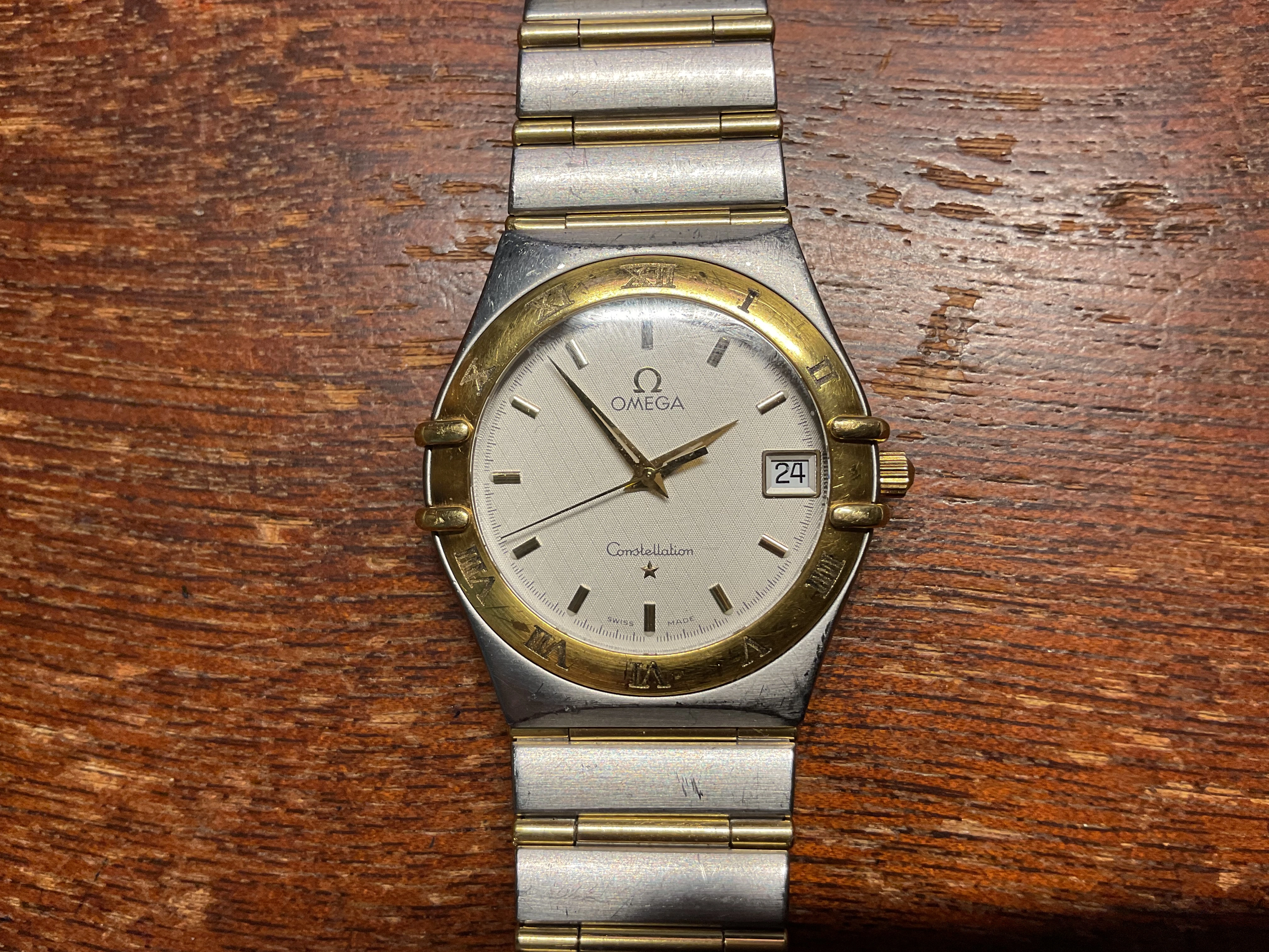

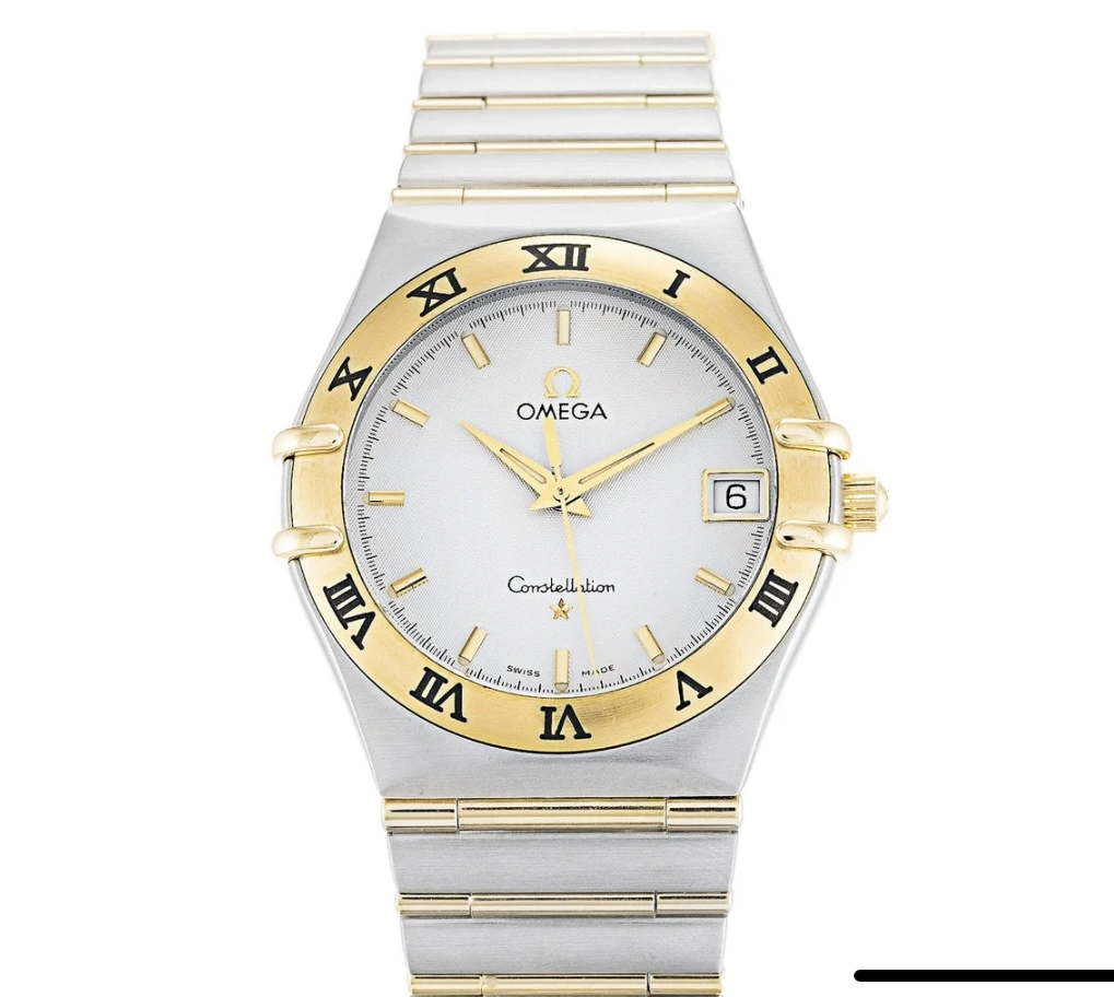

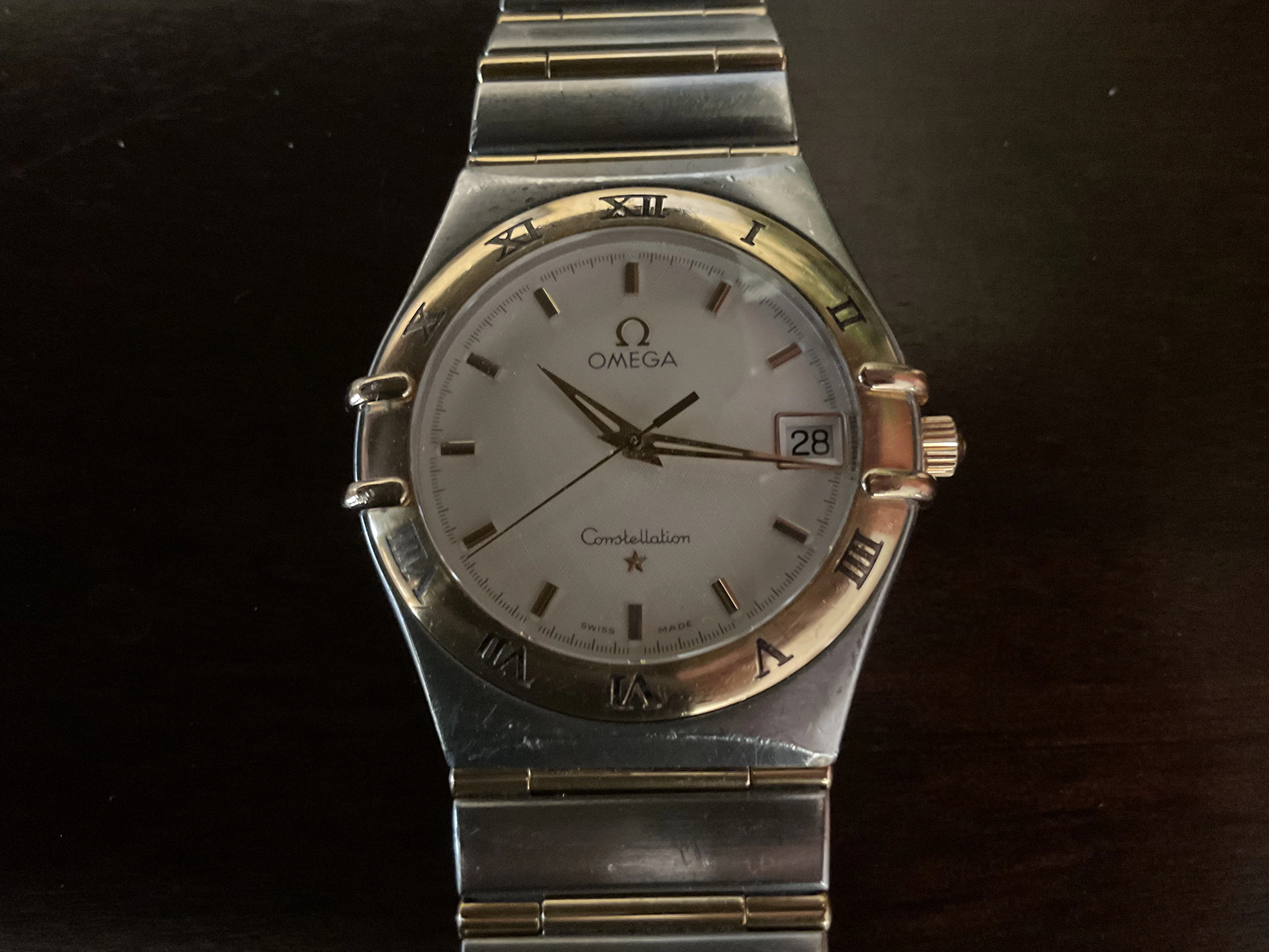

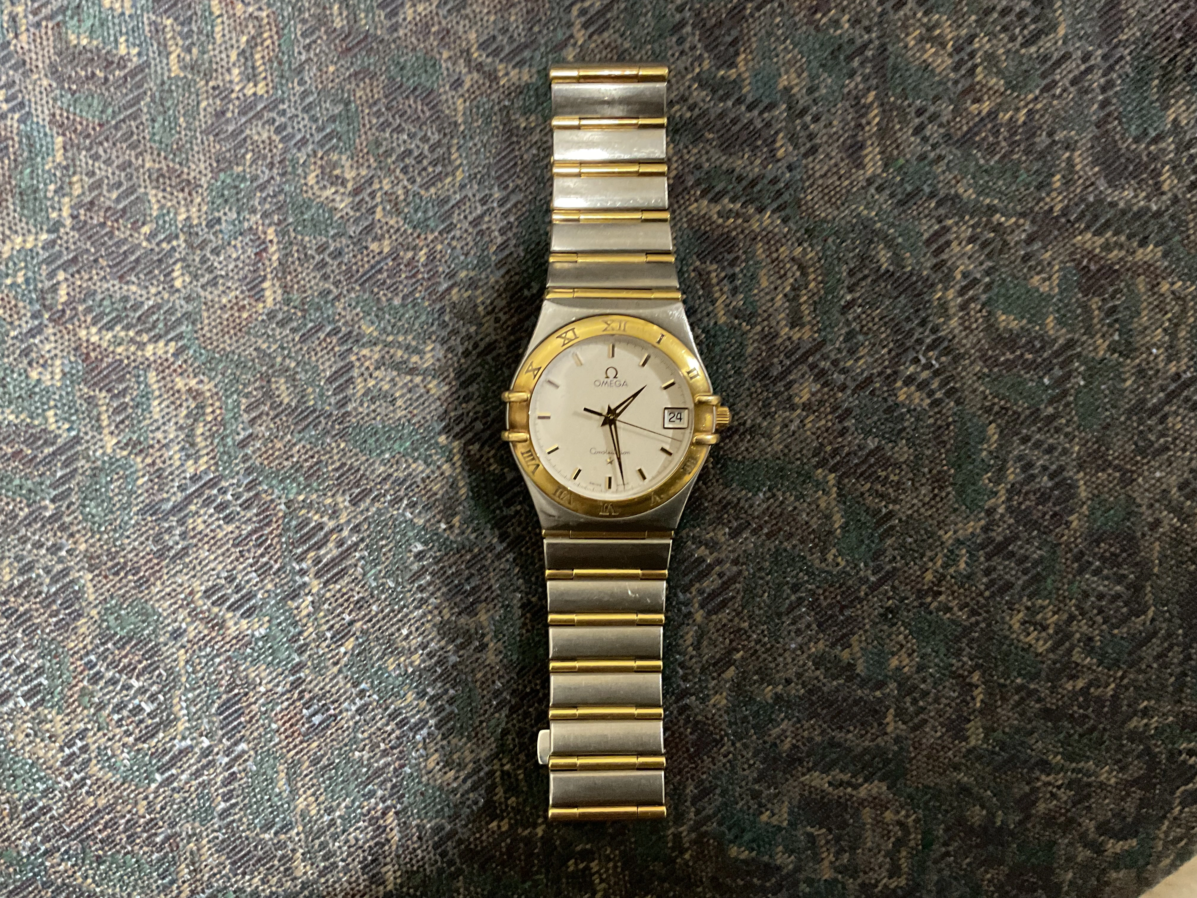

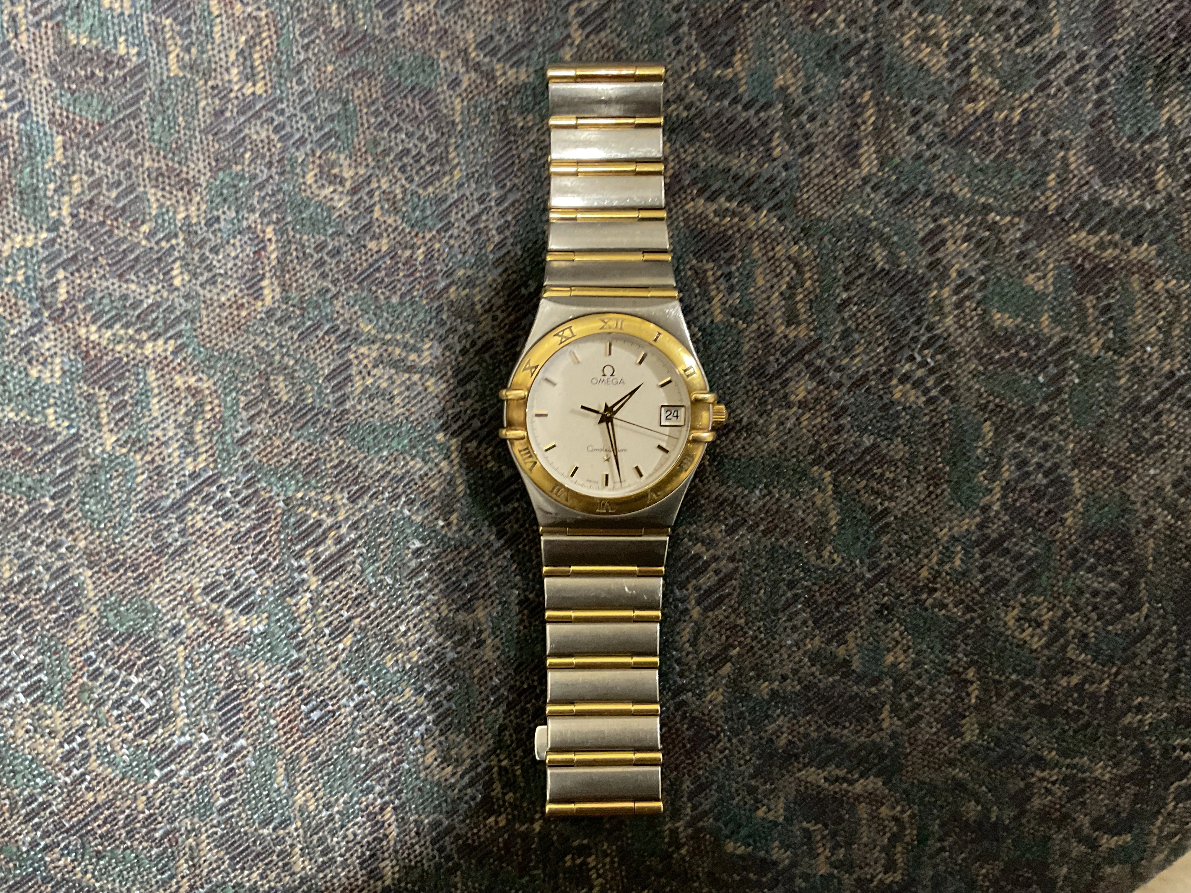

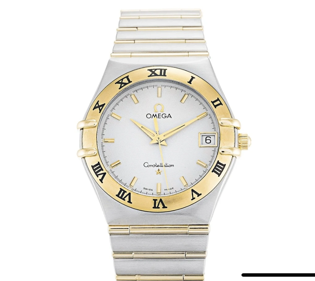

Hi. New forum member here. Not sure which section best to post this thread in but hopefully this is a good place to start. Have a 15-20 year old Constellation model # 1212.30.00 (see attached pics + comparison pic of similar newer model) that is showing cosmetic wear on the bezel and band that I am wondering if possible to freshen up and restore to “newer” appearance. Mostly would like the roman numerals on the bezel to again be darker in appearance and the bezel, case front and band to be buffed so that scratches are less visible and gold coloration more uniform. This is a watch worn daily and I am not concerned about diminishing any “collector value” it might have, now or in the future. That being said, I would hope to have work down by a qualified person who had experience and ability with this type of refresh. I contacted Omega, the rep I spoke with said that due to age of watch it is now considered “vintage” with limited parts availability and would have to be shipped to the Omega Switzerland factory for formal inspection, upon which they could then inform me of possibility (or not) of doing the work desired and cost of same. Not sure thats the path I wish to pursue if other more local options are available. FWIW, the local authorized Omega retailer in my hometown reiterated the company rep rec to send it to Switzerland. Anyone here have recommendations or advice that might be of help? Appreciate your thoughts.

So if you get it serviced it will come back looking new again, they may recommend replacing the bezel or may be able to save it. If you just want the lettering back, the easiest say is to just use a black sharpie pen to paint it black again in the recess and wipe the excess off the top surface of the bezel.
Here's one example from our sister site tagheuerforums.com
https://tagheuerforums.com/threads/bezel-marker-paint.108954/
If you want to get more serious some black enamel model paint will do a better job, similarly cleaning the excess off before it dries.
3
Thanks, may give that a try. I had considered that as a possible option before posting but just wondered if anyone had contrary thoughts. Appreciate the rec.
3
Took “dsio” ‘s advise….experimented a little with fine point sharpie and then black enamel model car paint, alcohol wipes for removing excess. Got best result with careful application using fine point sharpie and then wiping/rolling motion the excess with dry fine needle point cotton swabs (Amazon). Don’t expect it will last forever but will be easy enough to reapply when needed. Also wiped watch and bezel/claws + bracelet with “Connoisseurs “ brand gold and silver dry jewelry wipes (also Amazon), brought out nice sheen and removed tarnish on gold. Happy with result. Makes my everyday watch look much closer to it did when new. Thanks dsio!
