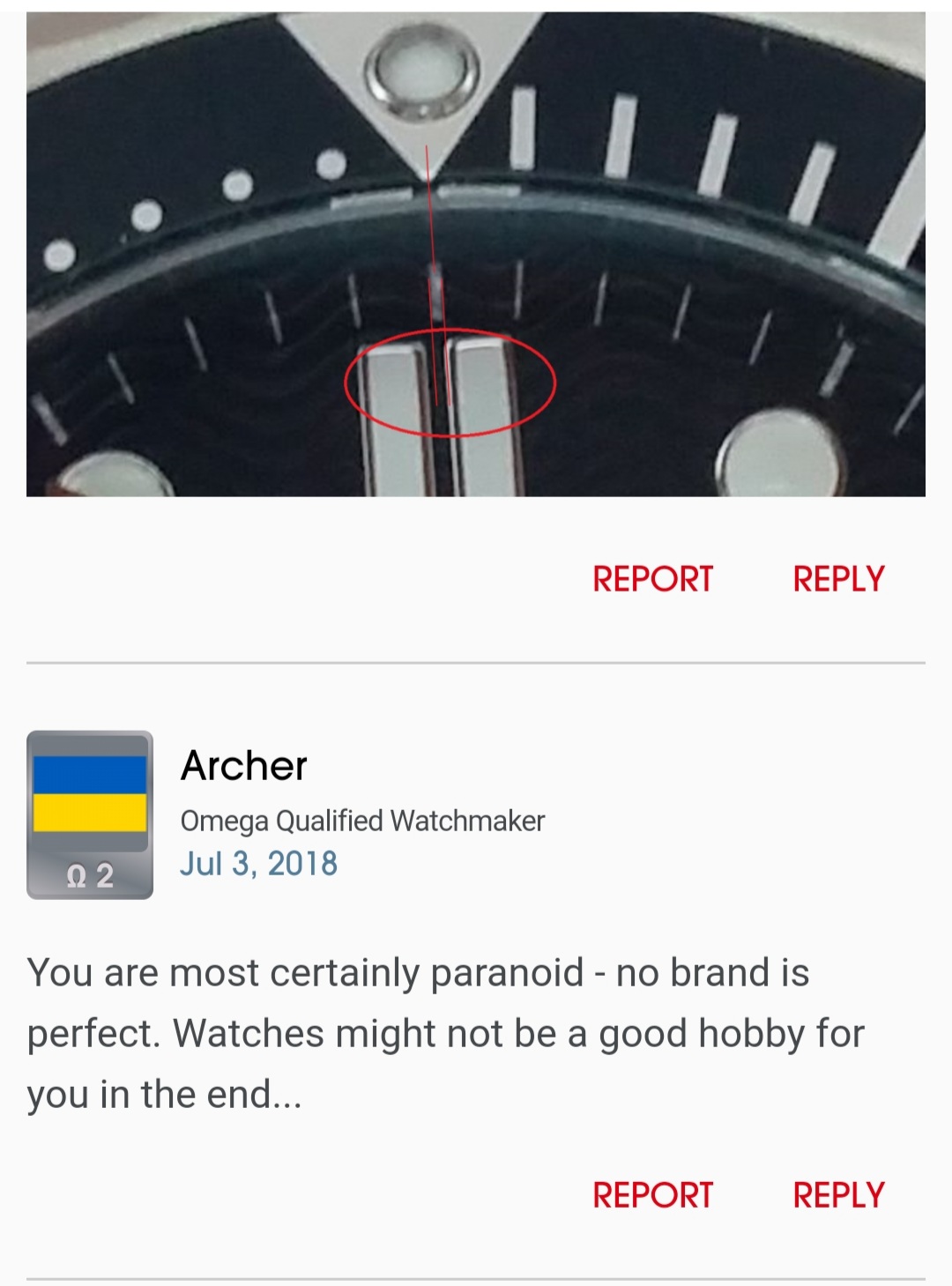

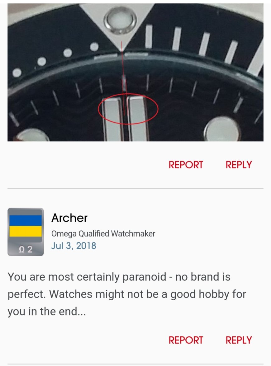

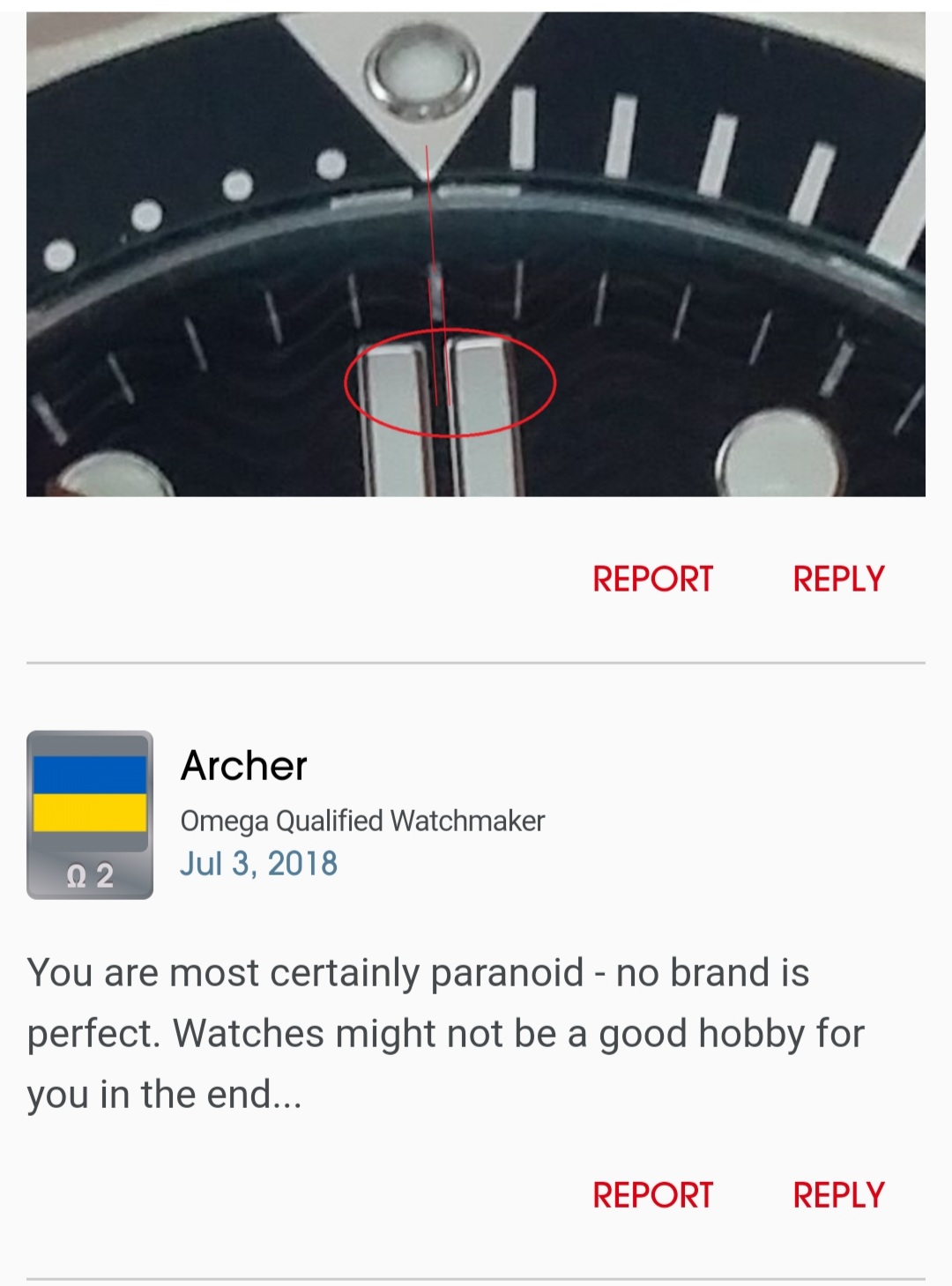

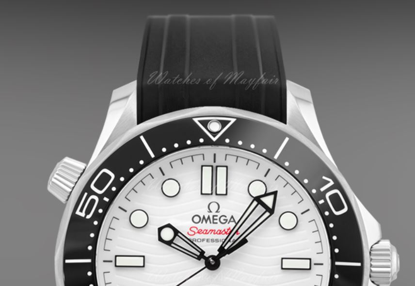

Guys,
What do you think?
Since i noticed it i just can't unsee it 🙁
One is tilted and they aren't at the same height.
Do you think Omega would do something if i bring it?
I noticed it too. Human eyes can notice things like that pretty sharply, you'd be surprised. At this pricepoint you'd expect them to be parallel. It's too much money to accept it 'as is'. I'm sure there's something they can do about it.
32
25
Let us know what Omega says.
I went to an OB yesterday and presented it to the watchmaker.
He did confirmed that QC after fabrication is made by staring at the watch with a naked eye at a distance of 30-40cm, not closer.
However, looking closely he agreed that there is a slight misalignment of the indexes.
He proposed to send it to OSC as they are the ones who will decide if this is a flaw or not and that it would take about 6 weeks.
Option 1: it is not considered by OSC as a flaw and the watch will be sent back as is
Option 2: it is accepted as a flaw and the dial will be replaced
I decided to spend the summer with my watch and see if in September i'm still obsessed by these indexes or not ^^

This thread reminded me a bit of my insecurity when i joined the forum, i even wrote @Archer a PM, asking for his opinion 🤦
I obviously didnt want to give up the hobby, so learned that nothing is perfect and since then those things dont bother me really.
Dont worry, you are not alone!

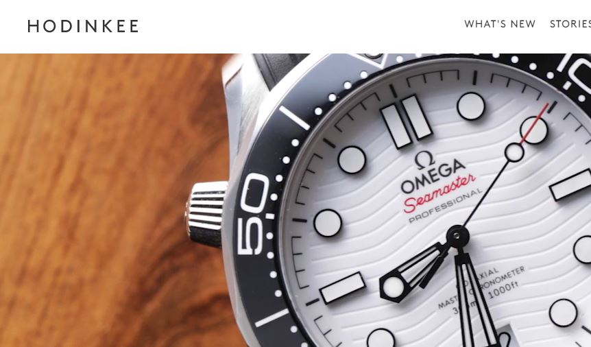

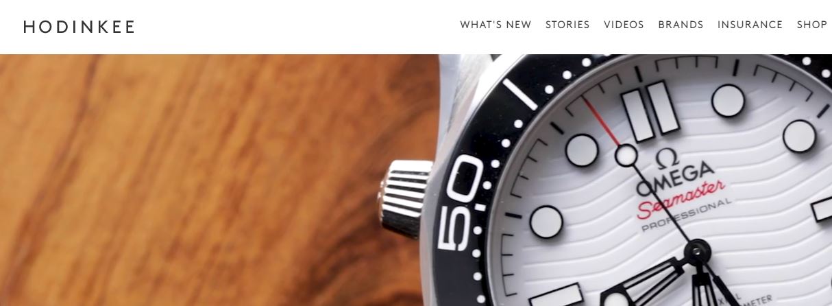

Well, when you watch that video
it seems that most of it is made by robots, even the hands installation. Then you wonder how you can end up with hands misalignment!!
Even robots make mistakes... 😡
274
266
That’s probably precisely why there are hand misalignment issues. It’s due to slack in the gears, not sloppy placement.
To explain: If they were manually applied, the watchmaker would apply the hour hand first, then move the hand to the 12 position, removing any gear slack or backlash. If done by robots, they’re probably just placed on the pinion without any regard to the positioning of the underlying gears or any backlash that may exist within the mechanism.
So many ‘master chrono’ Omegas I have seen have hour hand misalignment issues.
