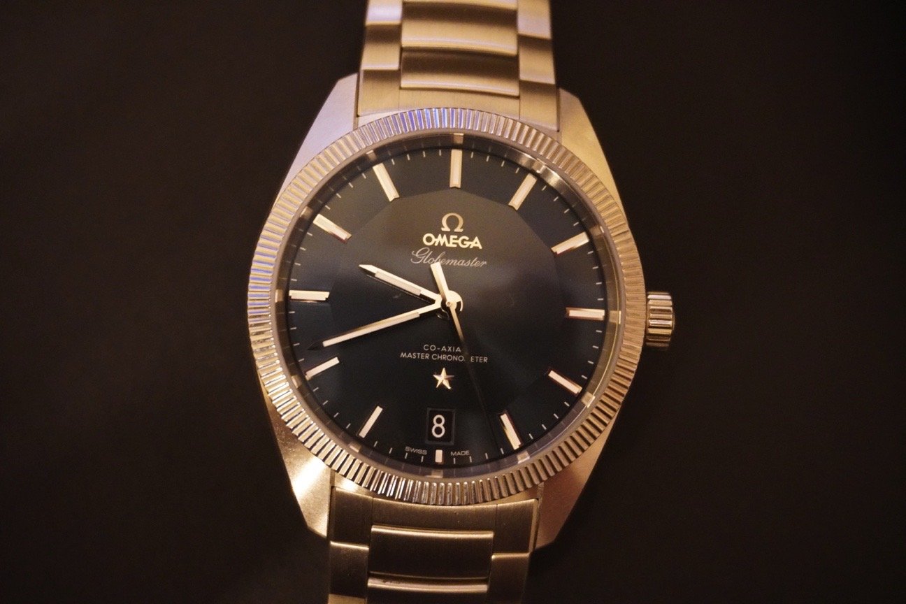

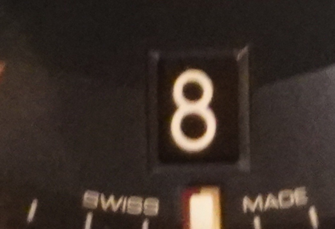

I bought blue Constalation Globemaster from my AD and I really love the watch. There is just one thing that really bothers me. When I was buying it two digit number was set as date on the watch. Couple of days after using it a realized that when there is one digit number the date is not perfectly centered (as photographed for the advertising) but little misaligned) I mean it might just be me but I can’t unsee it. I brought it back to AD and they took photos and sent them to Omega Geneva and indeed they said it is not perfectly in the center. But they also told me it is expected since the watch was built by humans and that it is just a small misaligned it doesn’t qualify as a mistake and therefore they will not be fixing it. I mean as my first luxury watch purchase it didn’t occur to me this is something I should be aware of and should check. It especially bothers me since all the promotion materials feature “8” in the center. I will leave the photos here so you can tell me it I am seeing thing or what but hey, it least you know in the future what to look for when buying Omega. I have to say I was little disappointed.

It looks off center to the left of the center line. It would bother me. Is it just the 8, or every single digit? I think Omega should fix it.

Well It is most notable on 8 since 8 is symmetrical. The two digit ones are not so obvious but I think the whole disk is shifted. They told me that it is impossible to have all digits perfectly centered, that some has to be shifted. Something about mechanics and stuff ‍♂️. But I mean, they game me the watch back and said, the watch is fine. Its like, what can I do? I am thinywhen I have it serviced in the future I will tell them, but until then ‍♂️. I can’t do it myself and they told me they will not do it for me

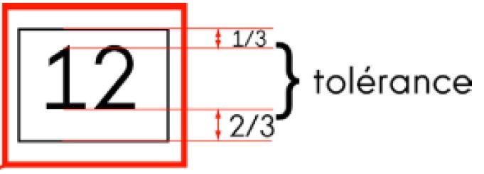

The tolerance for vertical alignment with the date window at 3 o’clock is the the gap between the digit and the edge of the date window can be 1/3 on top/bottom and 2/3 on the opposite, and still be within tolerance.
If you were to apply this to the side to side alignment in your photo, I think it would be within tolerance.
Maybe you should check this comprehensively by taking a photo of every date. I would have thought they would all be shifted/centered similarly.

Yeah that is what they told me. It is within a tolerance. But like, if you buying watch this expensive you just don’t want something incorrect but within a tolerance. I would ask for different pieces knowing this prior the payment. But after you pay they will tell you its fine, it’s within a tolerance.

That's literally what 'tolerance' means.
Keep trying though, and maybe Omega will take care of it.

I'm simply relaying what Omega's tolerance is...
