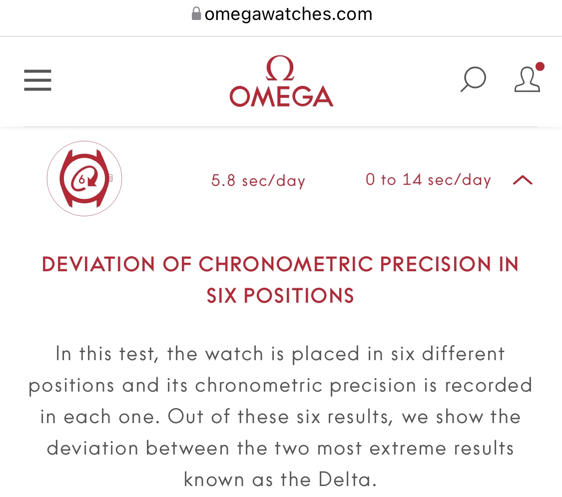

The movement has a 14 second tolerance across adjusted positions. I’m in the 2-3 s/d territory only because I’m always cognizant of not leaving the watch in the dial up position. Check the gear slack on your watch, I’ve tested several examples and it’s quite large.
No, the tolerance is 12 seconds at full wind across 6 positions.
56
10

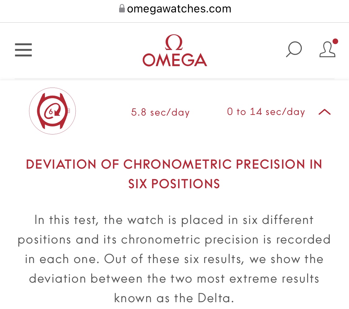

No, it’s actually 14. I’m referring to the delta. Here are my watch’s results via the Omega website:
30,205
77,993
Yes, I know what that means. Omega's internal tolerance for this is 12.
56
10
Well, it says 14 on the official paperwork so there’s no reason for me not to believe it’s 14. Never knew there were internal/external tolerances for these results. Thanks.
