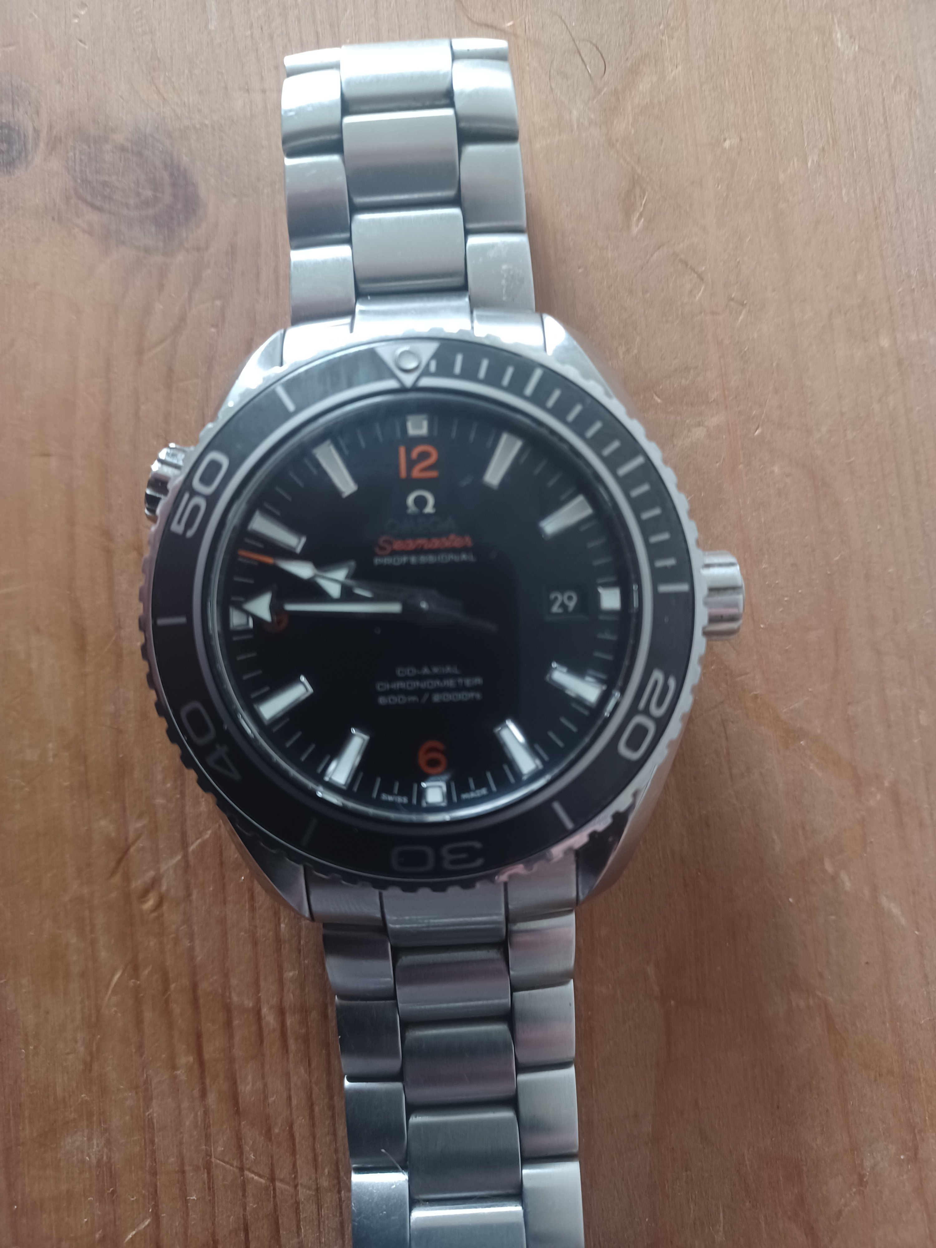

Earlier this year, I purchased a Omega Seamaster Professional watch, skeleton back, 2012 model, full purchase documentation, certificates, polished wooden box for an attractive price, from a local independent jeweller.
It is a beautiful watch. The jeweller owned it before going into the business and due to the nature of his job, only wore it occasionally. It is in excellent condition.
It was his own watch and I even have the receipt from when he first purchased it.
He was going to pass it onto a family member of his, but put it up for sale in his shop. He had it serviced to check the seal, prior to thinking of passing it on to the family, of which I have the receipt also.
However, it has recently started to irritate me a bit that some time ago, I noticed the bezel only slightly misaligned at 12 o'clock. To be honest, the camera makes it look far worse than it actually is.
I understand from watch forums that other Omega owners have the same with their watches. Some owners have the bezel adjusted and others simply accept it and live with it.
A different local jeweller, who has a repair shop in another town, feels she personally would not be concerned with the misalignment as it is minor, but sought advice from the repairer who said if it is sent to him, he would price up an alignment job for me. Also, she staid that is is not a major job or else it would have to be sent to Omega.
Her advice is to leave well alone, as there are risks in servicing.
The jeweller I bought it from showed me on his own Seiko that his bezel is slightly out. My Tag Heuer's F1 bezel is perfect.
Have you had a slightly misaligned bezel and did you have work done to put it right.
I appreciate any advice.

What does it look like one click before that? Almost looks like it's one click past 12.
Personally, that would annoy me and I would have it addressed with a service. I have 2 8500s and both bezels align correctly.
8
It looks similar, one click before it.
I do know that other Omega watches, from online forum searches, have had misaligned bezels.
Does age/usage cause them to become misaligned?

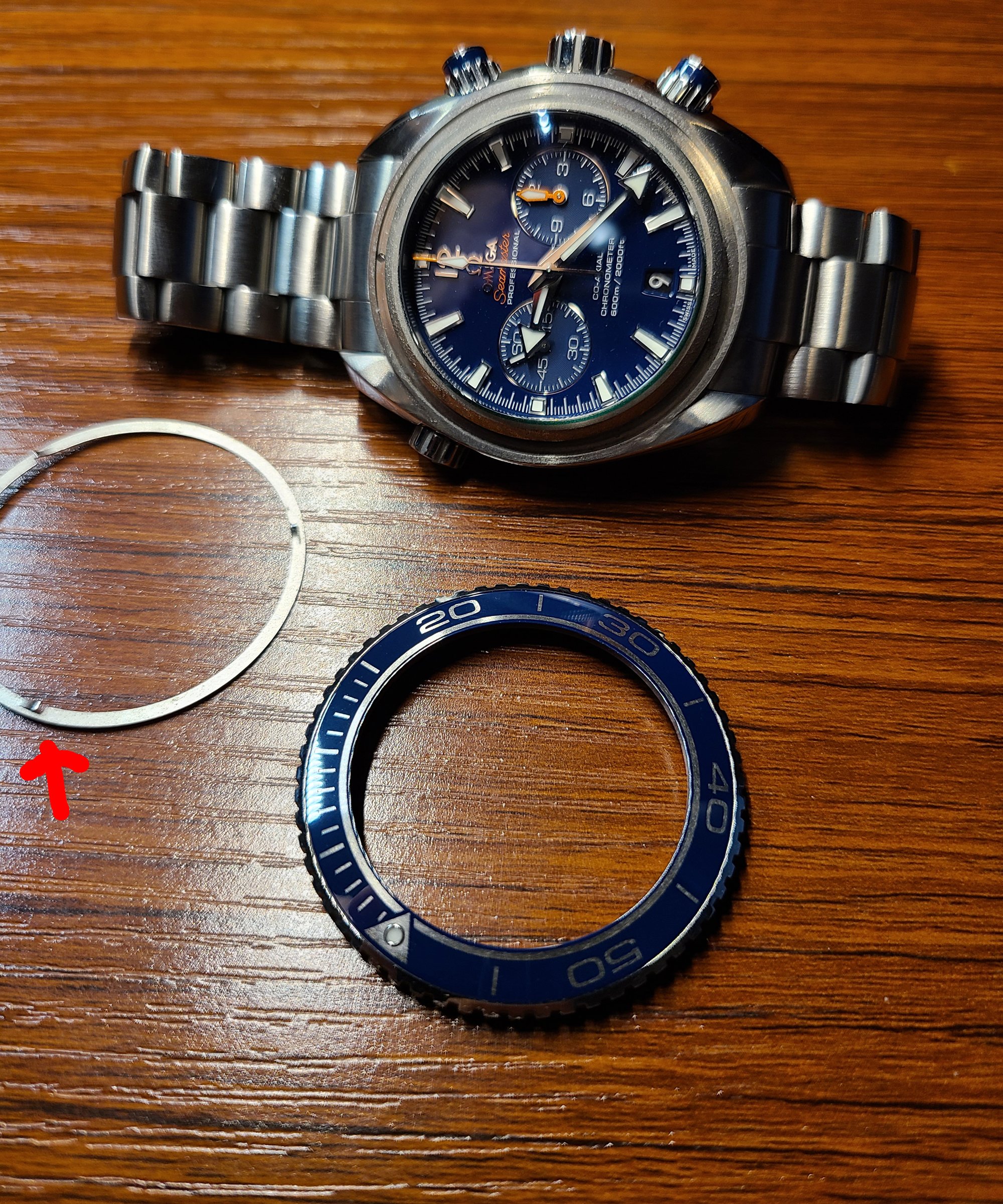

Not really. The likely problem is that one or more of the bezel click spring's ratcheting "teeth" are slightly bent at the wrong angle underneath, thereby stopping the bezel at the wrong point. The fix is either bending them to the correct angle or replacing the whole part.
Here's a pic off a 9300, but the part looks the same:
