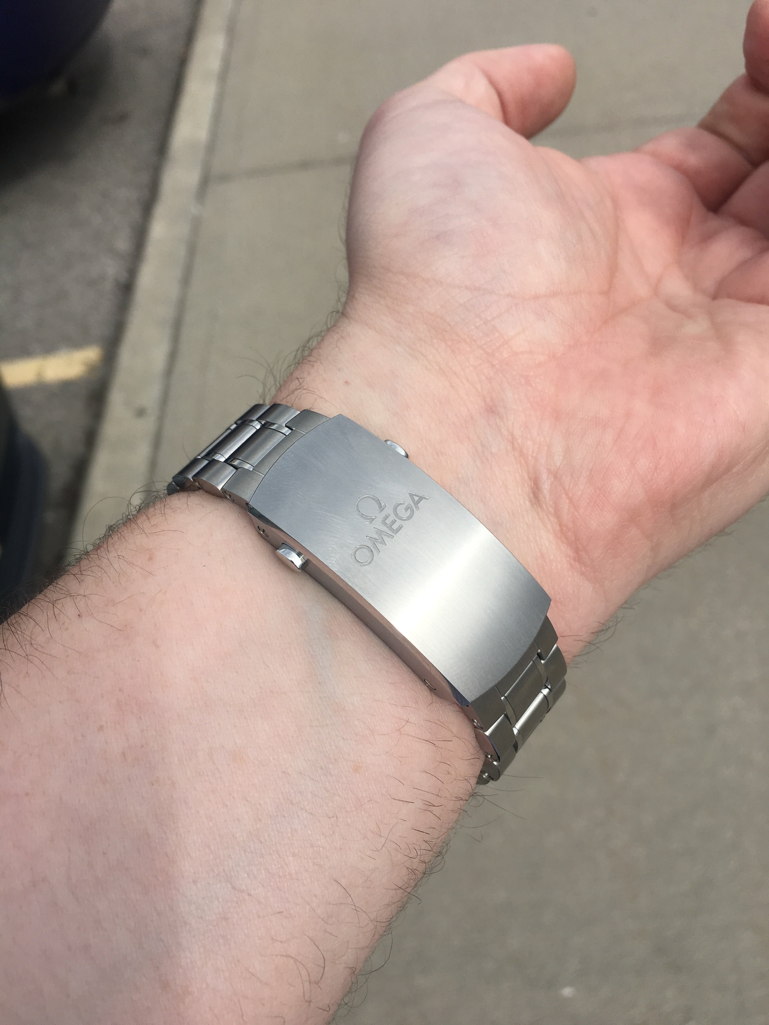

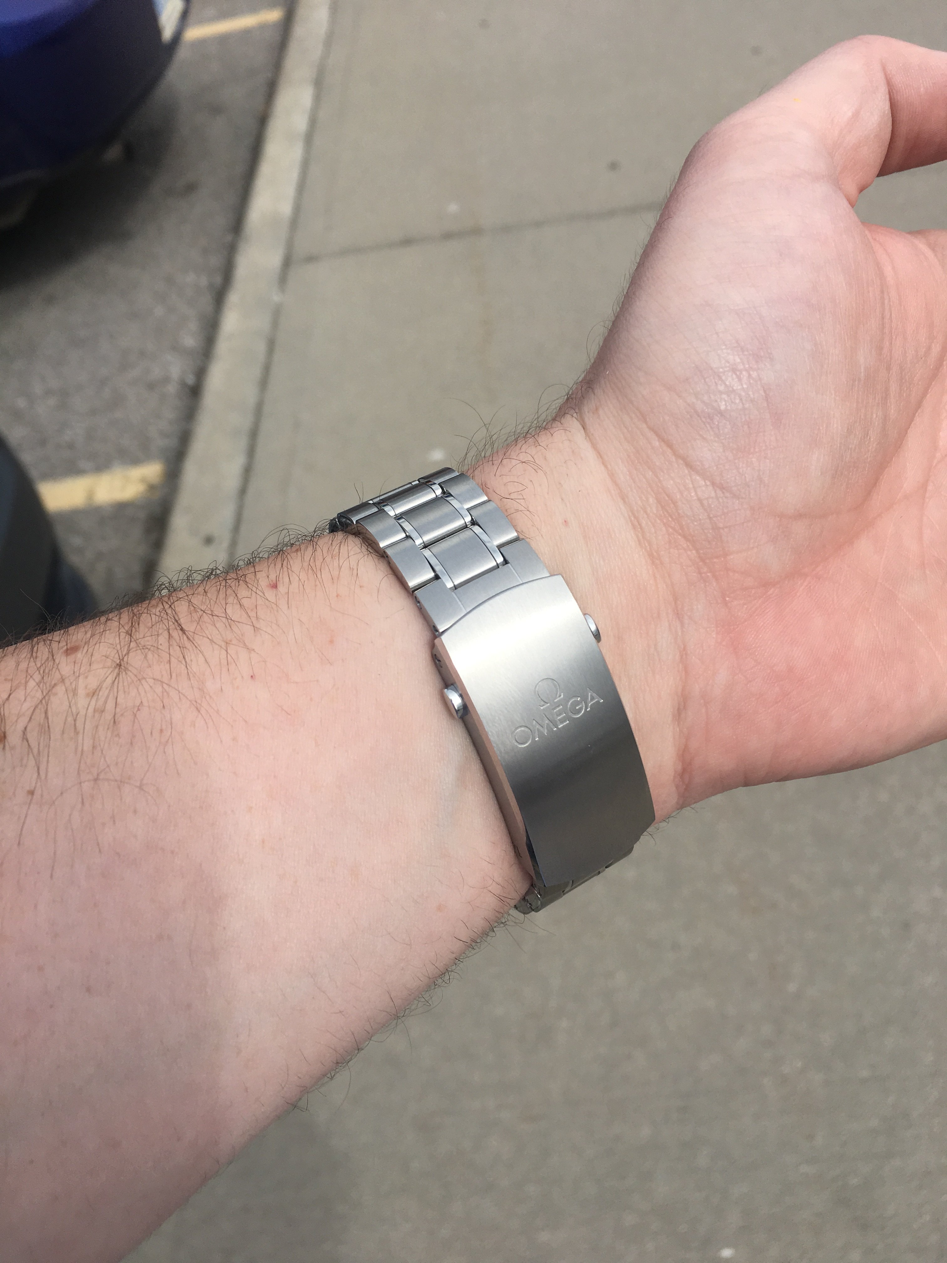

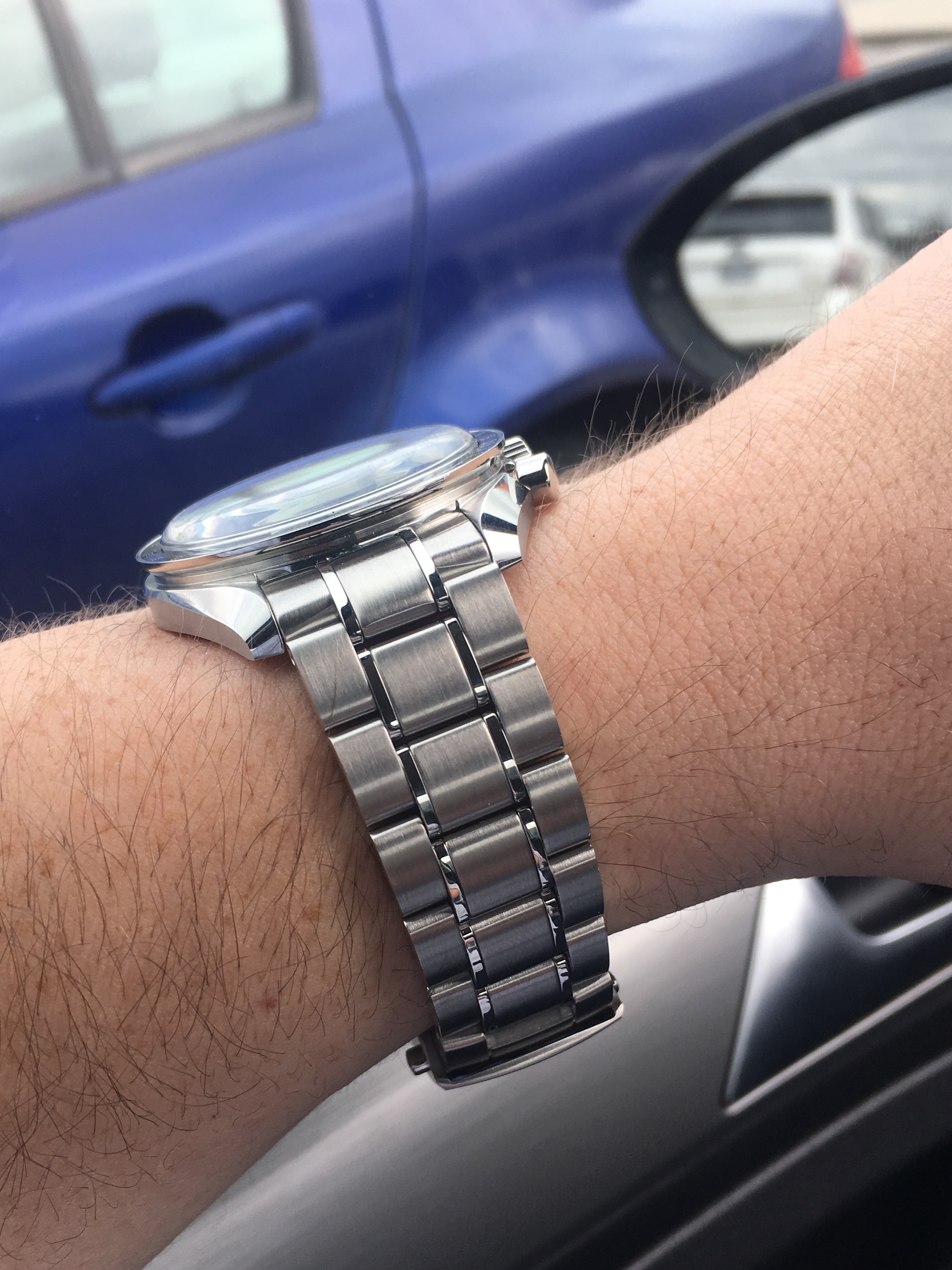

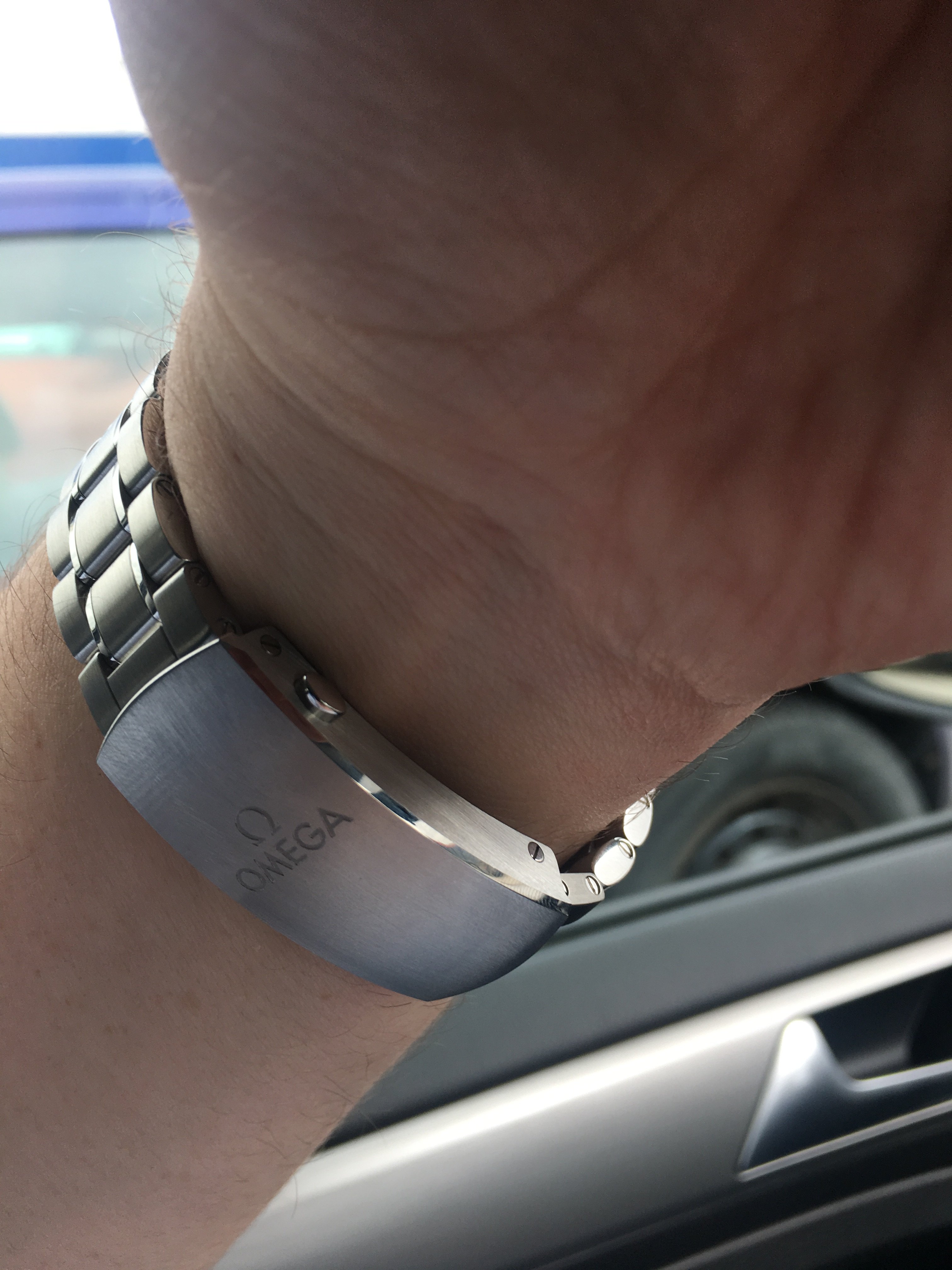

Ressurecting this thread after taking delivery of the PO Clasp and fitting it onto my current gen Speedy Pro.
I'm one of the unlucky few who's wrist-size falls into the either slightly too tight or much too loose category when sizing the bracelet for my wrist.
I sourced the clasp and endlinks from someone online and had it switched onto my Speedy's bracelet today by my AD.
When doing my research, I found there weren't many wrist shots of the clasp attached to a Speedy Pro, so I figured I'd add some to this thread in case anyone else is interested.
First impressions:
-The bracelet with the clasp is noticing heavier. I definitely prefer the wrist feel if the smaller, original clasp.
-Comfort is fine is fine... the clasp is smooth
-Quality about on par with, if not a stitch better, than the Speedy Pro bracelet. Nice click when securing the clasp. Detaches easily when removing.
Feel free to ask any questions. I don't have the reference #'s available, but they've been widely confirmed here and on other forums.
At this stage, given the extra weight, I'm not sure if I'll keep the clasp on year-round, but during humid Ontario summers, I'm thinking this is a winner.
