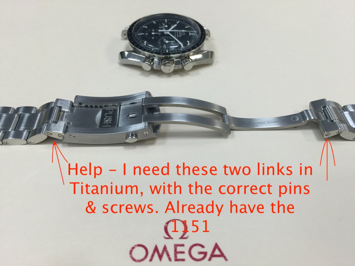

Hi there,
I have the Ti 1151 clasp, but am still at a loss as to the Titanium equivalent of the 118ST1589 links (and pins and screws) for my 3rd Gen X-33 bracelet. The Ti bracelet is the same size and style as the Speedy bracelet, just not in steel.
For instance, I am using the 1154 clasp and 118ST1589 links on my Speedmaster Pro 3570.50, and the X-33 bracelet looks the same except for the materials used (the 1189 links also work with a 1610/930 bracelet for a 2254.50, and on the 42mm Planet Ocean 2500 2201.50 bracelet - been there done that). I just can't find the Titanium parts numbers.
So, does anyone know the part numbers for the Titanium links to connect the Titanium 1151 clasp to a Speedmaster style bracelet, with the corresponding pins and screws?
I do NOT wish to use the steel 1589 links with it's pins and screws for my Ti clasp.
THANKS!

I researched years ago putting an adjustable clasp on old ref. 2298.80 Seamaster Chronograph Titanium with a titanium ref. 1504/826Ti bracelet. It was not fruitful.
I determined the following was required:
P/N 117TIZ004664 - titanium version of 6-position steel 117STZ001154
P/N 117TIZ001159 - titanium version of w/diver's extension steel 117STZ001159
Smaller/shorter 2-4mm (3-position) micro-adjustable steel 117STZ004666 does not seem to be available in titanium
P/N 124TI3307 titanium screws, and
P/N 128ST0166 steel pins
Conspicuously missing are the clasp links. The reason is that they don't exist for the "Bond" bracelet. My research also concluded that titanium clasp links for the "Speedmaster style" Ti bracelet affixed to the ref. 2232.80 Seamaster Titanium "Electric Blue" are also nonexistent.
This info may.have changed as it was over five years ago. The only hint of a part that I ever found was P/N 118TI1515 for the titanium "Bond" bracelet but it is not in the catalog.
