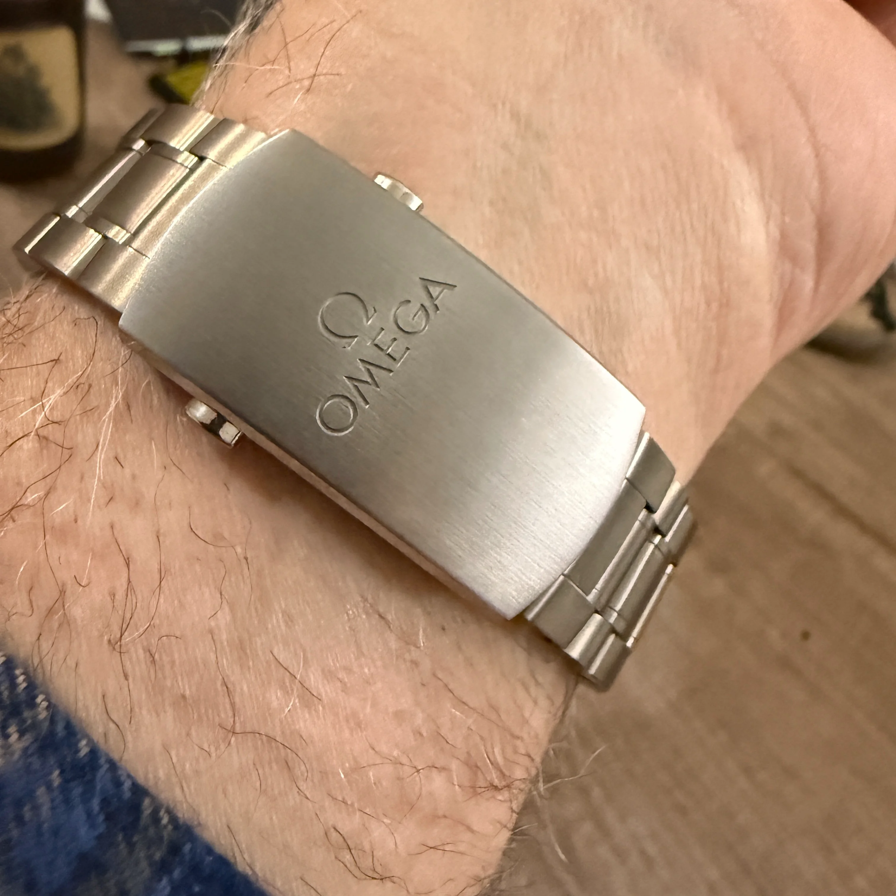

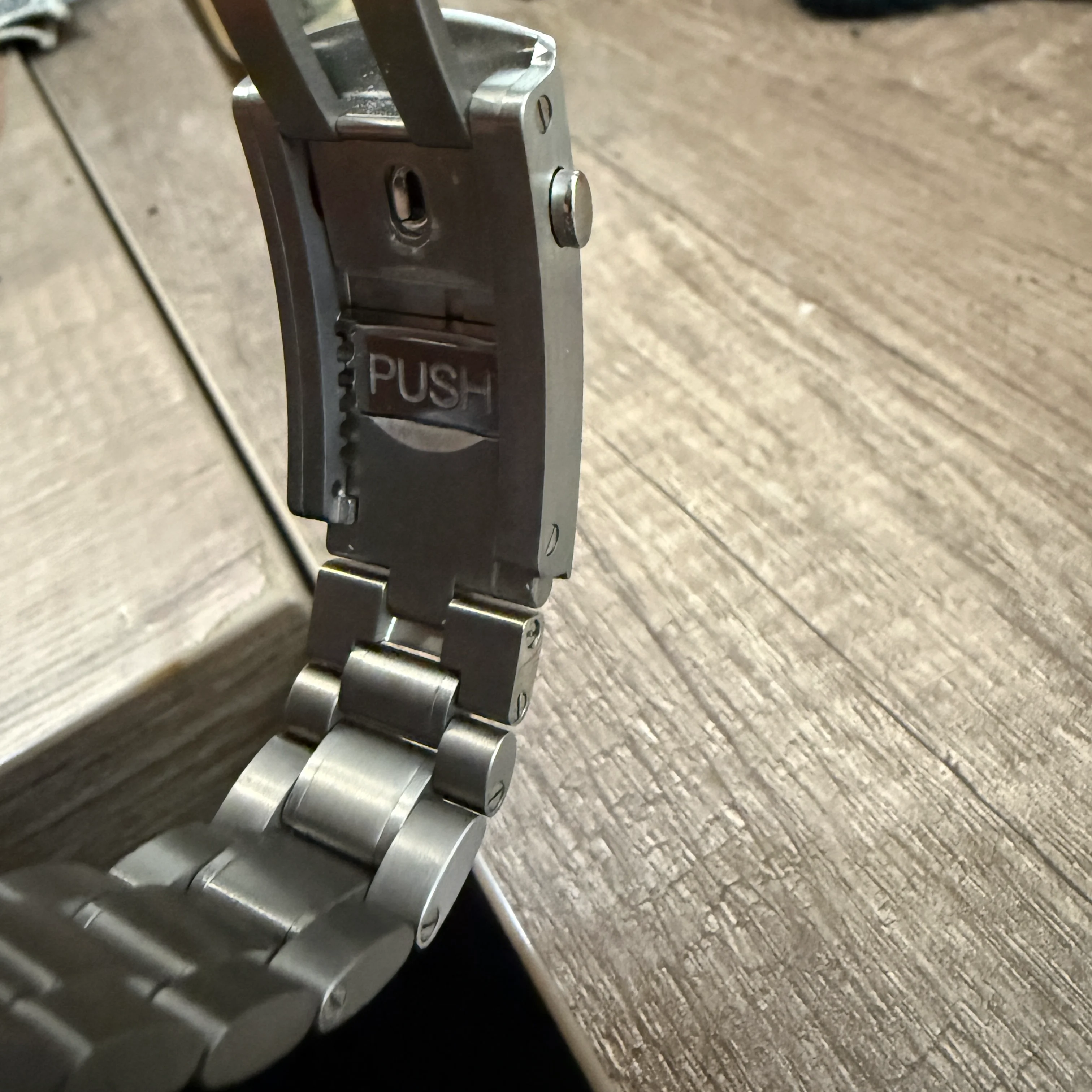

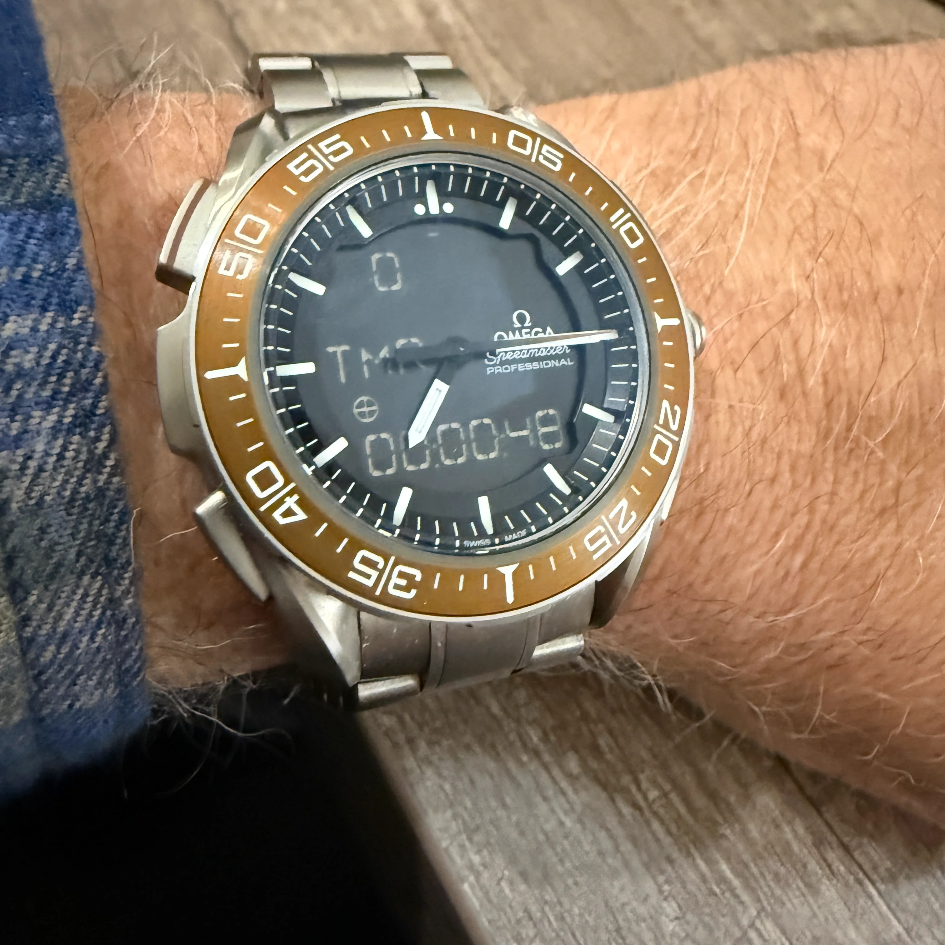

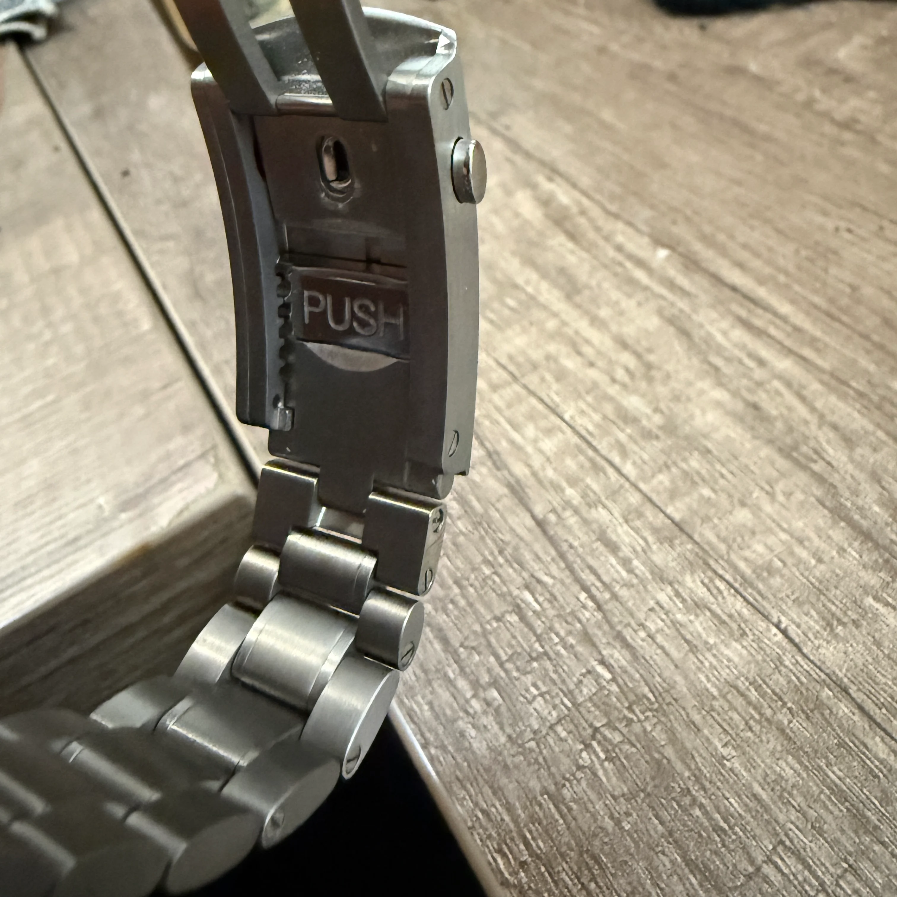

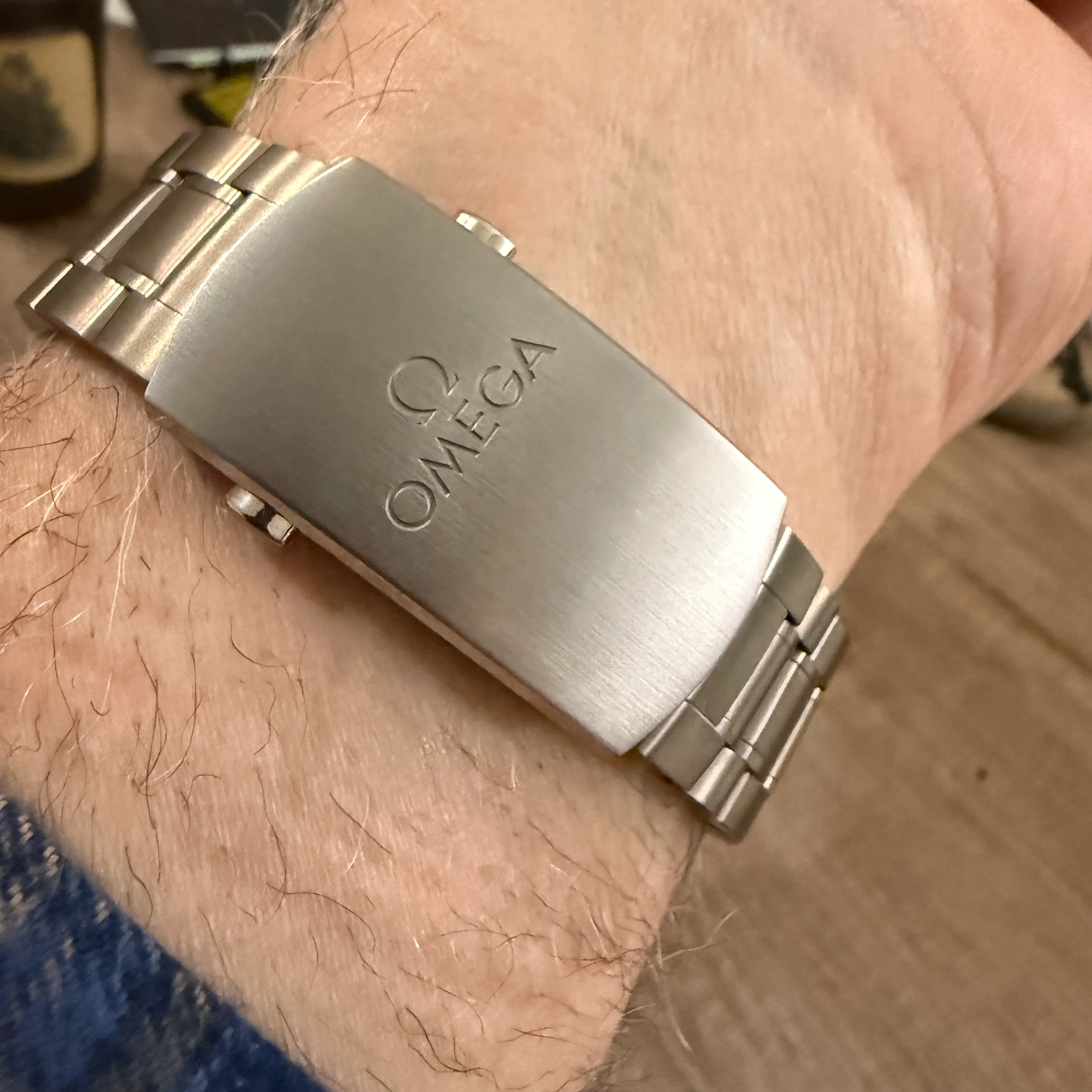

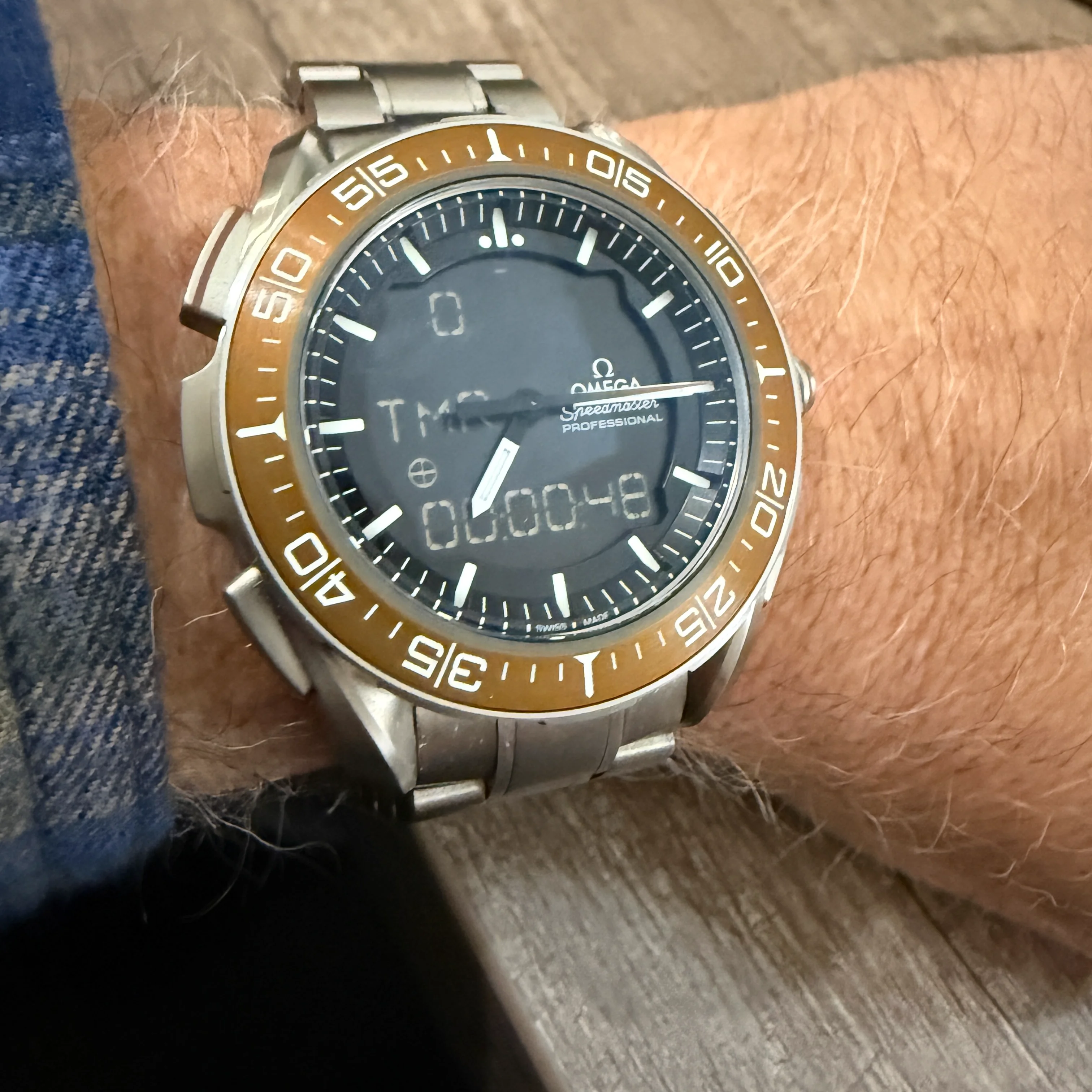

First post... I searched for this info forever via the web, forums and Reddit, so I figured I would share it.
I have been wanting to buy an Omega Marstimer since its release, but what preventing me from doing so was the lack of a micro adjustable clasp.
There are so many speculative posts and conflicting info, I thought I would add the following info for others that may be searching for the same.
To replace the existing clasp you need the following OEM parts:
(1) 117TIZ001151 Omega Seamaster Adjustable Titanium Clasp
(2) 118TI1589 Omega Seamaster 18mm Titanium Clasp Links
I bought the watch at my AD plus these 3 parts via Swiss Watch Part and viola', I now have a X-33 with a full titanium OEM micro-adjustable clasp.
I believe this solution would also work on the 3rd Generation Speedmaster X-33 Skywalker (2014–current), but I can not confirm as I do not own one.
Hope this info may help others.
ps: Please excuse the quality of the wrist shots - just quick snaps to show the functionality.

Do you notice a color difference? The clasp is originally for a Seamaster using Grade 5 Ti. Your Marstimer is Grade 2 Ti.
Just peering at my wrist there is a slight difference, BUT only on the clasp and zero on the clasp links... so I suspect it has more to do with the large brushed clean surface of the clasp and how it reflects the light... this weekend I will look at the original clasp and compare the two for a more definitive answer.
As promised I pulled out the original clasp to contrast the colors side by side, they appeared the same other than the adjustable being considerably longer, but in direct sunlight the original clasp appears a very slight hue darker - very minor imo. Hope this helps.

Just to add this will work with a Skywalker X33. The parts list I had for mine was:
1x 117TIZ001151 clasp
4x 3307 screws
2x 0166 pins
2x 118TI1589 clasp links
