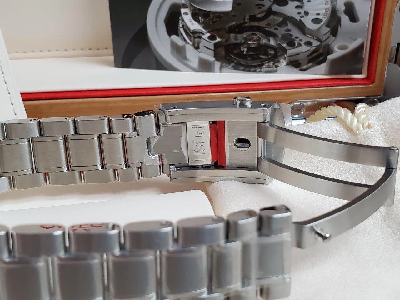

With all the new Speedmaster bracelets that have been released that have micro adjustable clasps, is it possible to modify the oem speedmaster coaxial bracelet with any of them?

Which Speedmaster model do you have exactly? Based on the 9300 in the title, I'm guessing one of the earlier two-counter versions. For those, you can just get the adjustable clasp (or complete bracelet) from the Speedmaster Racing 9900 series.

Correct, the bi-register model with date at 6 pm (311.30.44.51.01.002). If this is the model you meant, do you happen to have the item number for the Speedmaster Racing 9900 series clasp? Would I need any additional links to mate the clasp up to the bracelet? Anyone happen to have a pic of what the mod looks like?

The clasp itself is P/N 117STZ004666 or sometimes just referred to as STZ004666. I think it might need an additional link to connect to the rest of the bracelet.
